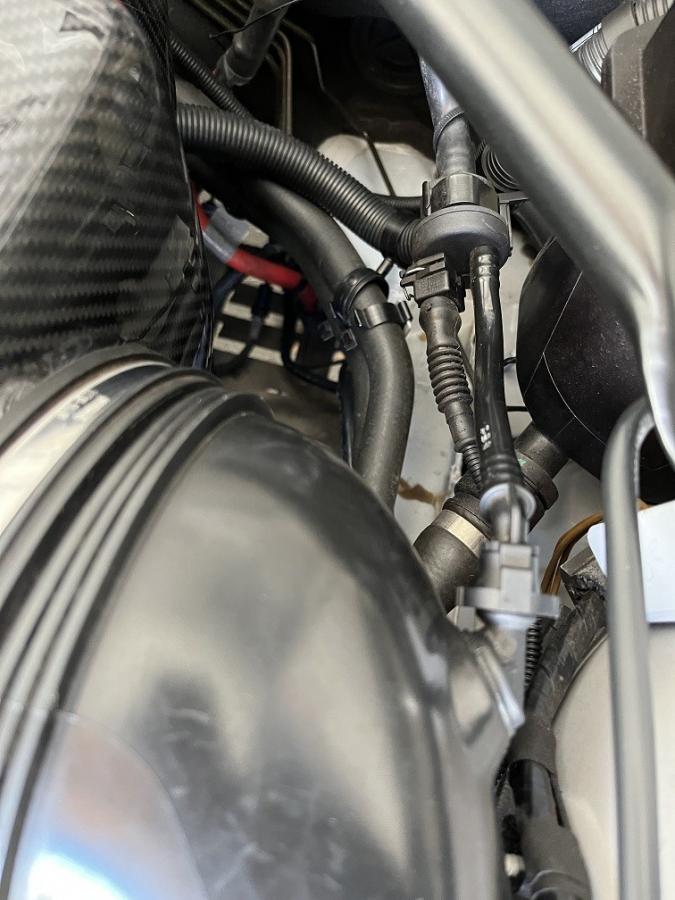

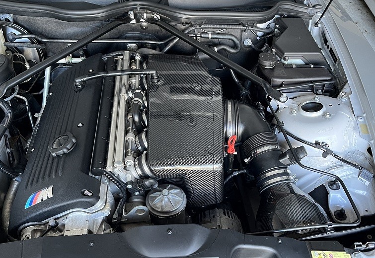

      I got my Karbonius plenum installed yesterday but didn't get a chance to have a proper drive until today.
      Notes on the installation:
      - pretty straightforward, even for someone like me that isn't very experienced.
      - I used silicone tape around the plenum opening. This gives a grippy surface without leaving a residue.

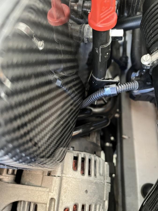

      - I had some trouble with the location of the dipstick - it was too close to the plenum and rubbed when I was putting the plenum. In the end I used rubber washers on the mount to space the dipstick away from the plenum, which worked fine (see one of the images below).
      - The hose that comes from the elbow (only Z4s have this) joins up with the electrical conduit that is mounted to the side of the dipstick. There is a mount on the standard plenum for these but not the Karbonius plenum. I zip-tied them up but it's not ideal (see photo below).
      - I tried to install the stock air filter housing but it was contacting the electrical conduit on the side of the dipstick and the dipstick itself. Even if I hadn't of used the spacers, it would have been close. So, I just installed my Eventuri straight away. Bit of a bummer as I wanted to do some tests with the stock air filter housing.

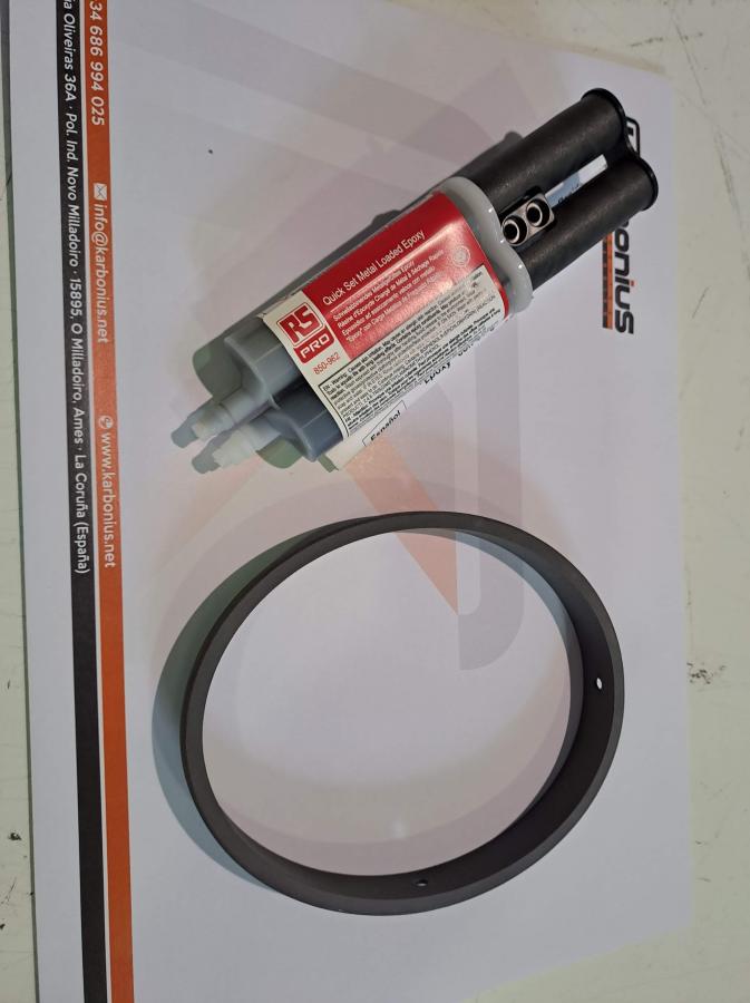

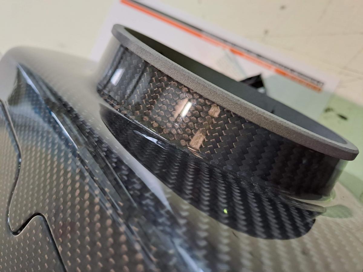

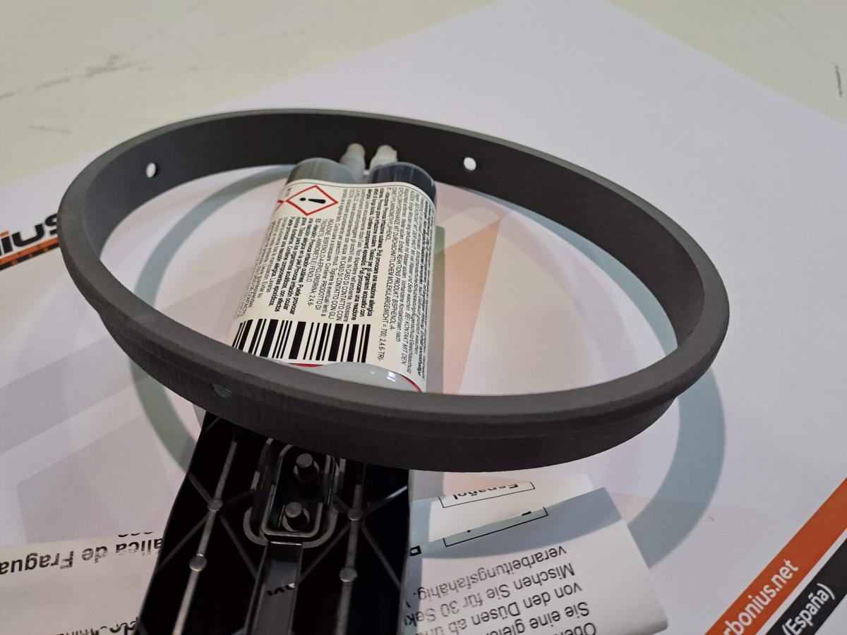

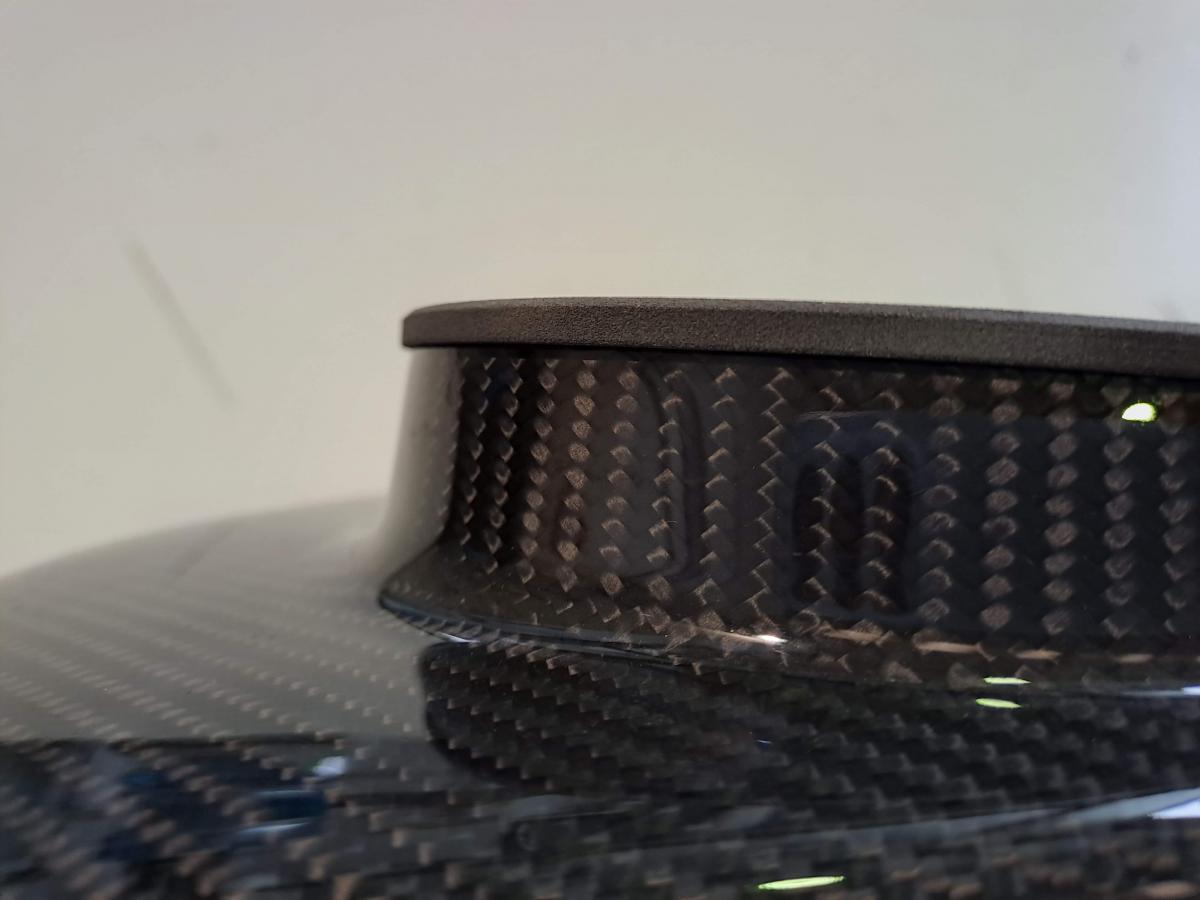

              I'm not sure if this is an issue for the E46 guys, but Z4M users have found that the factory rubber intake elbow slips off the opening to the plenum. People have used tape to stop this from happening but Karbonius now has a permanent solution. From Karbonius:
              "We have developed a solution for the slipping of the tube
              Can tell the people on the group they can ask for a kit and we will ship
              It includes glue and a laser 3D printed nylon frame"
              Pictures below.

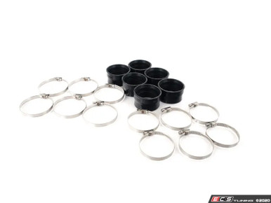

                      My car is euro spec 3/2005.. do I have to buy new silicone boots and clamps or I can reuse the stock ones?
                        #71
                        You need the pre-2003 old style boots. Or the new silcone boots sold by Turner which are for the pre-2003 cars. I forget the cutoff date, but after 2005 is definitely the new style boots.
                          #72
                          Here it doesn’t mention something
                          A specialist provider of performance BMW and MINI parts. The widest range of BMW and Mini performance and tuning parts online. At our established headquarters near Manchester, England we are the sole European distributors of American brands such as ECS Tuning, Dinan and NM Engineering.
                          while turner mentions it fit cars up to 10/2004
