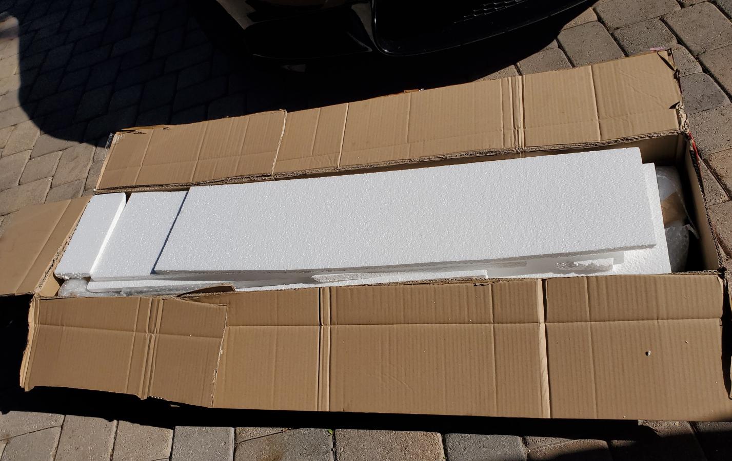

    Box/packaging was amateur, though effective

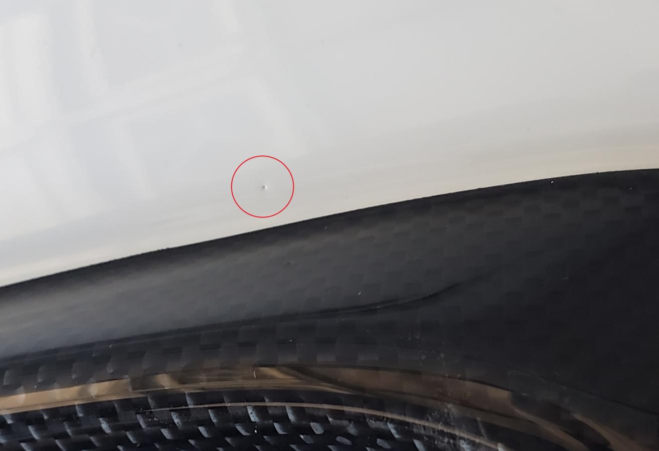

    Only 1 pinhole on this piece, but for the price paid, I still find it unacceptable

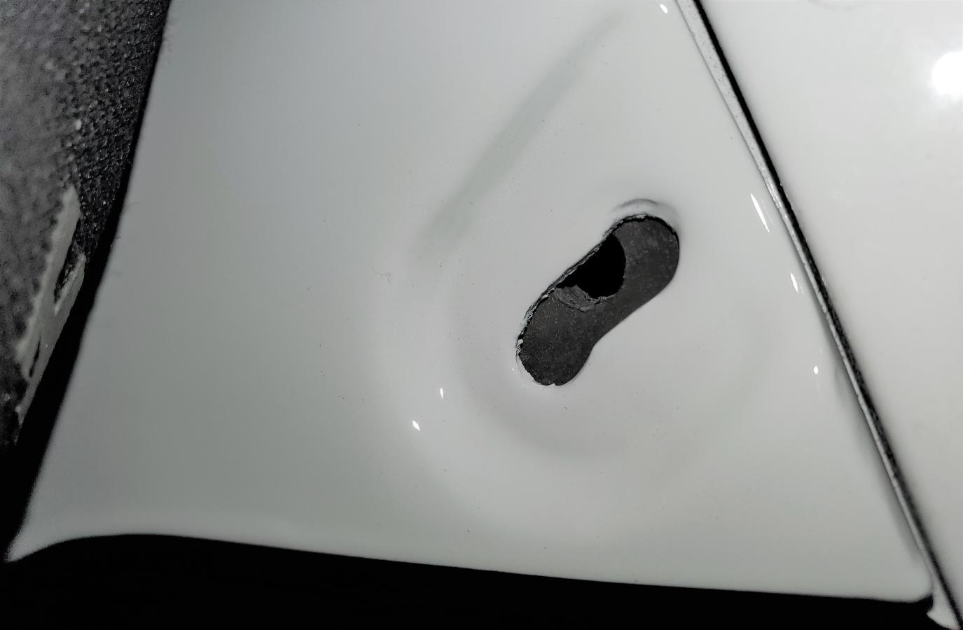

    This is the most disturbing part. Now I can't say for certain that the piece didn't already have this issue when I unboxed it, but I doubt it. I don't remember it, but I also can't see in any of the other photos. This piece was not dropped, and no tools were used. I literally was pushing it into place. Even stranger, and a compliment I was going to make about the install, is that the piece, with factory like tabs, is very easy to install - very factory like. Despite that, upon pushing this portion in, the paint cracked. I can't tell if there was an adhesion issue, but I can tell that the paint is very very thin.
    Paint is always thin. It bears no bearing on its quality for the most part. You pointed it further down in your review, I'll come back on that.
    Very disappointing that the paint could simply split like this with such moderate pressure applied (both by my fingers and by the rectangle that the tab inserts into *the split happened as it was being inserted). You can also see a hairline crack perpendicular to the vertical crack, at the bottom. I'm confused how the paint could crack in this fashion with such moderate pressue as I mentioned earlier.
    Clear coat cracks for a variety of reasons: poor preparation, misapplication, mis calculations on drying times and unfavourable conditions for outgassing not being abided, etc.
    Being applied on a flexible material like carbon makes it worst: flex agents need to be added to compensante - making paint application more finicky.

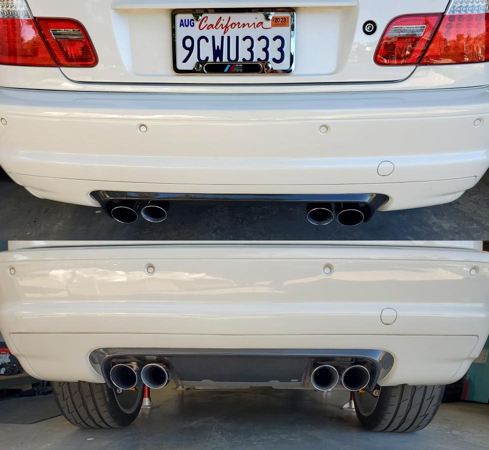

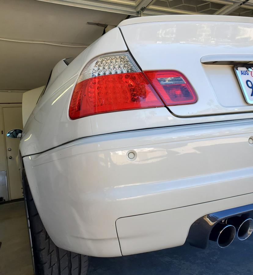

    Once installed, it looks very good.
    Correct.
    That crack pictured above is actually very small, and can't be seen from more than a few feet away.
    The corner gap is a little better on the pass side than driver, but neither is as bad as earlier products pictured in this thread.
    Also, the paint line between CF was very good, better than other pictured earlier ITT.

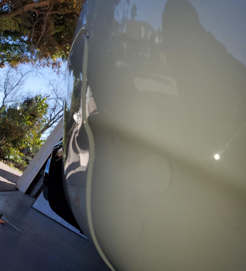

    The orange peel I reference is in this pic, on the far right with the light's reflection. The pooling in the gap is another indication of clear coat being too generously applied and/or intercoat drying time not abided to.
    I'm currently packaging all the issues and will communicate to this René. He needs a chat with his painter for sure. I'll be respraying mine as we're doing a color change, I'll document the steps to get it right.
    Gotcha. Yeah, the orange peel is fine with me..factory paint has it too. I don’t have any plans to do any paintwork in the near future so idk what to do about the excess clear that has pooled up.

    I’m just saying, something doesn’t seem right if many people are experiencing that gap in the top right corner. It’s not enough to bother me, but it is there on both of my cars.
    The waviness is not orange peel. I’m talking about excess clear pooled up at the paint line. Look at the paint like closely in my close up photos. That’s what bothers me the most about the diffuser.

    Hey,

    The waviness is orange peel - it can be a symptom of many things.
    René wet sands and polishes all of these. Considering the pinholes, this is a case of an outgassing clear. It will keep "moving" for usually 30 days or so after paint. This is much worse on fiberglass / carbon parts as the underlying surface is porous.
    I agree with your last assessment: primered it is if you want it perfect! Thank you for the honest review.
    I received the diffusers a couple of months ago, and the pinholes are still present. But again, this is so minimal that it doesn’t bother me. Only the second issue I’ve pointed out is significant to me.
