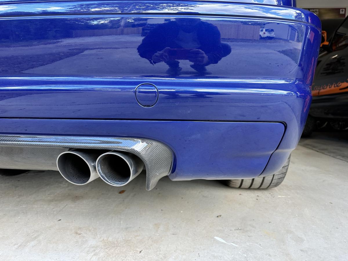

    Finally received and installed today. Overall the fitment looks pretty good to me, the corners don’t fit quite as well as the OEM diffuser (similar to some of the other pictures posted here), but I’m satisfied vs the cheap CSL style diffusers I’ve had on past E46s. Paint match isn’t stellar but it should look a bit better when the car isn’t so dirty/dusty. The paint line looks great though, as does the CF work itself.
