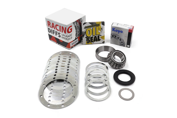

All the parts you need to change gear ratio and even a video tutorial. Let’s get this group buy filled!
Upgrade your BMW differential with our Gear Ratio Swap Set in case you decide to change your gear ratio. Includes essential parts for a successful swap: adjustment shims, pinion oil seal, large pinion bearing, crush sleeve shim, and pinion depth shims. Ensure fitment with VIN confirmation or BMWFans.info. Shop now!

I swapped my stock diff for one w/ a 3.91 BMW Motorsport FD already installed it, its great but now I'm hooked and itching for a 4.10. If I buy this GB 4.10 FD and Pinion I can just swap it into my current differential right? I dont have to swap out the entire unit I mean, just gotta open it up and swap in?
Right you would only be replacing the ring and pinion gears. In the video above they recommend a minimum amount of parts needed to swap.Originally posted by BigRussia View PostIs this GB still going on or closed out already?

that’s a great price! Is the $400-500 labor the quote the Montreal guy is giving you?Originally posted by Epoustouflant View Post
It depends what you’re doing, some guys use the opportunity of opening up the diff to change out the LSD entirely. You will need around 250-300$ in hardware and labor is usually around 400-500$.
The unfortunate limiting factor is finding a shop willing to do this swap, with the prices I’ve been getting quoted it makes more sense for me to just buy the diff from diffsonline‘02 LSB M3 (11k original miles)
