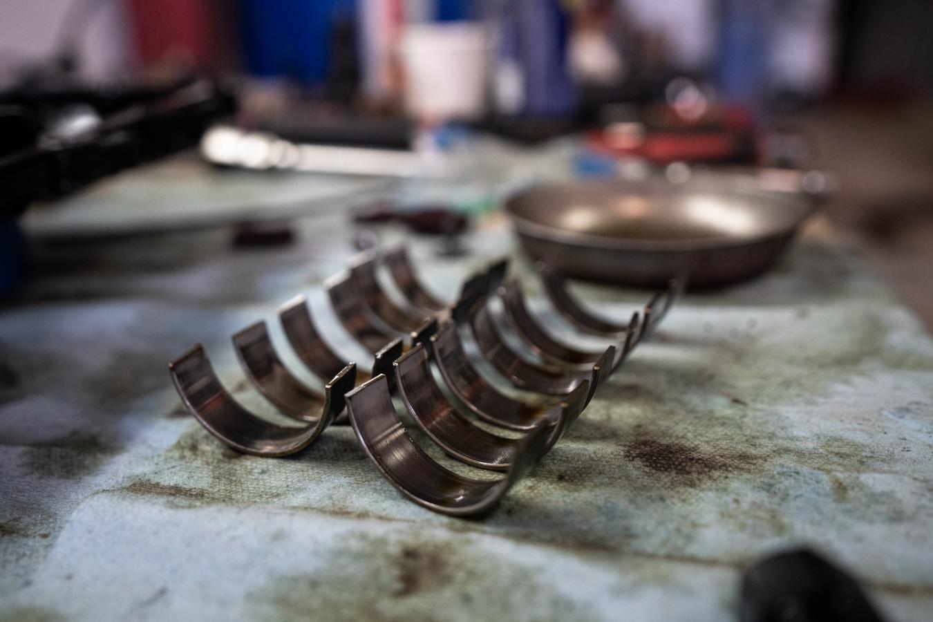

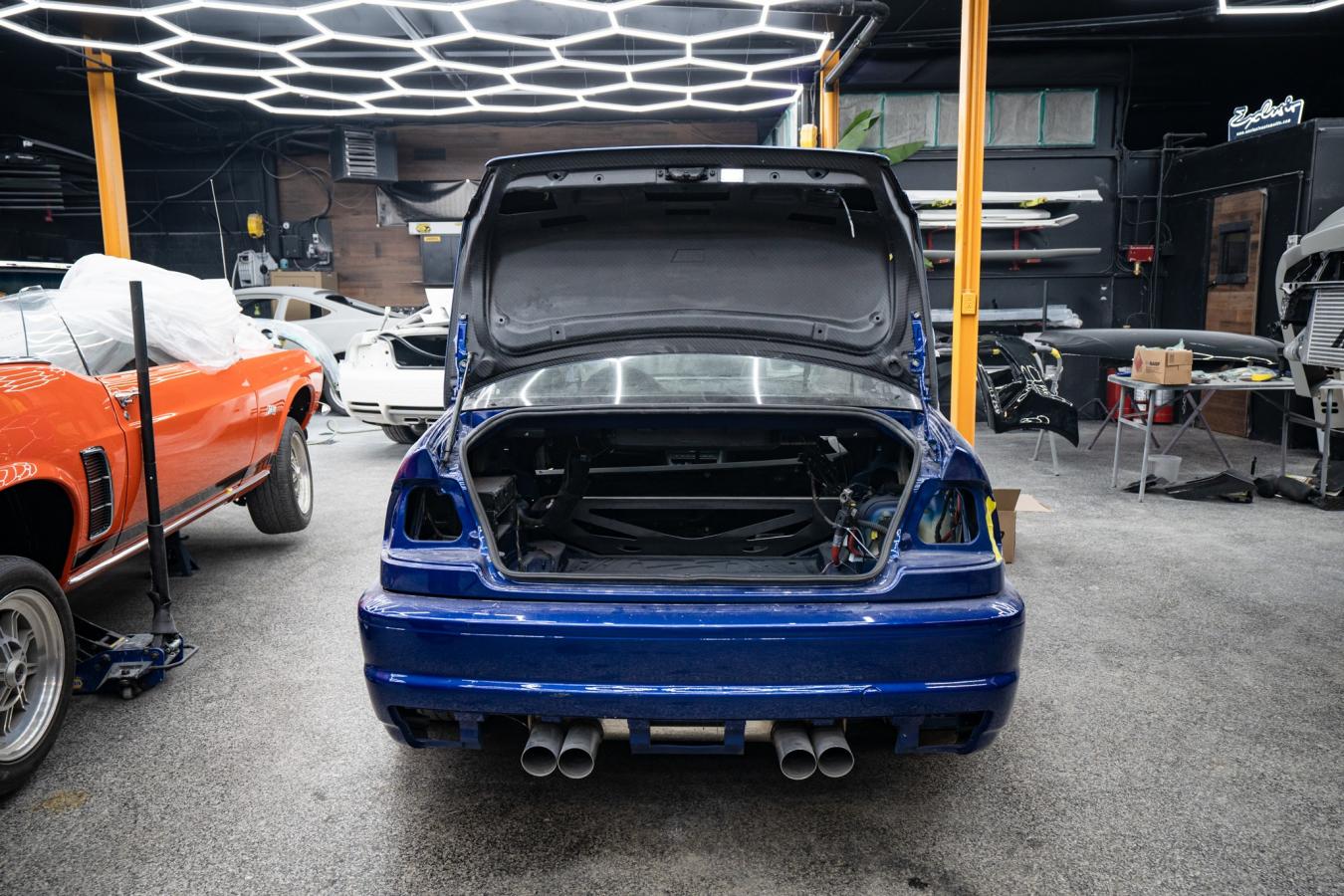

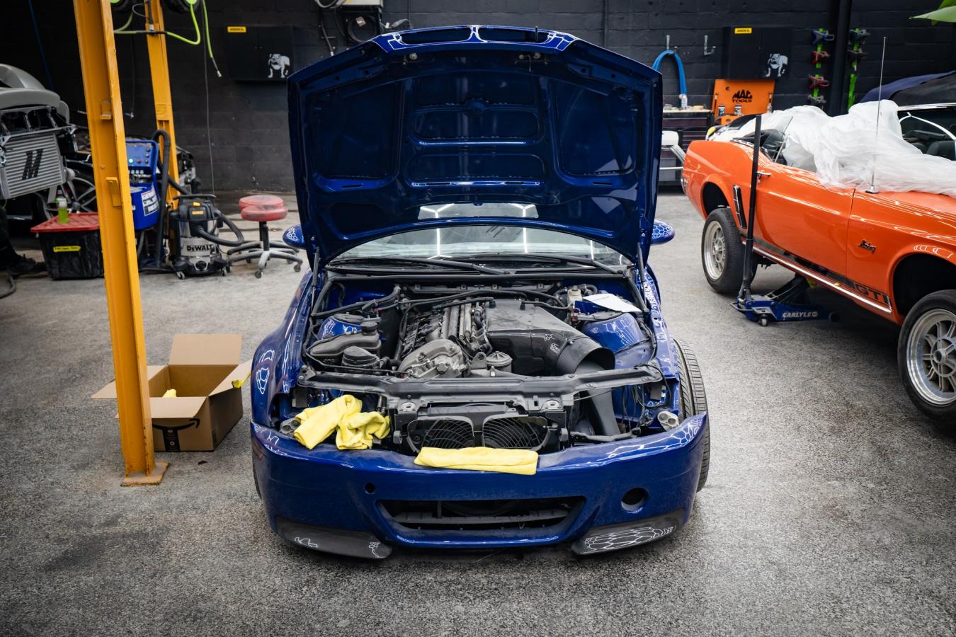

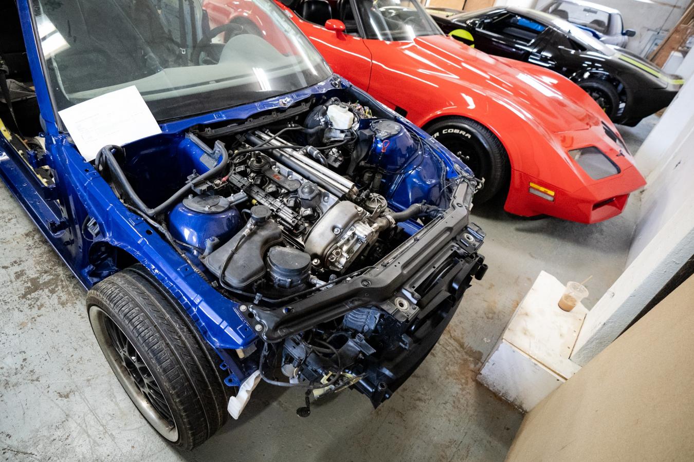

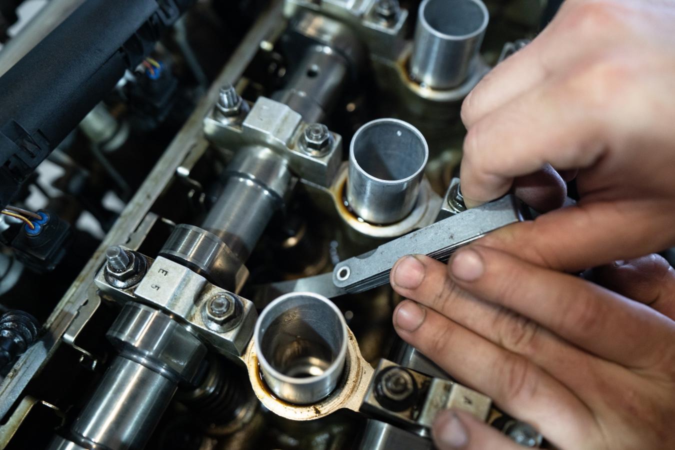

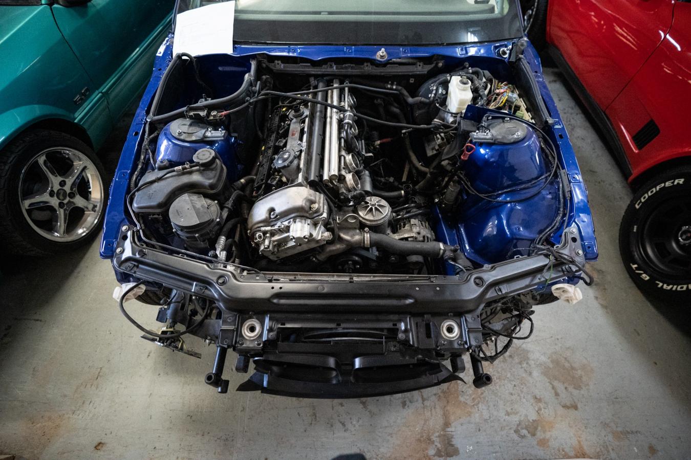

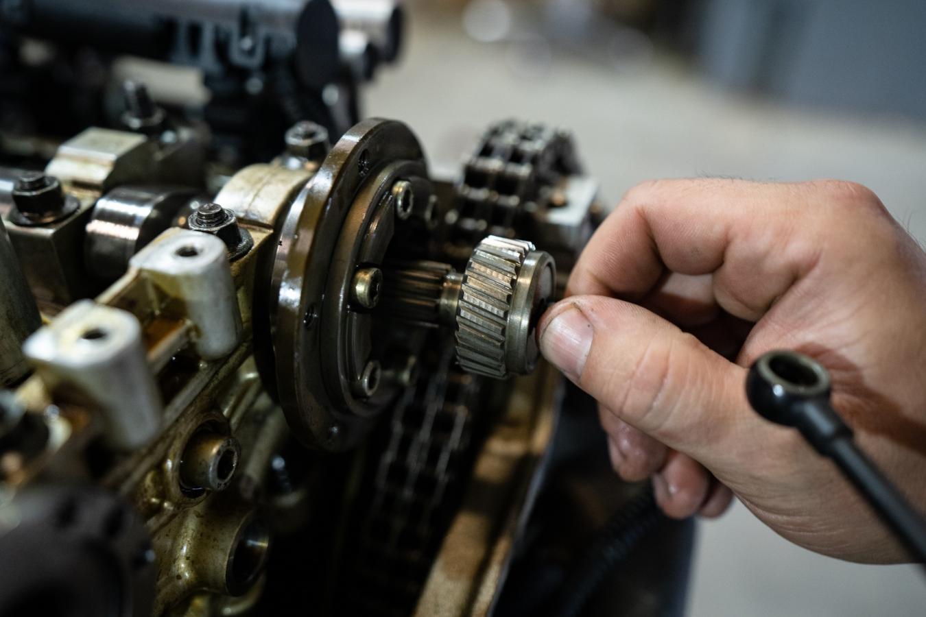

    Engine work is done: VANOS is bulletproof'ed, rod bearings & bolts got swapped, 288/280 cams are in time, valve adjustments done.
    Most importantly, the S54 is back in the chassis. The car will be on the road in 2-3 weeks, maybe - if coilovers, seat brackets and a new top reinforcement kit makes it in time.

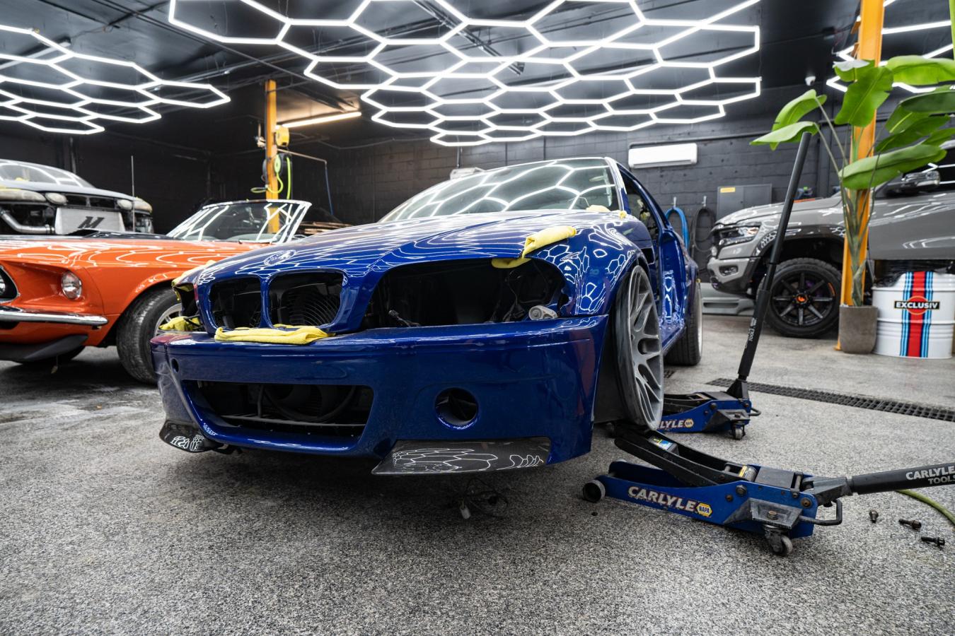

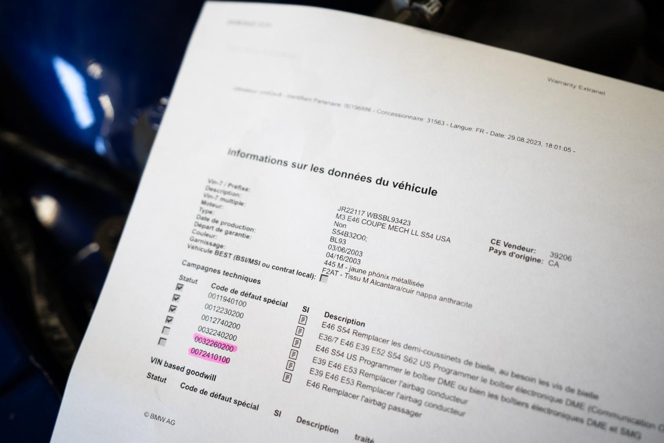

      I need to find time to install the CSL airbox now. I also pulled the recall campaigns off the VIN. Airbags need to get done still.

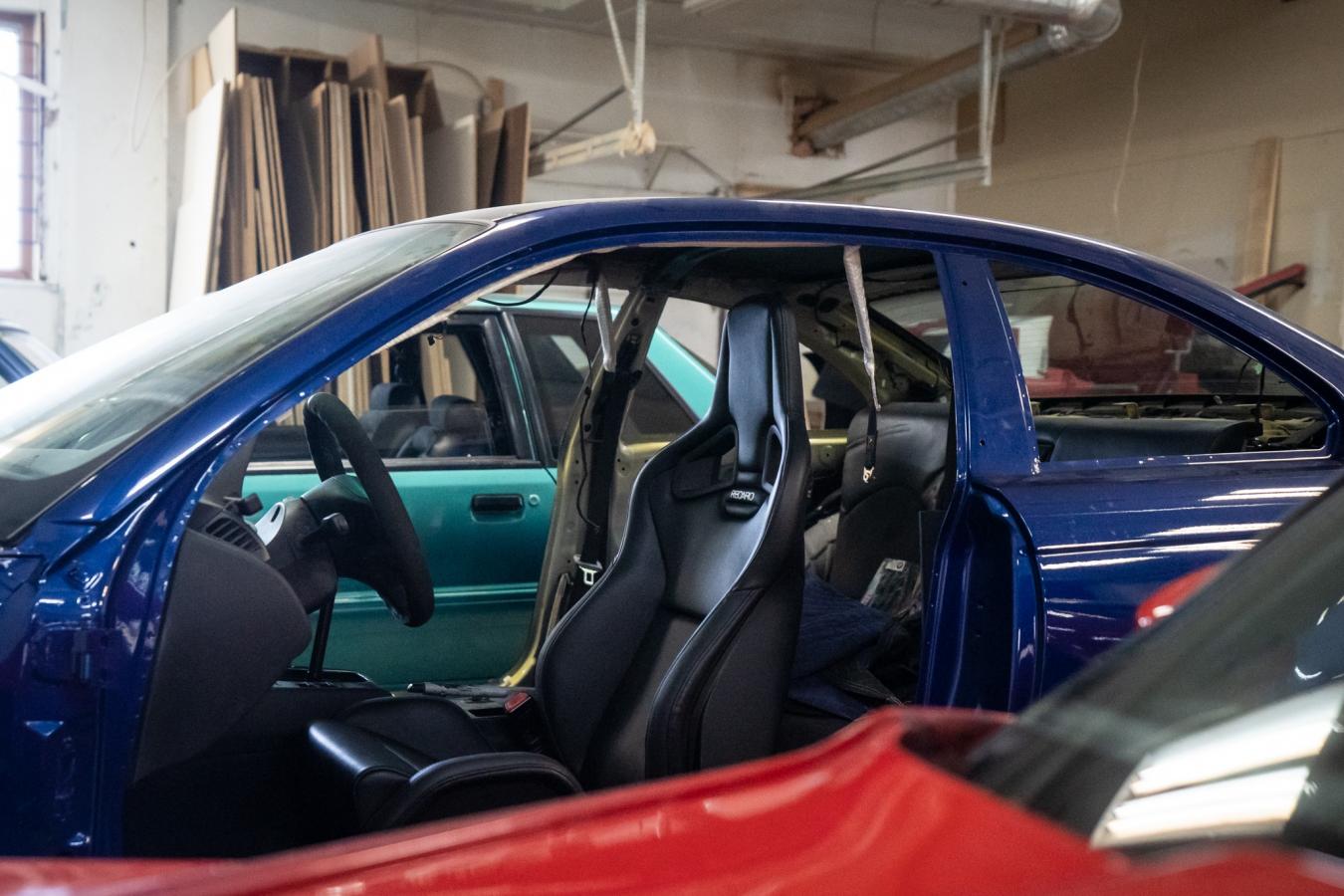

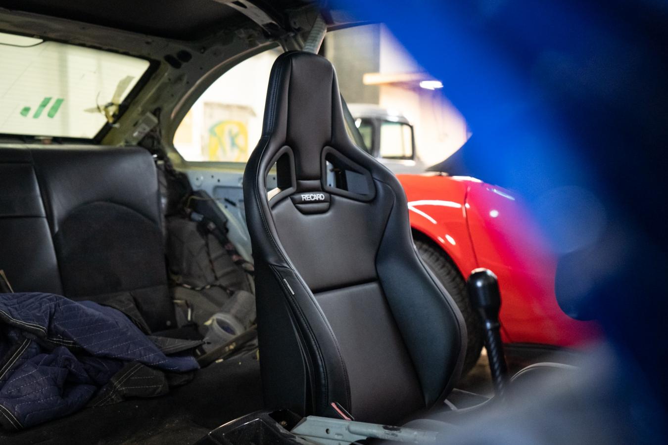

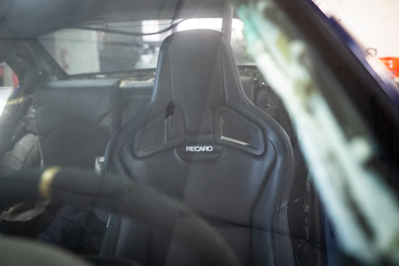

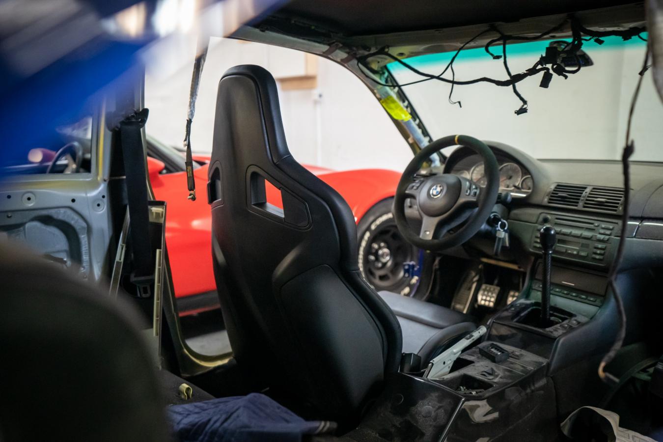

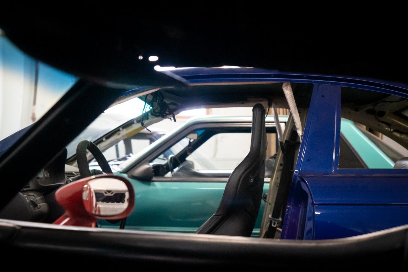

        I tested fitted the Recaro CS and BK mounts. No spacers needed for my height, it doesn't hit the center console like the PP ABE mounts.

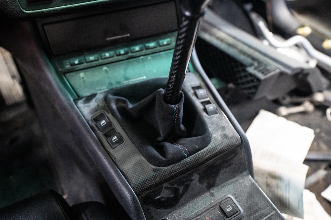

        I also put the OE boot on. It needed to be cut as I was unbothered by attempting to remove the knob off the RTD. I'm working with a company to do a clip-in flat panel that will be upholstered to specs for the upcoming RTD group buy.

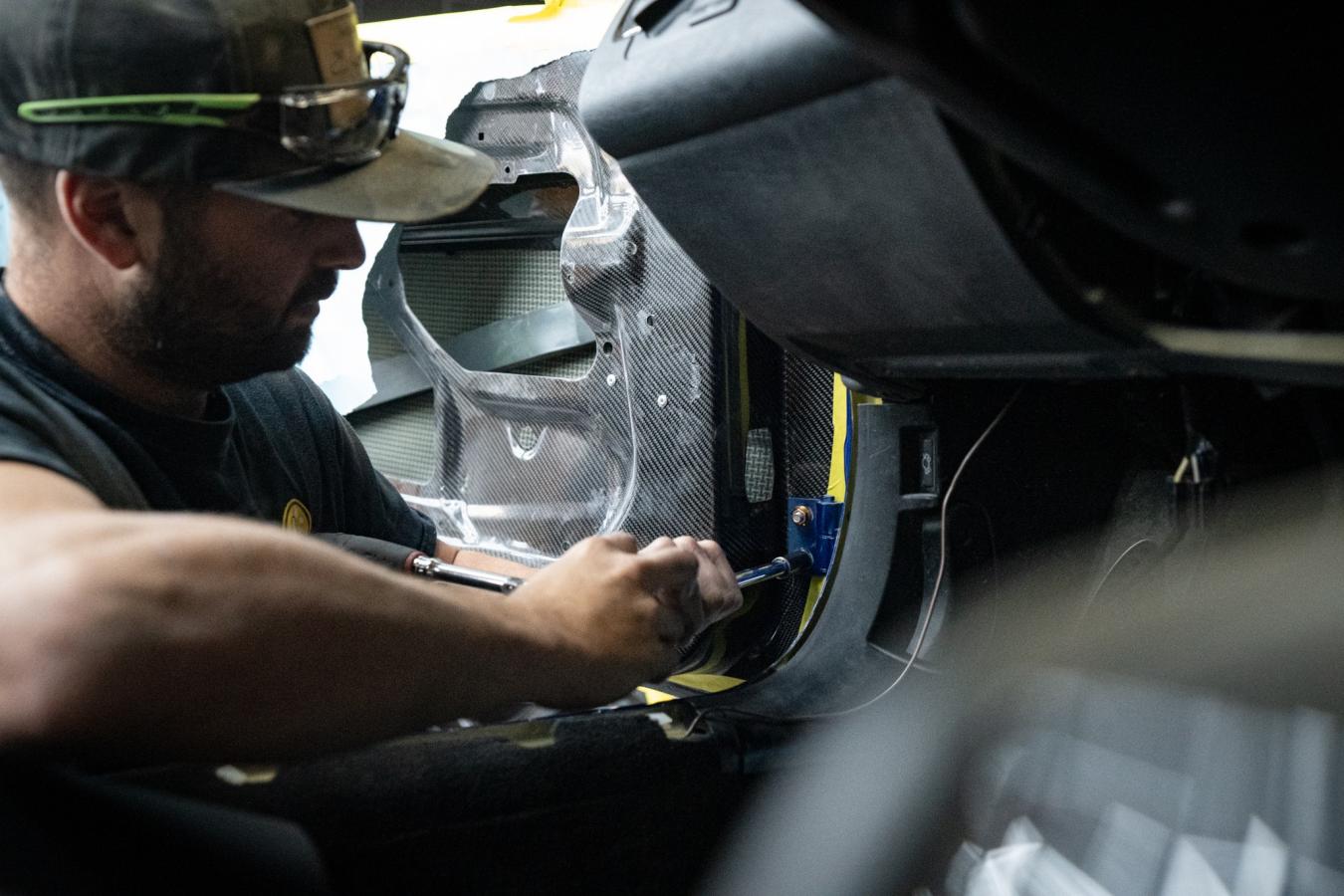

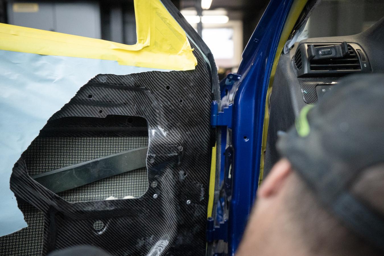

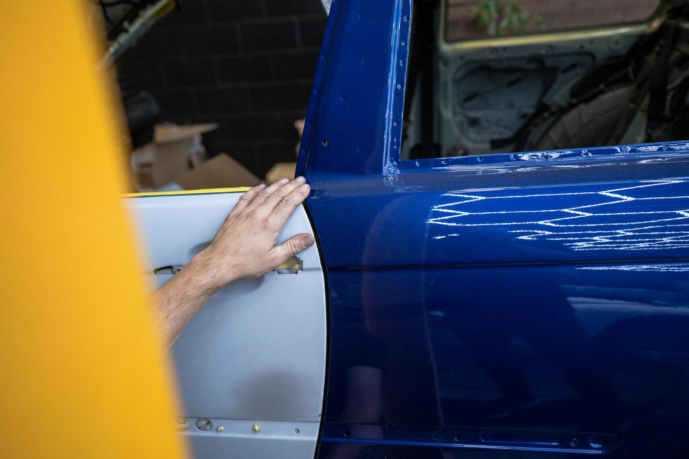

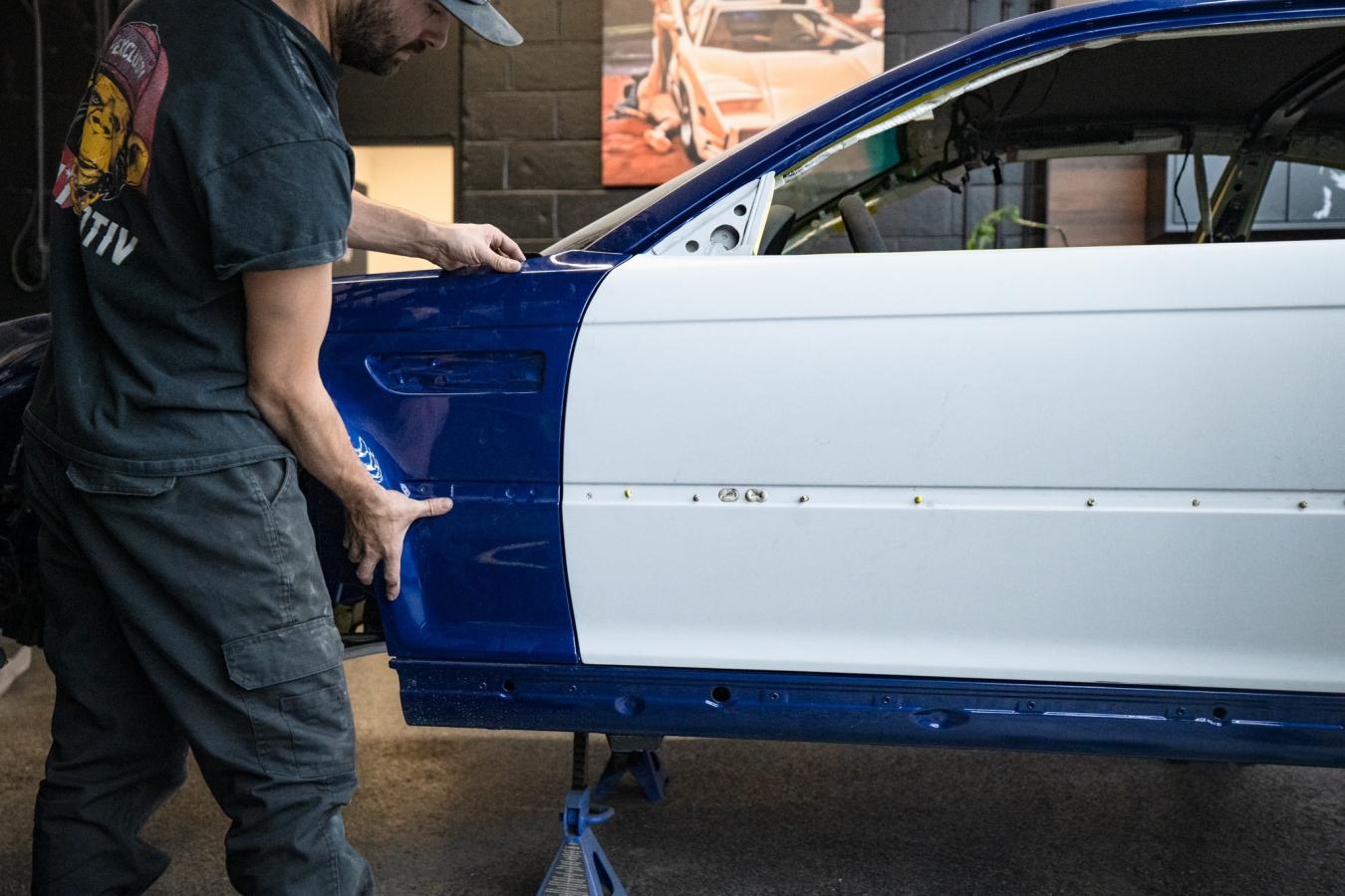

          Special Series: E46 1:1 Carbon Doors
          In this entry, I touch on expectations of OE+ versus Motorsport doors, and we finally test fit the 1:1 OE carbon doors along with the widened carbon fenders.
          I document the gaps, and body line alignments along with insights on how doors are aligned.
          We were pretty stoked about the final fitment.
          Up next: It's time for the last round of paint on the restoration and color change.
          We'll inspect the finish quality we achieved, along with interior accessories fitment, and my final impressions on the door’s feel.

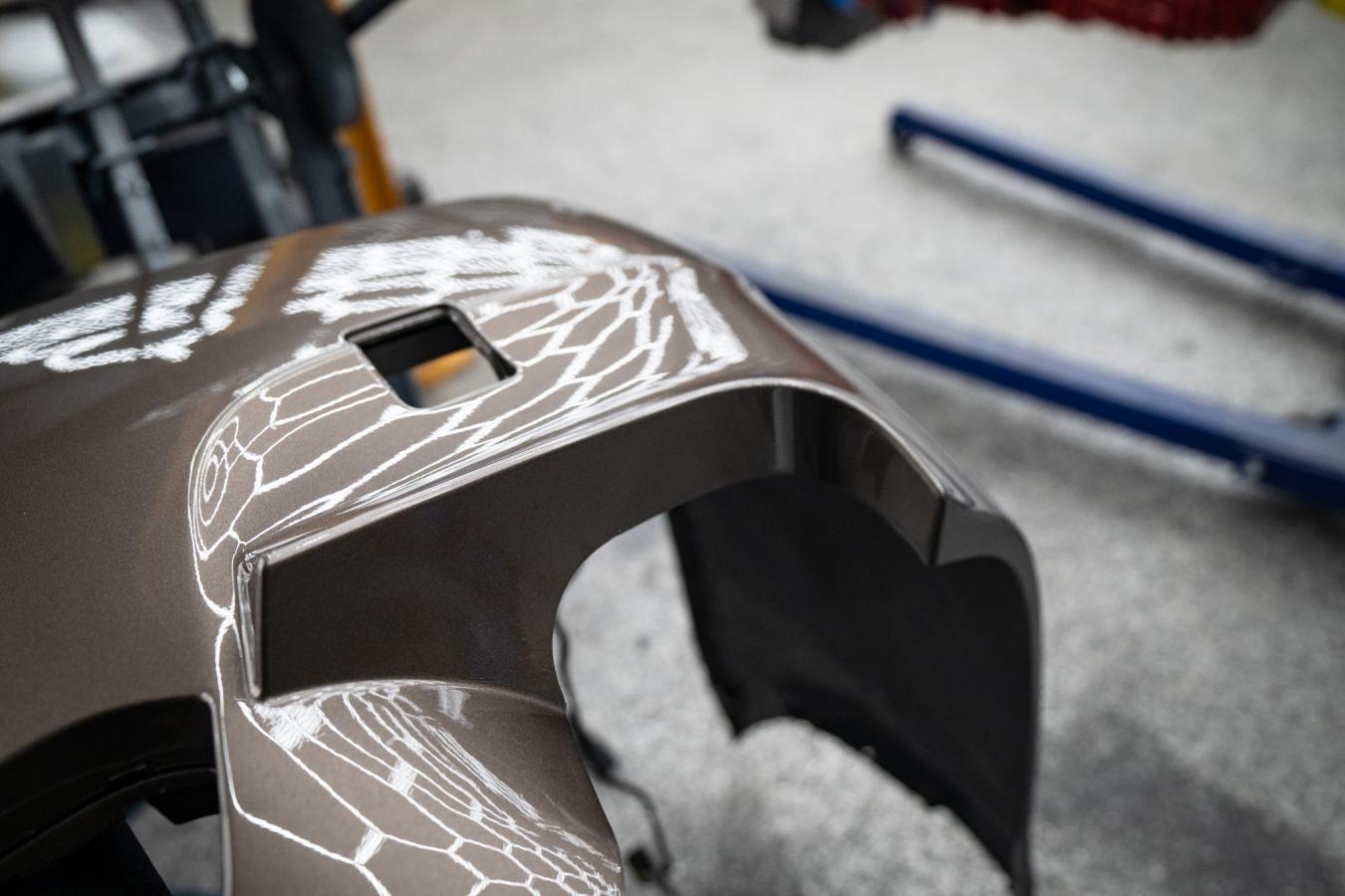

            Maybe this is a dumb question, but we've been on the subject of body shops in another thread and it makes me wonder, how are you going to match all the pieces fully when they're not being painted at the same time? I assume you have this thought out, and clearly with a build like this, anything but an exact match won't fly. I'm curious if you have a bunch of extra paint pre-mixed and stored (how long does it last?) or how that works. I think everyone I know who has done a big build like this has painted the car and all the parts all at the same time.
            '01 M3, Imola/black

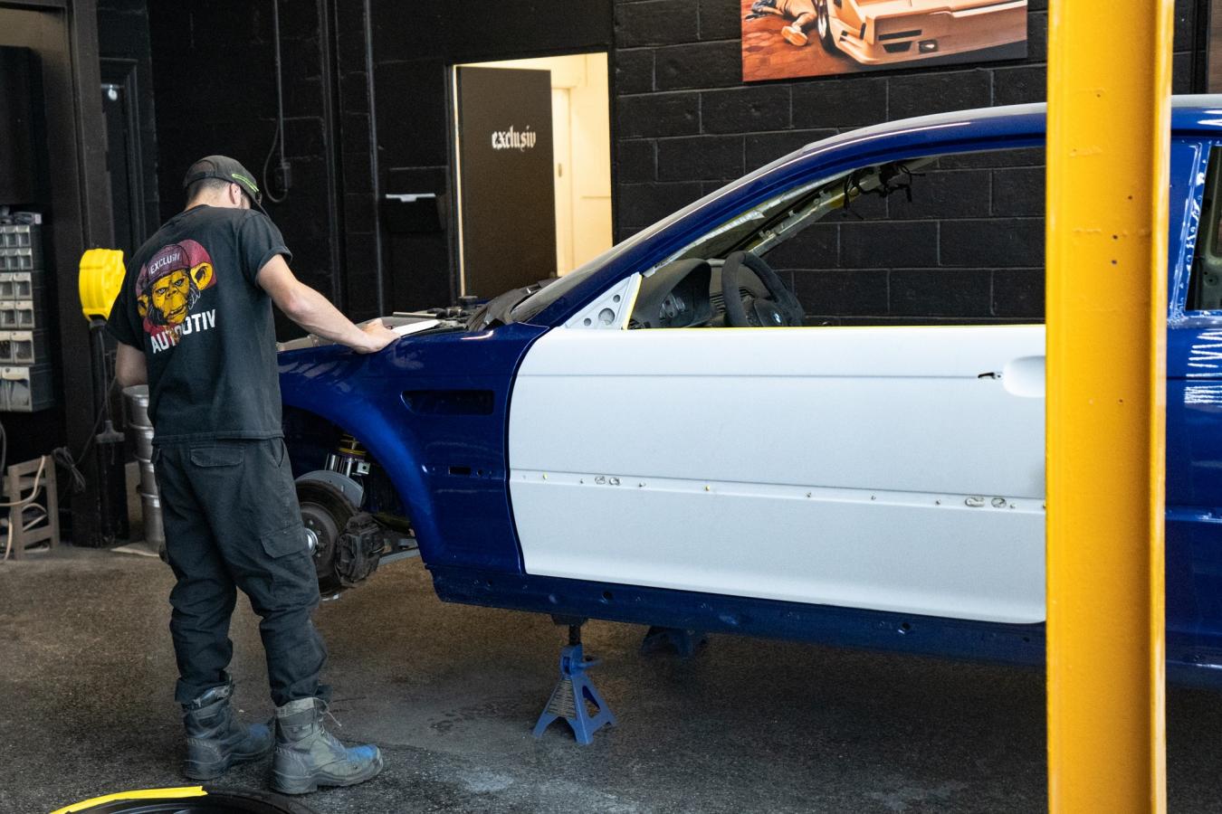

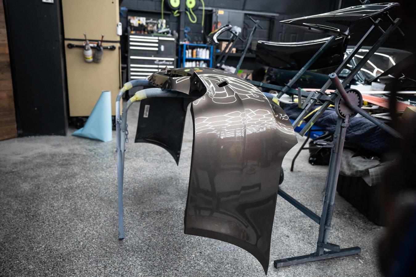

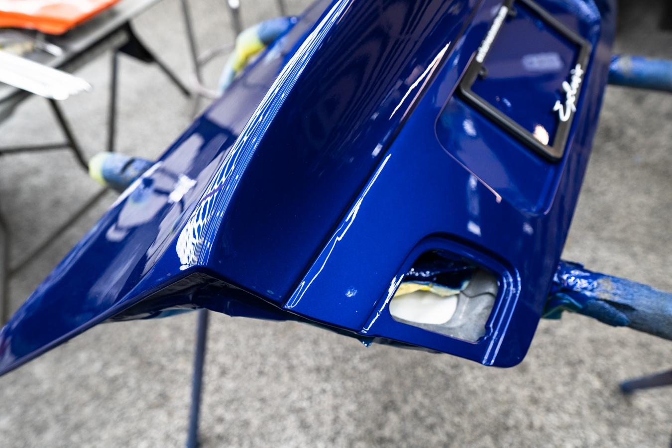

              It's actually a great question. There's lot of opacity when it comes to paint work.
              In short, the issues that come up with color matching will usually arise from cars that have seen UV exposure and use different products, across different panel materials.
              Here, the color fornulas stays the same using the same BASF pigment with the same preparation work across every single panel along with using the same spraying methods & overall thickness per color and clear coats.
              As an example, for color matching, the shop usually uses a gas cap to match. It's what we did this week on my M5's rear bumper.
              Click image for larger version  Name:	_DSC3175.jpg Views:	0 Size:	105.8 KB ID:	239667
              Click image for larger version  Name:	_DSC3170.jpg Views:	0 Size:	174.9 KB ID:	239668

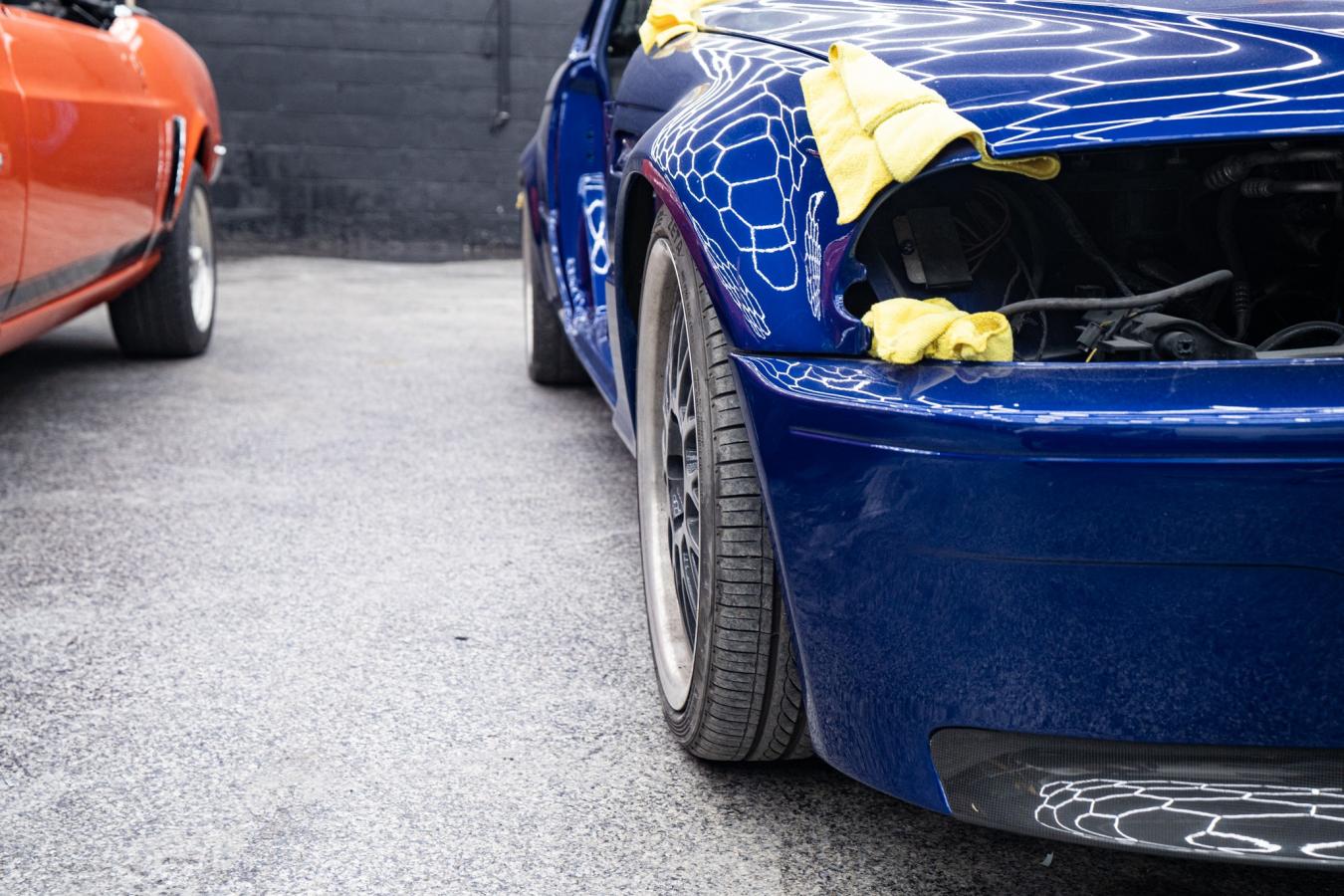

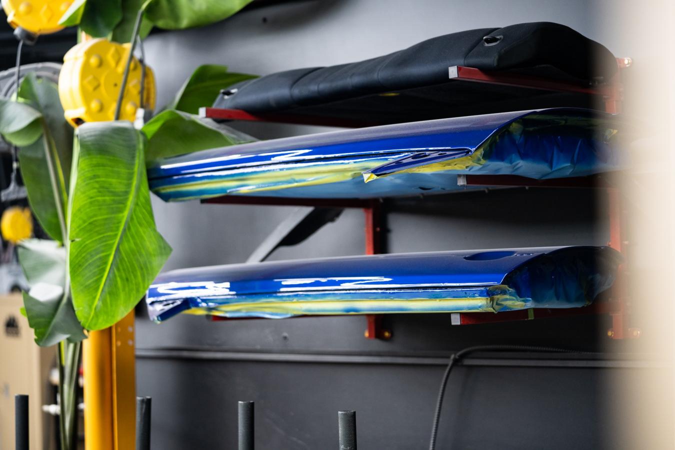

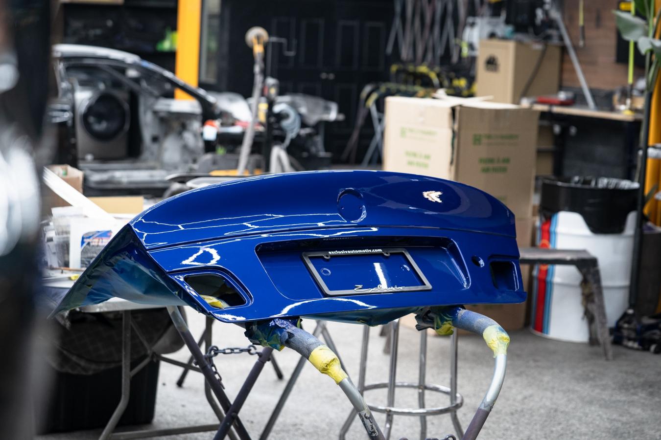

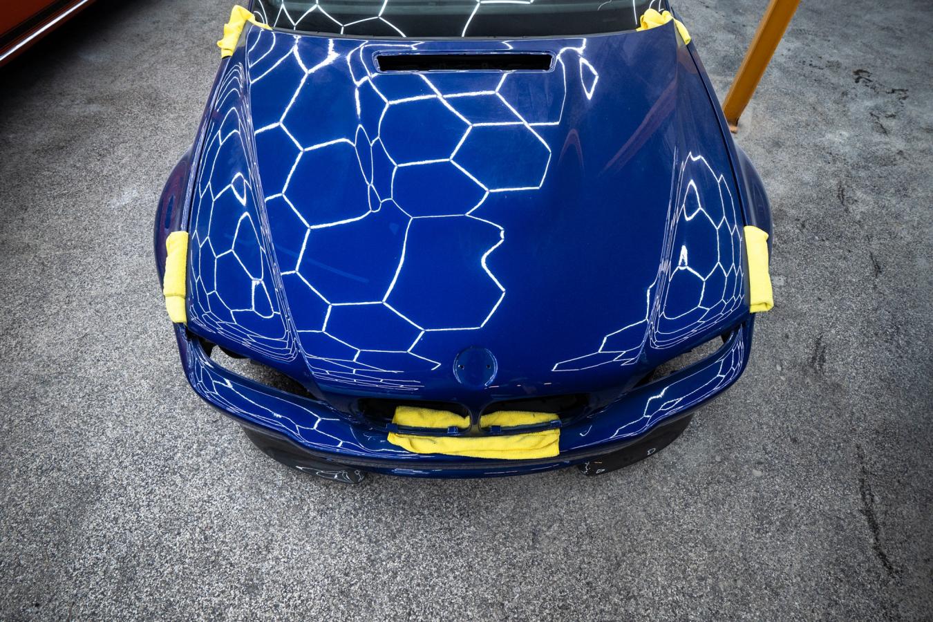

              The doors and other panels have been sprayed and clear coated.
              The issues we've faced came from surface contamination of carbon panels, notably the trunk. No matter how careful we prep'ed it, it seems the gel coating used in the CSL trunk's mold led to surface contamination - commonly called "fish eyes". I haven't had much luck when it comes to Karbonius' gel coat, we had similar fish eye issues on the roof's original clear coat.
              We had to sand down the clear across the hood, trunk and doors to re-clear again, eliminating the issues. We did the same to the roof previously over last Winter.

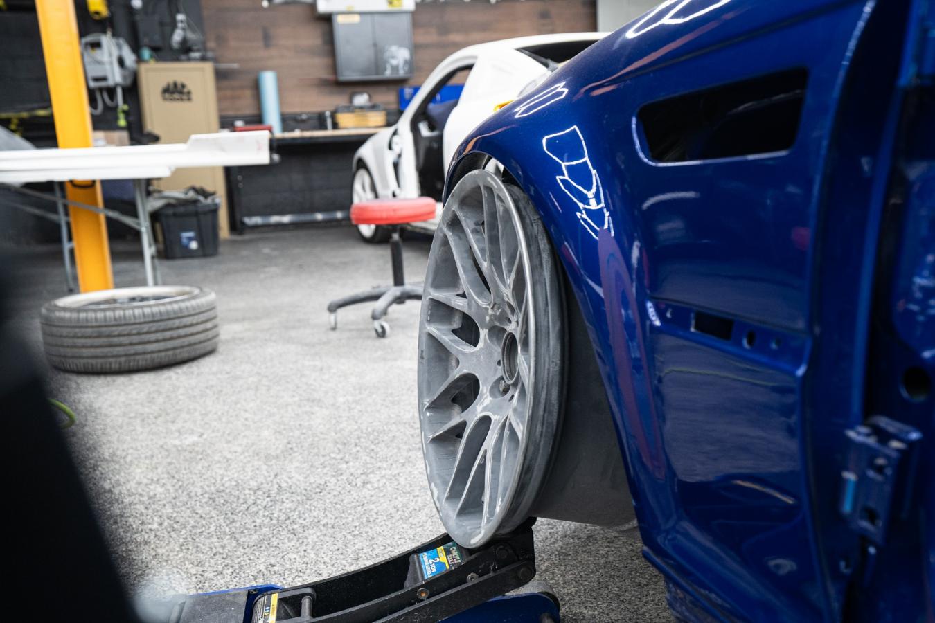

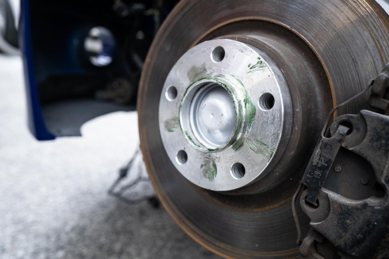

                Special Series: Widened Carbon Fenders
                Link to the full entry.​

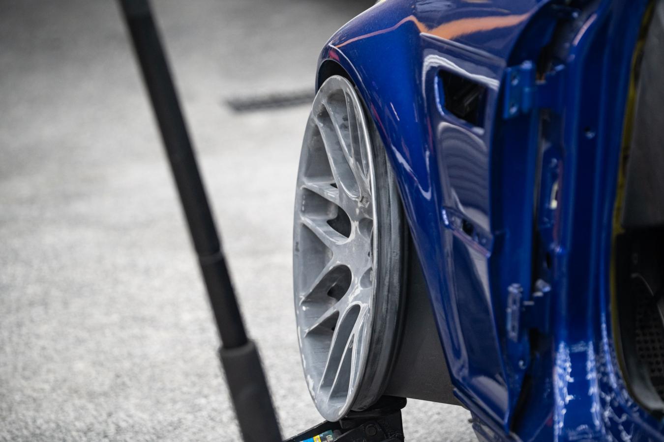

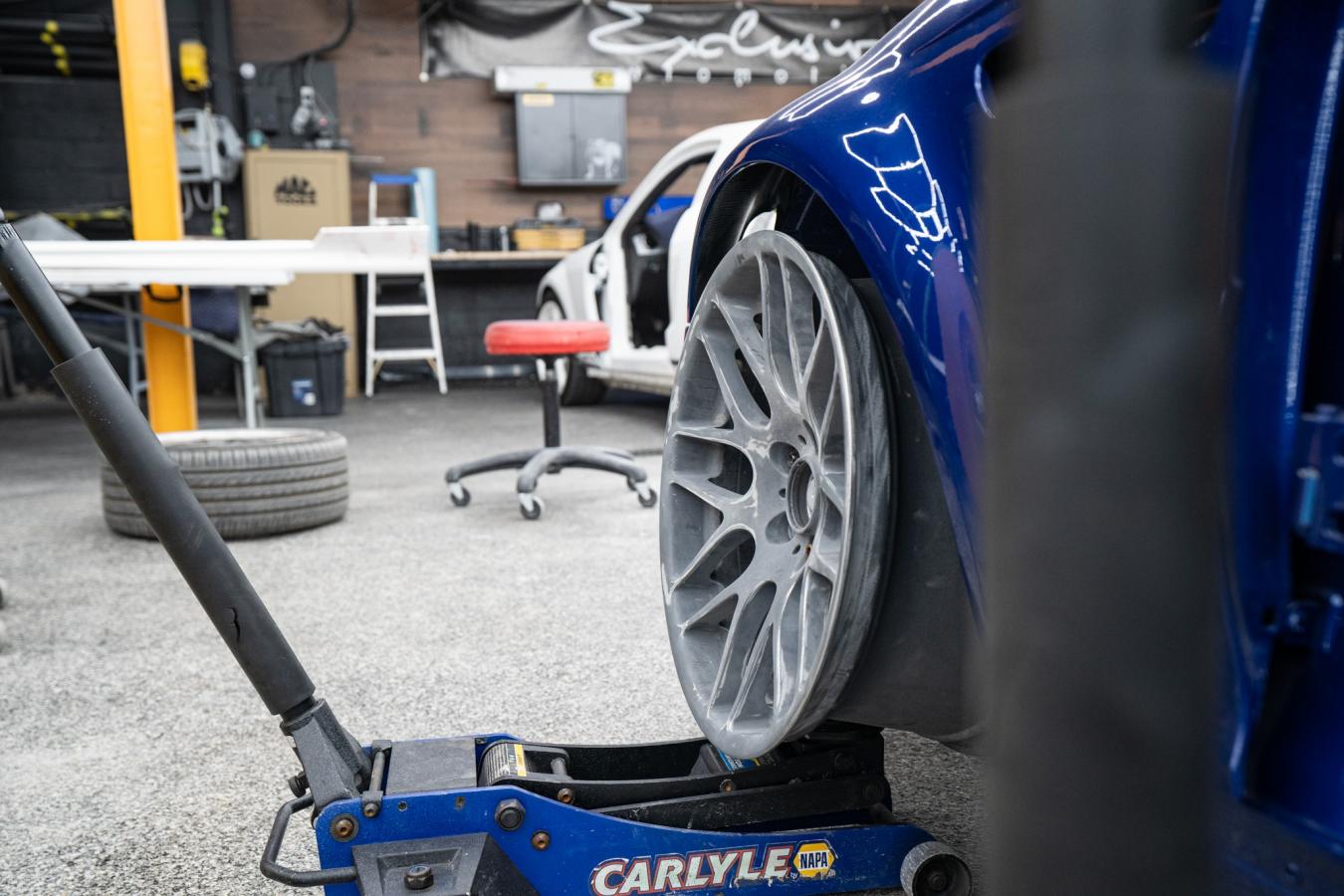

                In this entry, I explore new wheel fitment possibilities opened up by the wider fenders in preparation for the 163M CSL style forged wheel program.
                I include fitment tables and in-depth specs, and future fitments I want to explore.
                See below for the preview. You can spec a set of widened fenders year long here.
                The first set of prototype, raw forged CSL style wheels are (nearly) here .
                Up next: we do the final fitment of the fenders during re-assembly, and we revisit the wheel fitment with tires mounted.
                Cheers!
                Matt
                @m3_epoustouflant​

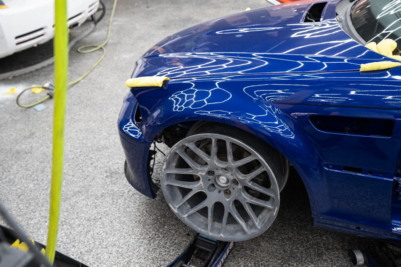

                  This pic looks dope, you can really see the increased track of the fenders here.
                  Can't wait to see this beast come together.
                  2004 Dinan S3-R M3
                  2023 X3M Competition
                    This pic looks dope, you can really see the increased track of the fenders here. Can't wait to see this beast come together.
                    Thanks dude 👏
                    Here's another that I find not too bad - it'll be fun to have a side by side versus an original car.
                    Click image for larger version  Name:	_DSC3599.jpg Views:	0 Size:	281.8 KB ID:	241060

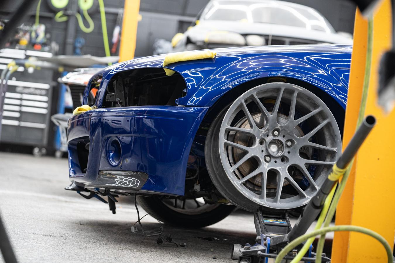

                      Progress is being made - fast. You got to love the deserts and autobahns of a build process.
                        can't wait to see what this tips the scales at when the dust settles.
                        /// 2004 SG/IR - Build Thread

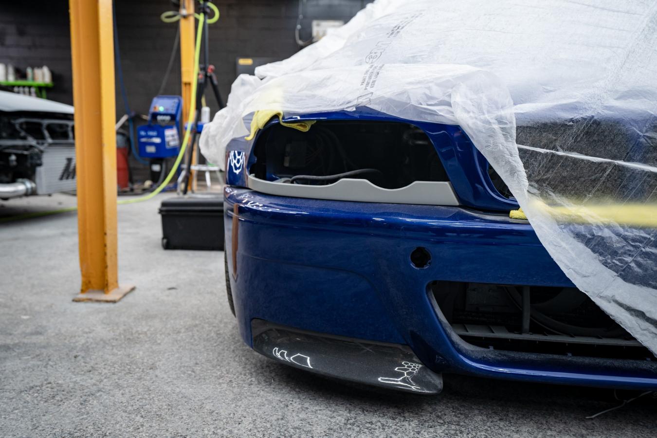

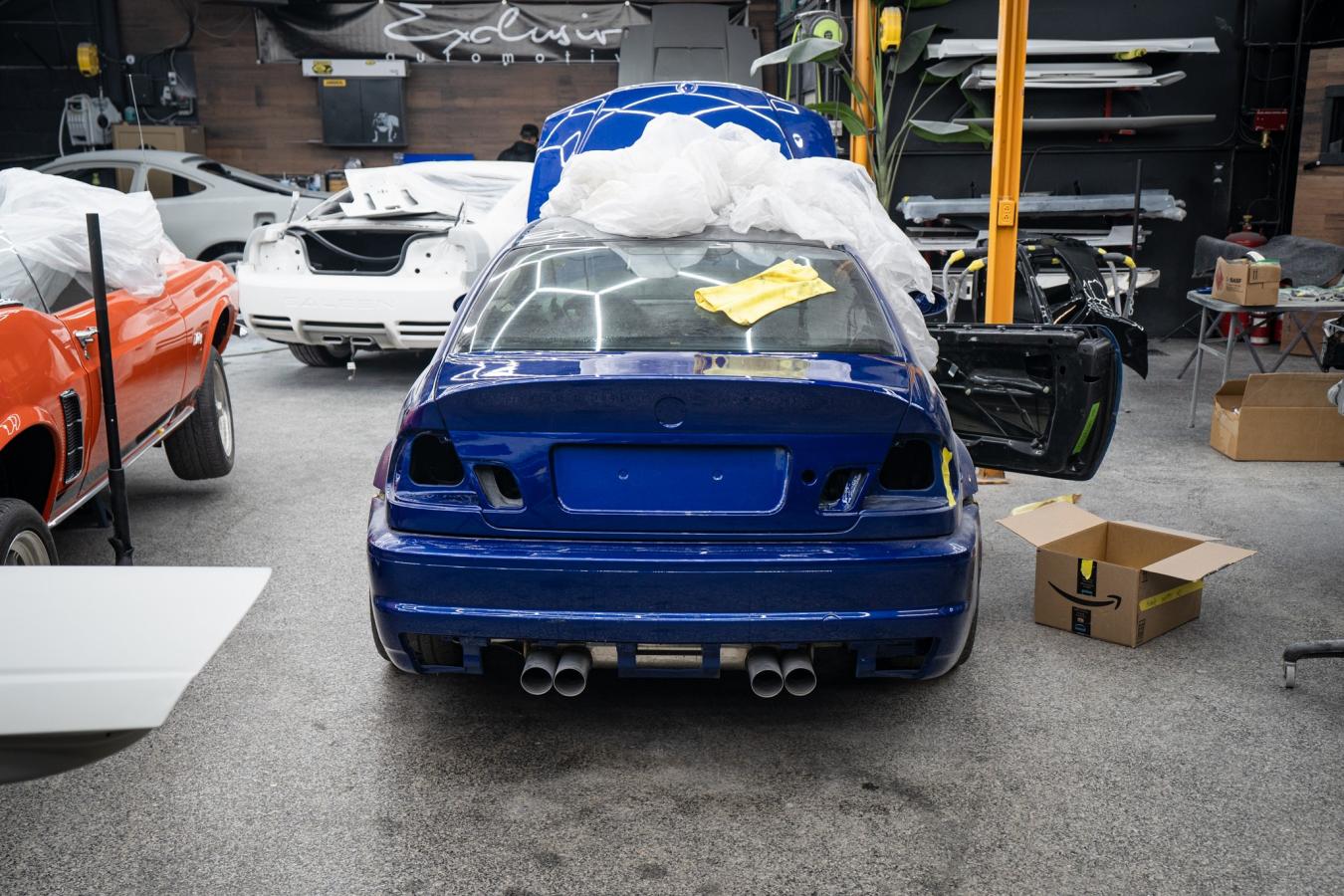

                          Always loved putting my cars back together after a full respray. Some say it’s the bumpers and hood installed. For me something about getting to the windows, lenses/headlight/taillights and exterior trim you can really notice a large completion of how it’ll look imho. Something about the sparkle and filling in the silhouette.
                            100% - it isn't a car until it's got its eyes back!

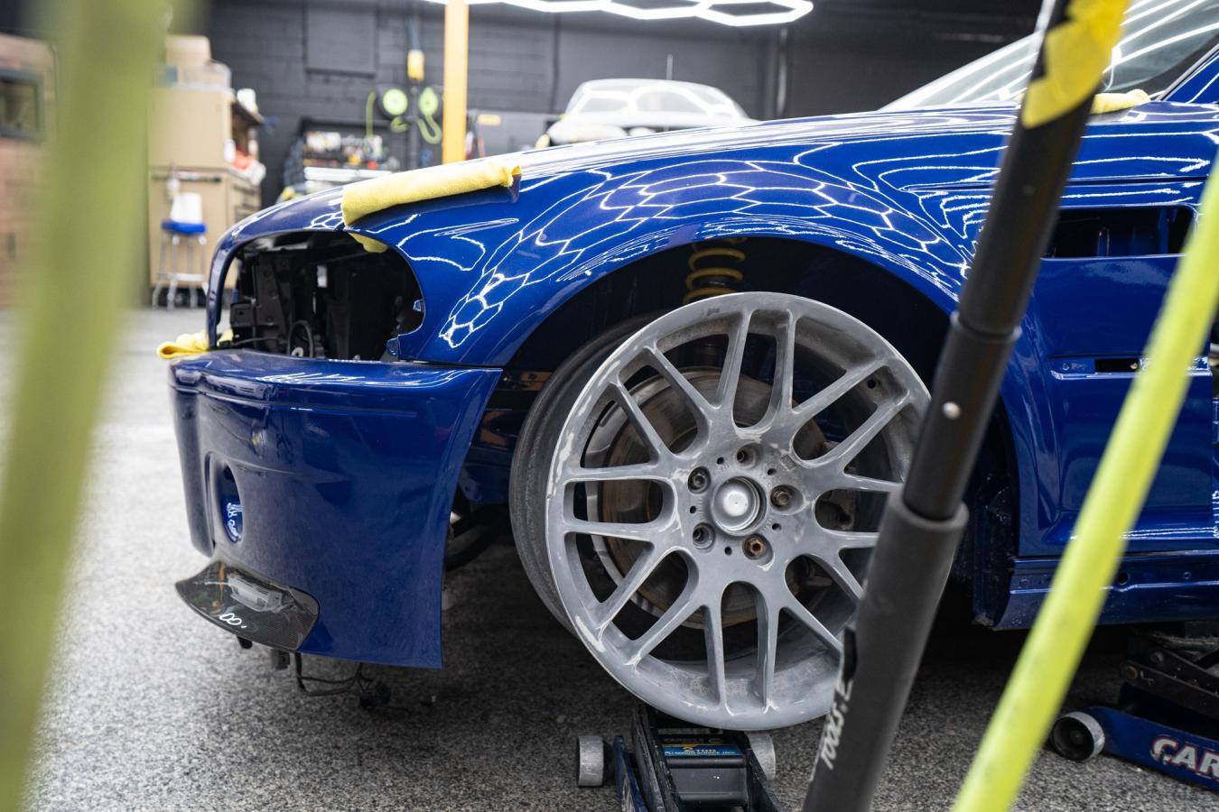

                            We nipped and tucked them up a bit.

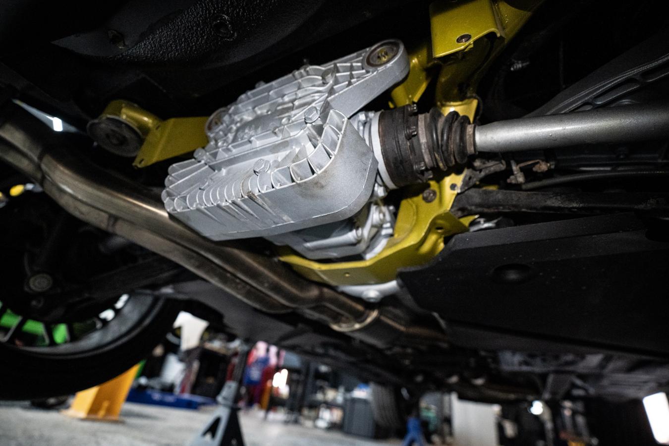

                              Everything looks good Matt, I don't agree with the yellow carrier though.
                              Looking forward to this more interesting build.
                                The subframes? I was 100% people pleasing, old habits.
                                Thanks for the feedbacks, appreciate you.
