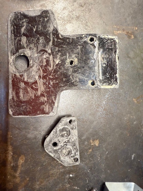

    Swapped in four new strut bar nuts (31316769731) since the printed bracket design uses the stock studs.
    Much to no one's surprise, I pulled out the aluminum threads holding one of the timeserts in. I'm pretty sure this was the hole I messed up badly, so it was only a matter of time. No big deal though, I left a tooon of material around those holes, so even with a bigsert (~12mm OD on the exterior threads), there's still ~3mm of wall thickness at the thinnest point. Cross section for reference:
