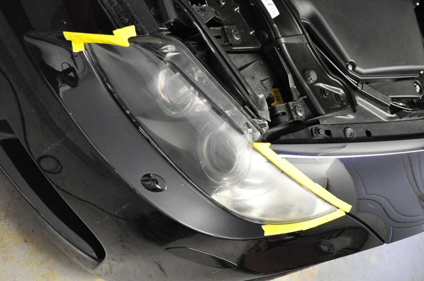

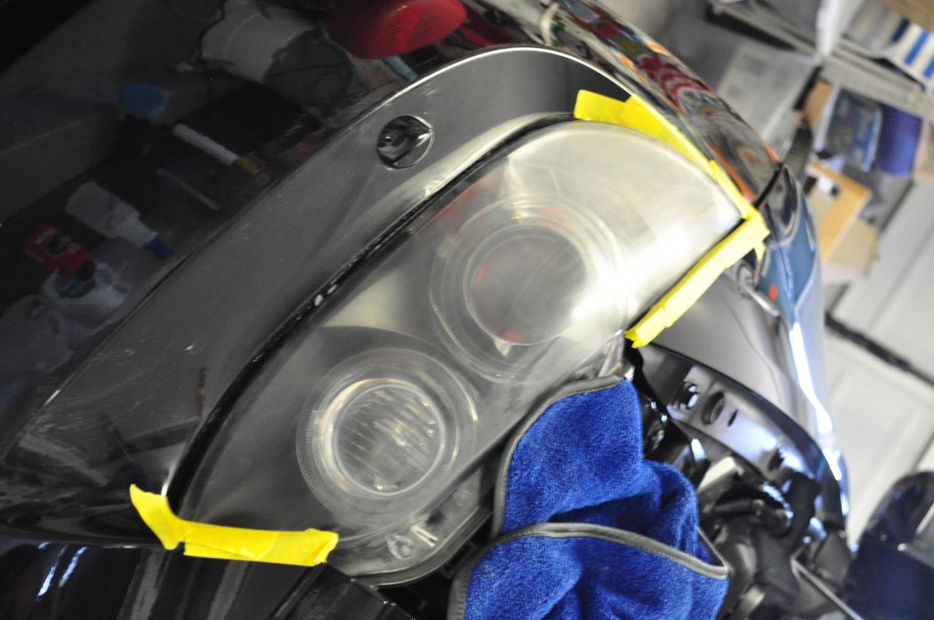

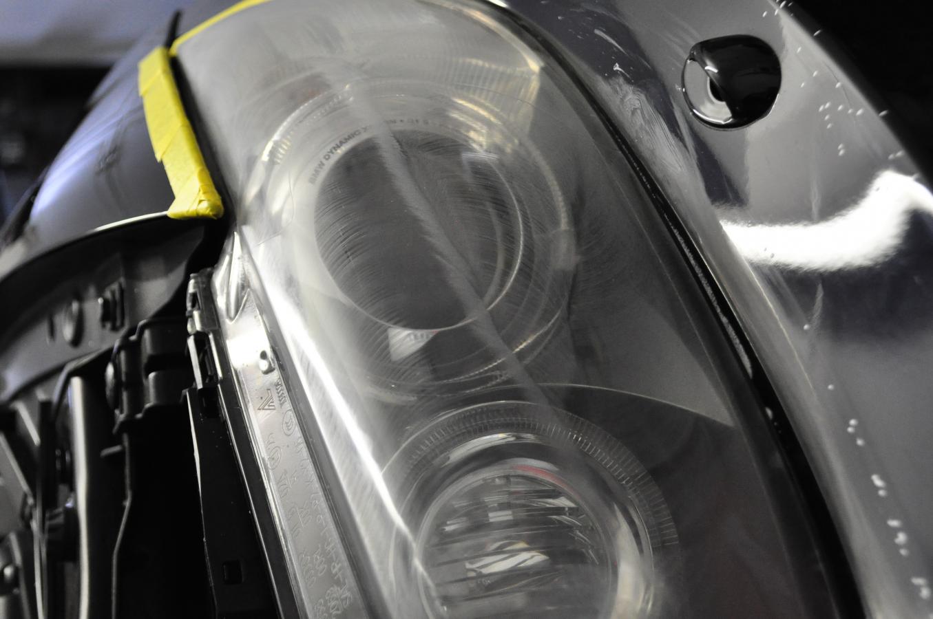

      Front end restoration. Wet sanding the headlights, then polishing them and the front bumper/grilles.

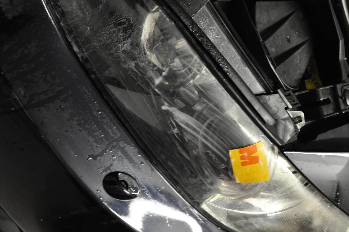

      The headlights were in surprisingly bad shape for a 48k mile garaged car, particularly the driver side. I was warned not to dig too deep so as not to ruin the UV protecting layer. And you can't simply replace the plastic lens like you can on the E46. However, the damage was severe enough to need to level the plastic. I figured with the car being out of the sun a lot, and with my periodic polishing, I'd be able to keep the headlights always looking pretty new, and avoid having to replace them, so I went forward.
      (Pardon the orientation of some of the photos)

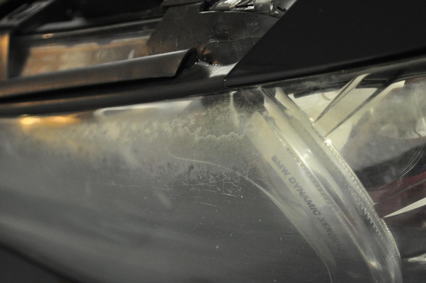

      Existing condition:

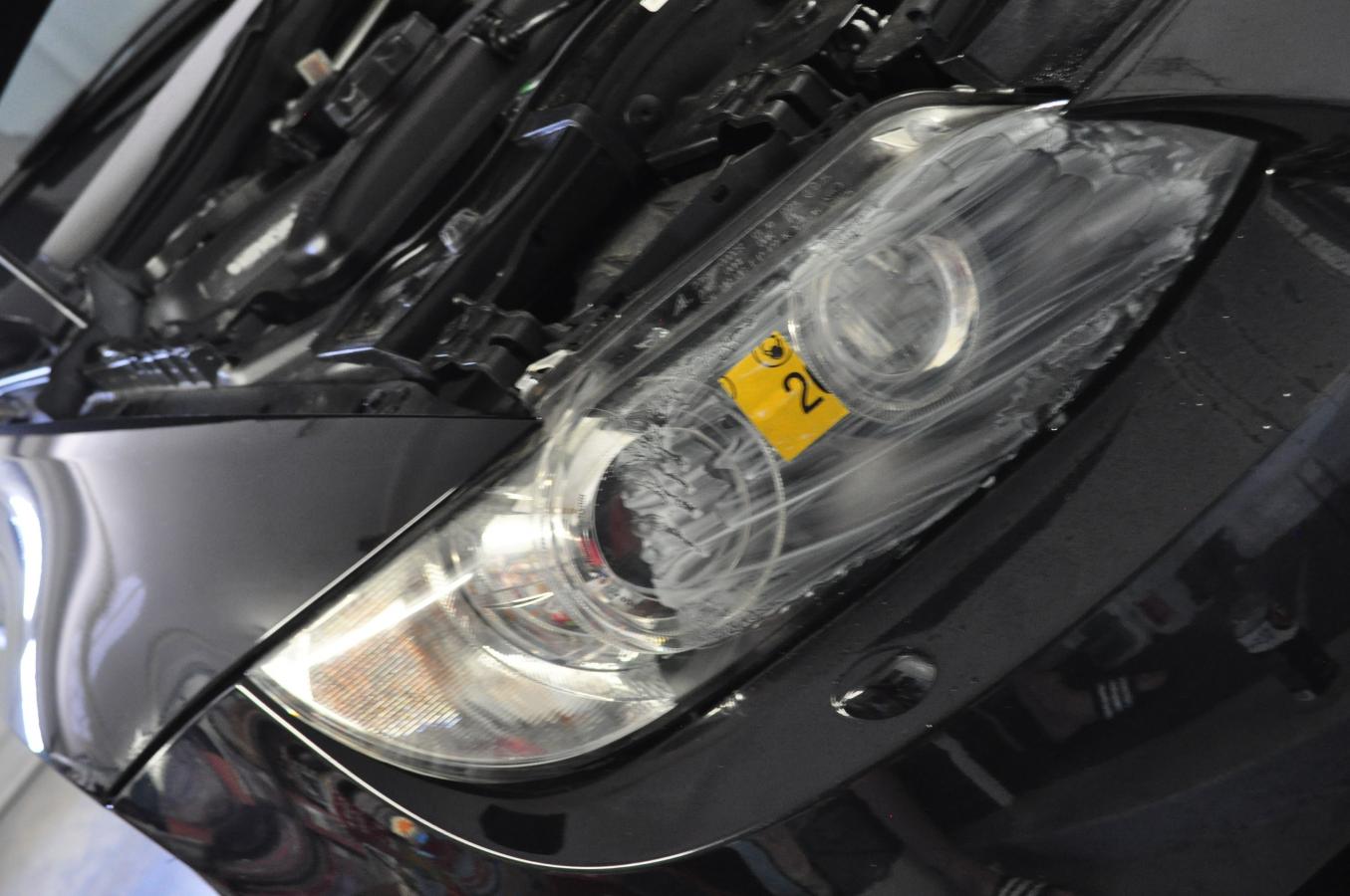

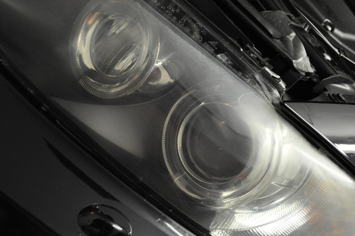

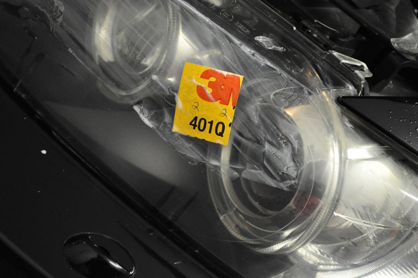

      And go
ID:	188255 Click image for larger version

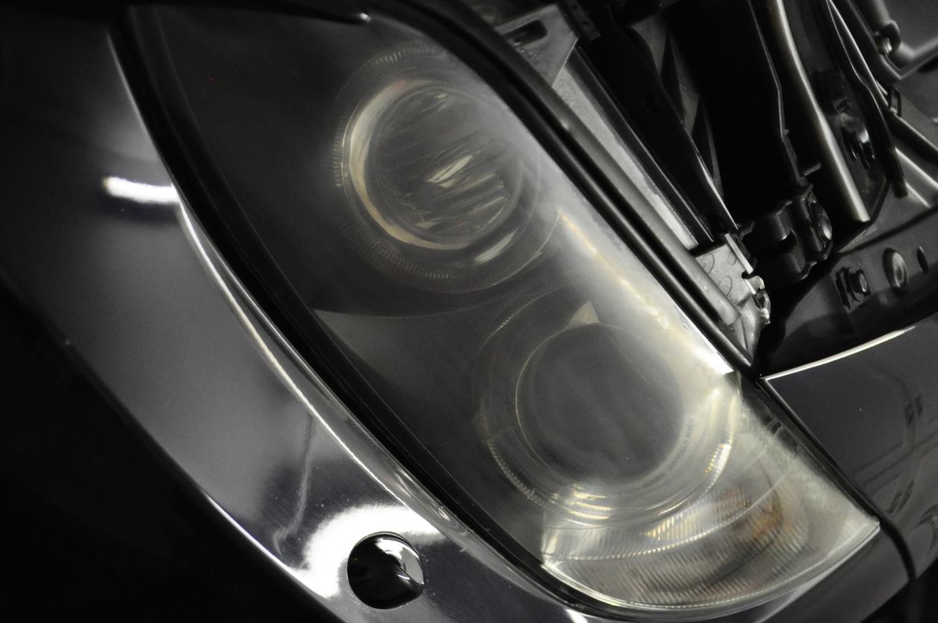

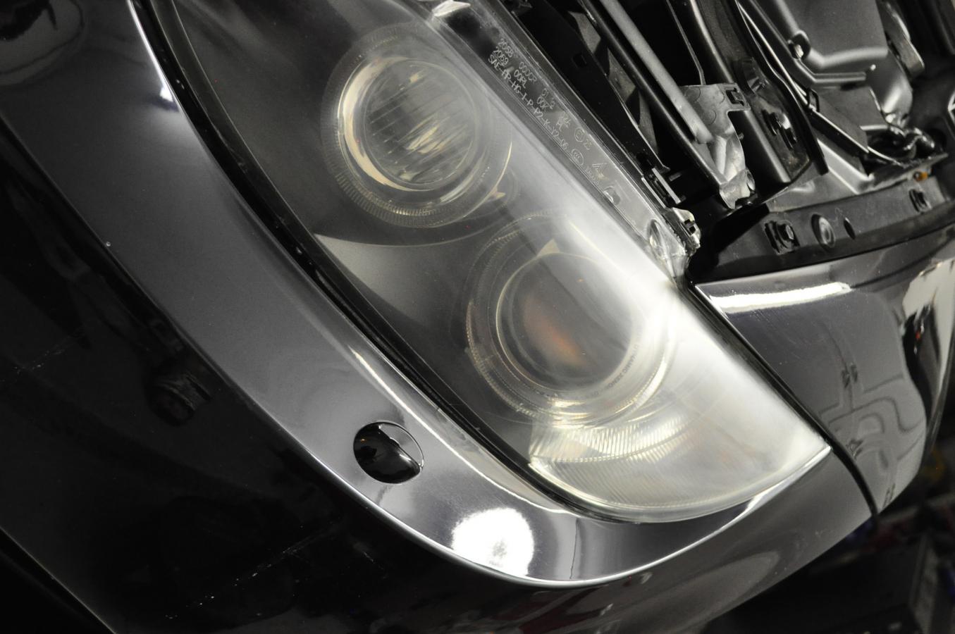

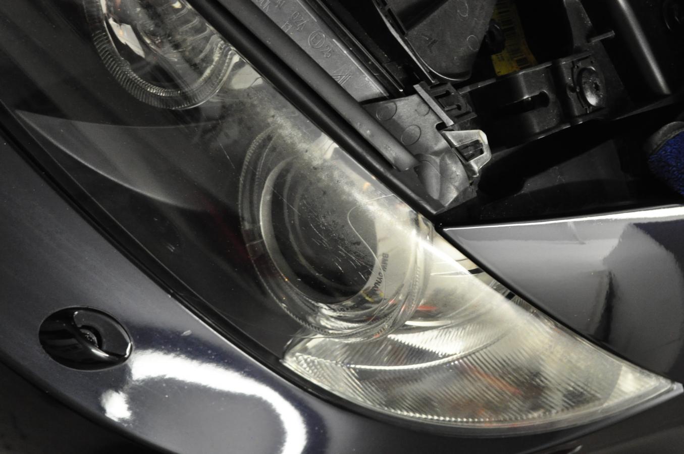

      I would go for a bit, then check my work. I probably could have stopped here, and it would have looked great after clearing it up, but I still saw fading and scratches that went deeper still, so I went a bit farther down
ID:	188259 Click image for larger version

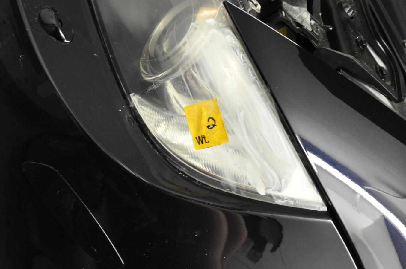

      Then moved to the corner, which wasn't as bad and didn't need as much sanding

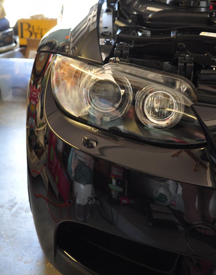

      Passenger side was faster

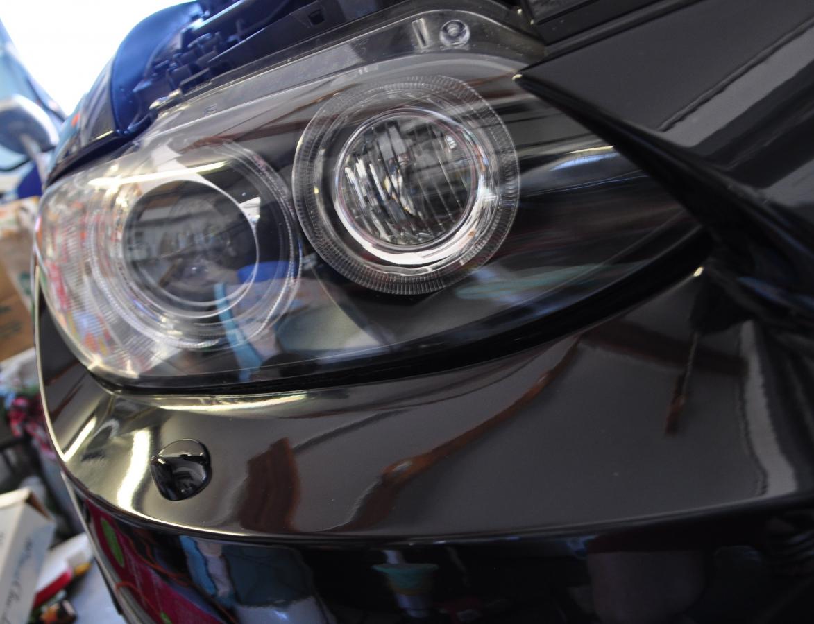

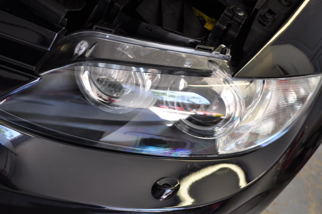

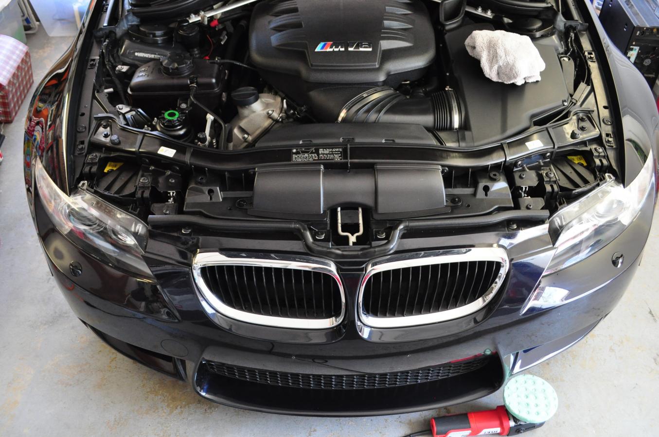

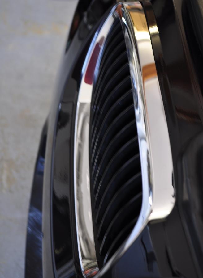

      So headlights sanded down and compound used to remove sanding marks and smooth it all out. Now time to high polish and seal them as well as the chrome grilles and the whole bumper - notably the area covered by the front license plate holder.

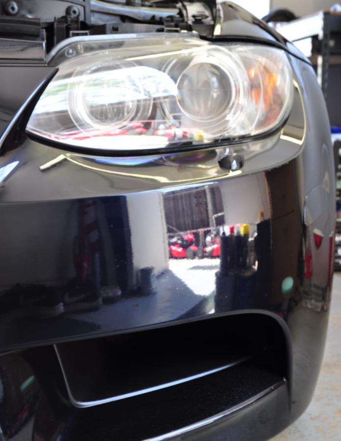

      I used a very mild green LC CSS pad with the mild Mother's CMX polish and seal in 1 product. Same product I'll use to polish the whole car after I clear up every panel in piecemeal.
      tbc...

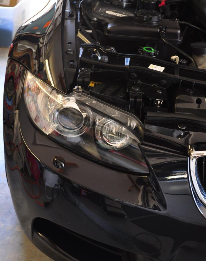

        Post polish:
ID:	188353 Click image for larger version

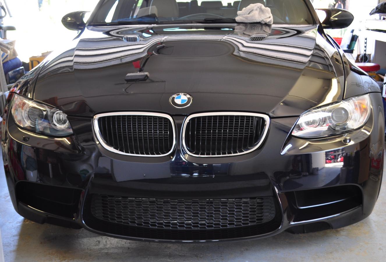

        Roof, boot, both bumpers and headlights/taillights done. Have both sides left to do. No other work needs to be done to the exterior - grilles, gills, emblems, lights, trims are all in great shape.

                    what did you use to seal / UV protect them?
                      Same sealant or wax I use for the vehicle, nothing special. I'm relying on 1. little exposure to sun 2. below average annual mileage & 3. annual polishing to keep them looking good. It's actually been 6 months now since I did it, and they look the same still.

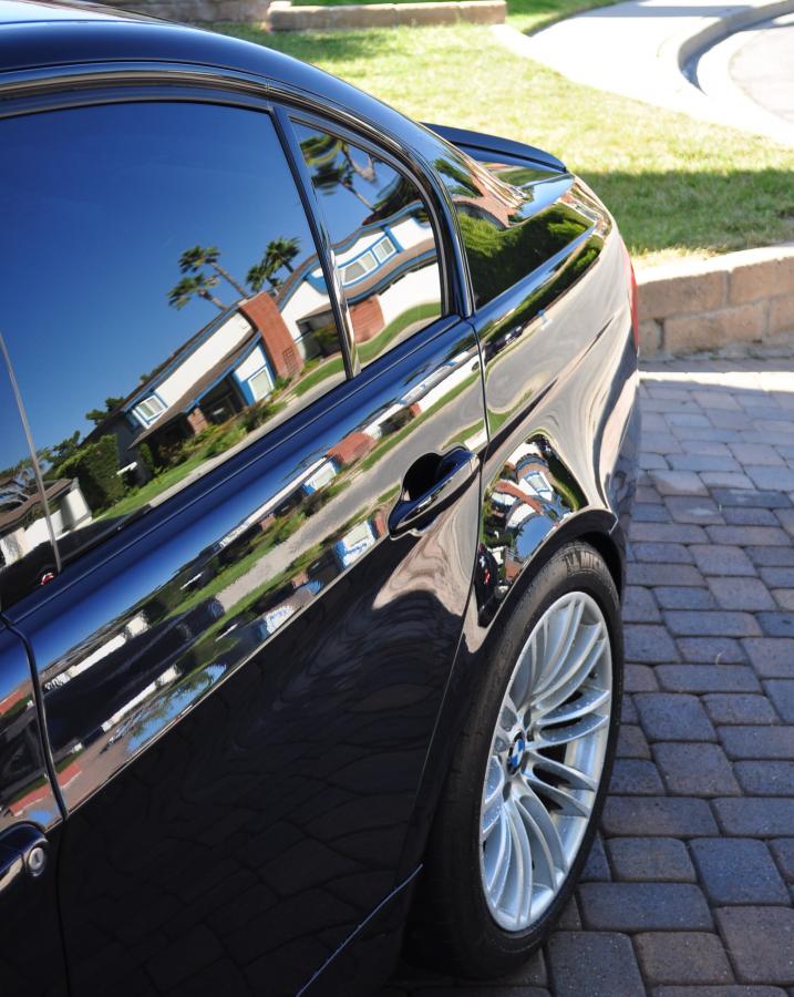

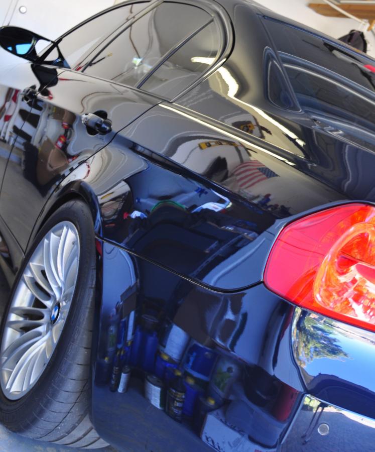

                        I forgot to conclude the light correction I did on the car.

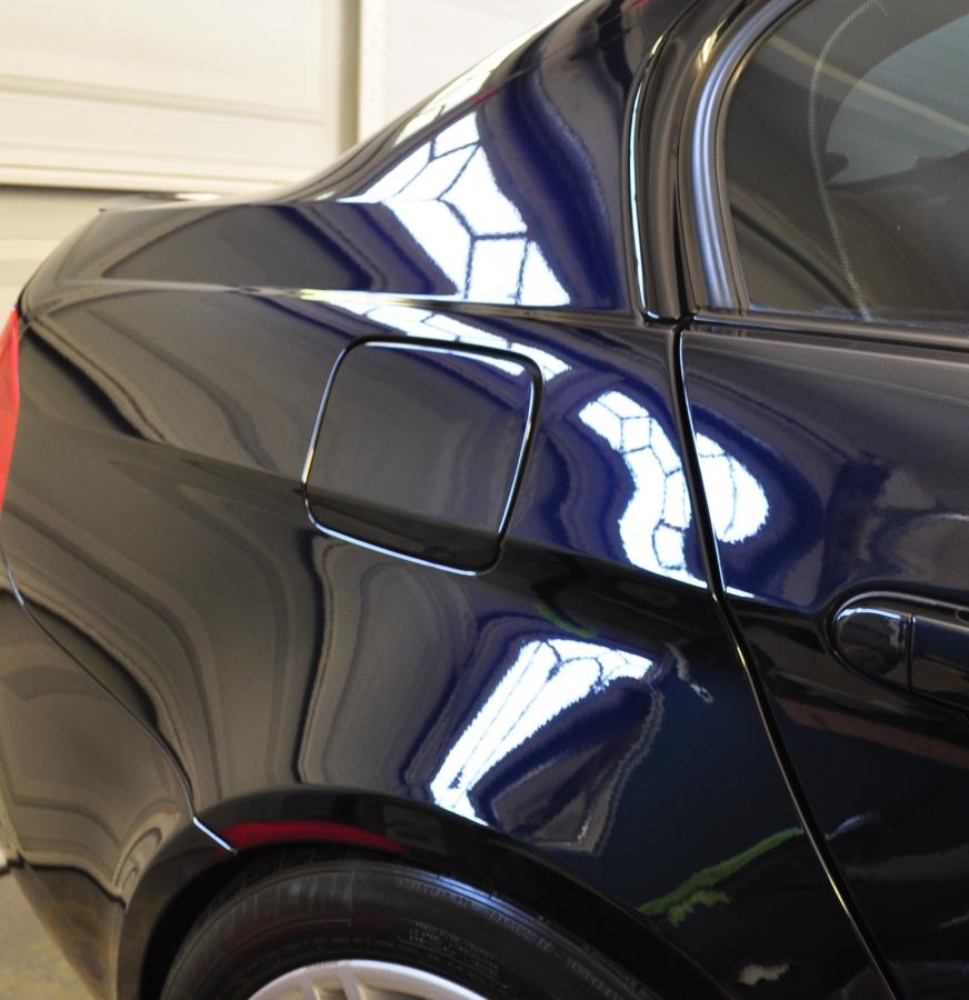

                        Finished the sides of the vehicle
                        Click image for larger version  Name:	e90driverpolish3.jpg Views:	0 Size:	90.4 KB ID:	197113

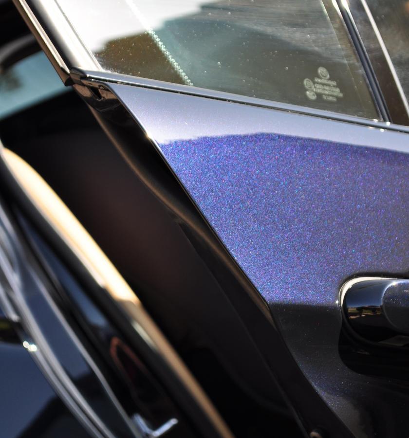

                        Thought this was a cool shot, with direct sunlight on paint:
                        Click image for larger version  Name:	e90passdoorpurp2.jpg Views:	0 Size:	84.0 KB ID:	197112
                        This was intersting to me, so I took a pic. This is in the garage with indirect light. It was enough light to show the blue color in Jerez, but low and indirect enough to not show any of the metallic. Looks like a flat navy blue. I've seen now 4 different colors that the paint can appear as depending on the lighting.
                        Click image for larger version  Name:	e90passsidefinal7.jpg Views:	0 Size:	73.3 KB ID:	197111
                        All done with the mild polish and semi-ceramic sio2/tio2 CMX coating. This will hold me over until I decide on staying with sealants or doing a ceramic coating.

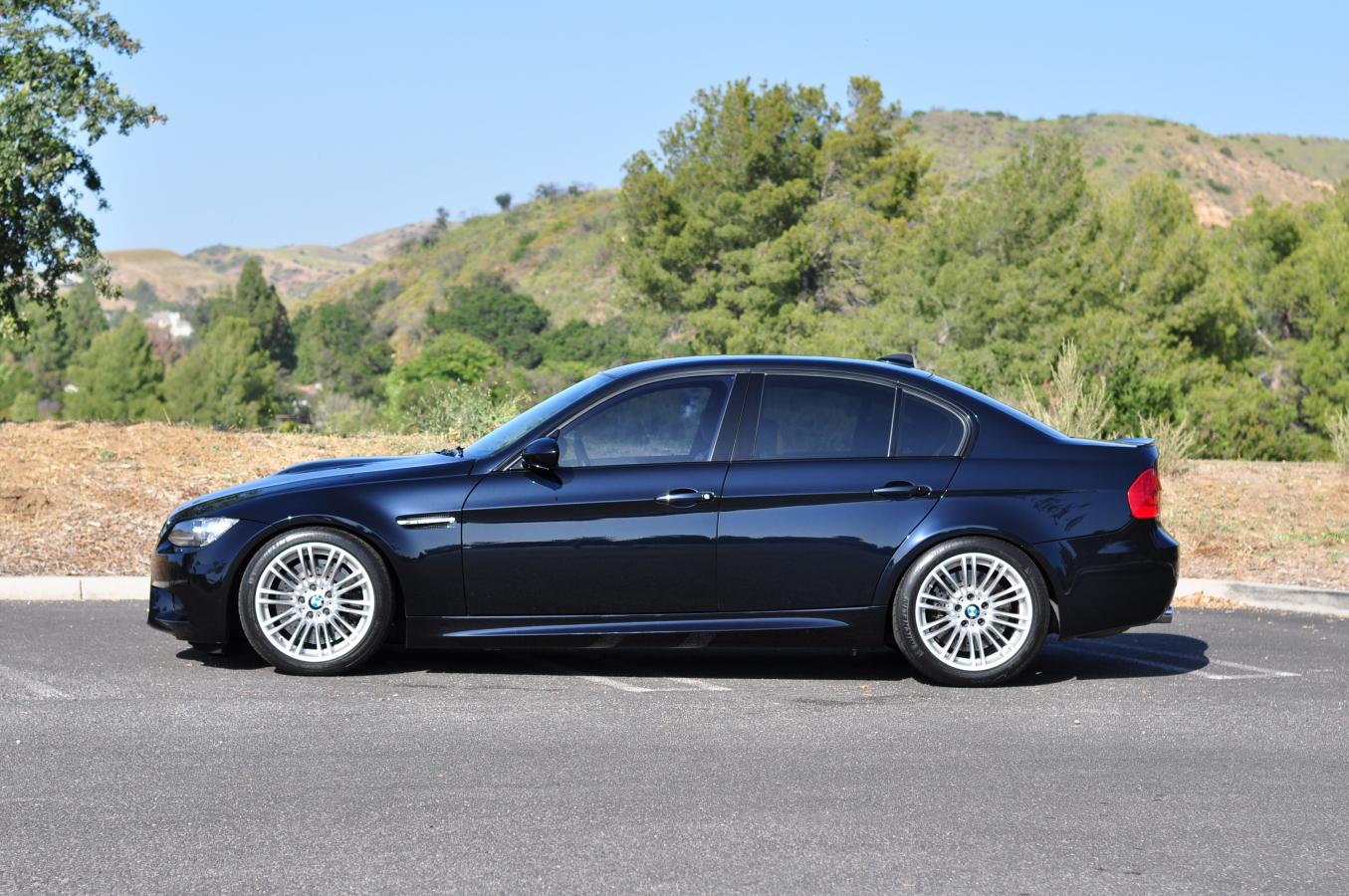

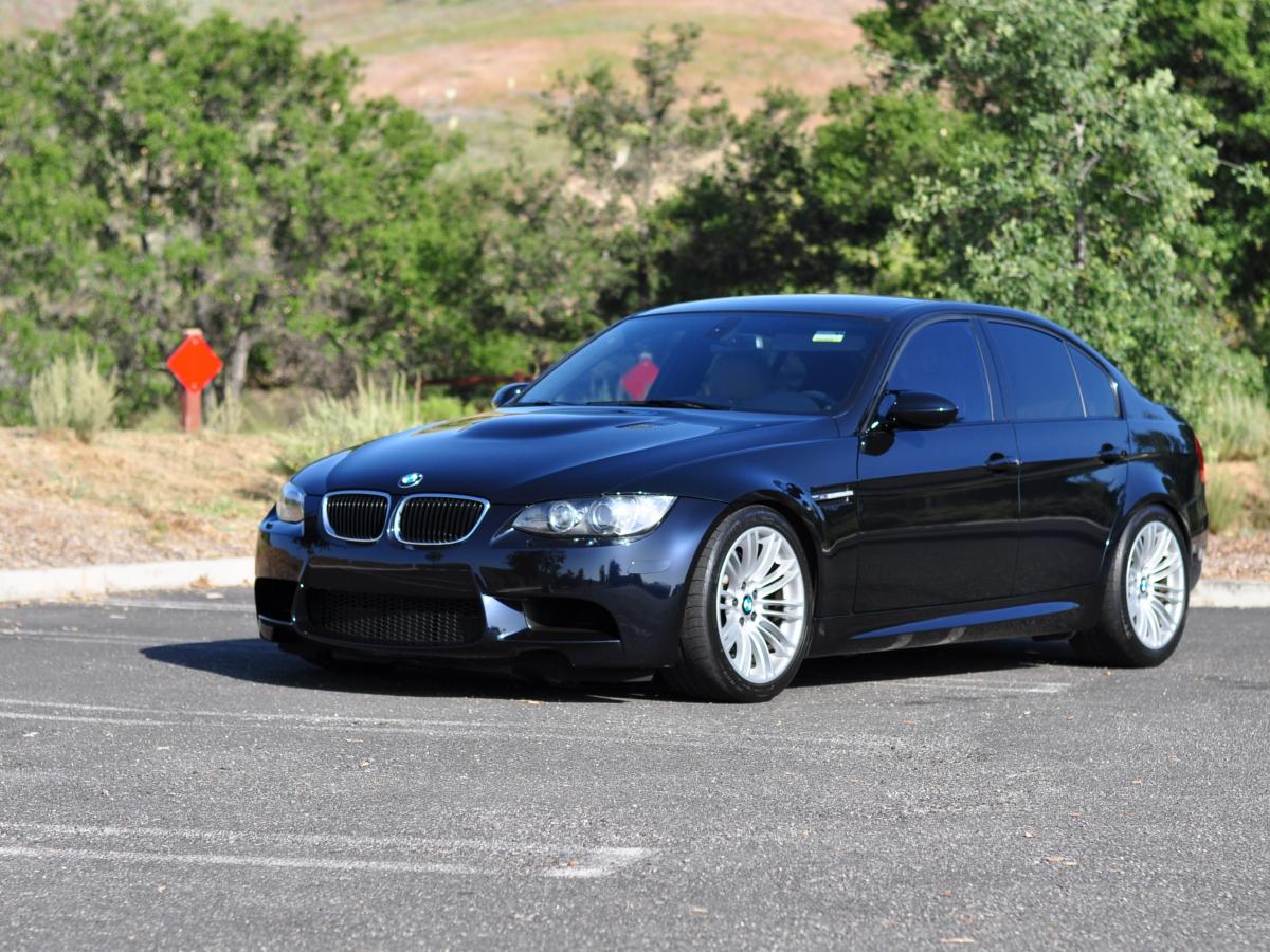

                        Now, out in sun. Just lowering springs (swift) so far, no other mods.
                        Click image for larger version  Name:	20220526_205313.jpg Views:	0 Size:	181.8 KB ID:	197115 Click image for larger version  Name:	E901stshoot (6).jpg Views:	0 Size:	195.8 KB ID:	197116 Click image for larger version  Name:	E901stshoot (1).jpg Views:	0 Size:	231.0 KB ID:	197117
