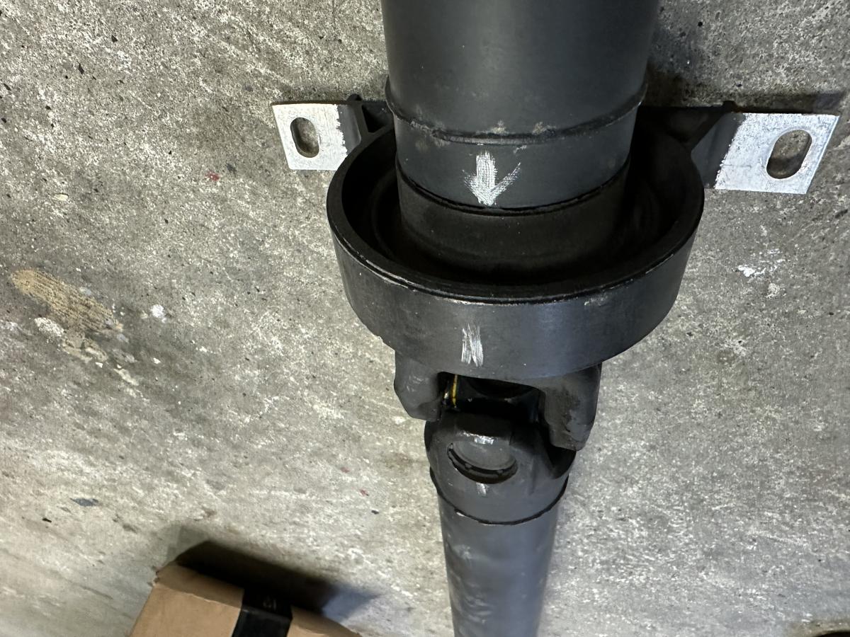

          Running well, but of course the CSB has let go.

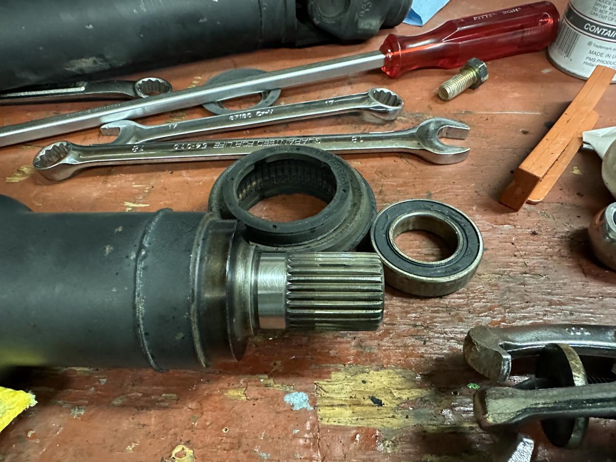

          Driveshafts are cheap as chips used, so I bought one and am rebuilding it.
          First step the CSB. Came off pretty easily with a 3 jaw puller. Click image for larger version

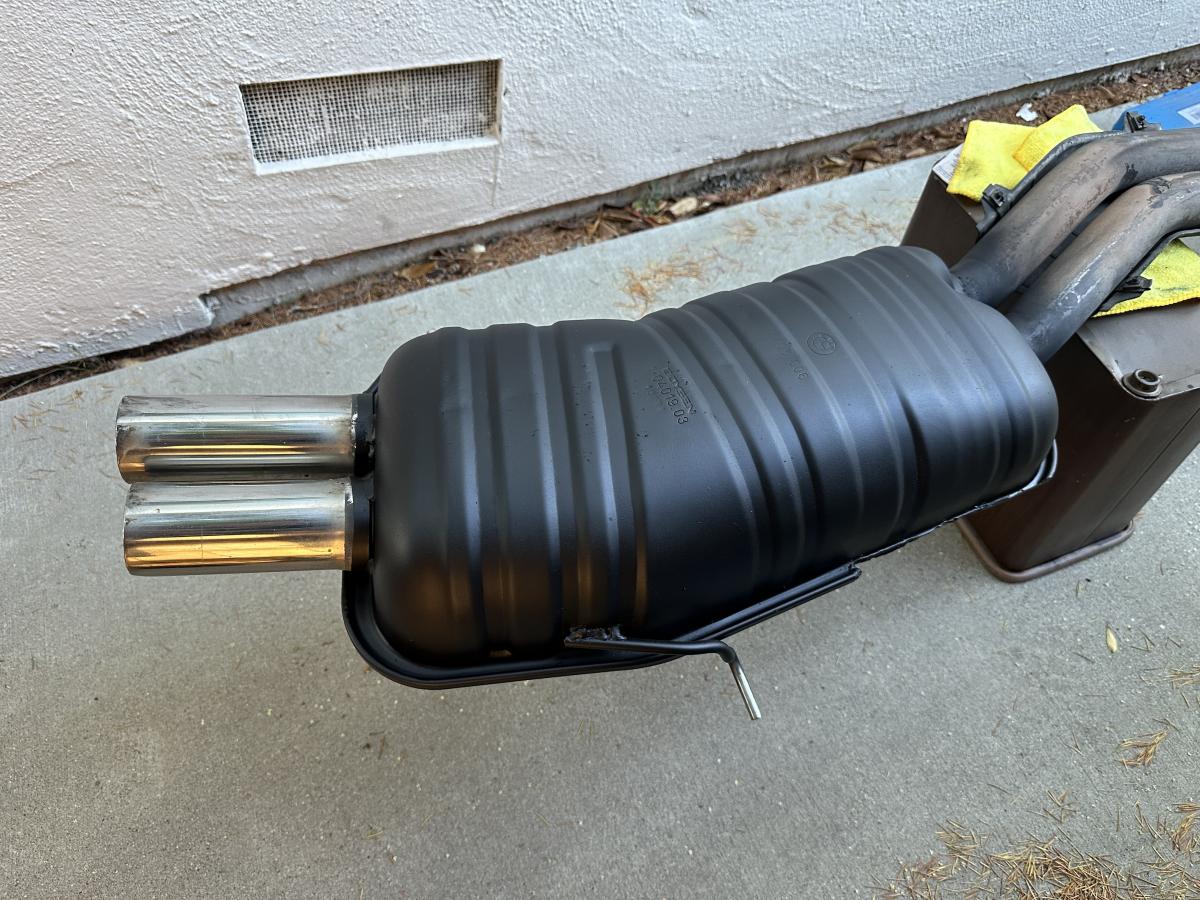

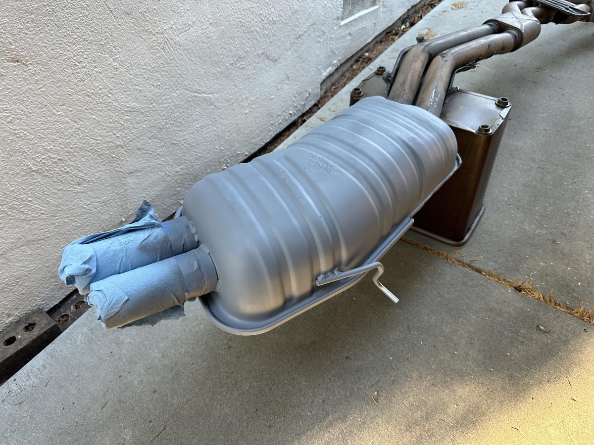

            When you’re ignoring the actual work you need to do to pass the BAR smog test and you’re just blissfully painting mufflers while swapping drive shafts.
            The new/used driveshaft fixed my clunky DS issues as well. The root issue ending up being play in the U-joints. heinzboehmer swappkng this out also reduced the auto solutions noise for me quite a bit. So nice bonus there. Everything underneath looked ‘normal’ with the shifter.
            Oh, and something finally showed up - hoorah!

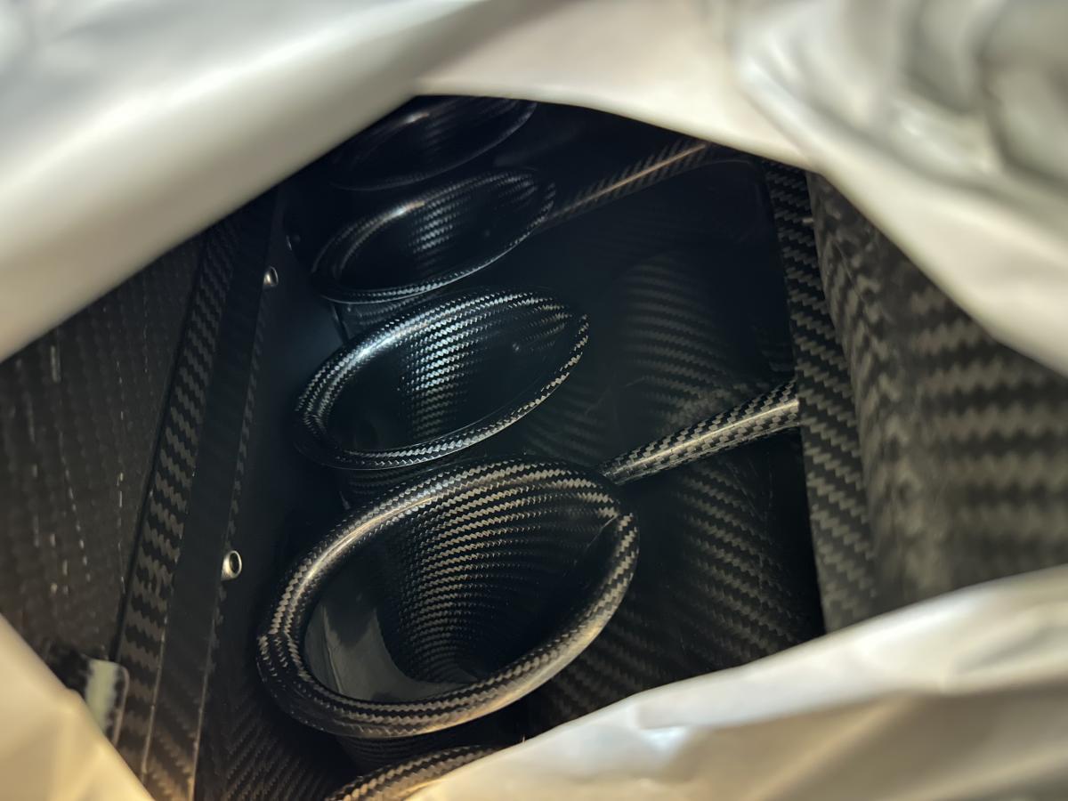

                    - Karbonius matte carbon airbox with their non-flap air intake piece

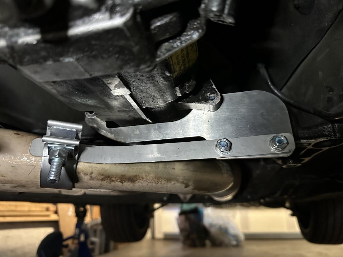

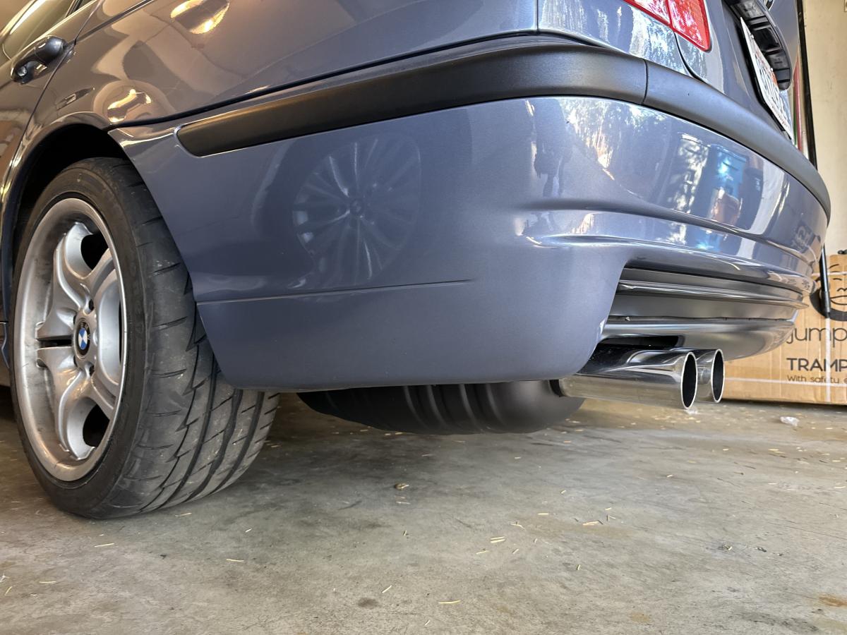

                        Thanks to Bry5on for designing a nice exhaust bracket for his setup (SSV1 headers and cats). My car has the stock US header + cat combo, and can use the same bracket except the US section needs a 2.25” clamp vs the 2.5” for the SS larger pipes.
                        It works. Love it. Car is smoother all over, but especially around idle. Blips are butter smooth. No more jostling and much less bucking. It’s subtle, but when you spend a bit of seat time in these cars it’s definitely noticeable and easy to see why BMW used a similar bracket on the m54 cars.

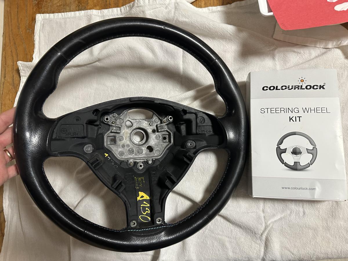

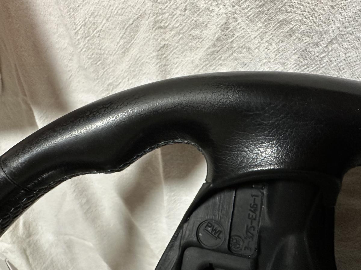

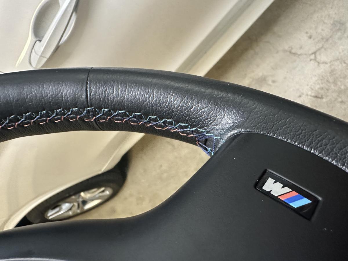

                          In true, semi-beater swap fashion, this car got another hand-me-down from a fraaaaan. Leather wheel! The alcantara ZHP wheel never did it for me. I re-did the leather dye with the colourlock kit. Good kit, would recommend. Of course it didn’t take the deeper gouges out, but it’s respectable looking and feeling now. I’m going to try the full button-less trim for a while. I don’t often use the options.

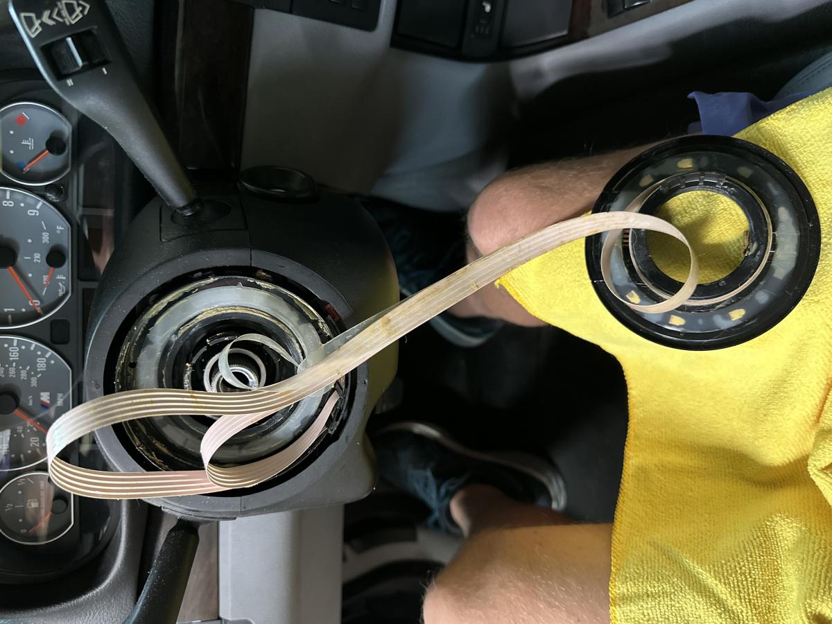

                          Also, somehow I snagged the clock spring on the way off with the wheel. If this happens, don’t sweat it, just wind it all the way up and put the cover back on. Now wind it lock to lock without installing the wheel and count the turns. Then turn it to the middle of the range and you’ll be good to go.
