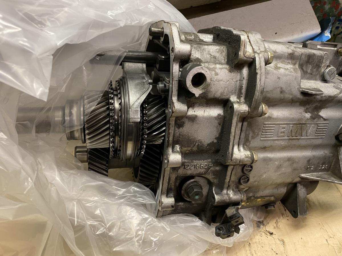

                So, what the heck - manual swap time. Time will tell if I regret this 😂

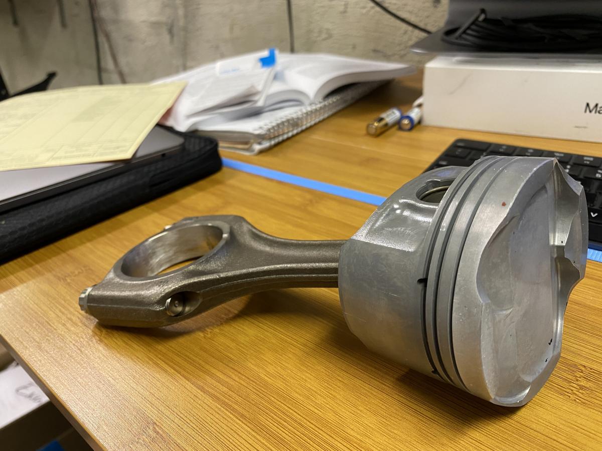

                  Ok, data on the 211k mile engine:
                  Block wear - Bore Taper and out-of-round:
                  - The bore measured the highest wear in three locations on cylinders #1, #2, and #6 in the non-thrust direction. The value was .0012" = .0305mm.
                  - In general, the taper was greater in the thrust direction, but the average delta was .0002" = 0.005mm. The greatest taper delta was highest on cylinder 3 @ .0005" = .0127mm. The machinist said for this build that value should not present any issues.
                  - Out of round was greatest on cylinder #1 @ .0011" = .0279mm. Out-of-round is less important for cylinder sealing and this larger delta should still be ok for my purposes, form my understanding.
                  Piston Wear
                  - The pistons were in shockingly good shape. The highest wear on cylinders #1 and #2 is .06mm. The other cylinders were all around .05mm wear.
                  - The pins, rings lands, and skirts all looked very good. All factory grooving was still evident on the sides of the pistons. Some showed light wear, but none of them were even close to being "smooth".
                  BMW Total Wear Spec
                  - The allowable wear limit spec between the block and piston wear is 0.15mm max combined.
                  - The block and piston total wear, respectively is 0.0305mm + 0.06mm = 0.0905mm
                  - All the other cylinders + pistons exhibited 0.06 - 0.08mm total wear.
                  Decision Time

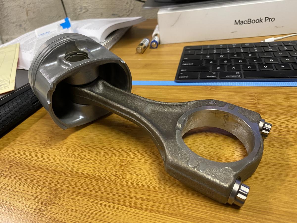

                  From the beginning, I wanted to re-use the pistons/rods/pins, but I realize the measurements needed to dictate the path.
                  - I measured all the above with a $100 bore gauge and a $50 micrometer. I was pretty certain the delta between measurements would be decent with this equipment. The actual values I questioned, of course. So, I asked the machinist to make sure the total wear, taper, court of round, and cylinder-to-piston clearance were do-able. He did not give me exact measurements, but simply said I should have no issues and mentioned total wear was around 50% of spec. He did mention that accelerated wear does happen as things age, especially with abuse, so I should not expect another 211k miles. He loosely said I could expect 100k if the motor was assembled correctly, street driven, and had good quality oil with frequent oil changes before the total wear on the pistons and block necessitate changing. So in other words - best case scenario. Now, tune it, put in cams, and an airbox and I'm assuming you may as well lop off a bunch of those expected miles. He also said BMW specs are pretty conservative and catastrophic failure is mostly related to either extreme wear or extreme abuse if all of the above are good to start with.
                  - I will re-use the stock pistons + rods + block (honed) and rebuild the head to stock specs.

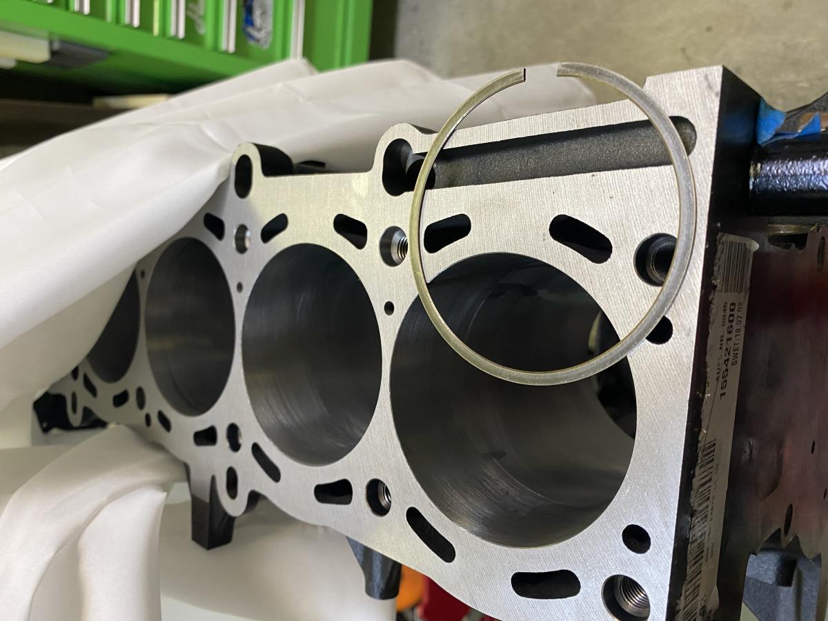

                  Machine Work
                  - A word on prices - I did not get a 'deal', and am not affiliated with this shop, but I'd like to list them so you have a ballpark of what to expect. Please don't hold them to the machinist if I end up sharing their contact with you. That's not cool and prices only ever go in one direction, especially given our inflationary period. Anyway, let's call it "mid 2022 pricing".😁 And of course, this engine isn't running yet, so it's all a bit meaningless at this point.
                  - Head ~ $900 - 3 angle valve job, surface (.005") pressure test, jet wash, and install new valve guide seals. no guides needed to be replaced nor any valves. Now, I did not measure the valve guide clearance, but I wish I would have. One of the areas I'm trusting the machinists' experience.
                  - Block ~ $700 - Mag tested, decked (.005"), "boiled" aka cleaned, honed
                  - Pistons ~ $100 - Clean, change bolts, check all dimensions
                  - Crank ~ 165 - Clean, check straightness (was great), polish
                  Machine Work Ramifications
                  - Head .005" removed
                  - Block .005" removed
                  - Block .0005" inches removed while honing
                  What does this all mean? Well, I'll want to get a .040" head gasket from Cometic instead of the stock .026" head gasket (which they round to .030", FYI) to make sure I don't bump my compression by 0.2 points. In fact, I'll prolly end up lowering it by 0.05 or 0.1 points if my maths are correct. anyone care to comment here? Always looking for a second set of eyes. And for the hone, add that to the total block to piston clearance above, respectively 0.0127mm + 0.0305mm + 0.06mm = 0.1032mm. But remember, this is my math with my mediocre measuring devices. Machinist gave it the OK, so I must not be too far off. This is the worst case for this motor.

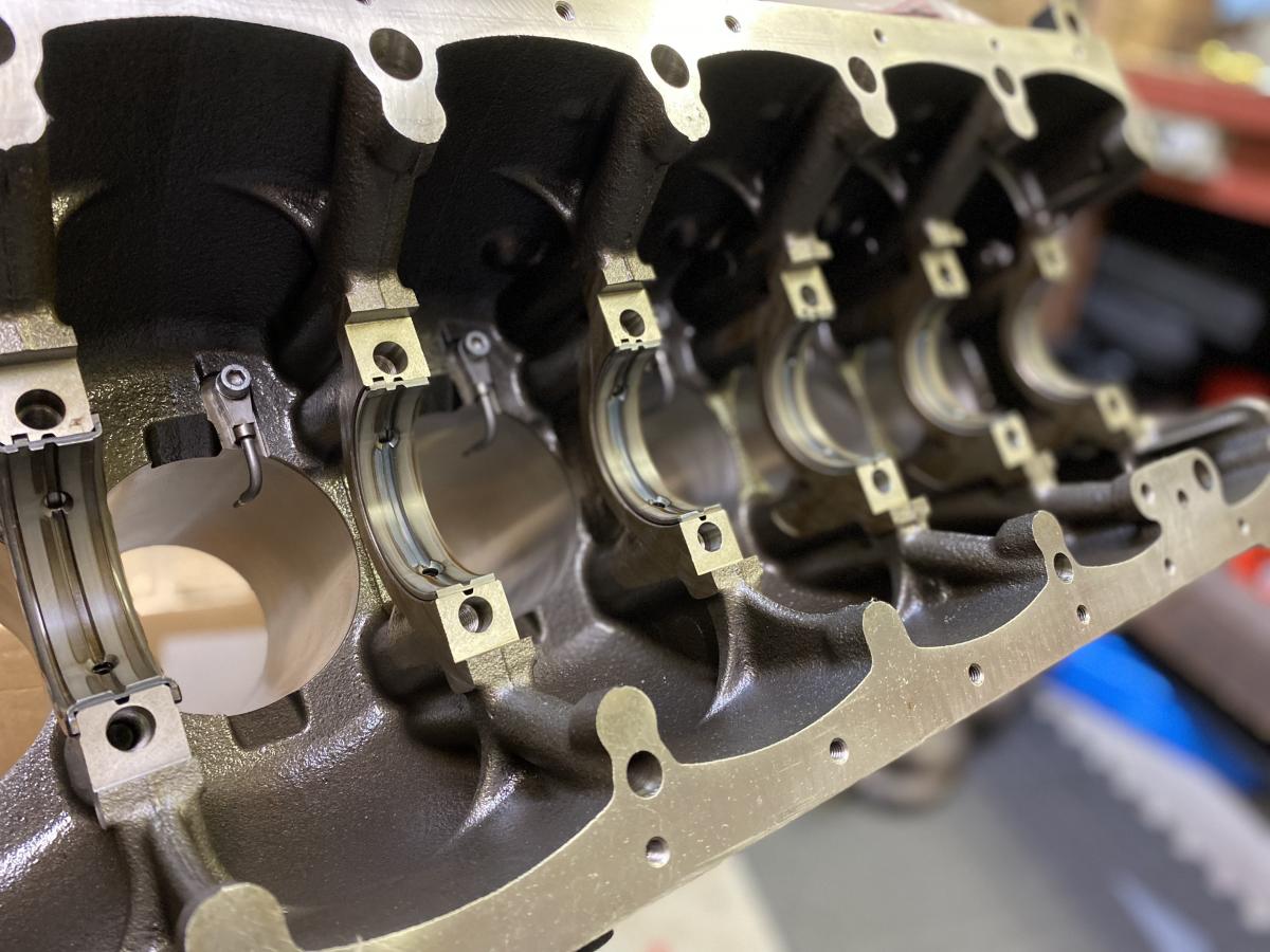

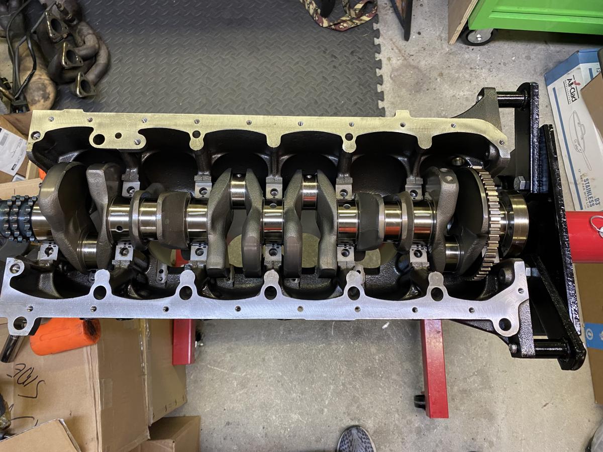

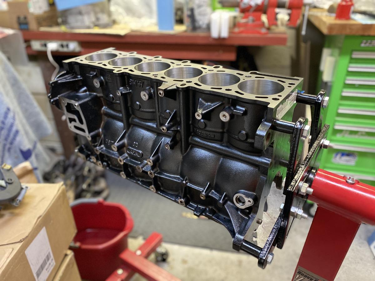

                  Next time, let's talk about rings, main clearances, rod clearances and until then, some pretty pictures! Oh, and also, how not to screw up your brand new main bearings and buy them twice... as I did. Yay! Negative $236, terrific 😀. Rookies have to pay the price!

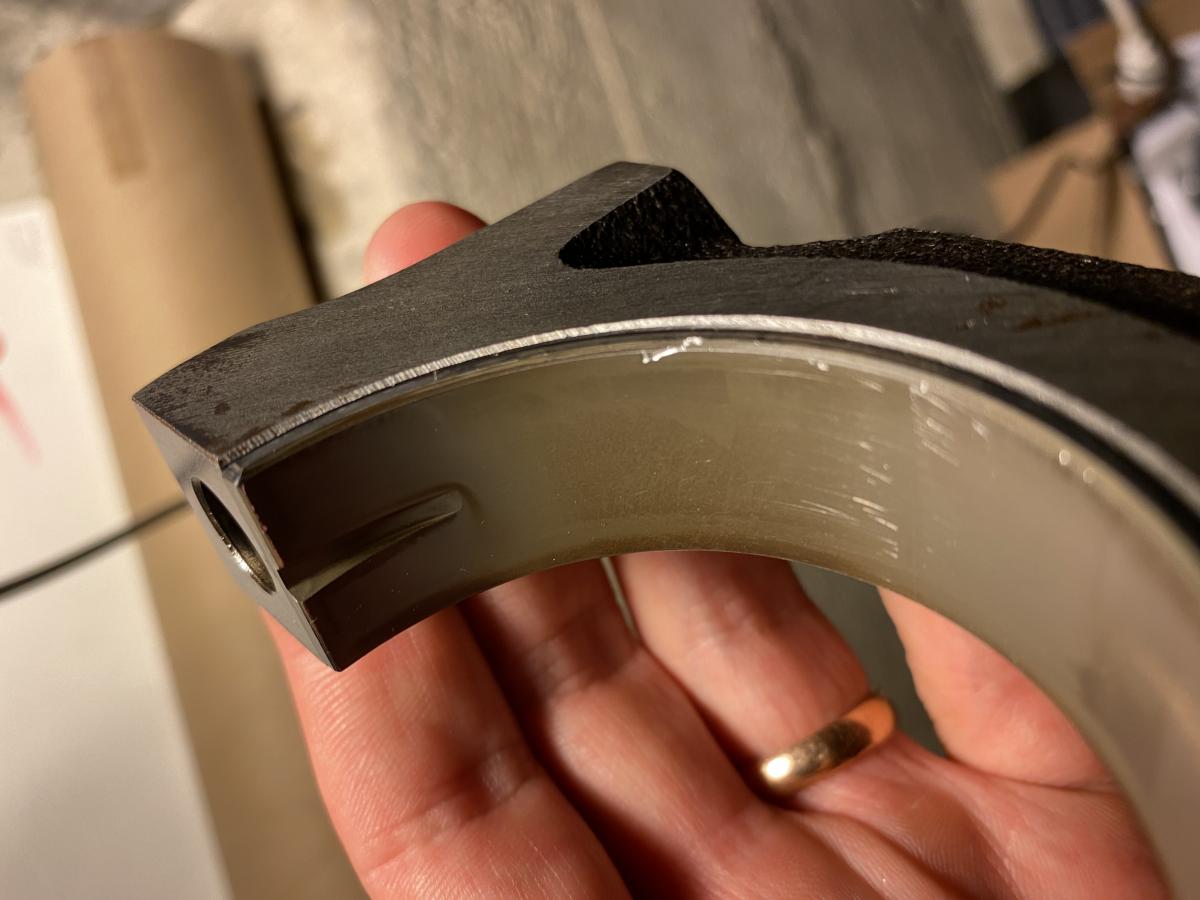

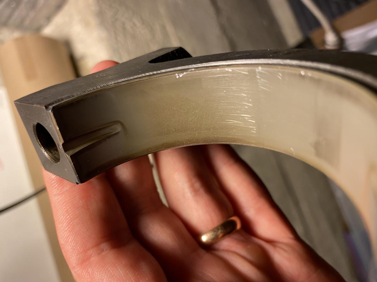

                    This probably doesn’t look like a $236 mistake, but we’ll, it is. All I can say is…
                    1 - don’t use a plastic scraper tool to remove Plastigauge from a coated bearing.
                    2 - don’t drop main cap #1 and a new bearing on the front sprocket while trying to fit the cap. If you let the main bearing bolts do the work you will not be broken-hearted caveman like me.
                    Im actually probably very lucky. The bearing is so soft that neither the sprocket nor the cap show any signs of being nicked.
                    I just have to buy a whole new set of bearings to replace 1 out of the 14 mains… Yay!
                    Would this maybe work as-is? Maybe, probably, as our cranks are super hard and the bearings are super soft, but I’m not willing to find out!
                    contact me if you need extra standard size mains… le sigh.
                      Nice progress! Wish there was a video series for this rebuild . A quick search says that a 1 point drop in compression will lose about 4% efficiency, so basically nothing in your case. You could always go the other way and have to run 100+ octane all the time lol. For a stock rebuild, this is looking really good.
                      Unlucky on the bearing, but at least the cap is in good shape. Looking forward to the next update.

                          About the bearing, not sure which brand you bought, but you can buy individual ones from BMW. Totally get not wanting to mix and maych manufacturers though.

                            Yeah, I thought for quite a bit on the bearings. At the end of the day, I wanted to use the coated ACL bearings in both the rods and the mains, which is what I bought. Technically, I think the OE bearing mixed with the coated ACL bearings would be completely fine, but something about it just didn’t sit right with me.
                            if I were using the Kobleschmidt bearings I’d be fine with buying a one off OE, as that is what the koblschmidt are, but I’m not so I didn’t. Perhaps that foolish of me?
