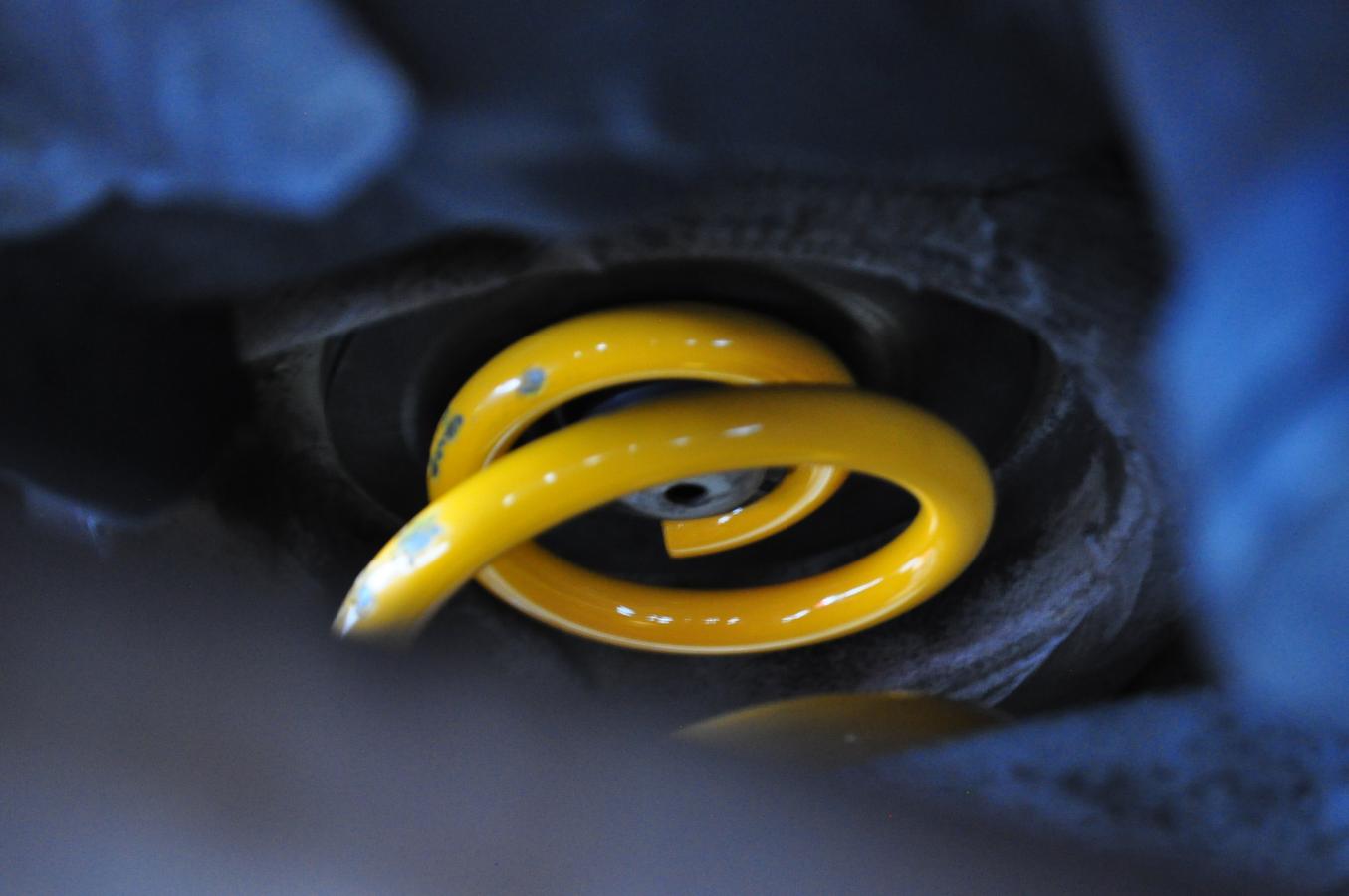

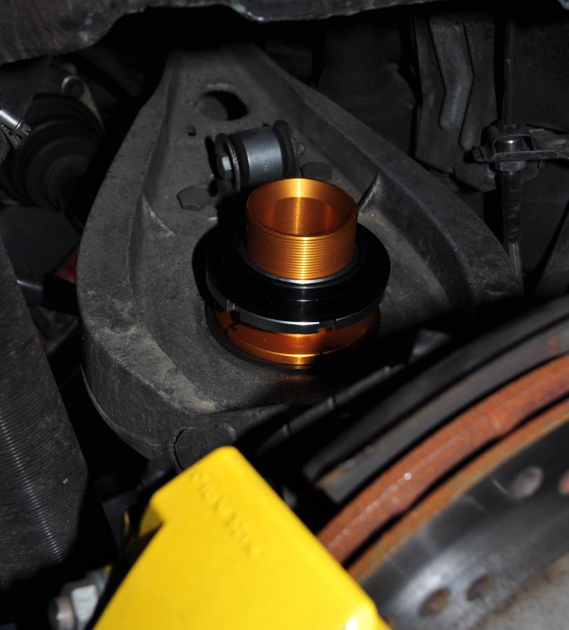

Looks great. I had a washer at the bottom of that stack anyway because seating the yellow bushing's inner sleeve directly on the shock's shoulder made me nervous.

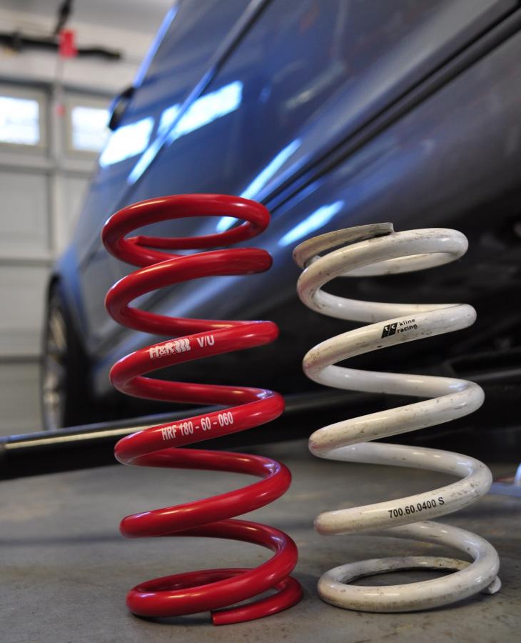

Yes, I haven't updated this thread yet, but I found some 60N/mm (342.6lb) H&R 60mm springs on sale with ECS, so I went for it. I was looking at 336 (6kg), but felt that was a little too close to the 325lb that I already had which felt too soft. I felt 343lb was lower enough from 400lb to satisfy me. It also allowed me to go back to medium setting on hotchkis sway without bringing back so much understeer, which I'm very happy about. Car feels great, besides scraping the rear on big dips in the caynons. Now I need stiffer rears to get much closer match in bounce frequencies, which will also be more appropriate for the 13.125" ride height I have.Last edited by Tbonem3; 02-24-2023, 07:22 AM.DD: /// 2011.5 Jerez/bamboo E90 M3 · DCT · Slicktop · Instagram

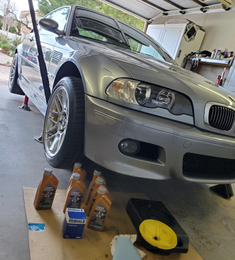

In January, did my annual oil change. Using up the last of my Castrol "sale" stock. With two "S" engines needing about 16L annually, I think I'll switch to Motul for 2024.

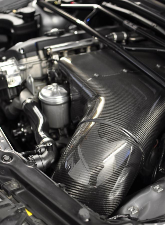

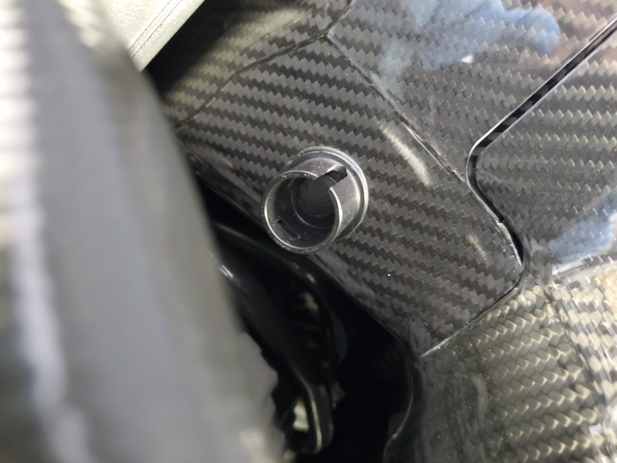

I also checked on my make-shift plug for the Karb's IAT port that I don't use. I had measured the ID of the port (think it was like 13mm) and then sourced a rubber stopper in the appropriate diameter. It was unnecesarily long, so I cut it down, leaving enough incase it migrated at all. But after a decent amount of driving, it hasn't budged.

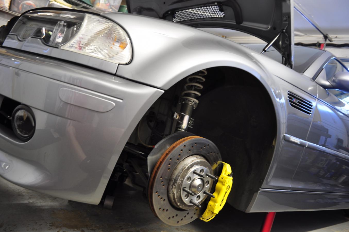

So while starting the hunt to find the right spring (not always easy!), I got lucky and saw that ECS had an H&R (bilstein) set in 60n/mm (343lb) that was 7.1" tall (good for travel) and in the 60mm I needed for the MCS and my TMS plates on sale for $63 a pop so I went for it. I figured 343lb was close enough to my trusty 325lb, but with a slight increase in firmness that the MCS surely wouldn't mind at all. I have to say, the MCS were incredibly compliant even with the 400lb springs (on full soft setting!)

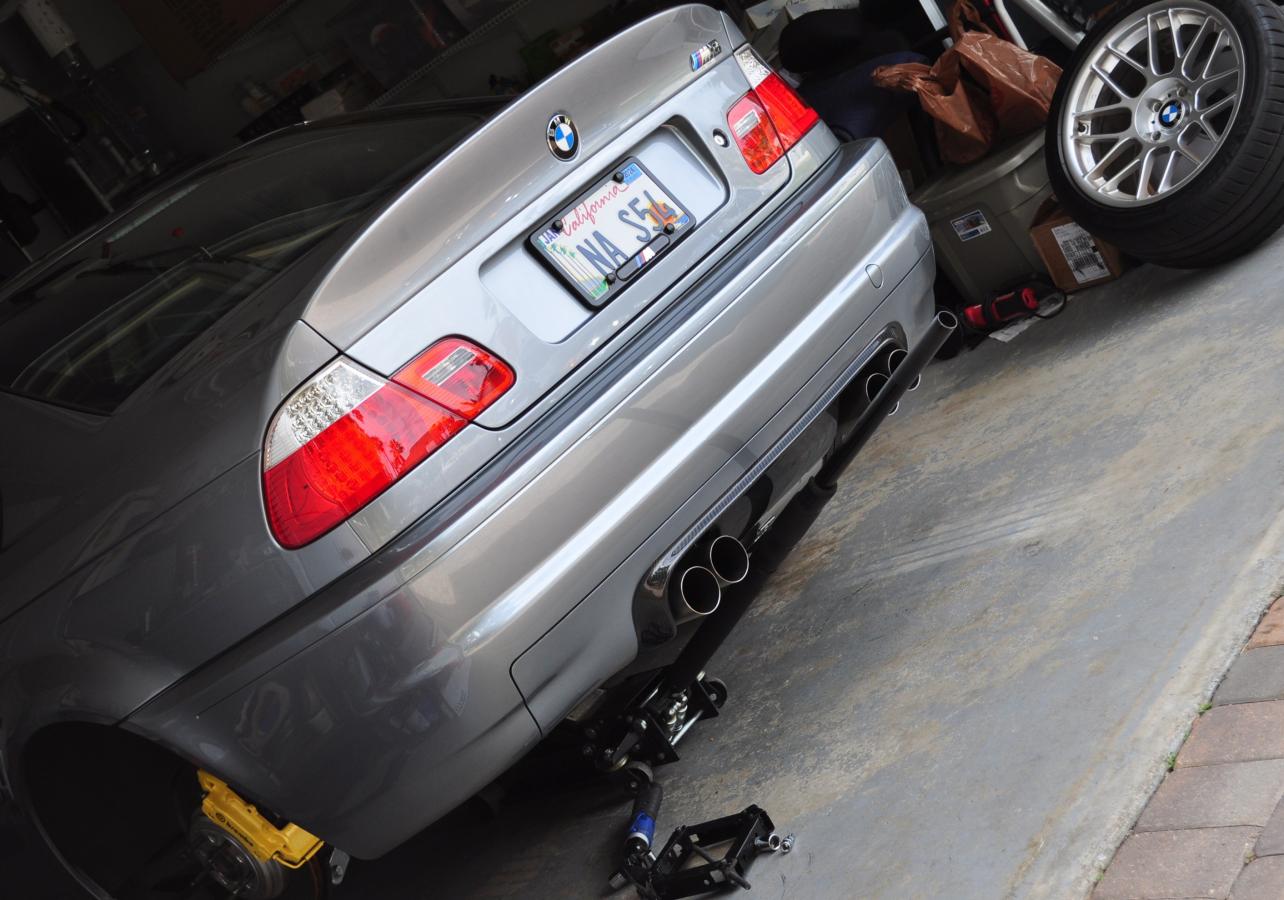

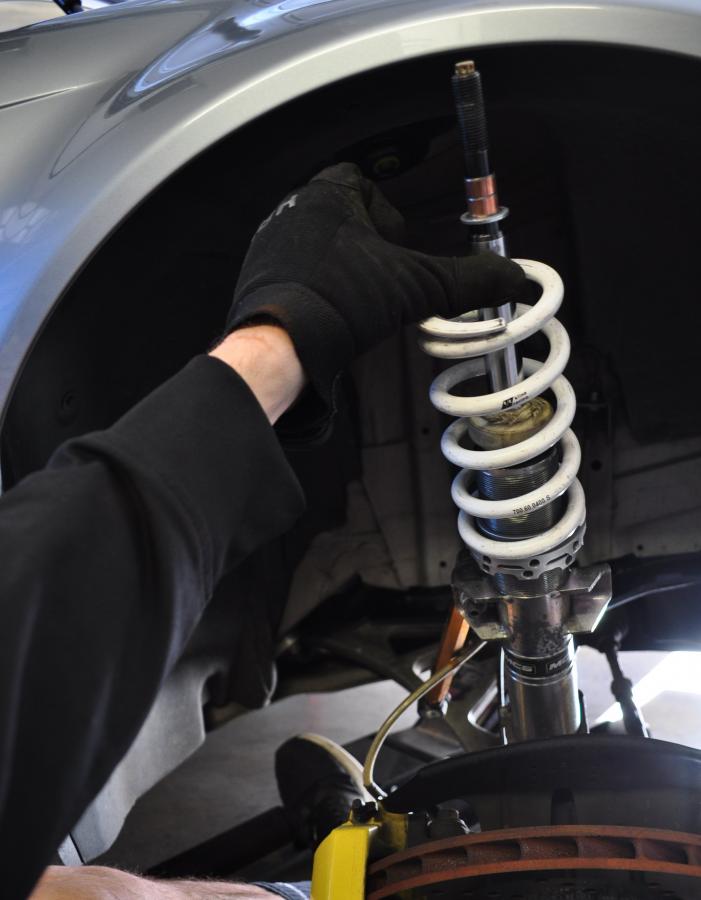

My MCS shaft bearings (to pickup tolerance between 14mm race dampers and camberplates made for stock 16mm) still looking good. Removing the TCK 400lb springs.

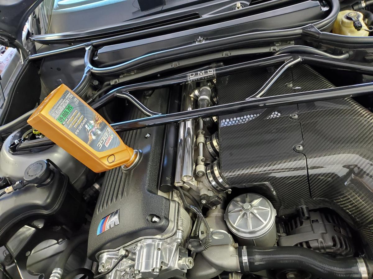

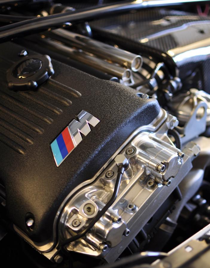

Had the hood up, so why not some glam shots of the engine/airbox?
I'll get around to affixing the M POWER decal at some point. Don't care for the unfinished look after all.

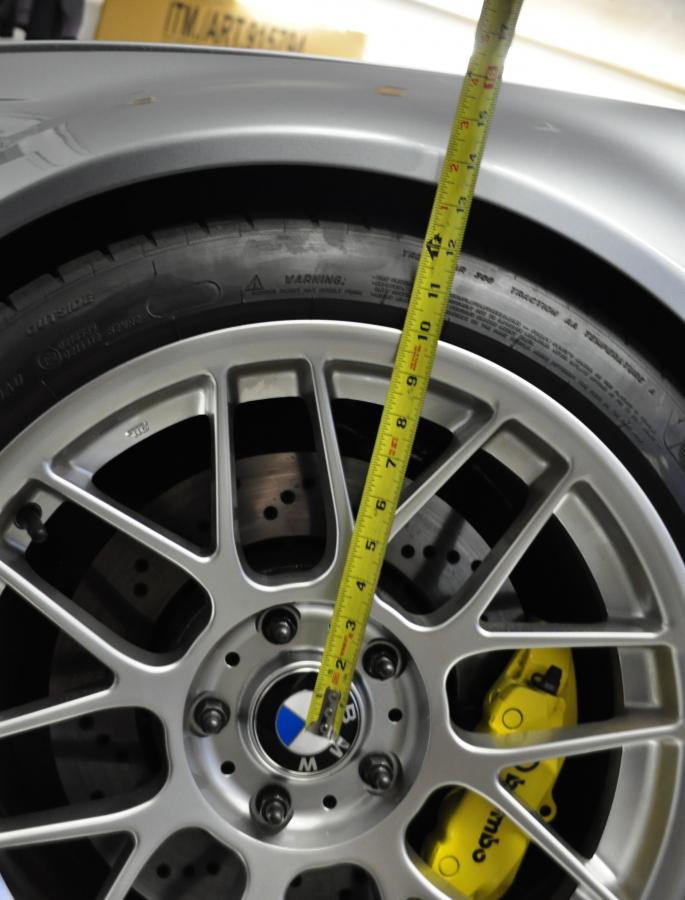

All done, rolled the car back and forth, and it seems like I've got it right at 13.5", but I probably will have to make small adjustments later, esp after I redo the rear springs.

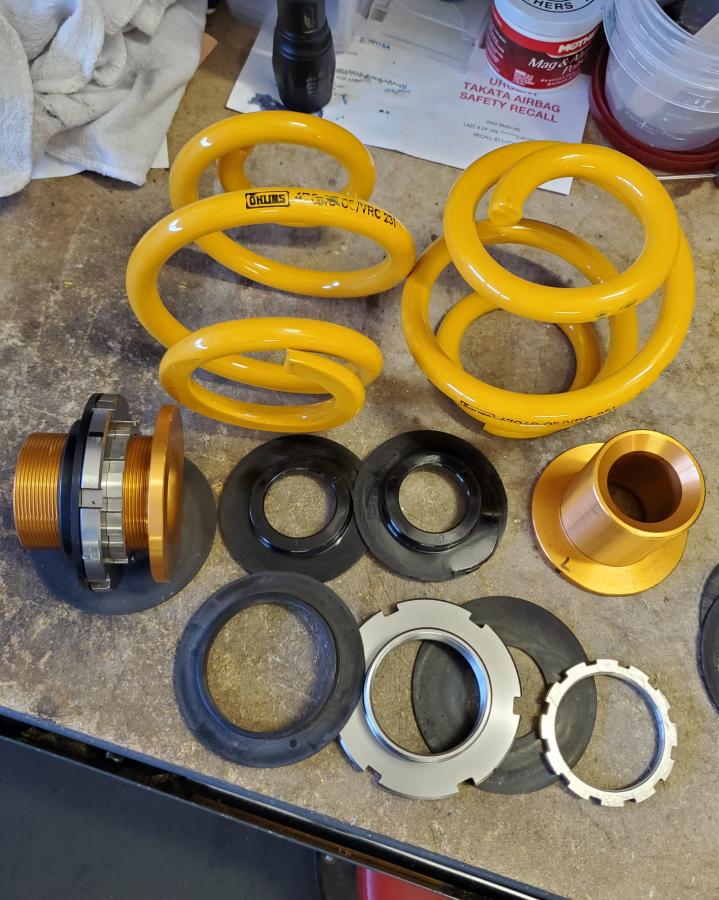

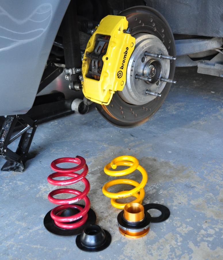

So now for the rear, I spent a lot of time thinking what rate I wanted to go with, that would also play nice with the hardware/perches I already had (or as I like to do, use the stock pad in some way). I saw that mrgizmo04 had put GC weight jacks and swift springs in his rear, so I asked if I could buy his rear Ohlins springs/perches as I wanted to try 628lb. I know the flatride spreadsheet would call for more like 700lb, but I just really don't like how harsh it is for what is still a street car. My rear end is also failry gutted, so 700lbs for me wouldn't be what it'd be like for a stock convertible, for example.
Me being me, I couldn't use the kit as supplied, heaven's no, I had to tweak something. Out of fear for repeating the experience I had when I tried 600lb springs on a GC perch with no isolation, I really wanted to make sure these ohlins were well isolated. I don't put up with much NVH- you' be surprised how quiet and luxurious the car is despite the myriad of modifications.

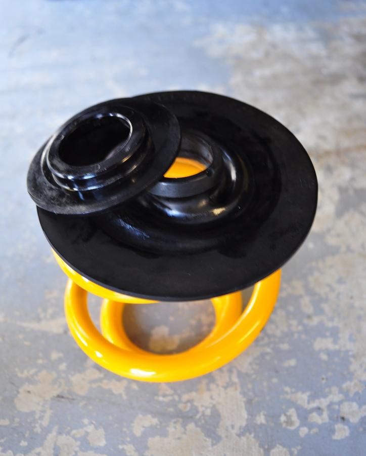

I didn't love that the top perch was simply plastic. Luckily, the pig tail of the spring matches pretty well to stock adn the stock rubber pad (5mm), so I decided to use it instead.
550lb eibachs - a little different in that they're a barrell spec and 6.5" so I was able to acheive 12.875-13.25" ride height depending on how many rubber sheet shims I used, while putting hte spring directly down onto stock rubber pad. The top GC cone made of poly was soft enough to isolate well - this setup was very compliant and quiet, but just not enough resistance to keep me from bottoming out on big dips at decent speed.
Versus the ohlins setup:
The Ohlins' perch has a rubber gasket to go underneat, and there's a plastic isolator for the perch seat itself. Seemed satisfactory to me.
I rotated the spring and wiggled it a little so that it caught on to as much of the "nipple" as possible. I doubt it moves under the weight of the car, but still... Great fit in the end!
