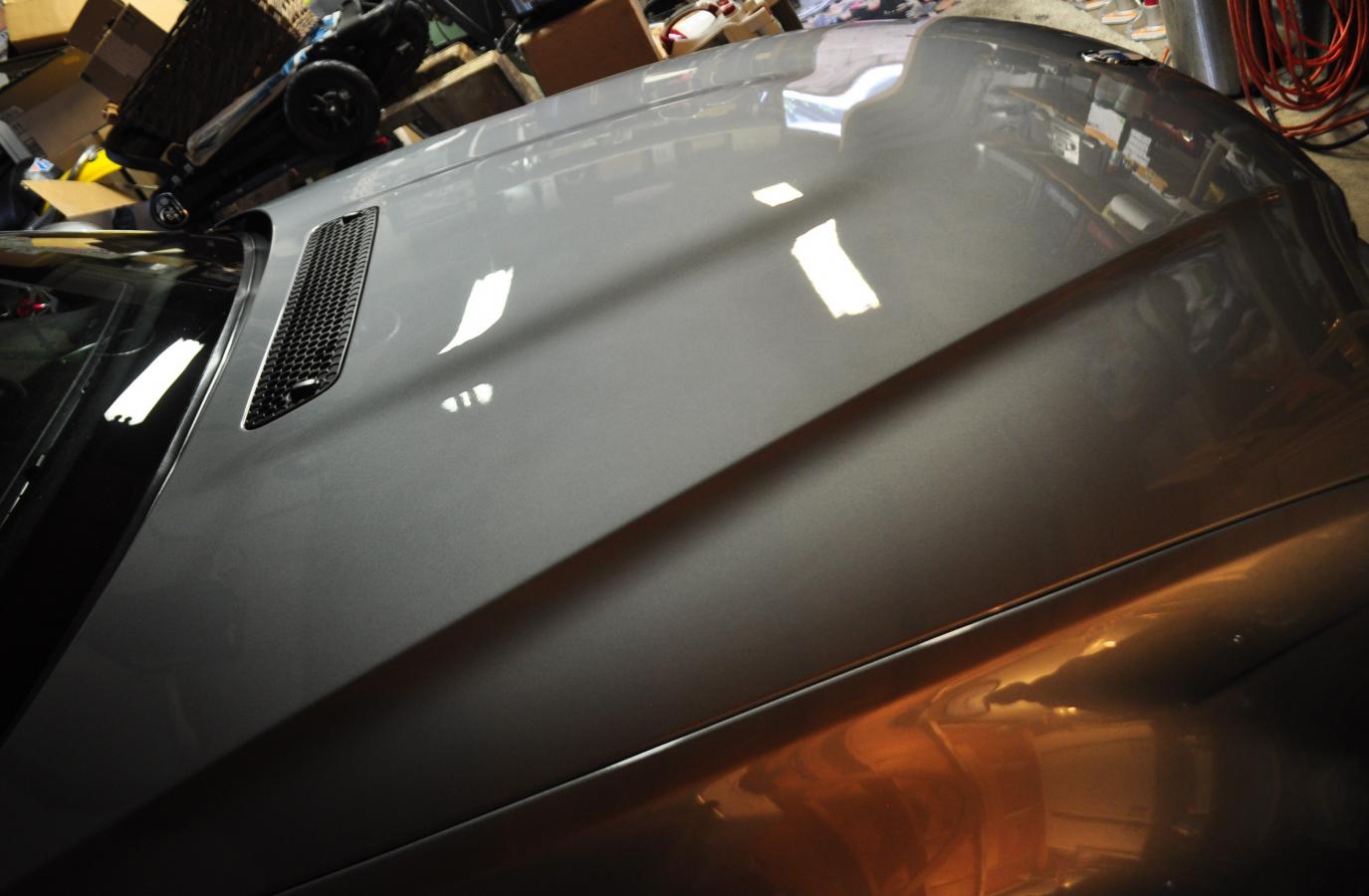

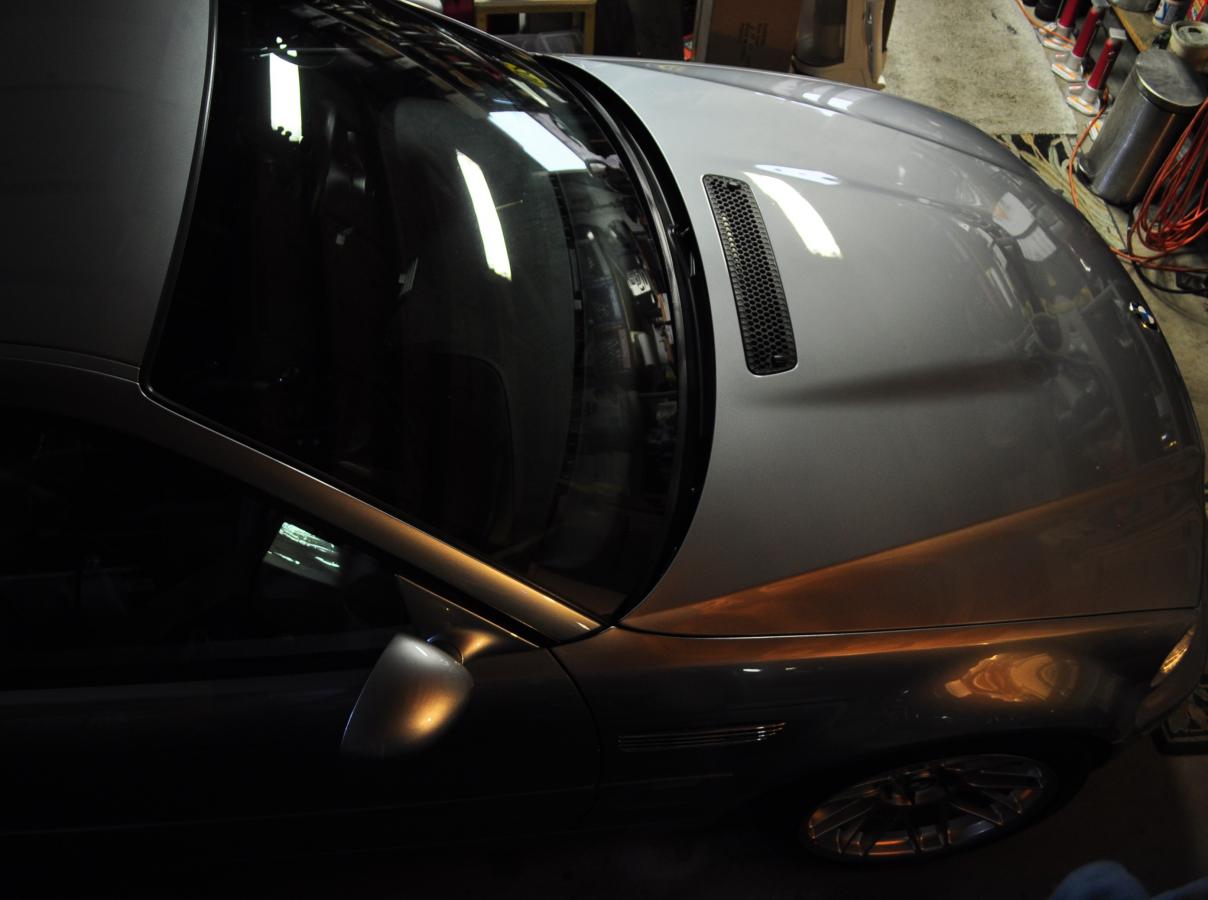

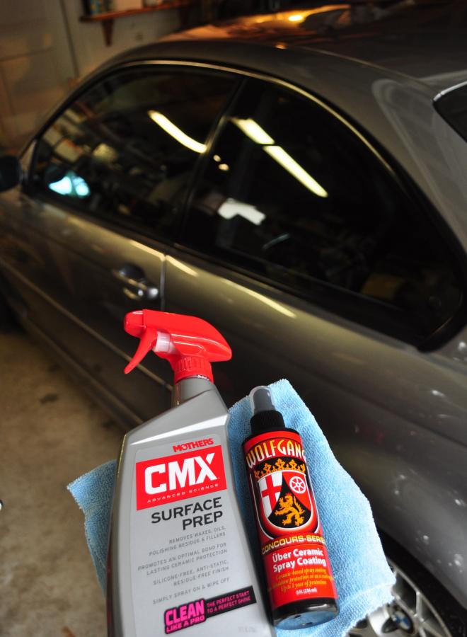

                        The car had to sit outside for half the year, so I topped it off with a fresh application of ceramic coating (1 year "lite" coating - wolfgang uber)
                        Did a chemical decon wash, then panel wipe, then the coating. Didn't have time to polish the car, but with it being a fairly light color, you can't see any fine scratches anyway.

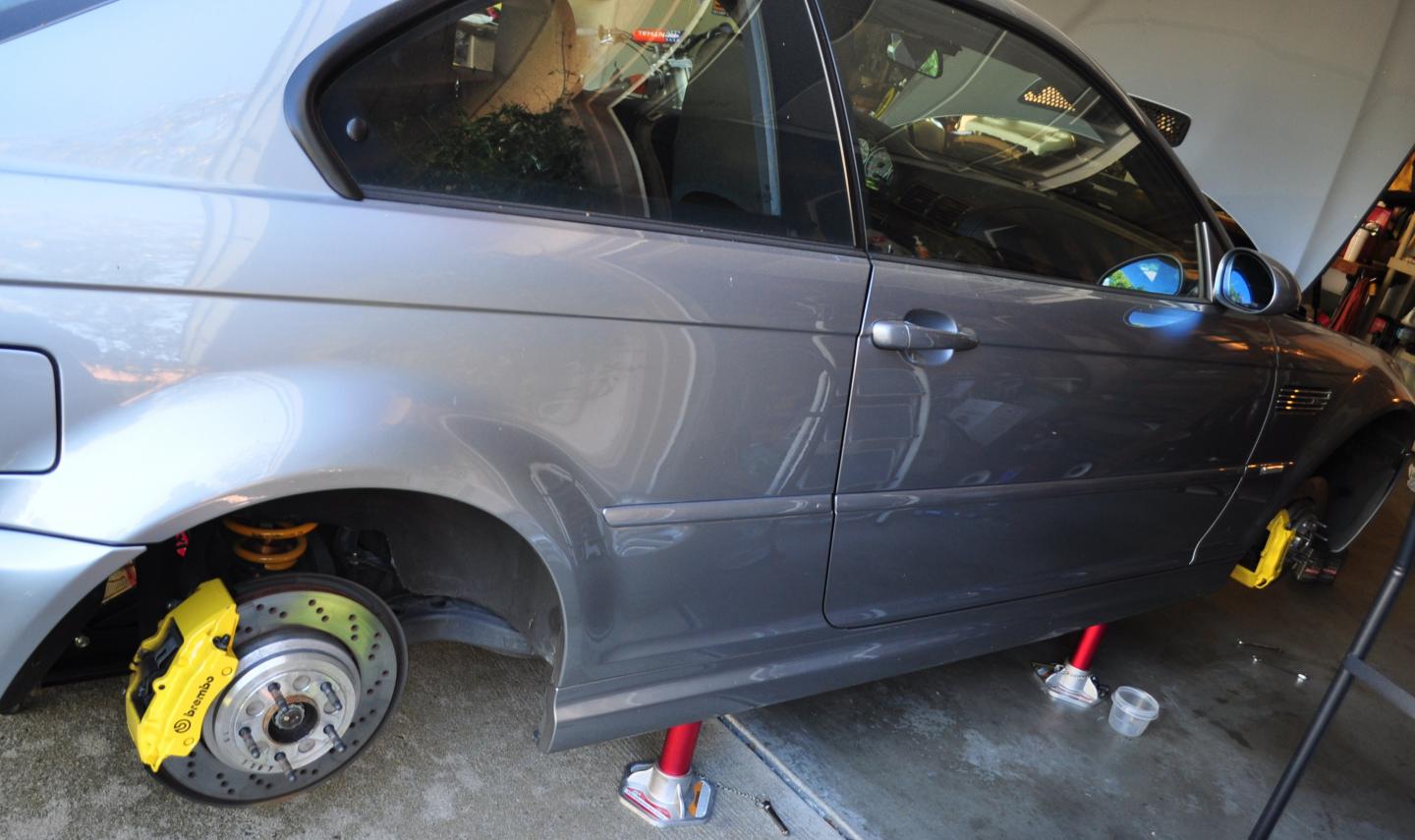

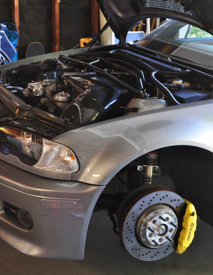

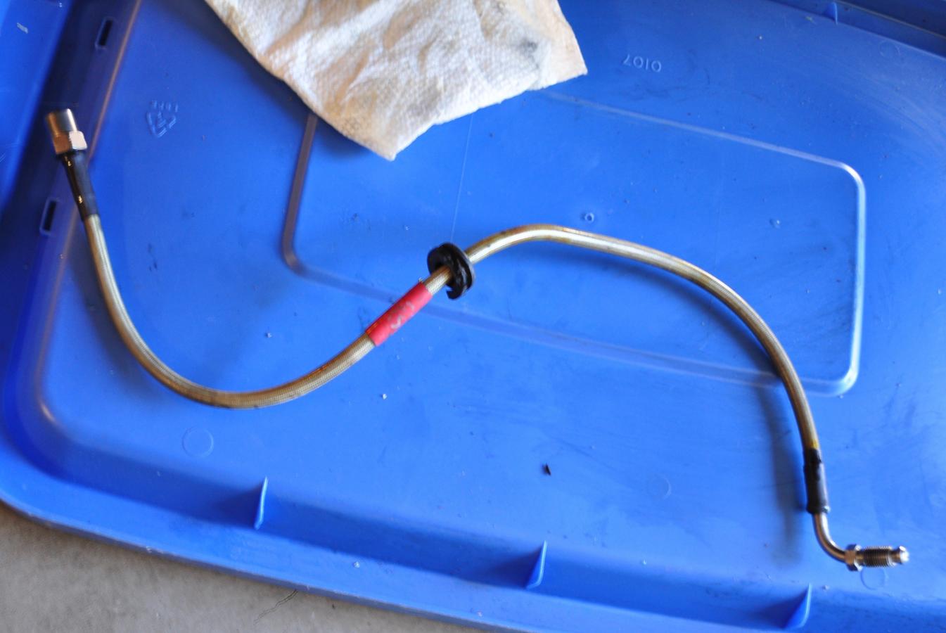

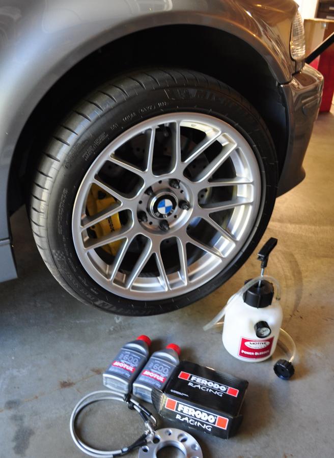

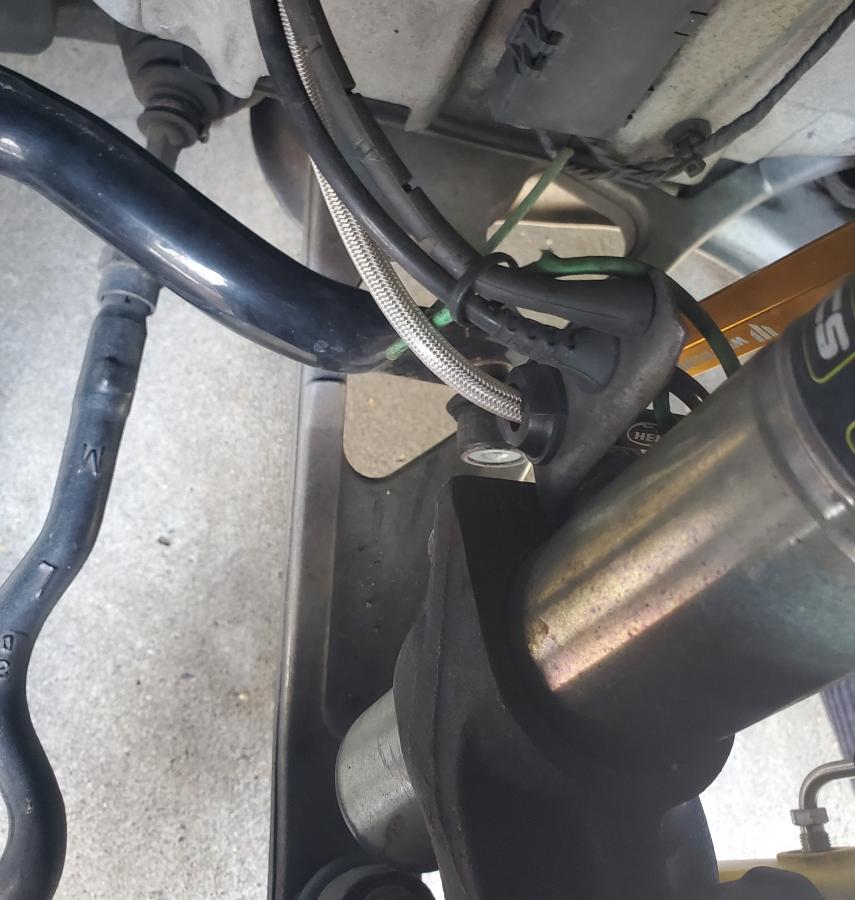

                        I finally got tired enough of the brake fade in the canyons to go ahead and get some hotter pads & fluid. I also took the opportunity to remove what I felt was a liability in the ECS/CM porsche 996 style brake lines. Too many reports (one of them a friend, witnessed first hand) of failures. I already updated the rears with HEL a few years ago. I found a set of HEL made lines with the 90 degree bend from a speed shop in the UK. I got several sets as I'm also building a 996 kit for a friend right now. Worked out to about $70 a set so not bad at all, and now my mind is at ease.

                        I also have plans to increase the width of my front wheels and tires, but the first step in tuning the car better for canyon carving are the brake pads. The porsche textars are very good, no issues at all, but fade easily. I decided to go with Ferodo DS2500 as it seemed to be a good middle ground between street use and track use. I was also eyeing PFC z or 08s but went with ferodo. I also got a liter of Motul RBF600. I'm not sure if the ATE typ200 (already higher boiling than stock) was inadequate, but figured I should go up to 600.

                        I just liked this pic, the floating E46 M3! Alright, time to start.

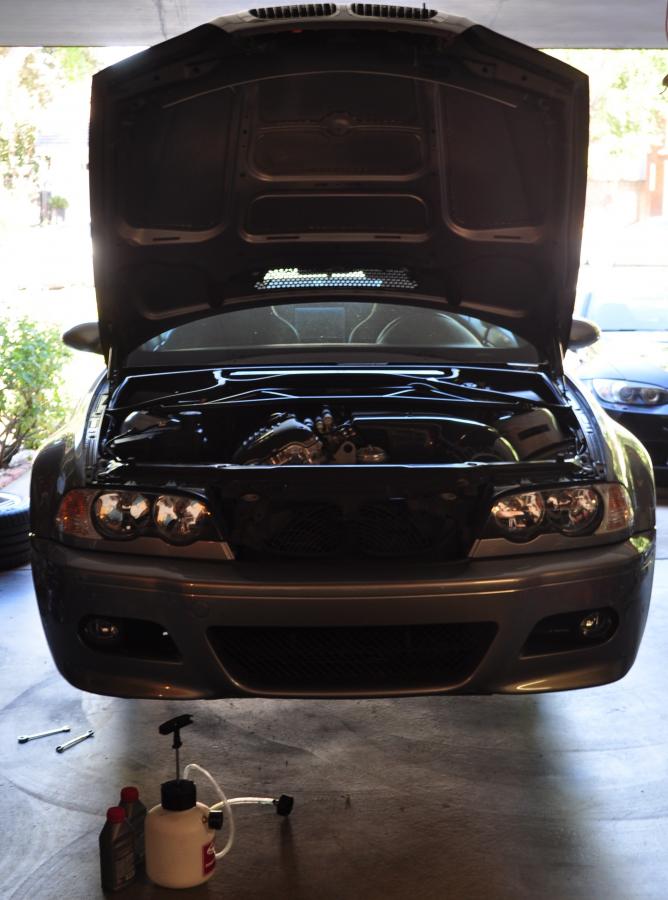

                        I started with the line change, then pads, then I'll flush

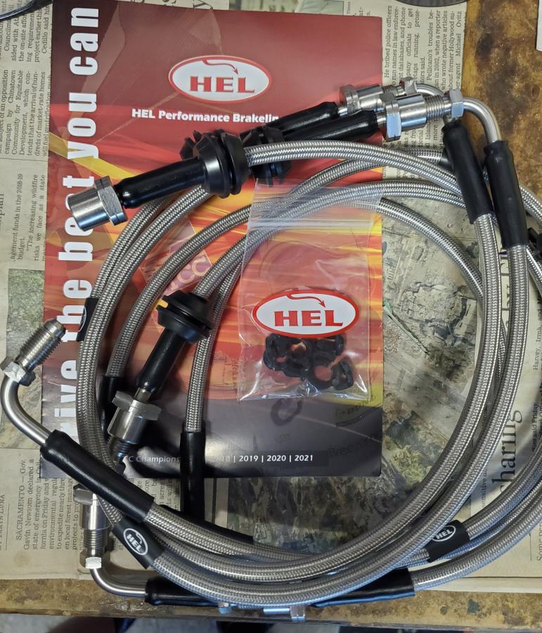

                        Good riddance to this cheap shit
                        The HEL lines are obviously higher quality just holding htem in your hands. Plus their rubber grommet actually fits! And stays in places! And doesn't crumble - amazing!

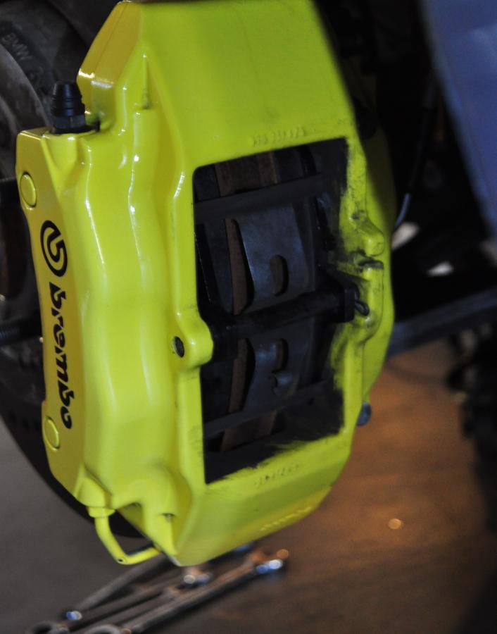

                        Pad changes for the 996 are stupid easy! (if you don't have the dumb dampers in there)

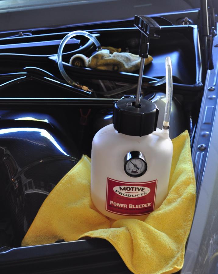

                        Time to flush. Motive (euro) bleeder is a great investment!

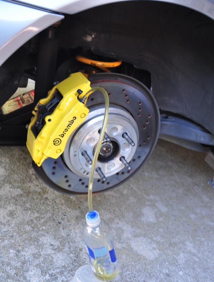

                        Rear right first. Old fluid is super clean (not that old, not many miles).

                        Then did a bedding session. Well, from cold, there was no noise so that was nice (I was expecting squealing when cold or really hot). As soon as I got some heat into them (getting ready to bed), they grabbed really well. The cold bite is still not great, but that's down to the smaller pistons (clamping force) than anything. They don't seem to have worse bite than stock textars so that's a relief. It took much more work to get them hot, but man they stop the car quickly! My tires were squirmy and squealing badly (next thing to change) trying to get them to lock up. The next day I took it out and man what a revelation! I can still get them to fade, but it takes a lot more work (and frankly, bad driving as in using the brakes too much). I just wanted to see what the threshold was. They only squeal a little when hot hot, and coming to a stop. I am very very pleased. Still want more front end grip and stickier tires, but this was a great move to set the car up for its primary use (dangeous driving in Mexico).
