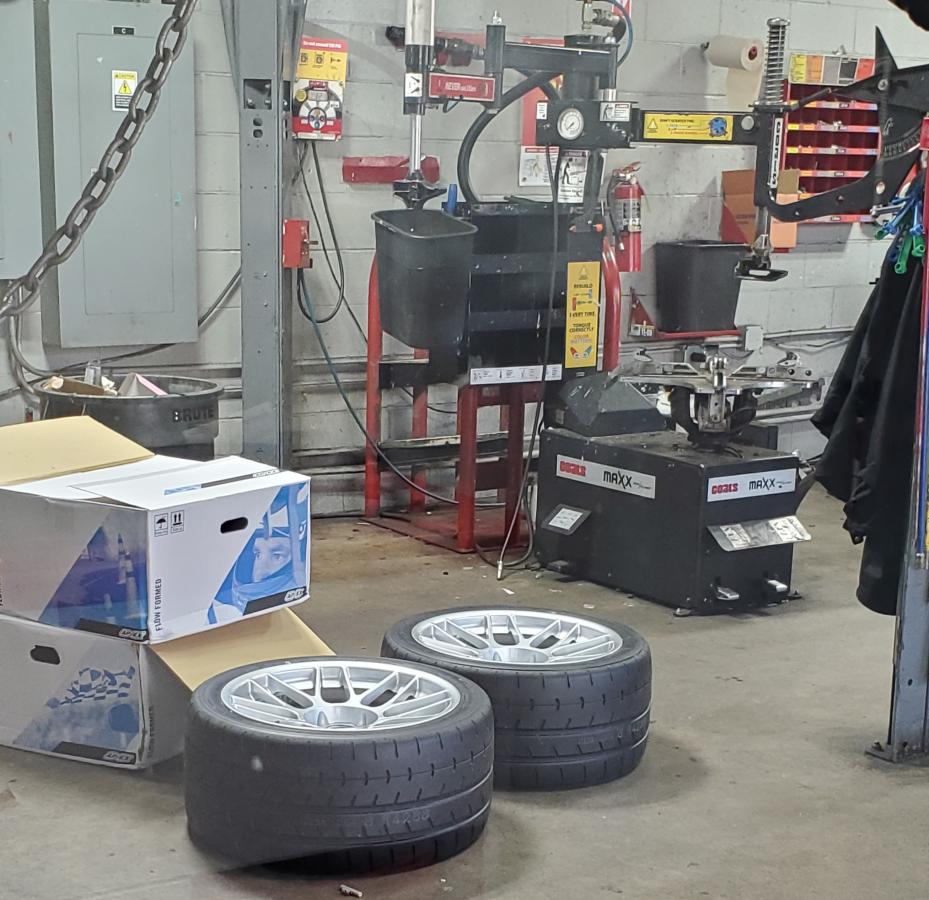

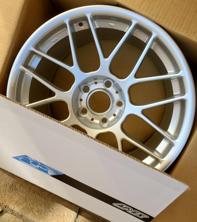

        I was not happy with the 9" front wheel (with 245 tire) - it felt no different (pushing/understeer) than 8.5" but had more tire stretch (I don't like the look). I figured instead of going back to 8.5", I owed it to myself to finally try 9.5" up front.
        I decided to just buy a whole new set of Apex arc 8s since it was BF anyway (like $300 off). I went with 9.5et35 as I didn't want the poke of the et22, and 10"et25 for the rear (same as I already had). I also wanted to go with 200tw tires this time.
        I did a little research and figured I'd need at least 3mm maybe 5mm spacers for the front still, to clear the fat 996 calipers. I also researched tire dimensions, and started focusing on true widths, not the generic "265" figure. I settled on 255/35/18 Yoko A052s since they're about equal in width to PS4S in 265. Then I went with 265 a052 for the rear which are similar to 275 ps4s. I went with yoko a052s are my priorities were dry grip and weight. Light wheels and light tires = me happy.

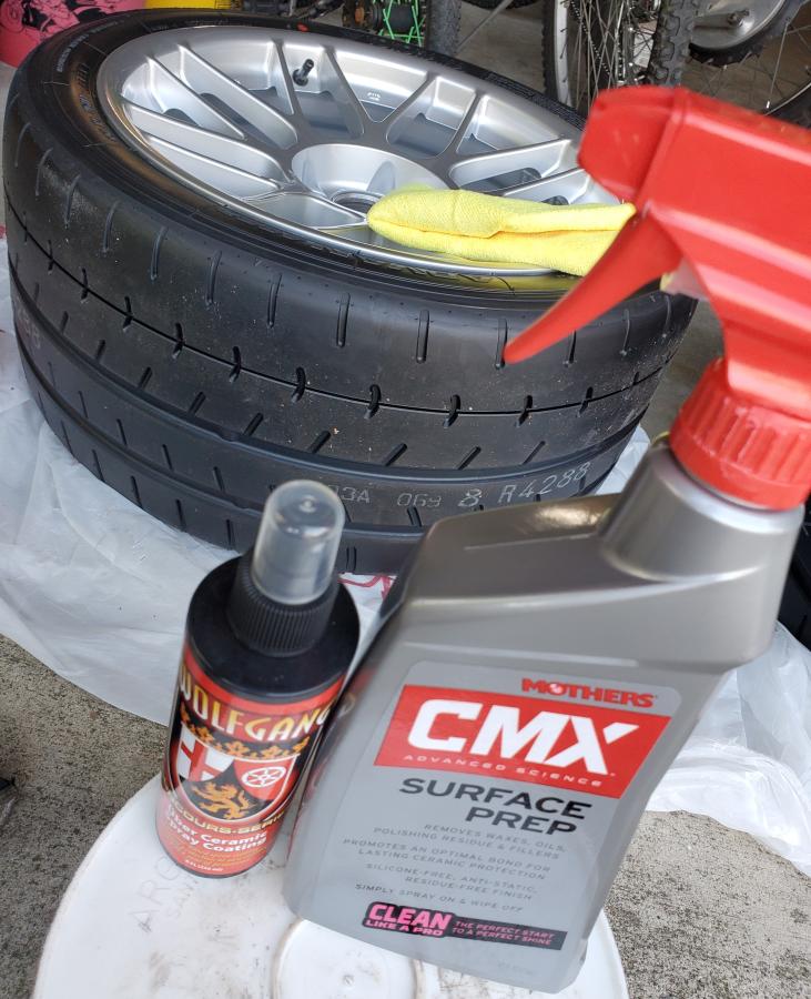

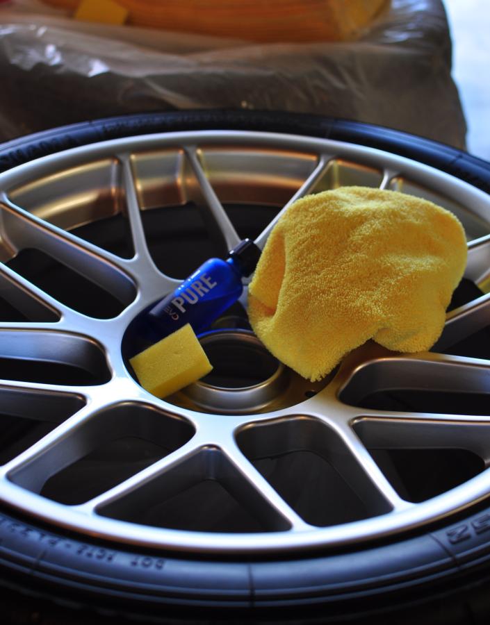

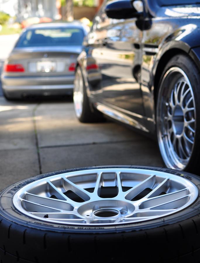

        Once I got them home, I degreased the wheels and tires (tire installation goo). Then I ceramic coated them. I used my best stuff for the fronts, but wanted to try and use up a cheaper, 1 year coating for the rears
        Click image for larger version  Name:	yokoA052fronts (35).jpg Views:	0 Size:	70.2 KB ID:	258671
        Gyeon Pure Evo ^
        Click image for larger version  Name:	ARC8x9.5 (4).jpg Views:	0 Size:	100.1 KB ID:	258670
        Wolfgang Uber CSC for the rears ^

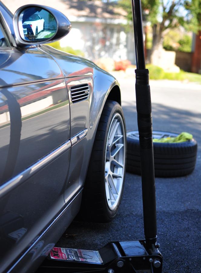

        Ready to install!

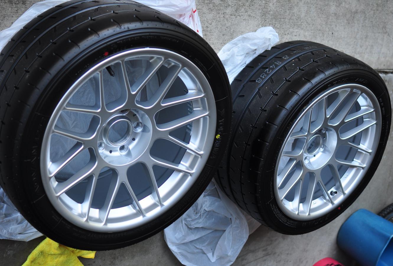

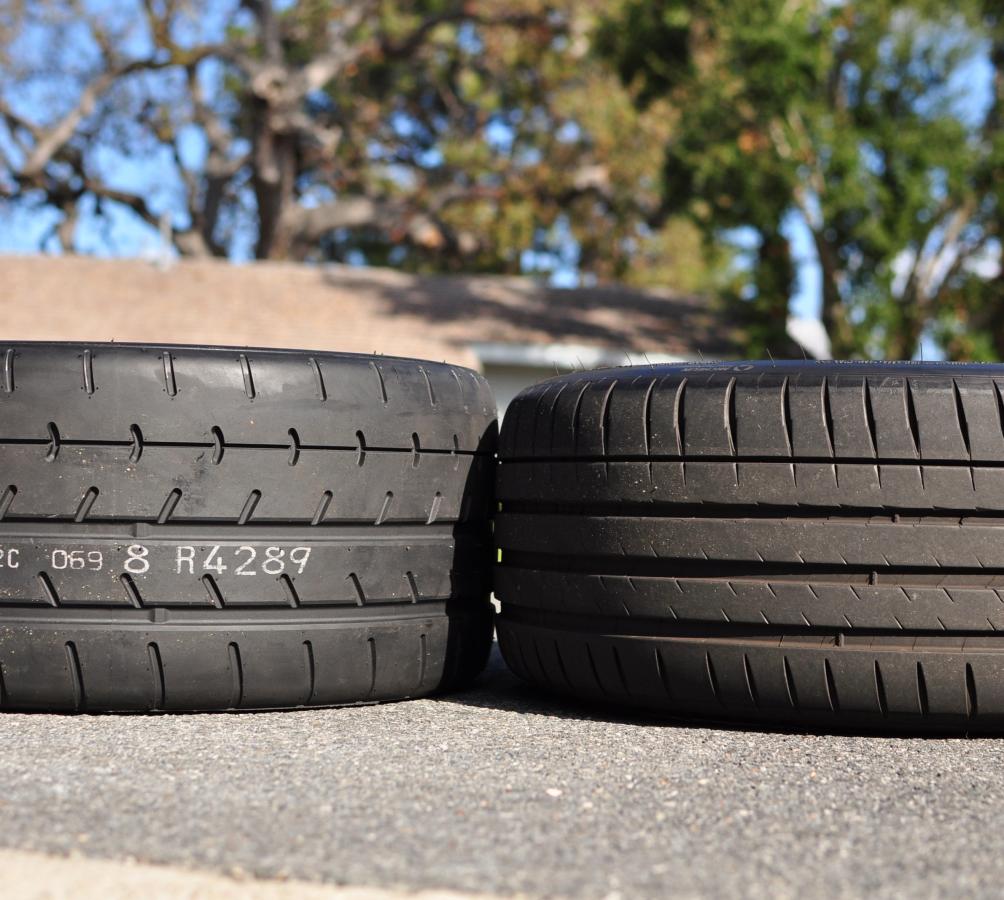

        Here you can see how much wider the actual tread width of the 255 yoko is than the 245 ps4s, though yes the left wheel is .5" wider as well.

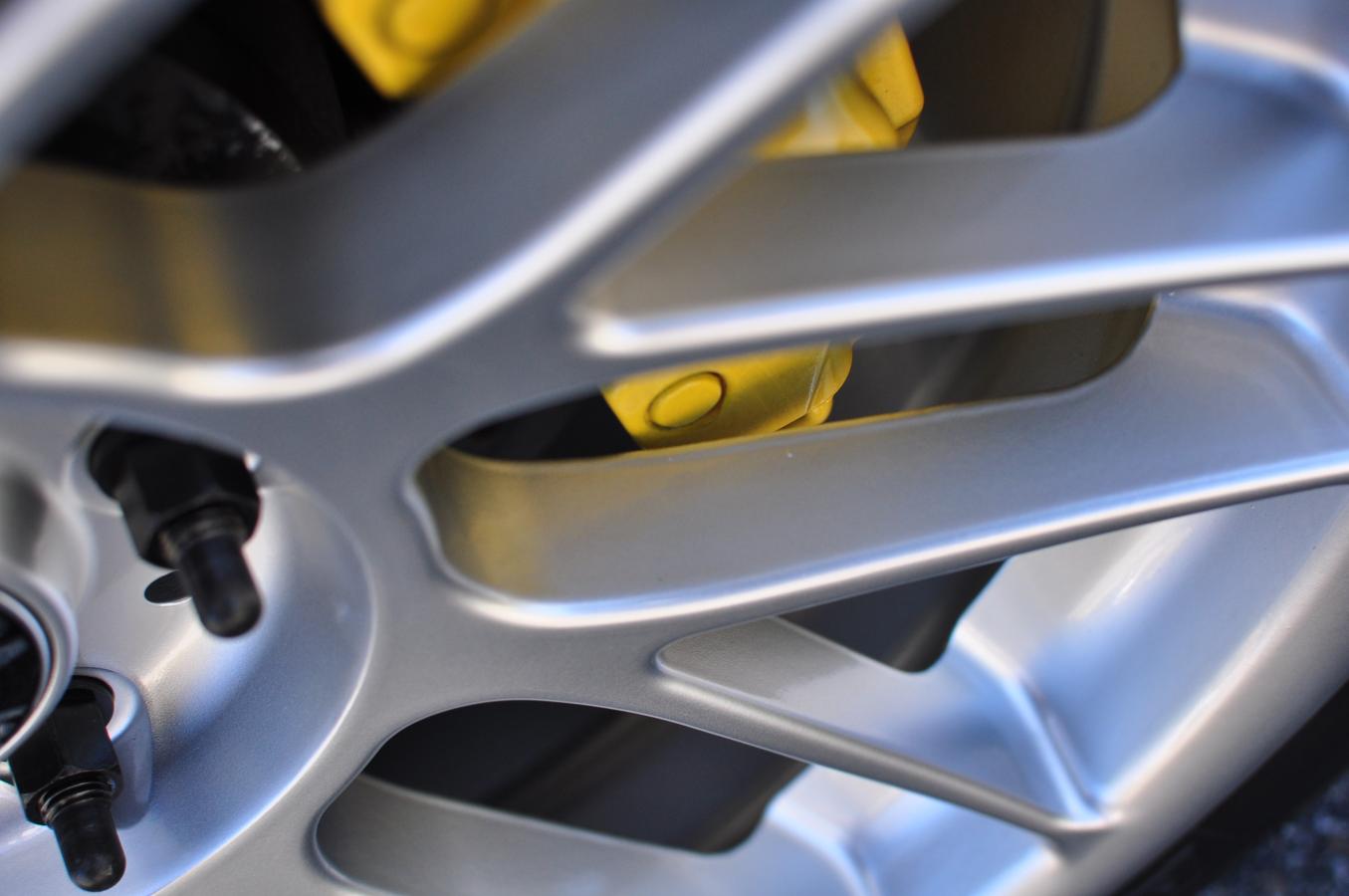

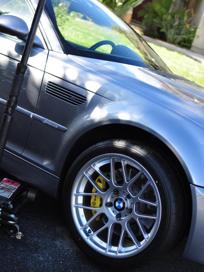

        The 3mm spacer up front was leaving the wheel still a little too close to caliper for my comfort, but 5mm is perfect:

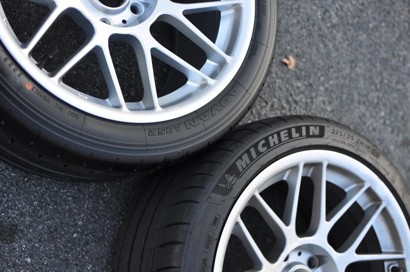

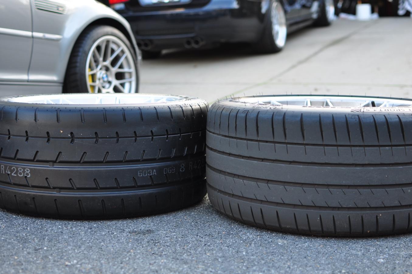

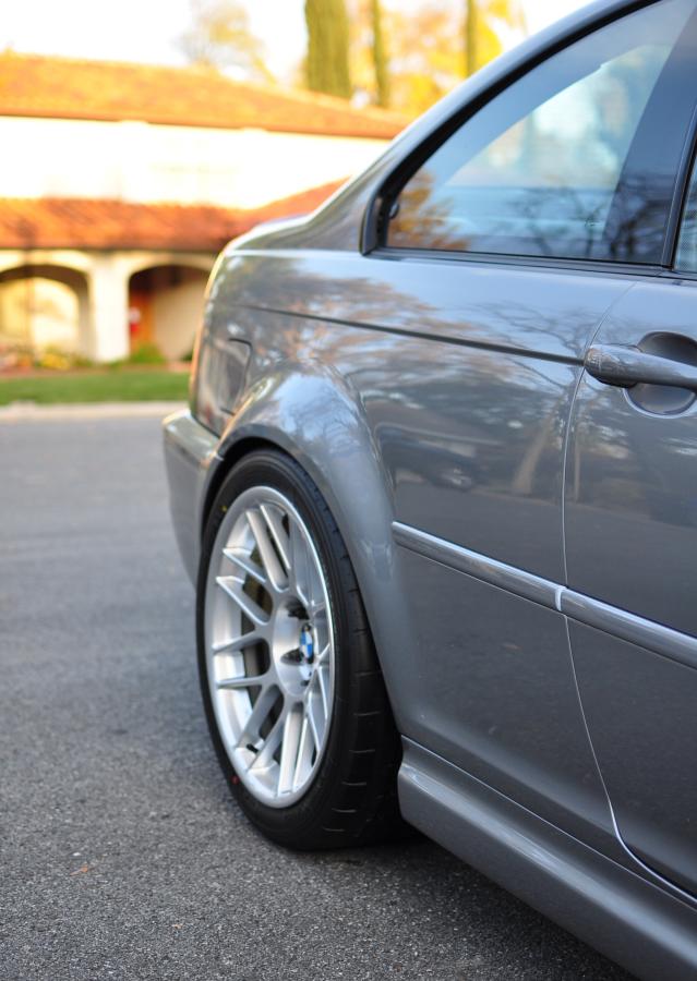

        Rears. 275 Ps4s vs. 265 a052:

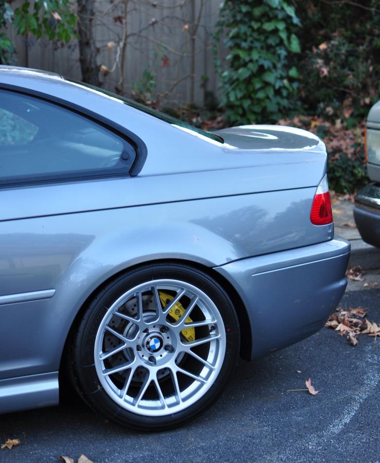

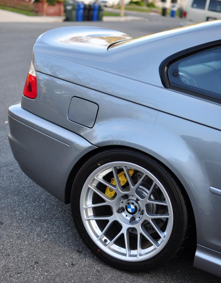

        The rears fit perfectly - I still can use the 3mm spacers to maximize the width, the slightly wider tire just misses the fender. With the 275 PS4s, I still has a couple of MMs of space, so I'm glad there was just enough room for the Yokos and I don't need to bring the wheels inboard at all.
        Click image for larger version  Name:	yoko1stdrive (30).jpg Views:	0 Size:	207.7 KB ID:	258685 Click image for larger version  Name:	yoko1stdrive (59).jpg Views:	0 Size:	219.2 KB ID:	258684

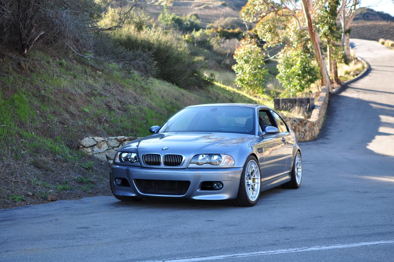

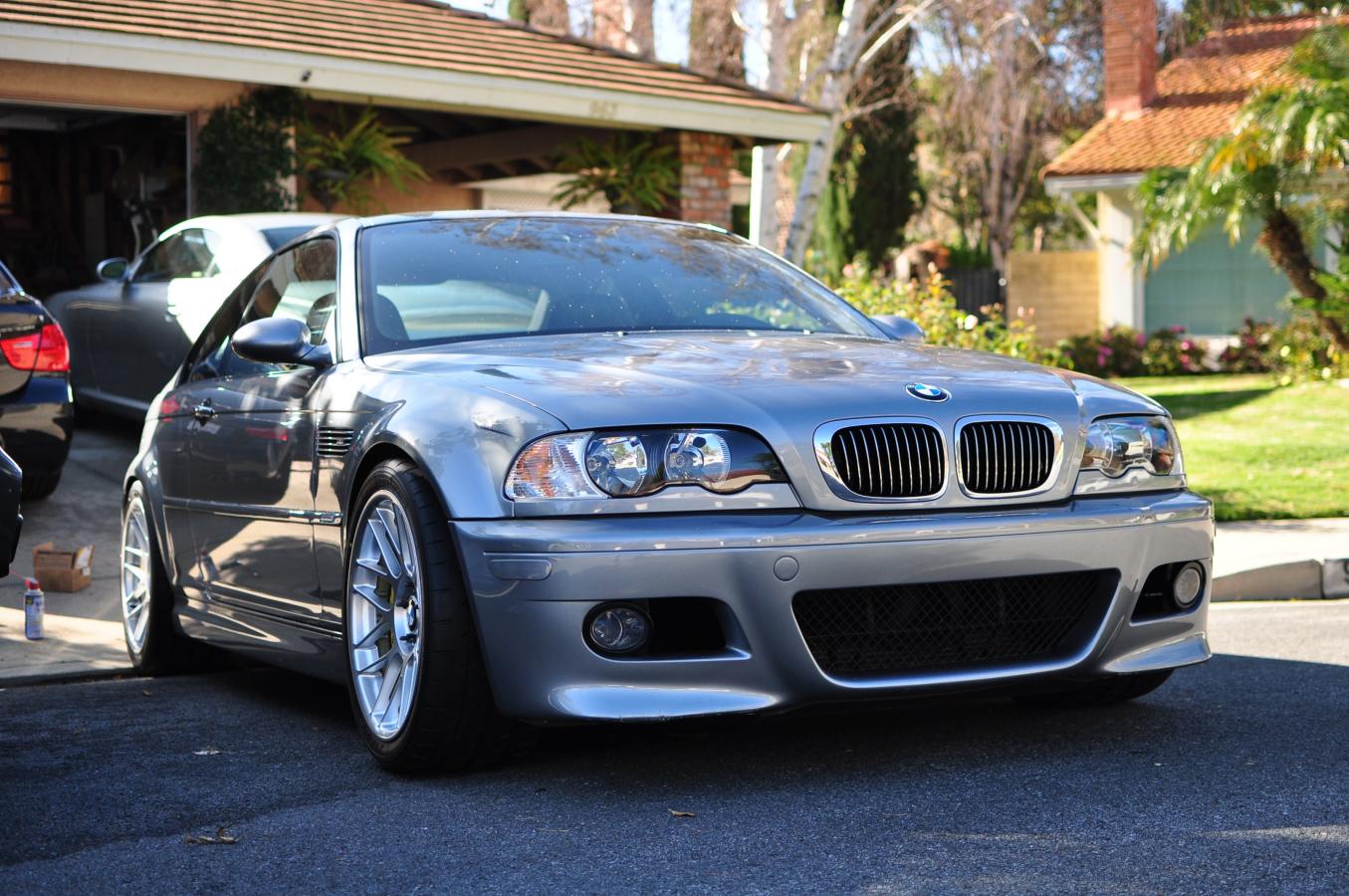

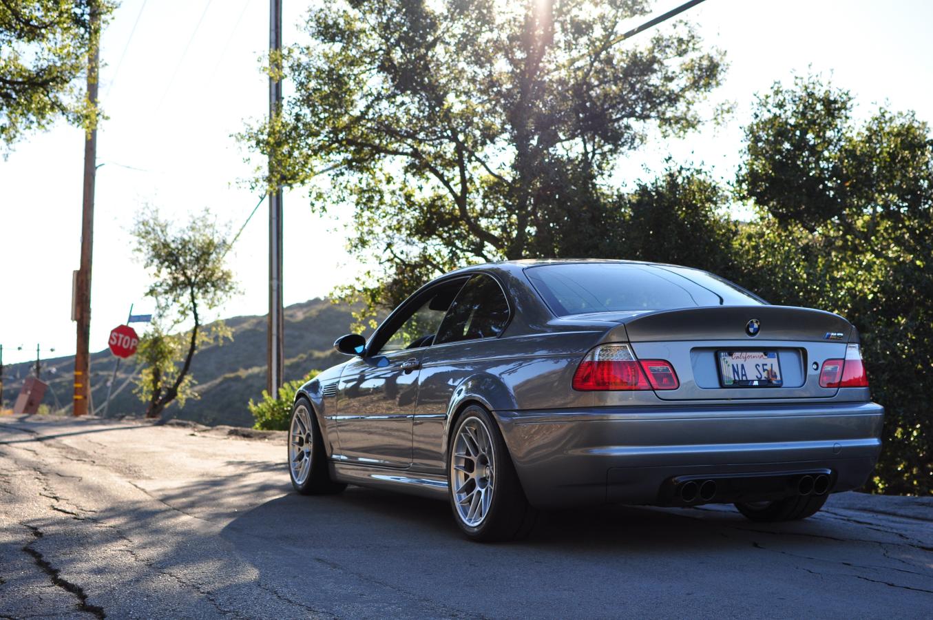

        IMPRESSIONS
        Wow, incredible levels of grip even without warming the tires up or wearing off the mold release agent. I can't imagine how sticky these'll be after a few drives. They are harsher and louder than michelin. I don't feel much tramlining or having to fight the steering wheel much. Thankfully, I have more grip up front, so that was goal #1. I hated the understeer with 225/235/245 up front. Goal #2 was looks - I hate stratched tires on 18s. I love the meatier look. I don't love how the Yokos dip inwards where they meet the rim (zero rim protection). If I were going purely for looks, I should have gotten the Cup2s. Overall, very very pleased in every department except hearing all the little rocks bounce off my fenders.
        Final specs 9.5"et30 x 10"et22 w/ 255/265 A052s 32/34 cold PSI.

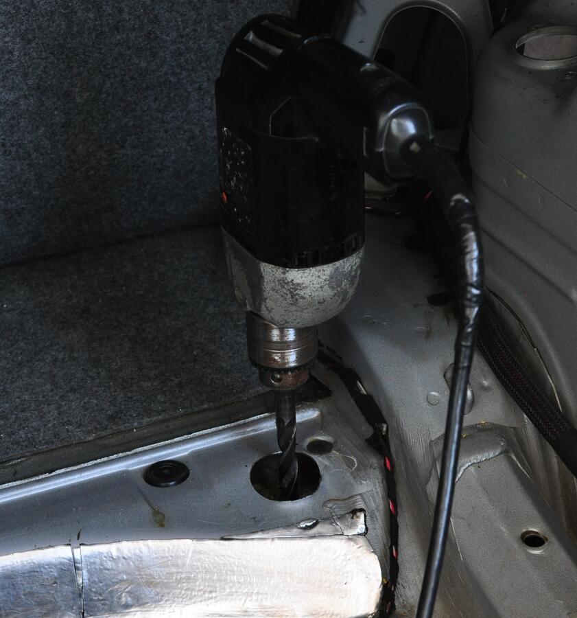

                        Now, we can drill down with 1/2" bit. Had to borrow my dad's big boy drill for this. Harbor freight $20 drill-master was smokin'

                        Question on this if you can remember so far back - to clarify where you're drilling down the with half inch bit it's only until you reach the top of the threaded section right? You're not drilling out the threaded section? I presume that the bolt goes up through the subframe and bolts it to the threaded section in the RACP, and then sticks out the top for the x brace to also bolt to?

                          From memory, you drill it all out. You don't need the threads, you're sandwiching the layers of sheet metal.

                            Hmm, Vince has you keep the threads for his products. You drill up into the trunk with a drill bit that's the same size as the minor diameter of the subframe bolts (~10mm for M12x1.5) and then tap the rest of the insert so you can run the longer studs through. I'm not familiar with the install process for that brace, but I would keep the threads if possible.
                            Edit:
                            Vince posted his cross section sketches here: https://nam3forum.com/forums/forum/m...852#post128852
                            Good visualization for what I described above.

                              Ah bummer - that's something I'm not keen to do….
                              Thanks very much for answering me so quick!

                                Yeah I'd much prefer the solution that you describe. Not keen to make a no-going-back change like drilling the thread out. Will do some more investigation - as you suggest drilling smaller and tapping seems preferable to me.
