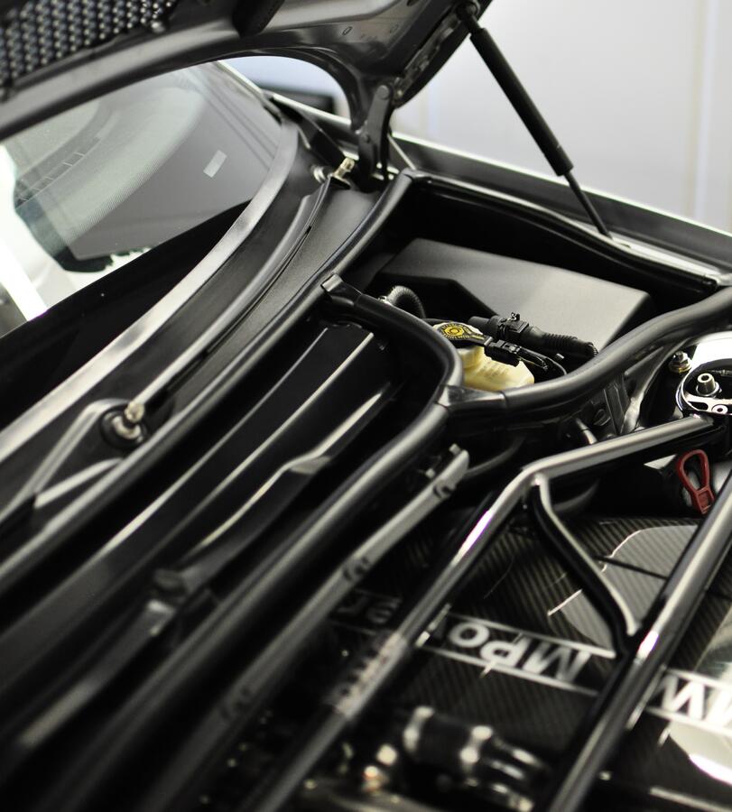

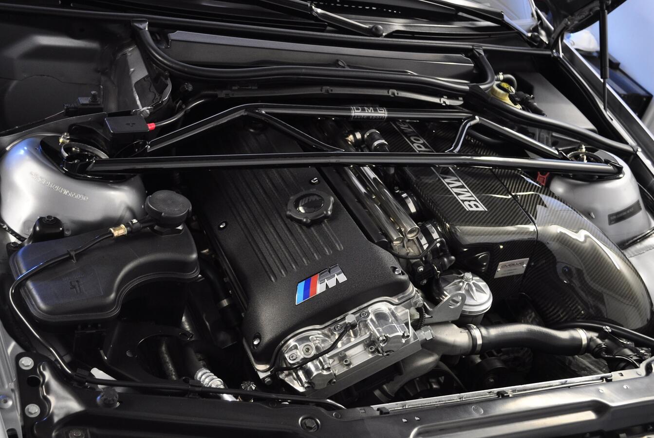

              I was pretty sure at this point that I was buying my wife's uncle's early e46 M3 with no strut bar, and I wanted a front bar with a better "footprint" esp before I upgraded the suspension/chassis any further. I love being able to upgrade one car, and then the "hand-me-downs" can go to the other car.

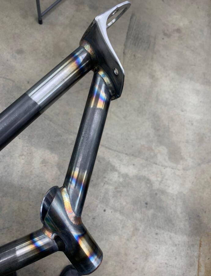

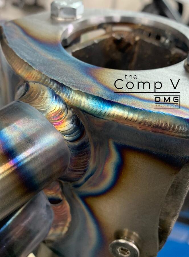

              I had already taken note of some newer fabricators like DMG & SME, because I wanted to further reinforce my RACP. While on IG, I saw Brandon (DMG) post about a GTR style rear bar that he had painted yellow for someone, but they didn't want it, so he listed it at a discount. I took the opportunity to buy it, but also have him throw in the front strut brace at a discount too!
              Here's the "comp-v" before paint. Really nice work.
              Click image for larger version  Name:	IMG_20201015_222137_025.jpg Views:	59 Size:	72.7 KB ID:	115368
              Click image for larger version  Name:	IMG_20201015_222128_484.jpg Views:	58 Size:	63.9 KB ID:	115369

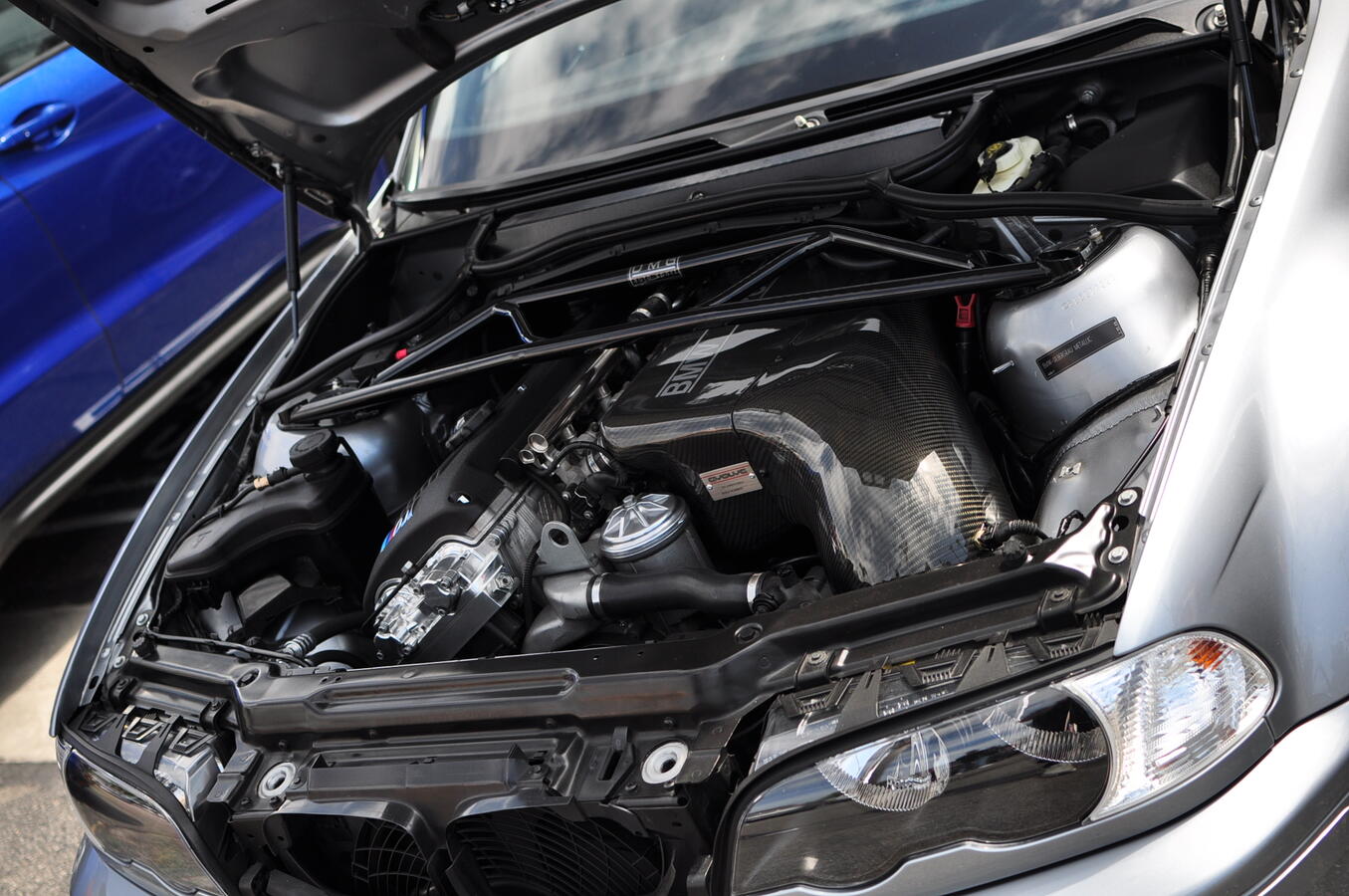

              Didn't take pics of the front bar, you've all seen it before. Here I've got the stock bar off. You can see the 3 little "feet" that the stock bar's mounts use to sit on top of the strut tower. The DMG bar, and others of similar design (Mason might be the oldest, RE too), sit flat on the surface for better distribution of forces.
              Click image for larger version  Name:	1.jpg Views:	57 Size:	49.8 KB ID:	115370
              Good time for a light polish
              Click image for larger version  Name:	2.jpg Views:	58 Size:	57.3 KB ID:	115371
              Click image for larger version  Name:	3.jpg Views:	56 Size:	62.7 KB ID:	115372

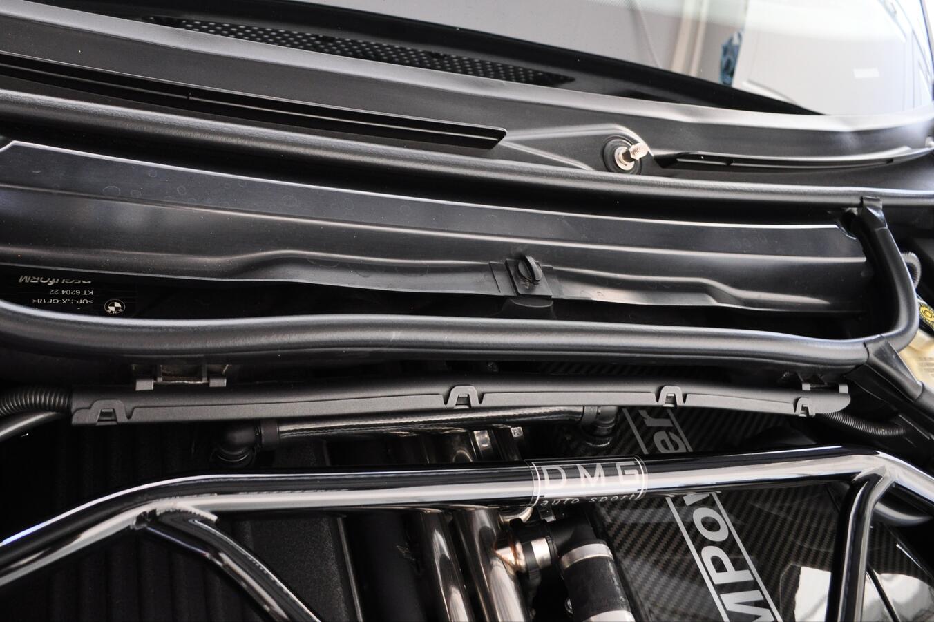

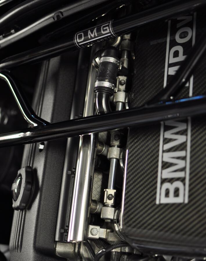

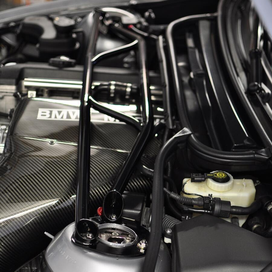

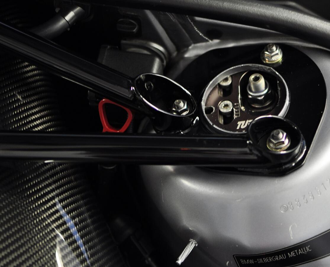

              Bar on and secured. A pretty tight fit, don't tighten one side without getting the other 3 nuts on the other side.
              Click image for larger version  Name:	4.jpg Views:	55 Size:	92.1 KB ID:	115373
              Uh oh, my bent dipstick is now in a bad spot I'll rectify that when the bar comes off again for suspension changes.
              Some more shots of the front bar installed:
              Click image for larger version  Name:	5.jpg Views:	56 Size:	103.3 KB ID:	115374
              Click image for larger version  Name:	6.jpg Views:	56 Size:	71.6 KB ID:	115375
              Click image for larger version  Name:	7.jpg Views:	56 Size:	86.9 KB ID:	115376
              Click image for larger version  Name:	8.jpg Views:	59 Size:	77.0 KB ID:	115377
              Click image for larger version  Name:	9.jpg Views:	58 Size:	162.8 KB ID:	115378

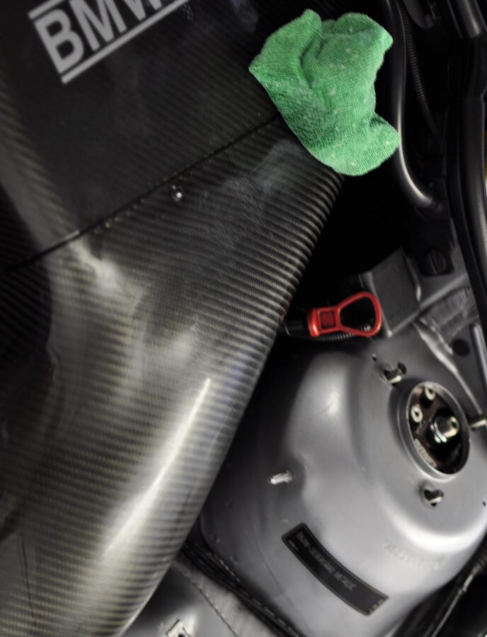

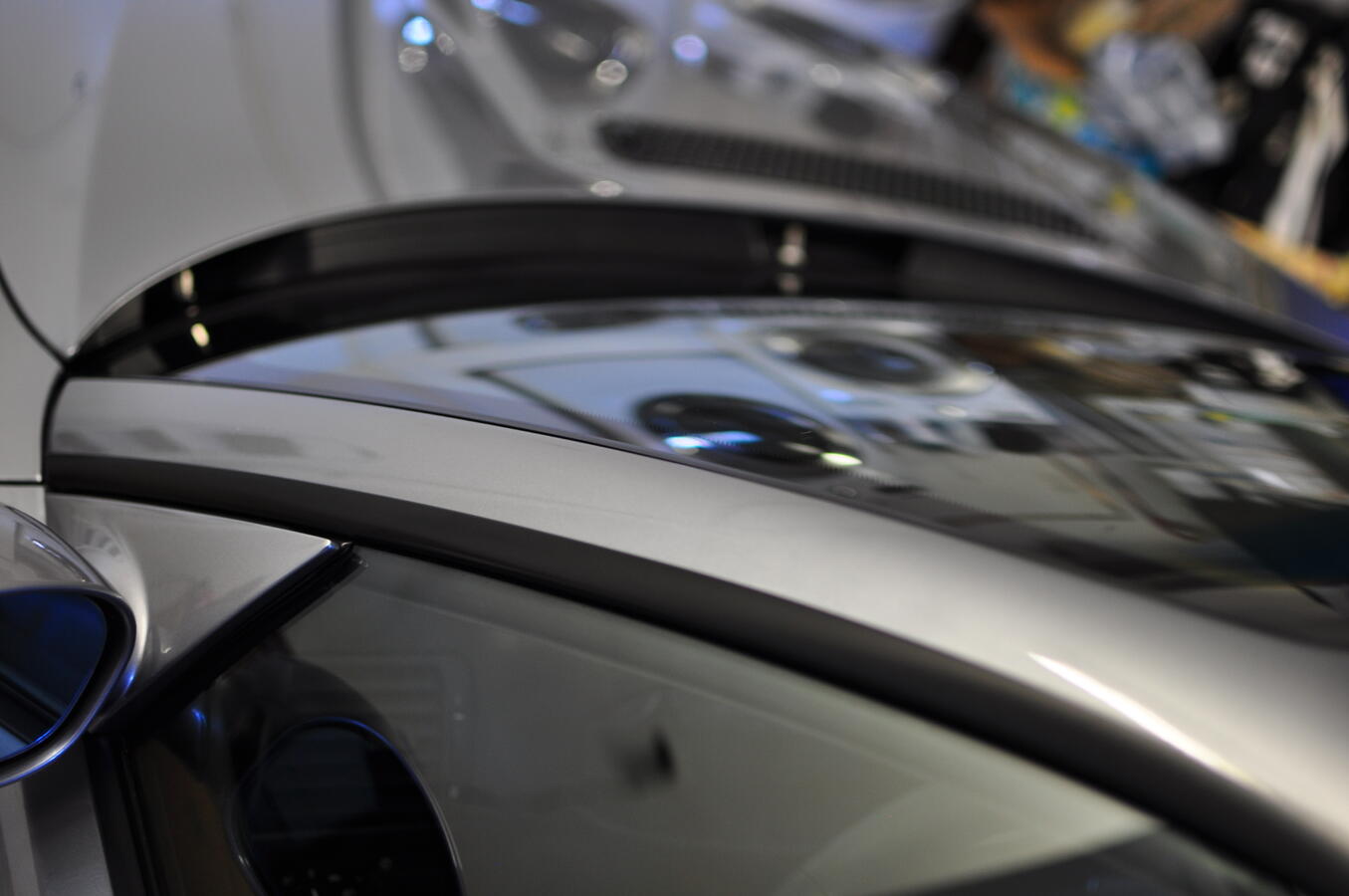

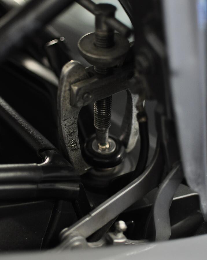

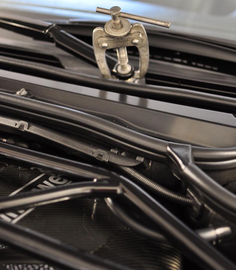

              Before finishing, I wanted to remove the wipers for less weight and a clean look. I never drive in the rain, I barely drive the car much at all.
              Take care when removing the arms. They'll likely be pretty stuck on the splines. Some penetrant helps, but I think it's best to use a puller, at least at first to get it started, then wiggle it off or leverage it off with a flat head. You can crack you glass if you're not careful.

                For safety reasons if something ever spills on your windshield, you won’t have complete vision if you don’t have wipers.
                Small risk it will be non-clear substance, but just an FYI.
                It’s happened to someone I know.
                Paint spilled on their E36 M3 on the road !
                Looks beautiful nonetheless !
                  “Wipers for Less Weight” Awesome!! 😎
                  It actually looks really good wiper less. I rarely use mine as well, hardly ever rains out here in the desert, but when it does it pours so hard they don’t really help anyway.

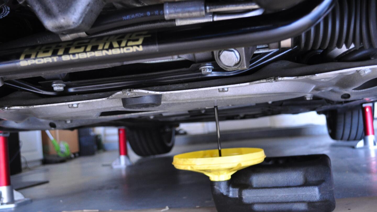

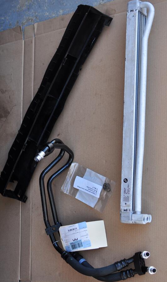

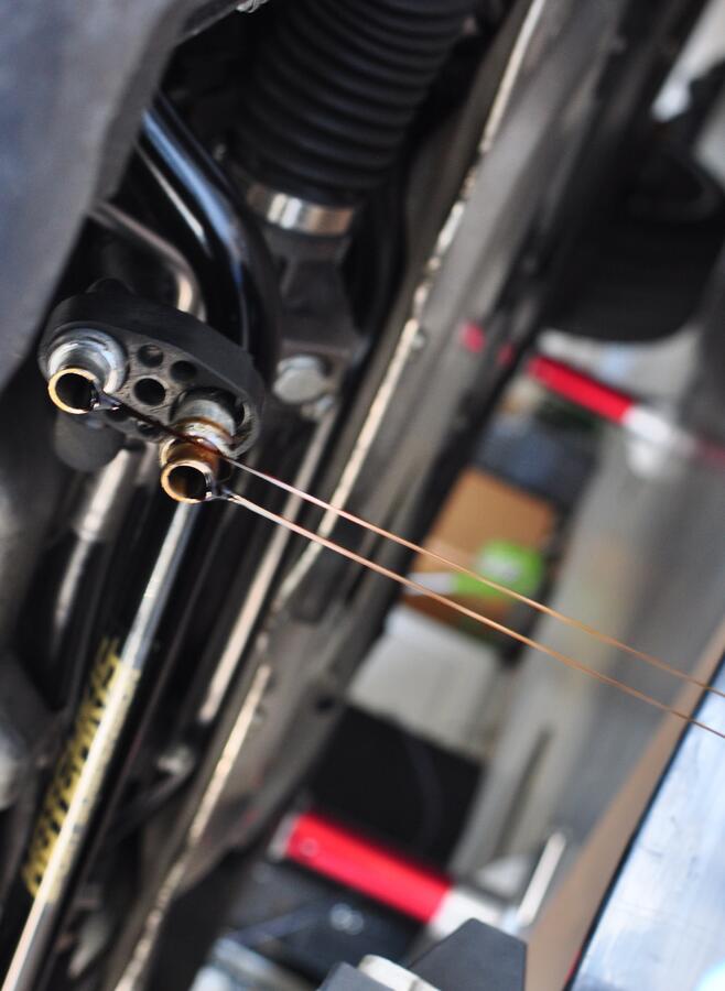

                    On canyon runs, in the summer, even though my cooling system is new, and I use proper oil, my oil temps would creep higher than I thought acceptable. My car has 179k miles, so I was sure the oil cooler was the issue. I also noticed the lines' crimps weeping oil.
                    Timed everything with my yearly oil change.

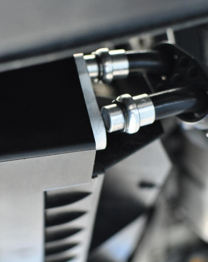

                    Dropped the cooler. Ya, it looks pretty done.
                    Click image for larger version  Name:	3.jpg Views:	0 Size:	59.1 KB ID:	120698
                    Some oil will come out. Center bolt is a 6mm hex iirc (maybe 5mm)
                    Click image for larger version  Name:	4.jpg Views:	0 Size:	52.9 KB ID:	120699
                    Not much oil to worry about up top at the housing. I had to bring the lines up through the rack and frame rail, couldn't go down. Might depend on your airbox situation.

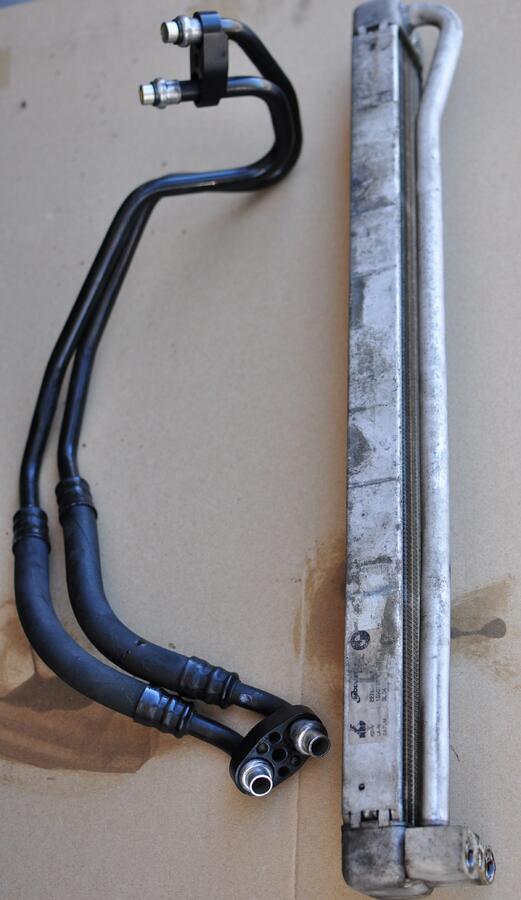

                    Click image for larger version  Name:	5.jpg Views:	0 Size:	86.2 KB ID:	120703
                    Old
                    Click image for larger version  Name:	6.jpg Views:	0 Size:	51.1 KB ID:	120704
                    New cooler, lines, o rings. Cleaned housing. Didn't take a pic, but cooler is made by OEM Modine just like our coolant cooler (radiator)
                    Click image for larger version  Name:	7.jpg Views:	0 Size:	57.7 KB ID:	120705

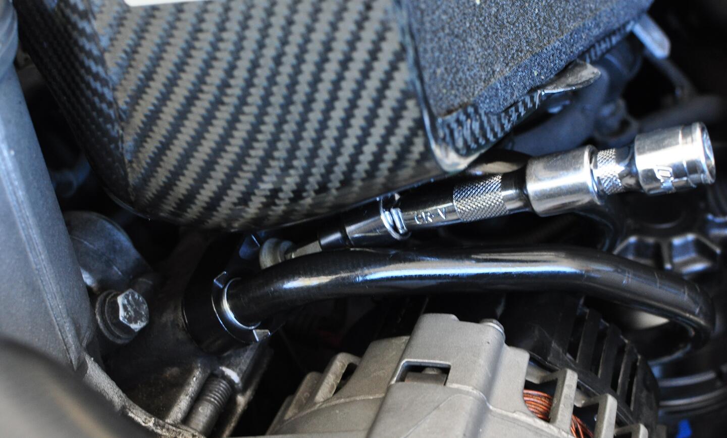

                    New lines going in. O-rings lubed and rolled on
                    Click image for larger version  Name:	9.jpg Views:	0 Size:	94.6 KB ID:	120707
                    Had to use a swivel on my 3/8
                    Click image for larger version  Name:	10.jpg Views:	0 Size:	134.3 KB ID:	120708

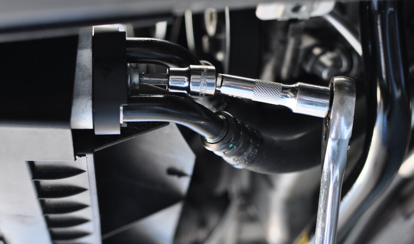

                    Same below
                    Click image for larger version  Name:	11.jpg Views:	0 Size:	38.5 KB ID:	120706
                    And also used the swivel here as sway bar makes it a little awkward.

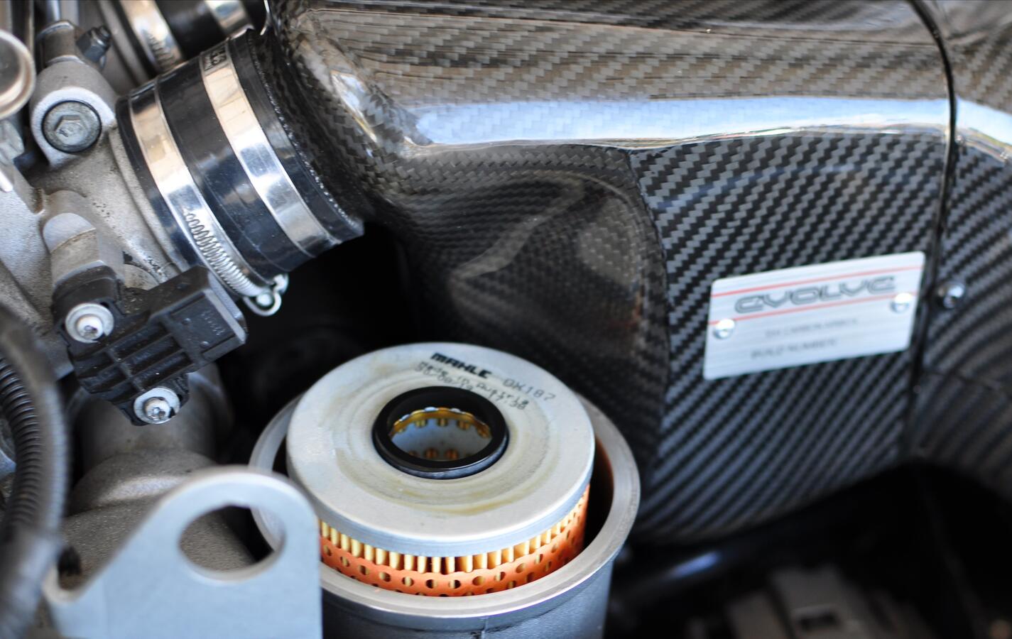

                    New OE Mahle oil filter. Gasket also pre-lubed
                    Click image for larger version  Name:	13.jpg Views:	0 Size:	142.3 KB ID:	120711

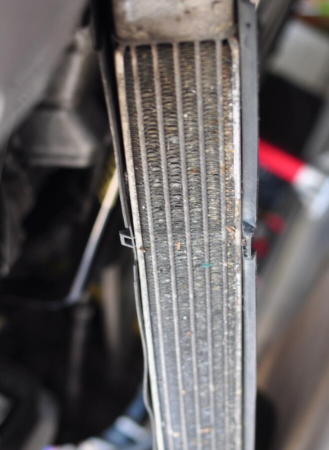

                    The center HVAC filter cover clip had been bothering me for years, but I never took the time to see if I could buy one/replace it. Turns out you can:
                    Click image for larger version  Name:	17.JPG Views:	0 Size:	75.3 KB ID:	120714
                    I think the center one gets faded as it's the most bathed in sunlight (if outdoors). Side ones look good. Simple, but important:

                      Curious to know why you didn't opt for a CSF oil cooler over OE, assuming OE is more expensive.
                        Quality/fit
                        I also got the cooler when FCP had it on clearance

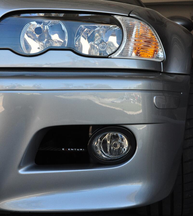

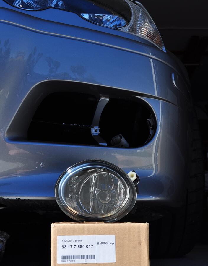

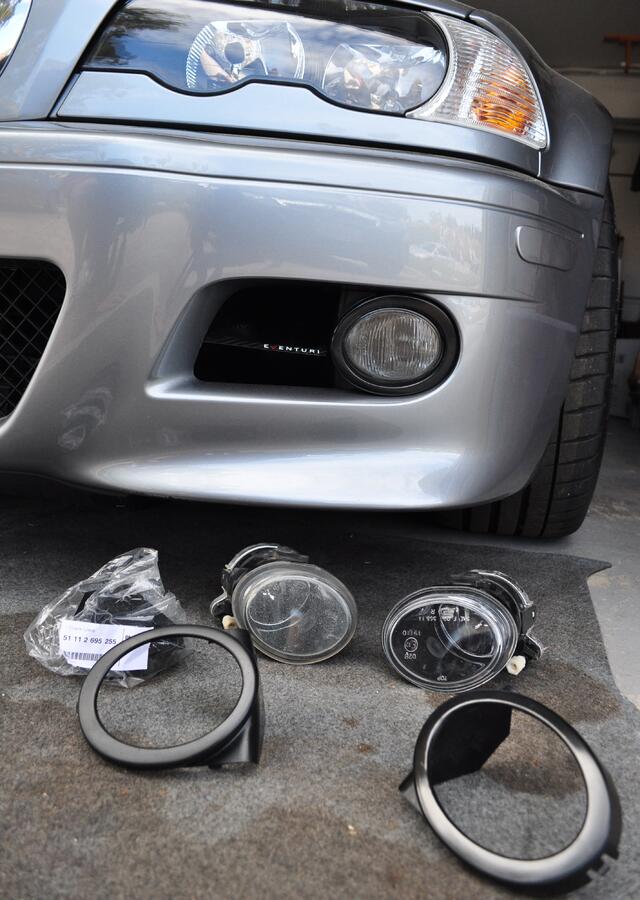

                            Almost caught up to present day. This is the point where I was buying the 2002 Steelgrey coupe. Had some mods/maint just sitting around that I had intended to install for a little while, but became quite busy with the neglected steelgrey car as you can imagine. As I was making progress on steelgrey, I noticed and remembered that there was a change somewhere in production where cars got fluted fog lights over clear ones. The silvergrey's fog lights had about 150k on them (they were uninstalled for ~30k), and were pretty pitted and hazy. Not horribly, but no longer equal to the condition of the rest of the car.
                            The steel grey had a single fog light replaced recently (and the black ring), and it was the clear type. I immediately liked the look of the clear vs. fluted. It also seems to match better with my double halogens. So, I set off to buy one more OE ZKW clear fog, and a new ring, for the other side, and put them on silvergrey. Then move the fluted lights and decent condition rings to steelgrey.
                            Click image for larger version  Name:	fog.JPG Views:	0 Size:	83.3 KB ID:	121742
                            Click image for larger version  Name:	fcp03.JPG Views:	0 Size:	58.4 KB ID:	121740
                            Click image for larger version  Name:	fcp05.JPG Views:	0 Size:	80.9 KB ID:	121741

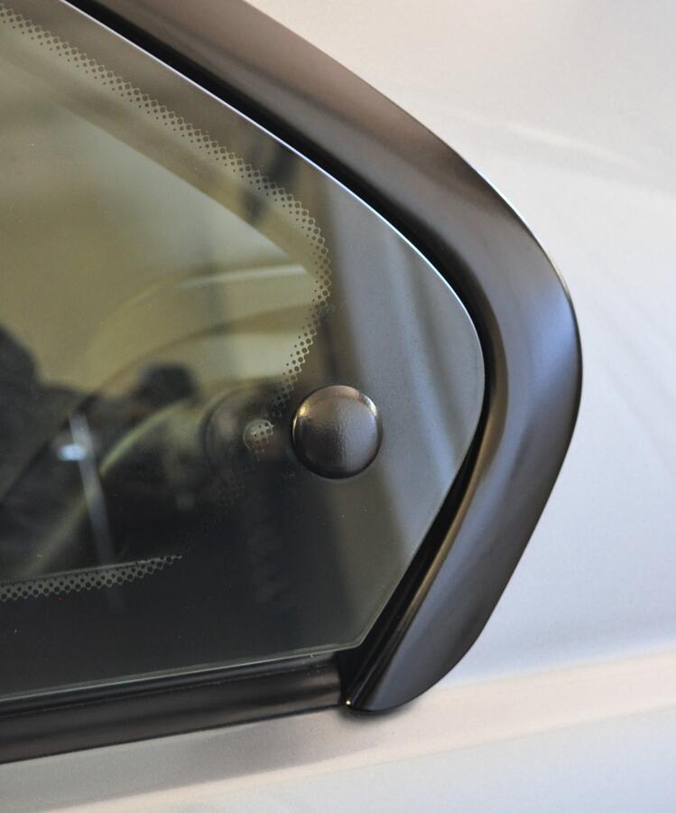

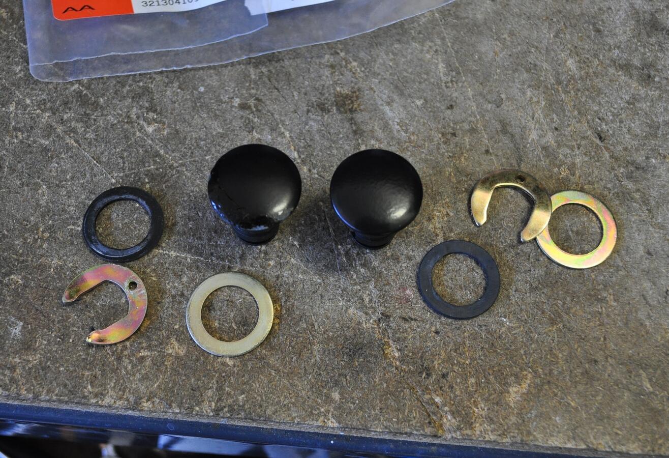

                            The driver side rear quarter glass' black button cap's paint had stared to chip. I touched it up for a few years, but finally dug through RealOEM and, sure enough, you can buy a replacement kit. I didn't need the kit, just the cap, but the kit was only $15 anyway.
                            Click image for larger version  Name:	console01.JPG Views:	0 Size:	167.4 KB ID:	121744
                            Click image for larger version  Name:	console06.JPG Views:	0 Size:	225.7 KB ID:	121745
                            Easy enough of an install. I used pliers to squeeze the spring washer back on, was a little hairy - take care doing so.

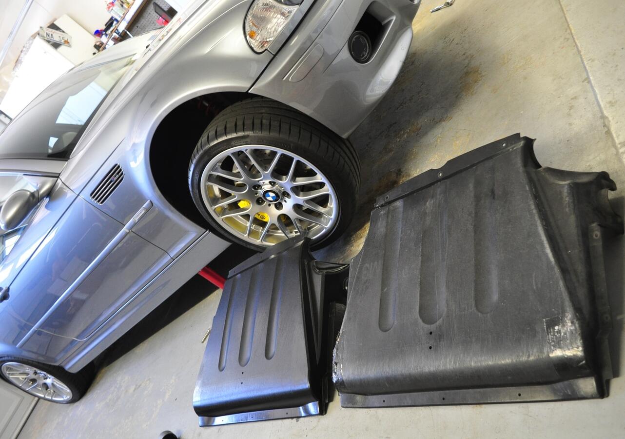

                            Steelgrey didn't have a belly pan, and silvergrey's was also no longer equal in condition to the rest of the car like the fogs. I love these hand-me-downs!
                            Click image for larger version  Name:	belly1.JPG Views:	0 Size:	139.7 KB ID:	121746

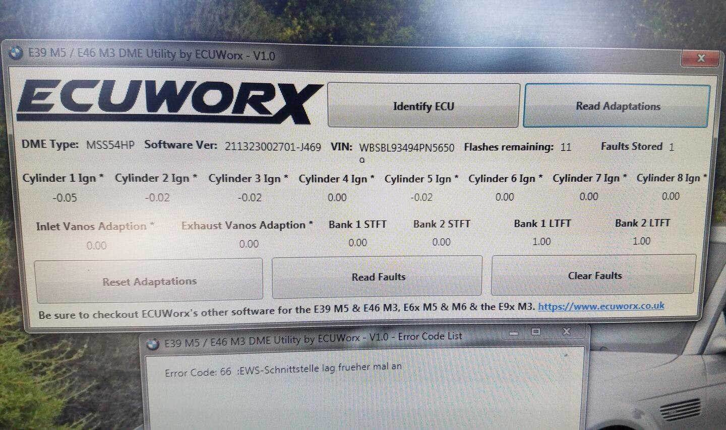

                            Lastly, as I was checking adaptations and codes on steelgrey, I figured I'd have a looksee at how silvergrey is doing
                            Click image for larger version  Name:	20210518_153259.jpg Views:	0 Size:	206.7 KB ID:	121747
                            Ahaha you motherfucker! Fucking perfect, just like it feels. (EWS is a bad key I later replaced)

                            Decent shot of the clear fog light look:

                              The fluted lenses occurred with the 2003.5 update and at first I didn't like them but to me they look a little more high end because you can't see the bulb imho. I prefer it on my because it's period correct but I obviously don't dislike the clear pre-lift one. Always love little touches like plastic trim caps, etc. and such.
