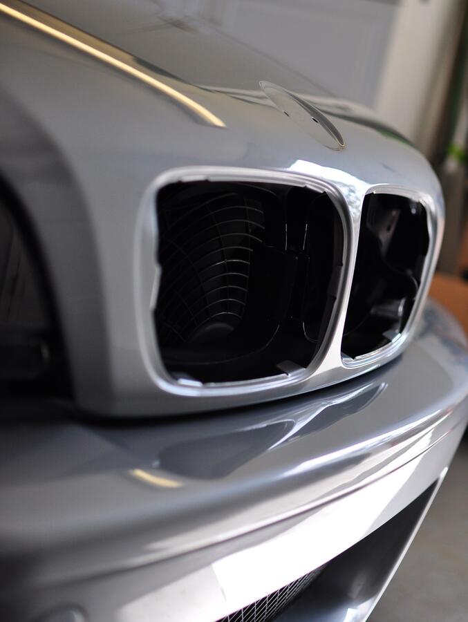

Look at this thing. What a car. This and E39, perfection.
