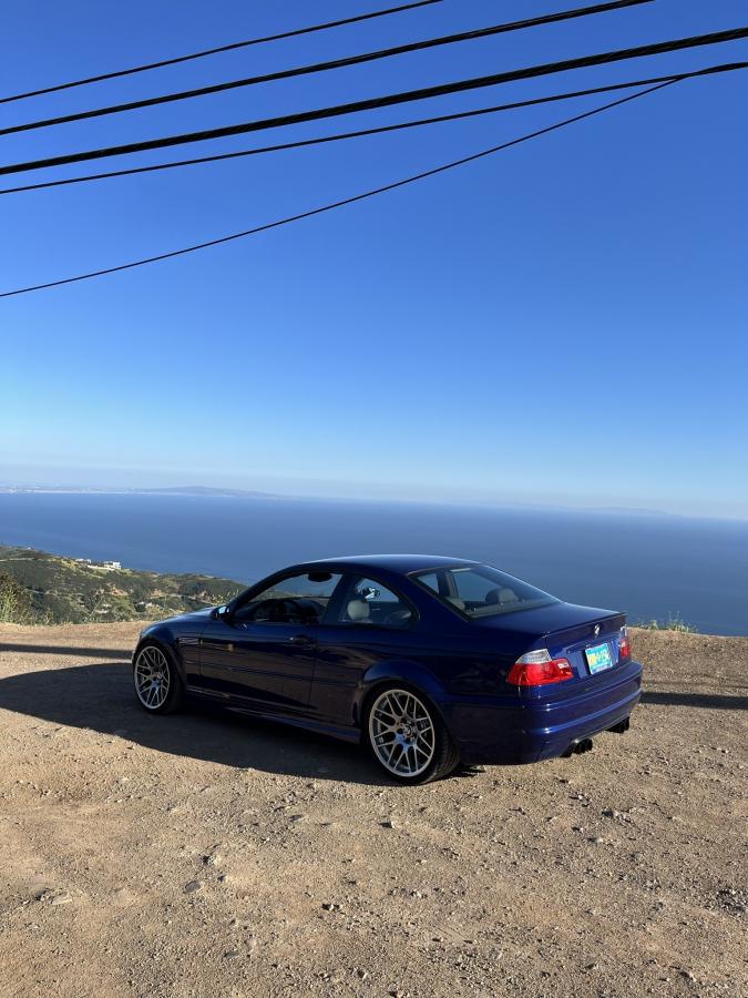

                Considering selling the car, although I likely won’t. I move to London in less than a year for work and it doesn’t make sense to have a car parked in the states for a substantial amount of time. With that said, I likely can’t bring myself to write an official ad so the car will likely go unsold. I wouldn’t even know how to price it.
                With that said I’m really enjoying my time with the car. Oil change and dyno-tune soon, followed by a paint correction and some rock chips getting touched up.
