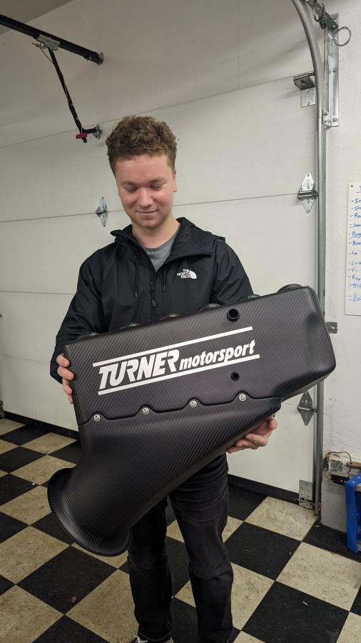

                Time to get rid of the crappy eBay Intake and replace it with something that fits the car. The runners on this are impressively nice!
                I'm also fairly certain the eBay Intake has been causing an issue with the car sputtering at low RPM, and I also think it was negatively impacting power at high RPM. Who'd have guessed - lol!

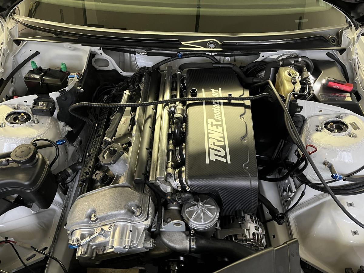

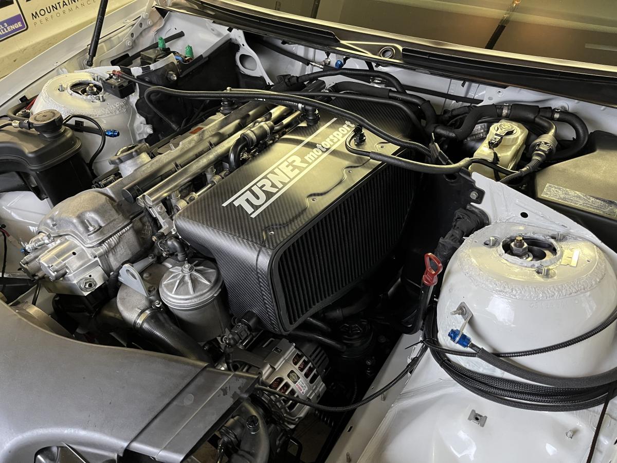

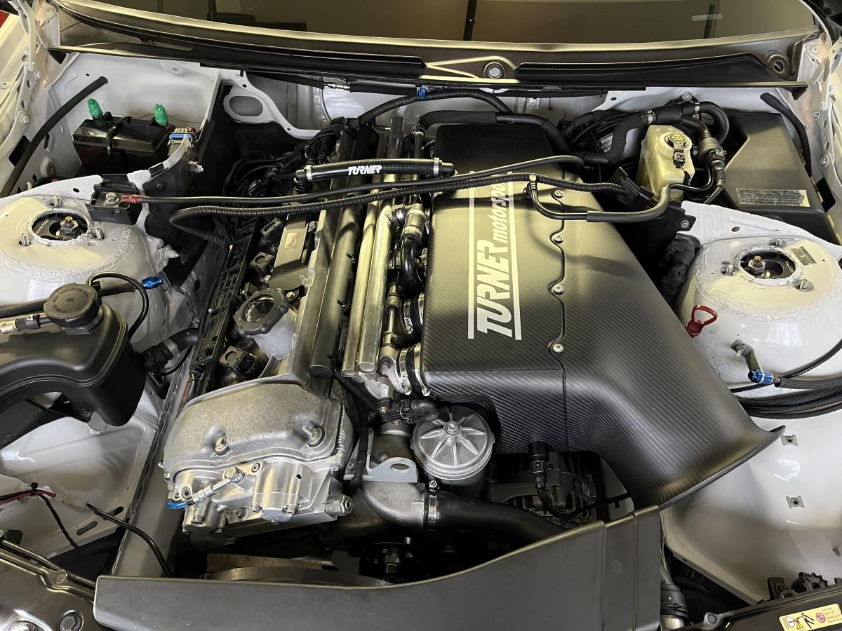

                  Intake Installed. Really happy with it. All of the vacuum fittings fit nicely, snapping into place (they did not on the old manifold).
                  IAT sensor is the clip in style which again is an improvement over the old intake which was threaded but ran out of threads before it would reach the seal...
                  The two piece design is another huge improvement as you can actually service things underneath the manifold by removing just the snorkel, old manifold I couldn't even check Power steering reservoir without removing intake completely.
                  Quality of intake was great, I didn't find anything wrong it. Im sure the Karb piece is just as nice, if not better, but this one being cheaper + simpler snorkel design felt like a better fit for this build, not trying to make a CSL replica here, just looking for the performance improvement.
                  Left the Turner sticker on, I really dont care + didnt want to risk scratching the finish when removing. Also despite ECS being ECS which now controls Turner, this is a great piece IMO. They can have their marketing for now lol.
                  I think the matte finish is a much nicer look but downside is no way to polish/fix any scratches. Well see if we regret this decision down the line.

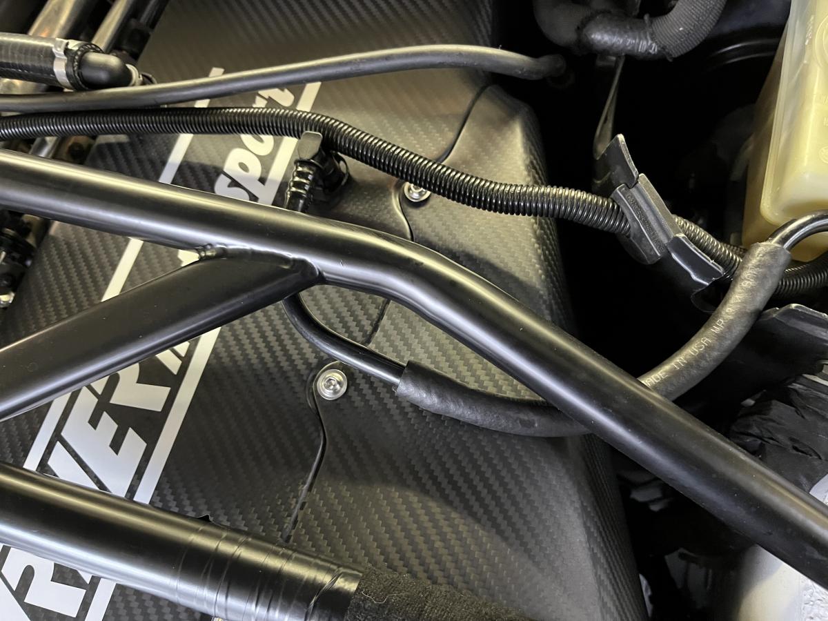

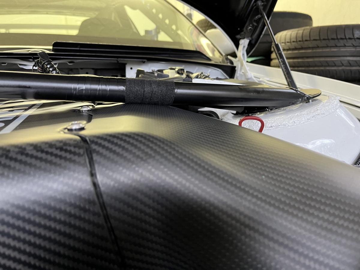

                  As you can see I was able to just twist the vacuum line from brake booster to top of manifold and it fits great.
                  However, when I went to install the Rouge strut bar, it hit this line + more importantly, hit the intake even worse than the old one. Either need to try using spacers or find a different bar.
