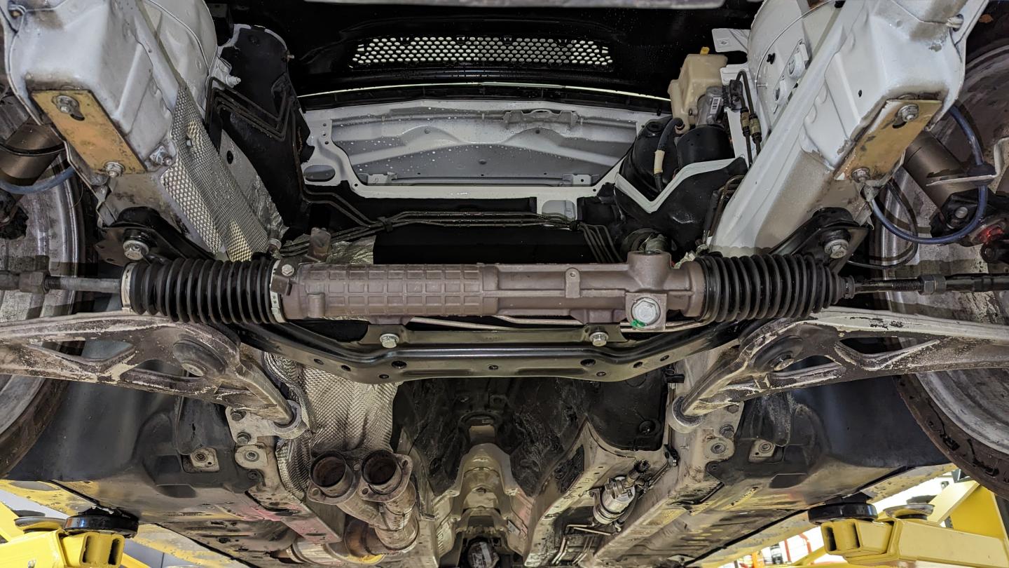

    Got the front suspension/subframe/steering rack apart today. The control arm ball joints did not want to come out of the knuckles. I finally got them out, but the rubber seals didn't make it. Not a big deal, since I'm fairly certain they had never been replaced. New ones ordered. Otherwise, got some cleaning done, touched up the paint on the subframe, and swapped in a Purple Tag steering rack! Including a pic of the interior.

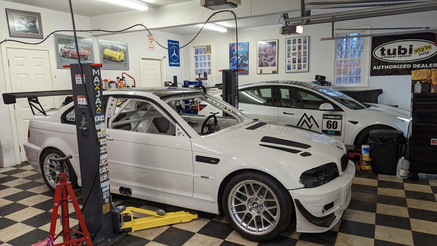

                  Some updates!

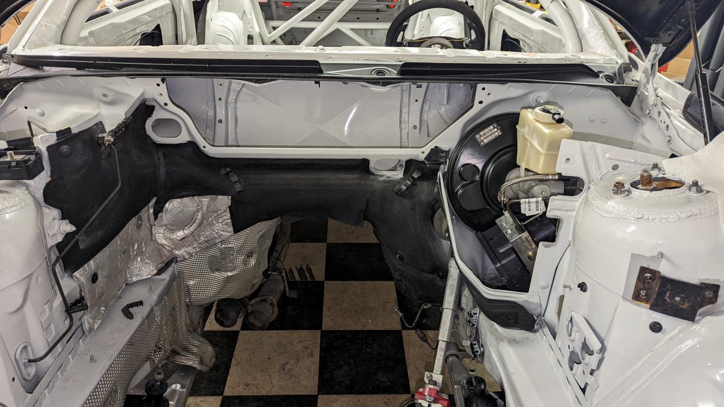

                  The MK60 swap is basically finished, I just need to do the wiring now and get fluid in the system.

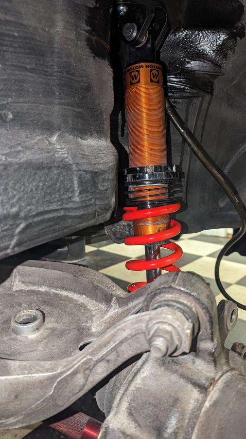

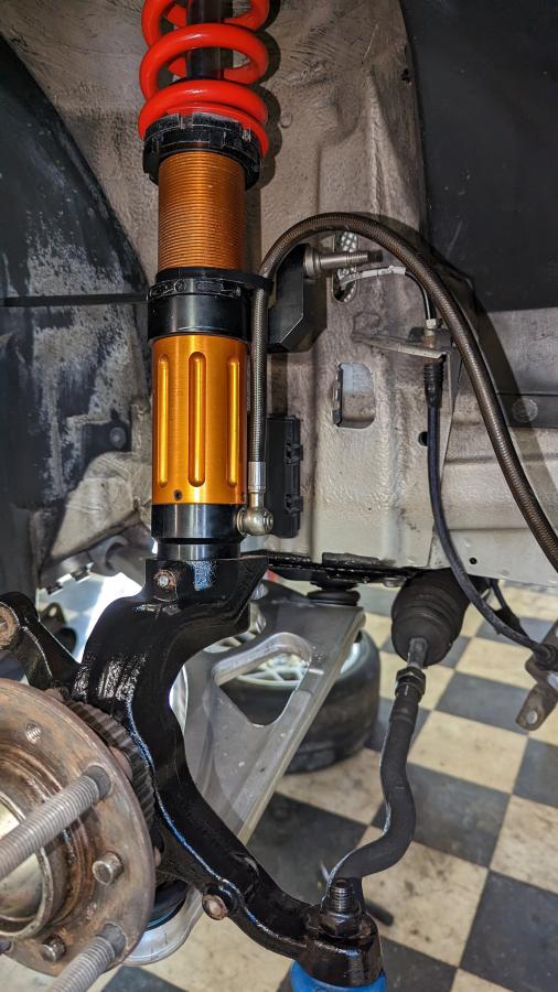

                  The Moton's are installed - once everything else is done will focus on corner balancing, alignment, and damping adjustments.

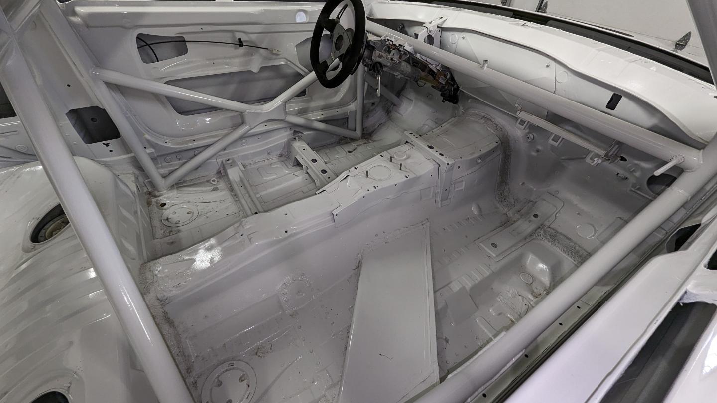

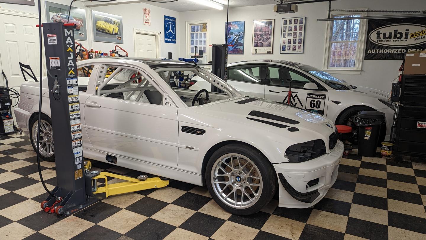

                  Got a lot of the exterior bits back on - tail lamps, wing, trim, some glass, etc. Still a bit to do there.
                  Pedals are in. So manual swap is probably 1/3 of the way done.
                  Motor is nearly complete at the machine shop, planning to pick up next week.
                  Still a lot to do, but making progress!

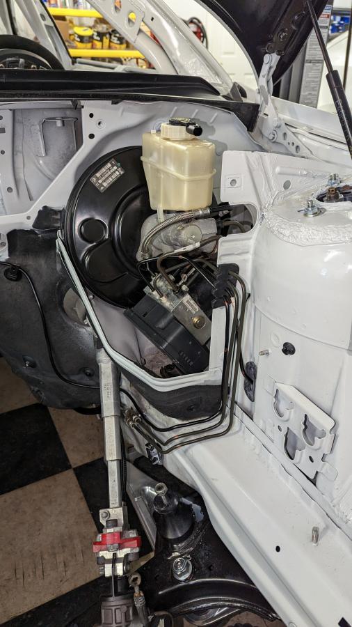

                    Here's a closeup of the MK60 swap. Tapped into the existing rear line connection points, but ran new lines everywhere else. These are not easy to bend!

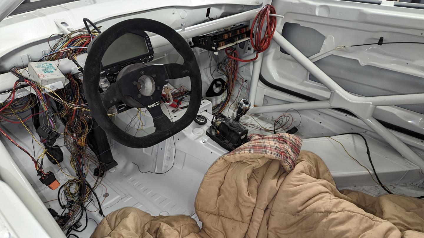

                    Also a picture of the current wiring (mess). Will be splicing in the MK60 Connector and cleaning everything up, and deleting the things no longer needed (SMG, EWS, etc).

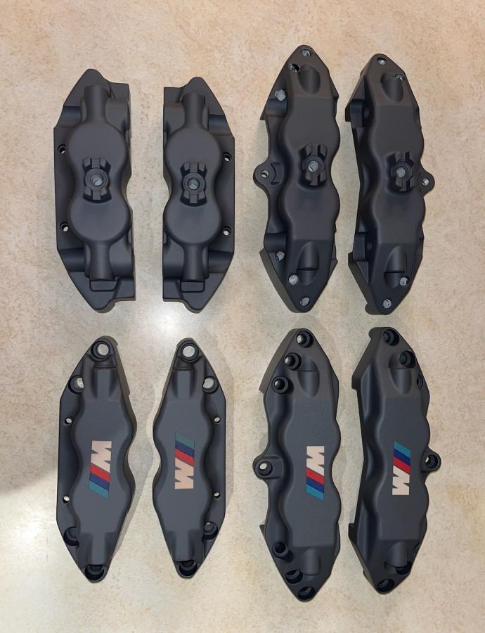

                      Small update - received the Rotora Calipers back from powder-coating. Are they the most fantastic brakes on the planet - no. But, they worked perfectly fine before, and given the car is ~2,600lbs and won't be making more than 350whp, it won't take a mega amount of brake. One advantage is that they are very light - I'll post final weights later but my recollection is ~5lbs for the rears and ~8lbs for the fronts. Paired with CSL rotors and good pads it's more than enough. Will be getting all new hardware as well.

                        Awesome updates. Do you mind posting some pics of the steering column mounting to the roll cage?
                          Nice work!
                          Like the MK60 swap. Job is a pain on a street car, but probably not as terrible with the engine and interior out. Good call on tapping into the rear lines, making new rear ones was easily the worst part when I did mine.
