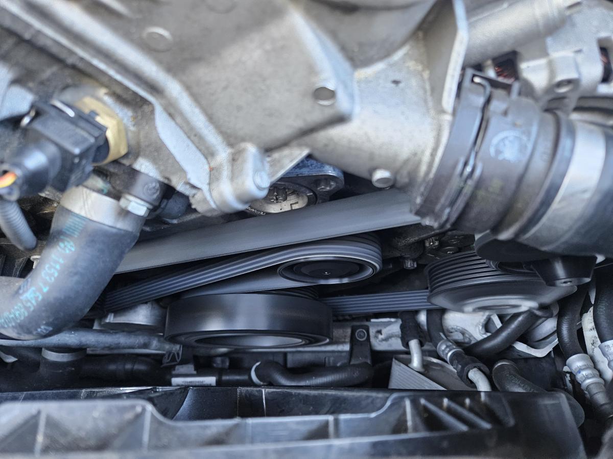

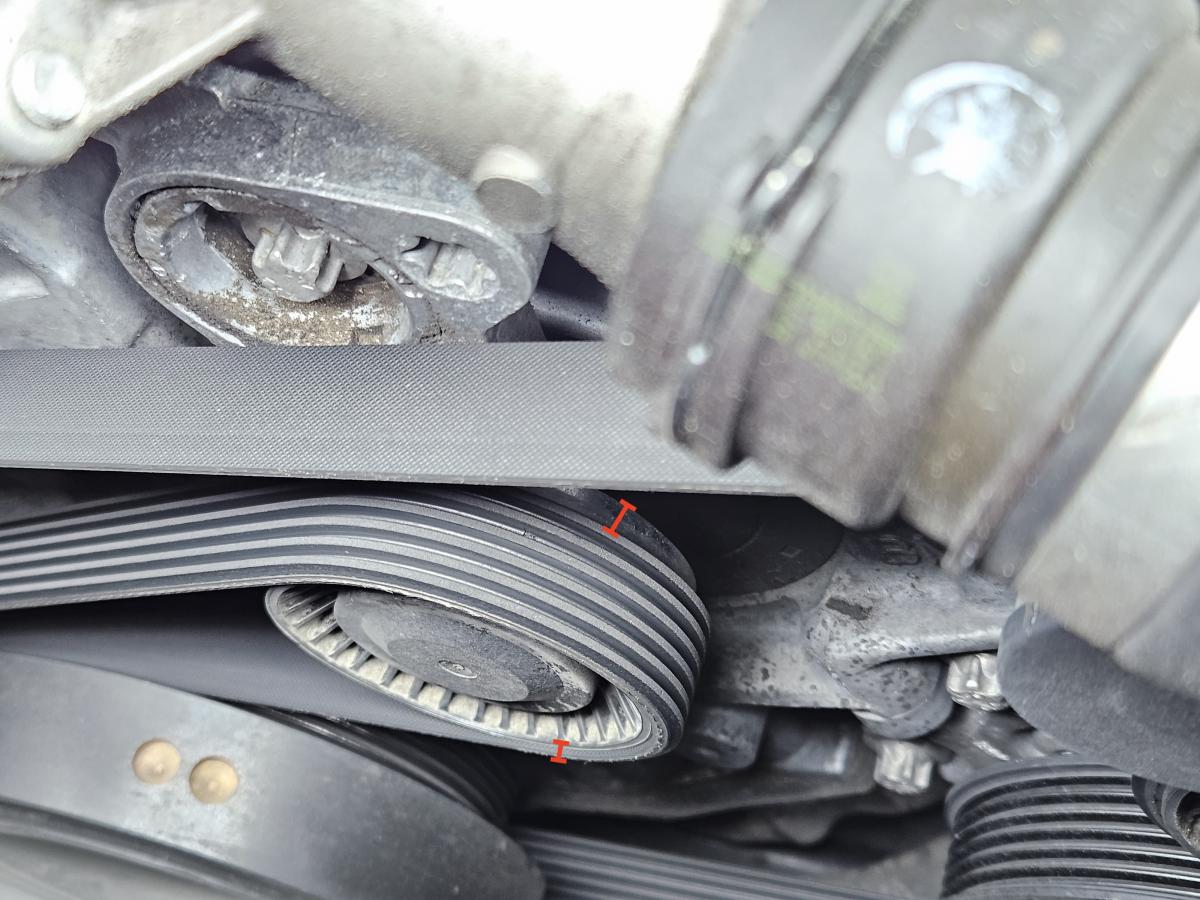

            Grabbed some tools from tlow98 yesterday and we did a quick walkaround the car. He noticed the engine is getting ready to eat the accessory belt:
            Still have some parts are in the garage that I haven't installed, so I guess I gotta plan for a work day on this car soon. M3 is almost done, so should be able to get the following done in the next couple weeks:
            • Swap tensioner
            • Swap idler
            • Swap belt
            • Swap spark plugs
            • Swap power steering fluid
            PS fluid will be done the lazy way. Siphon out everything in the reservoir and refill, then cycle fluid through system. Do this a few times to get mostly new fluid in there. After that, I'll just siphon and refill every oil change.

                  Tensioner, idler and belt done. Looking much better:
                  Click image for larger version  Name:	20230910_172256.jpg Views:	0 Size:	122.4 KB ID:	233014

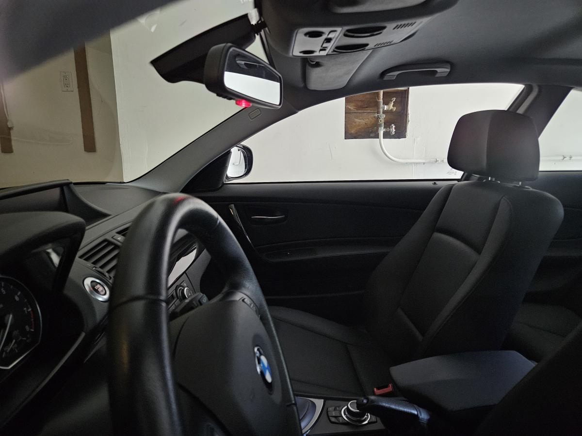

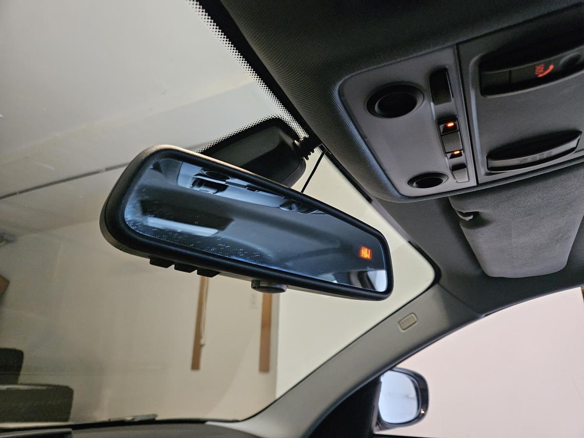

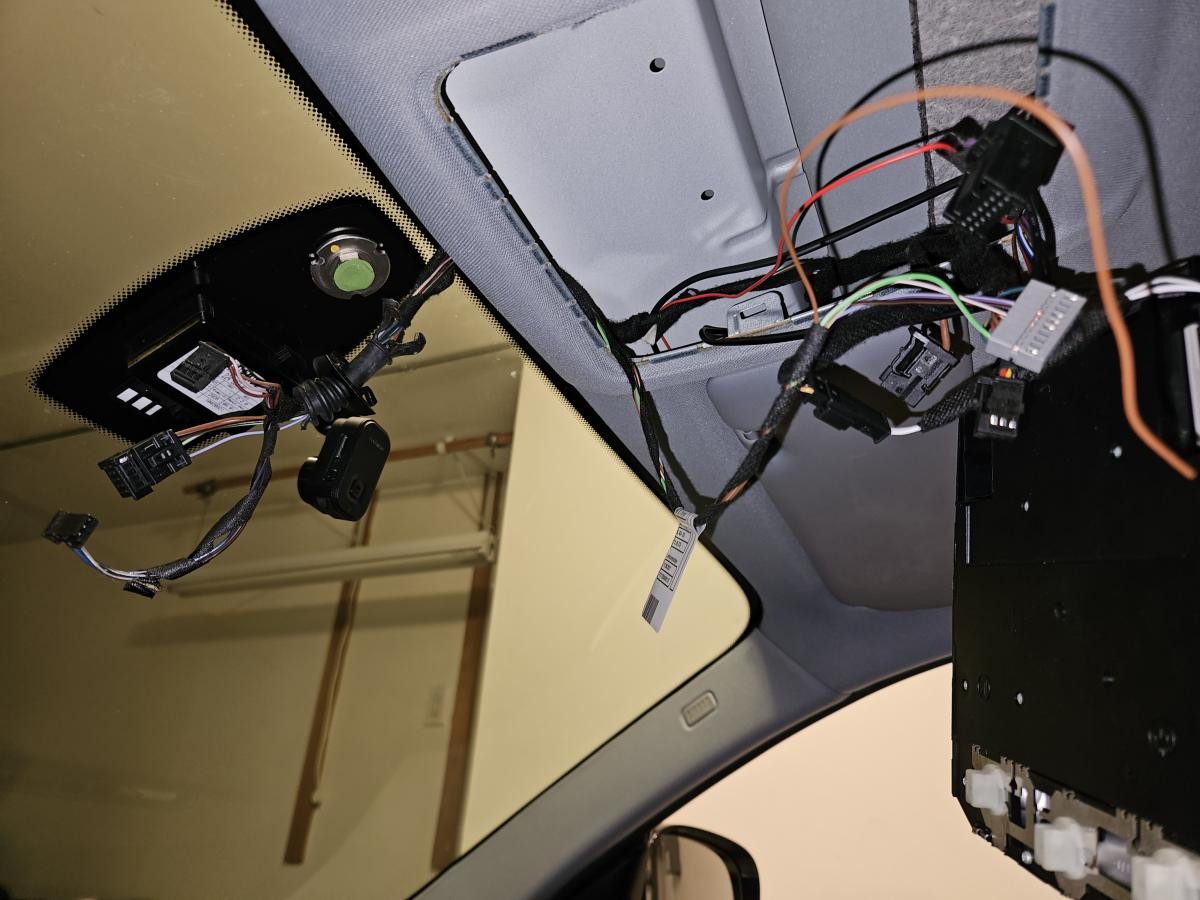

                    Picked up a mirror with homelink, compass and the stubby grey clown nose. Car came with a completely manual mirror, not even auto dimming. BMW sells a retrofit kit for this, so I got that too, but in retrospect, I should have just made it myself. Ended up just using like 5 wires from the kit and still running a coupe more of my own, oh well.
                    Harness ran through the grommet and plugged into the appropriate connectors on both sides. I just followed the mirror wiring diagram on TIS to know where to plug these in (BMW E82 128i Coupe/Wiring Diagrams and Functional Description/Body/Mirrors/Interior rear-view mirror, compass, garage door opener/):

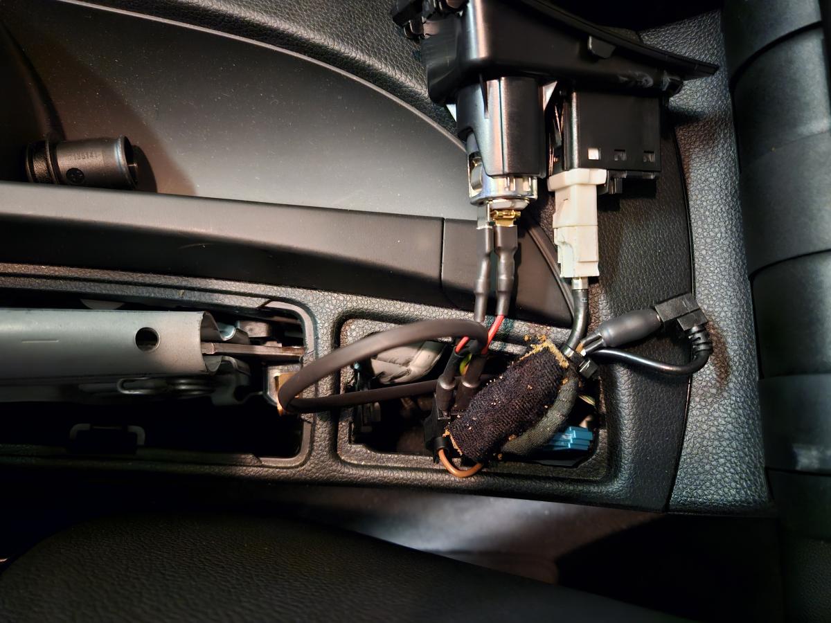

                    The BMW retrofit harness has you tap into a ground to add another ground wire. I didn't want to do that, so instead I just wired the ground into my little breakout board. The harness also does not come with the constant power wire for the LED, so that too got wired to the board. I added a connector for the ground and power wires for easy removal/service:
                    Last wire to run was the signal wire for the LED. That one just went straight from the FZD to the mirror, so no pics of that.
                    And done:
                    LED works too:

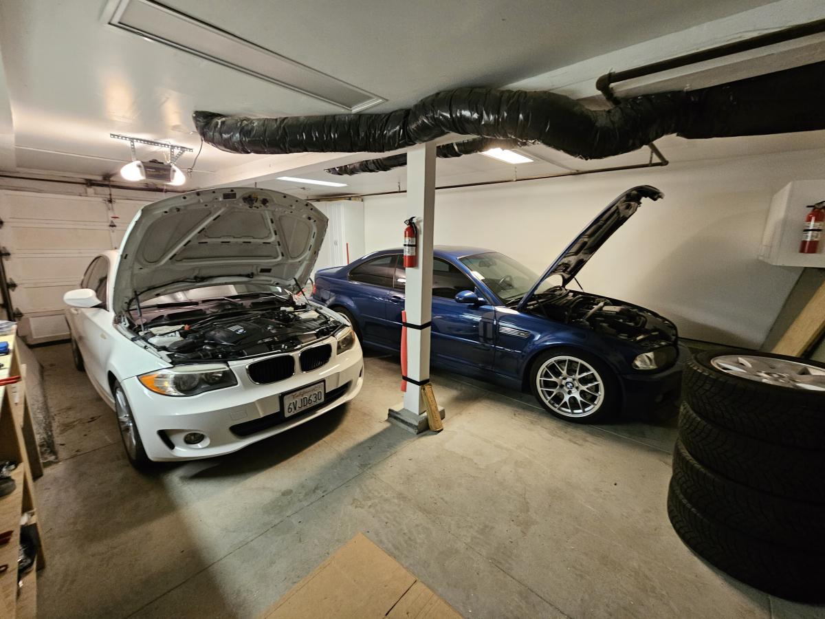

                      Swapped engine mounts and transmission mounts as I could feel a very slight vibration at idle. No pics, but it basically the same as the E46. Support engine from up top, drop subframe slightly, swap mounts. Same for transmission except that one got supported by a jack from underneath.
                      I also replaced the e torx bolts holding the engine mount brackets to the engine. Read online that those apparently shear in half after some miles, so just bought new ones. Bought enough to replace both sides, but ended up doing just the passenger's side (those are the ones prone to failure anyway), as the bolts on the driver's side were extremely hard to get to without removing intake components. This was way harder to do than either of the mounts. Suuper limited access and a 25Nm + 105 deg torque spec with about 30 deg of space to swing the ratchet. Got it done in the end though.

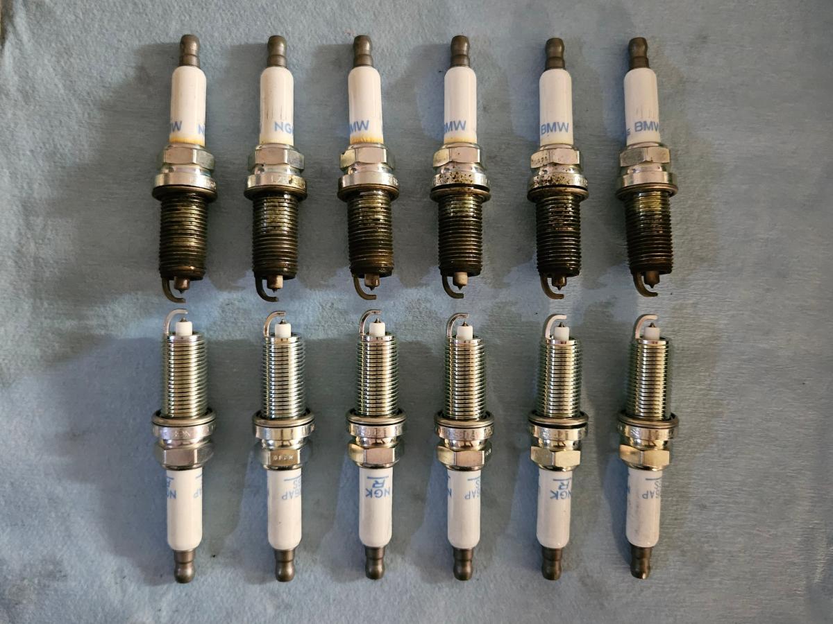

                      Next up came spark plugs. Old ones were the correct ones and didn't look insanely bad, but were definitely due:
                      Both cars being worked on:
                      Click image for larger version  Name:	20231112_175627.jpg Views:	0 Size:	136.1 KB ID:	243028
                      Also, noticed that BMW calls the plastic engine cover something like "acoustic cover" in TIS. Part doesn't have any sort of sound deadening underneath, so I thought it was a bit weird until I started the car up with the cover removed. Wow, those injectors are basically as loud as the M3 ones! Guess that cover does quiet them down quite well.

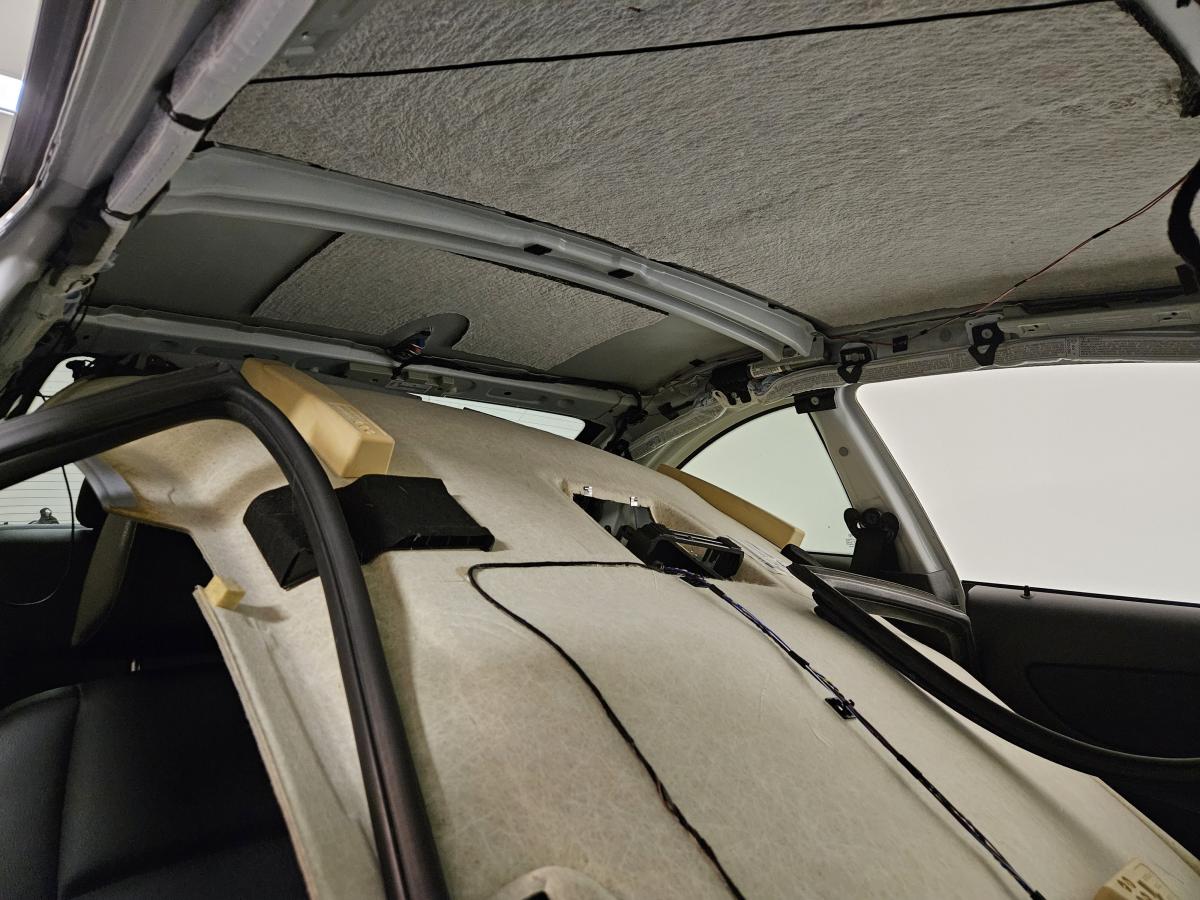

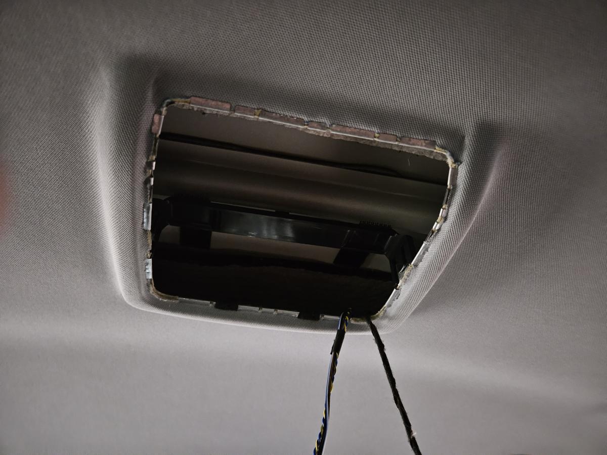

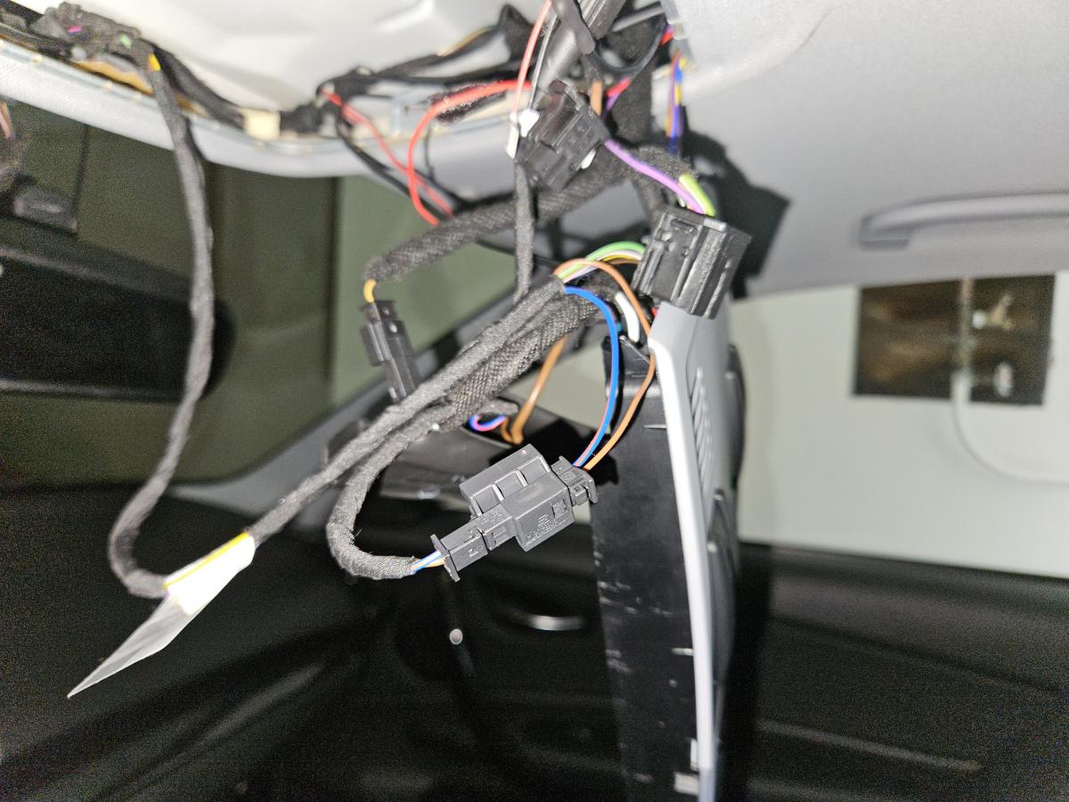

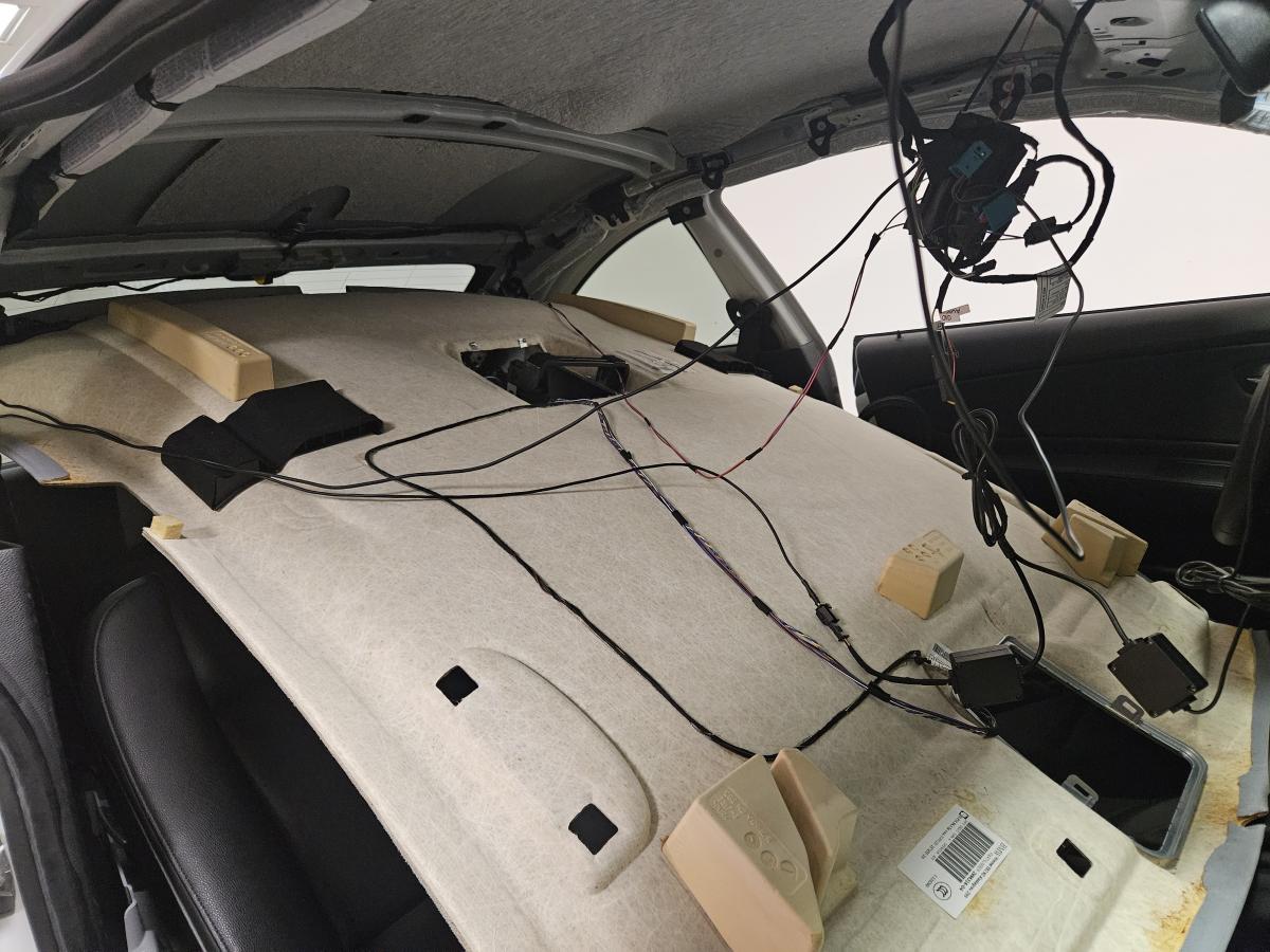

                        So, turns out that if you just throw a bunch of wires on top of the headliner, they'll start making noise. Who would have known?
                        Anyway, finally grew tired of that, so I lowered the headliner and secured all the wires using a few of those adhesive backed zip tie mounts.
                        Noisy:
                        Not noisy:
                        Unfortunately, I didn't make some of the wires long enough to go around the perimeter of the roof, so I had to run them diagonally across. Even though it's not ideal, they are clear of the airbags and don't seem to be making noise against the headliner, so I'm happy.

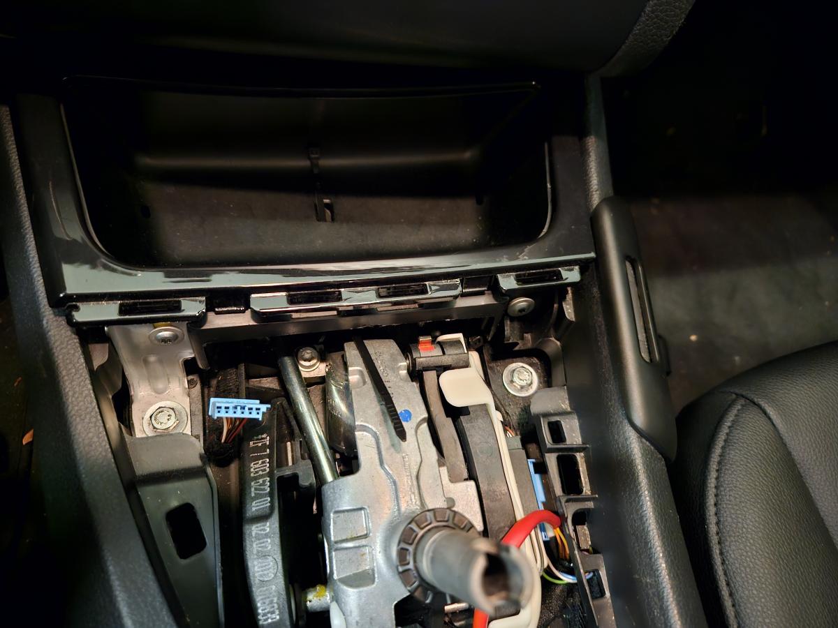

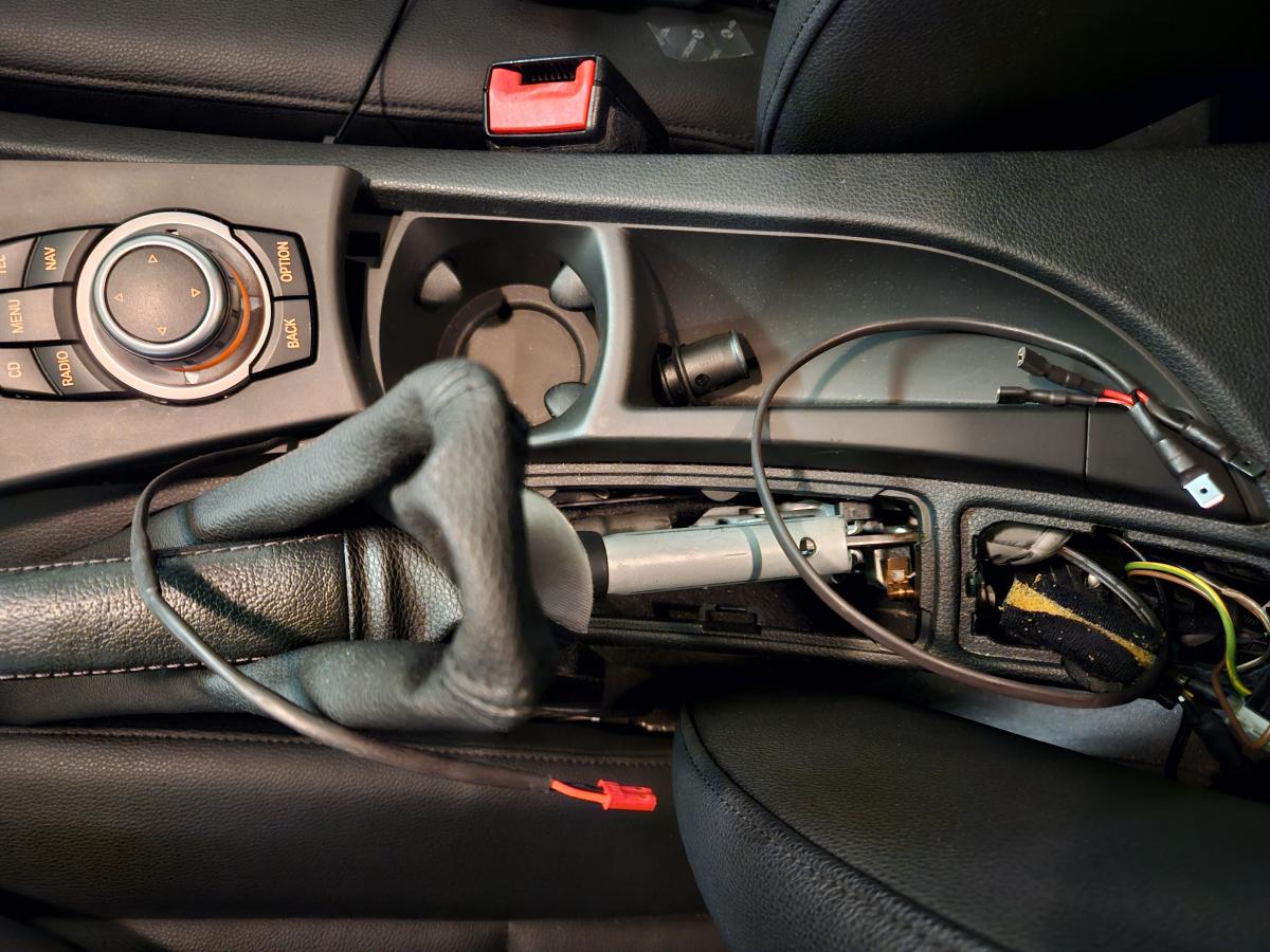

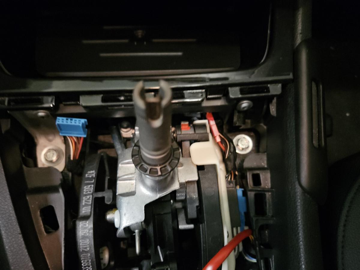

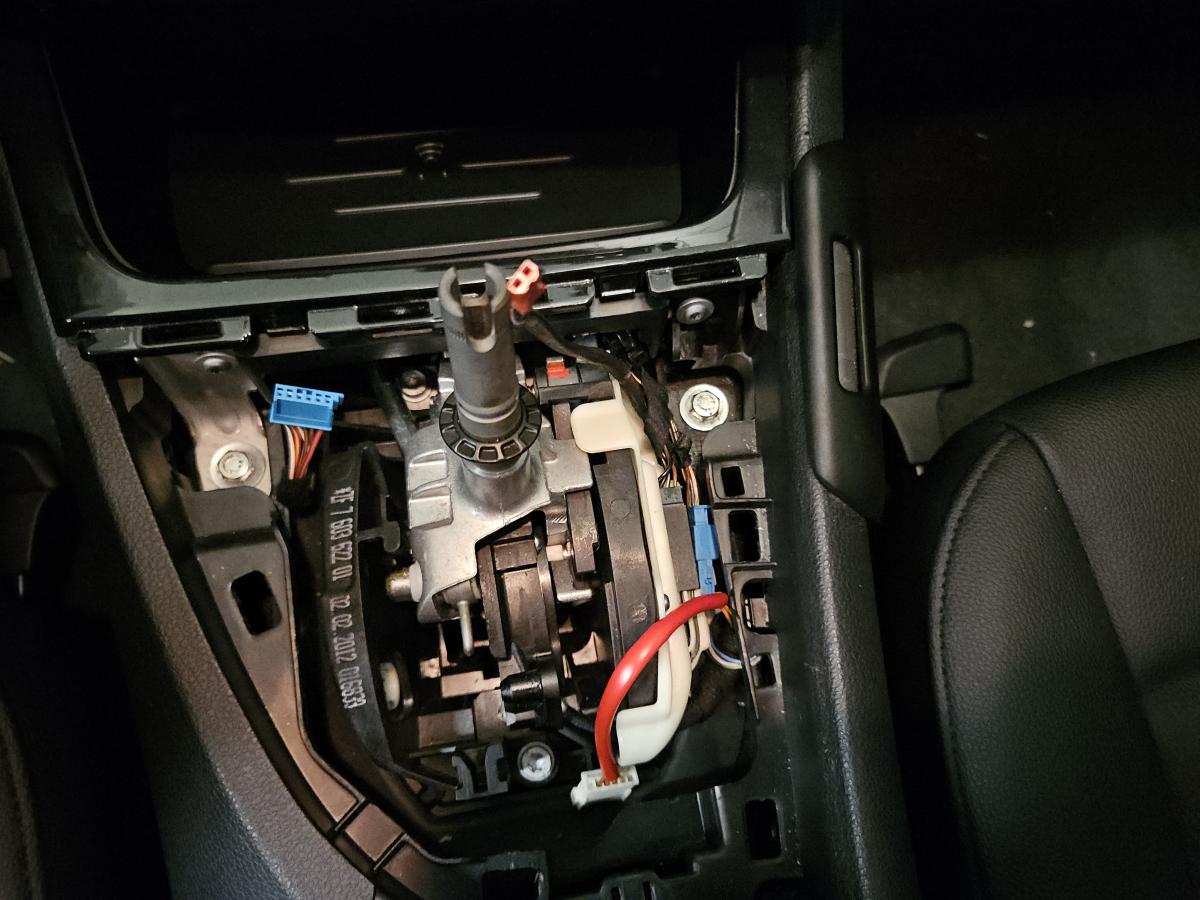

                              Having wireless Android Auto/CarPlay in this car has been awesome. However, it does quickly kill the connected phone's battery life on longer trips, so I decided I needed to install a wireless charger. For once, I decided that I shouldn't overcomplicate things and should just buy an off the shelf solution, so I went and got an E82 specific Induktiv wireless charger.
                              To be honest, I'm kind of disappointed with it, but I'll talk more about that later. First, the install.
                              Some minor disassembly and zip tie guidance was all it took. Only used a plastic pry tool for the whole process.
                              Started by poking a zip tie through the locating hole for the rubber mat in the center console cubby. Then taped the power lead coming off the charger to it and pulled it through:
                              I then routed the power wire from the back of the center console to the front. I ran it alongside (and underneath) the BMW factory wiring, to make sure it didn't interfere with any moving parts like the shifter and handbrake. Wireless charger itself gets secured to the cubby via two adhesive velcro squares:
                              And finally plugged it in to the cigarette lighter socket:

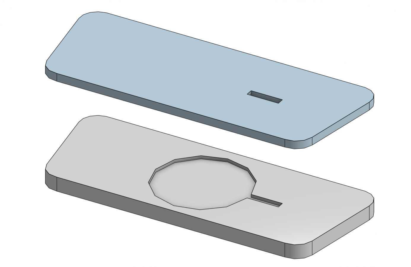

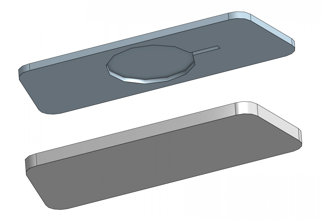

                                Actually, I just remembered that I did start designing a custom wireless charger right after I bought the car. It was designed as a two part 3D printed enclosure that sandwiched a magsafe charging puck within it. I was going to have it clip into the cubby using the stock mounting holes and shape the top of it to accommodate the stock rubber mat, which I like the look of. Was also going to tap into power using some nice TE connectors. Radio/nav were the obvious high-power sources, but I didn't really get that far into it to make a decision. Here's the (very much unfinished) design:
Name:	Screenshot 2024-02-07 at 1.51.51 AM.png
Name:	Screenshot 2024-02-07 at 1.52.16 AM.png
                                Stopped working on it for a couple reasons. First, the magsafe pucks are super thick, so this thing was getting chunky fast. Also, I realized the magsafe puck only charged my phone at ~3.5W with nothing in between them and struggled substantially to charge it with the rubber mat in between.
                                Maybe I should revisit this idea using the same wireless charging board I installed in the M3...
