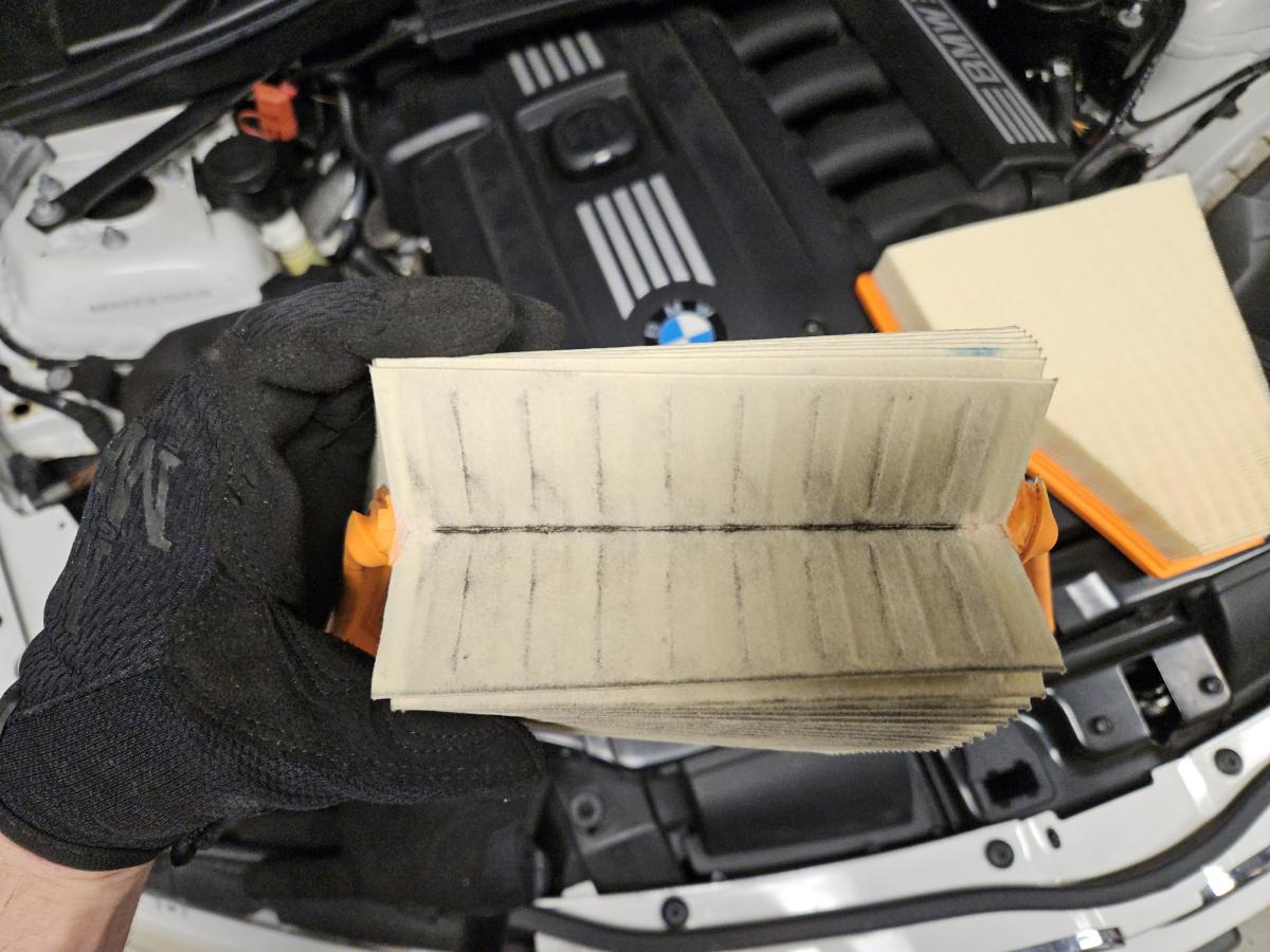

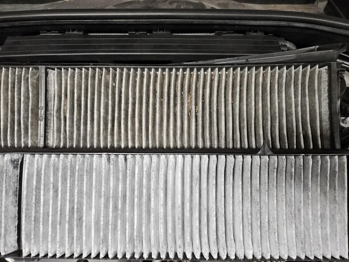

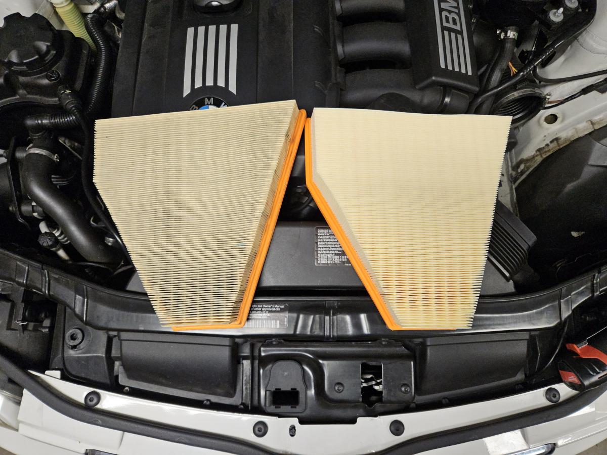

    Was up in the mountains last weekend, so got the car prepped for that. First up, a quick filter change.
    Engine one was due and cabin one was nasty. Not entirely sure why I didn't swap these out when I bought the car. Think I just forgot to order them then...

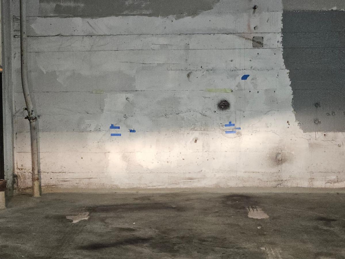

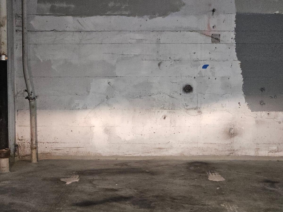

    Then I re-aimed the headlights in an attempt to make the (potentially snowy) drive with the sun down a little less sketchy.
    Before:
    After:
    Driver's side was the one that was most out of alignment, but honestly it did not make a huge difference. I think it's time to start looking into upgrades for this thing. Driving at night with the halogens really sucks.

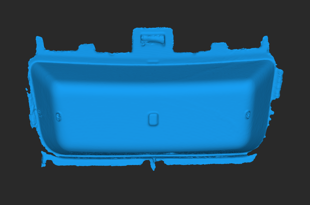

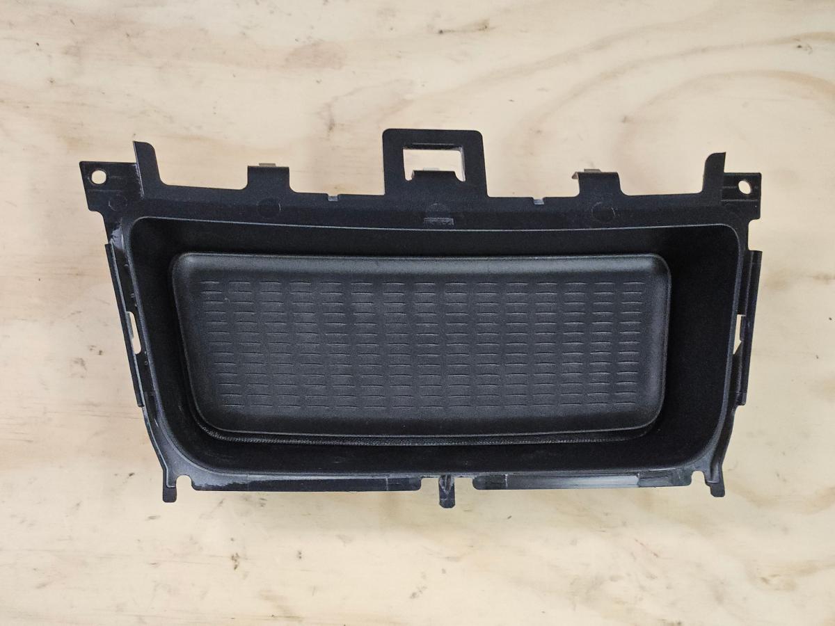

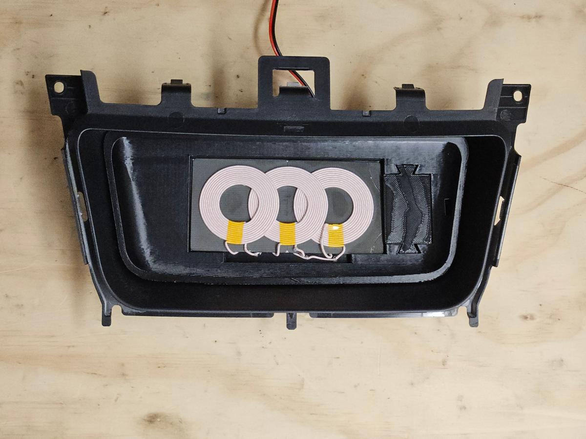

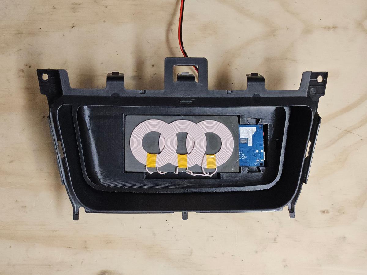

      Okay so I've lived with the Induktiv wireless charger for a while now and it's fine. All my previous complaints are still valid, but in steady state driving it does do its job. Fortunately, it only makes that high pitched noise for ~30s after starting the car, but the slippery surface + 1 coil combo does mean that any lateral acceleration will move my phone around and make it stop charging.
      It turns out that the E82 cubby/tray thing where the charger goes is pretty cheap, so I bought one and 3D scanned it alongside the 996 calipers on the M3. Here's the result:
Name:	Screenshot 2024-03-04 at 5.05.37 PM.png
      Will be designing my own version of this product that fits better and charges my phone at a more acceptable rate. I'll also make sure to contour the top of it so that I can put the stock rubber mat over it to keep it looking as factory as possible.

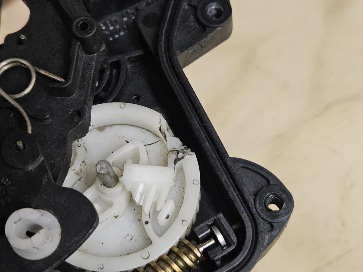

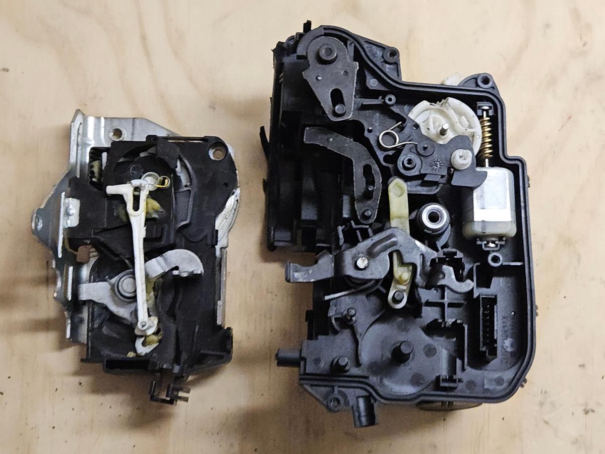

        Driver's side door lock actuator died suddenly. Apparently a common failure on E8x/E9x cars. Was curious to see the failure mode, so I took it apart. Was fun to see how everything worked in there.
        Unlocked:
        Click image for larger version  Name:	20240305_221947.jpg Views:	0 Size:	131.8 KB ID:	258091
        Locked:
        Click image for larger version  Name:	20240305_221935.jpg Views:	0 Size:	130.4 KB ID:	258092
        Anyway, here's what failed:
        Click image for larger version  Name:	20240305_221958.jpg Views:	0 Size:	97.2 KB ID:	258093
        Fortunately, all that gear is used for is the power lock function, so I just removed it to keep it from jamming again. With it removed, the actuator can still be used manually, which is great.
        New actuator on the way, along with stuff for an oil change and rear brake pad change.

          First wireless charger enclosure test went great:

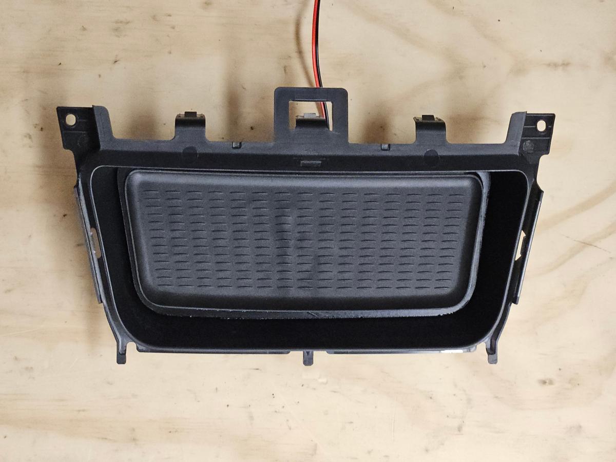

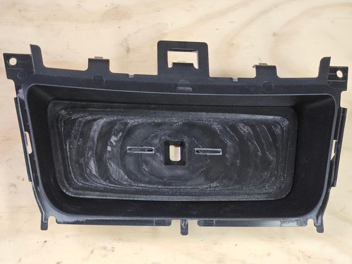

          Couple small tweaks needed to get it to fill the space better (+ reliefs for the board) but should be done soon.
            #65
            Done:
            Choosing a different print orientation resulted in a better surface finish. Happy with that. Now just need to figure out where to get power from and install.

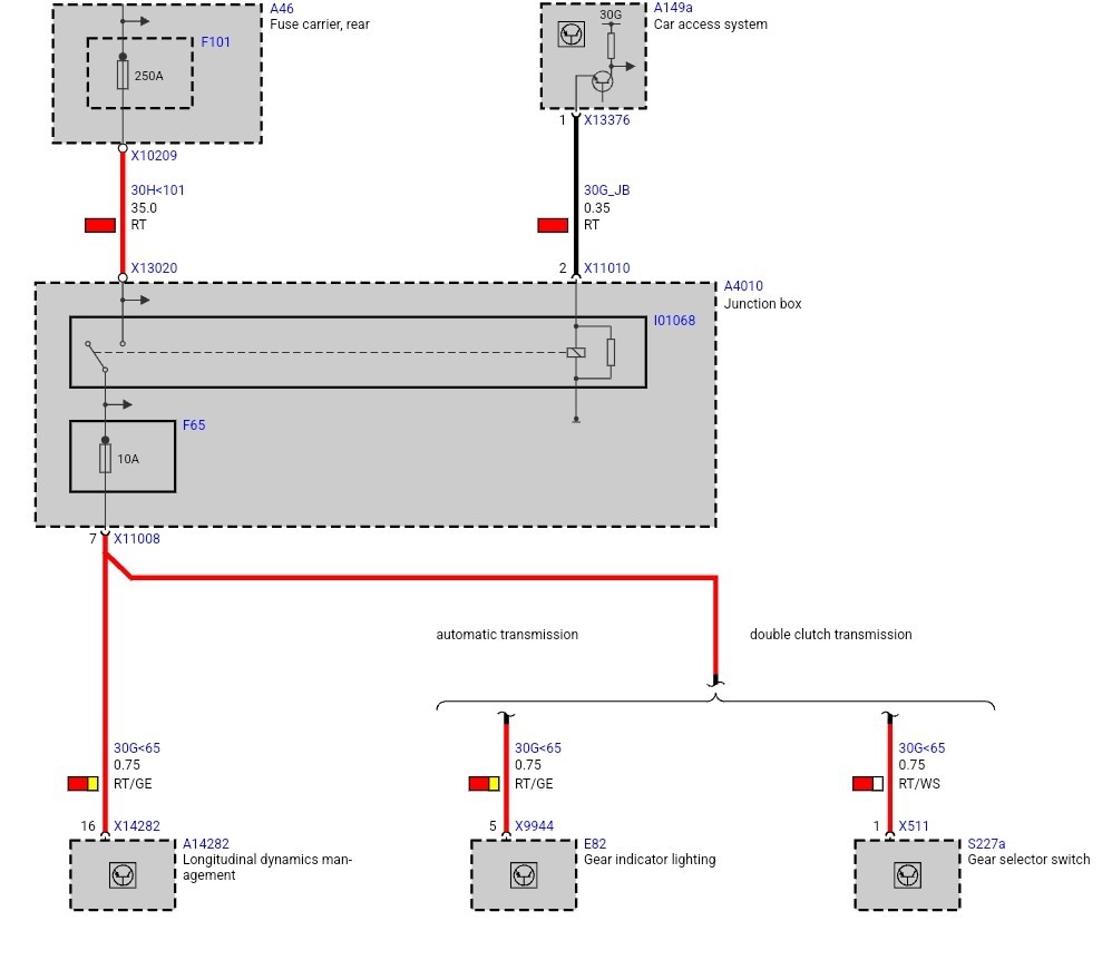

              Okay, so fuse 65 is a 10A fuse that feeds the auto transmission gear indicator lighting and the "longitudinal dynamics management". As far as I can tell, the latter is active cruise control, which this car does not have. So essentially the 10A fuse is powering an LED. Should be fine to steal power from.
              ​​​​​Having trouble finding a part number for the connector, think that's probably easiest to just go grab at a junkyard.

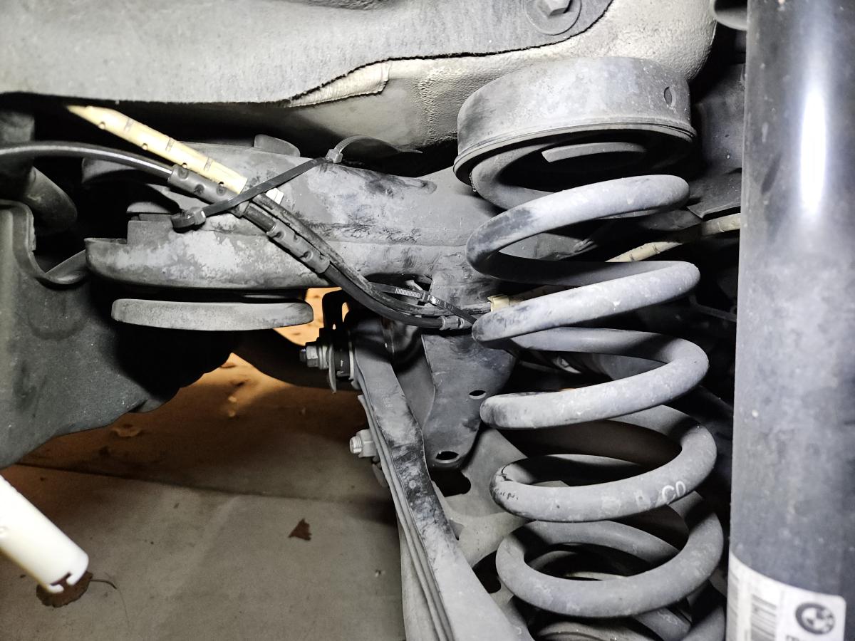

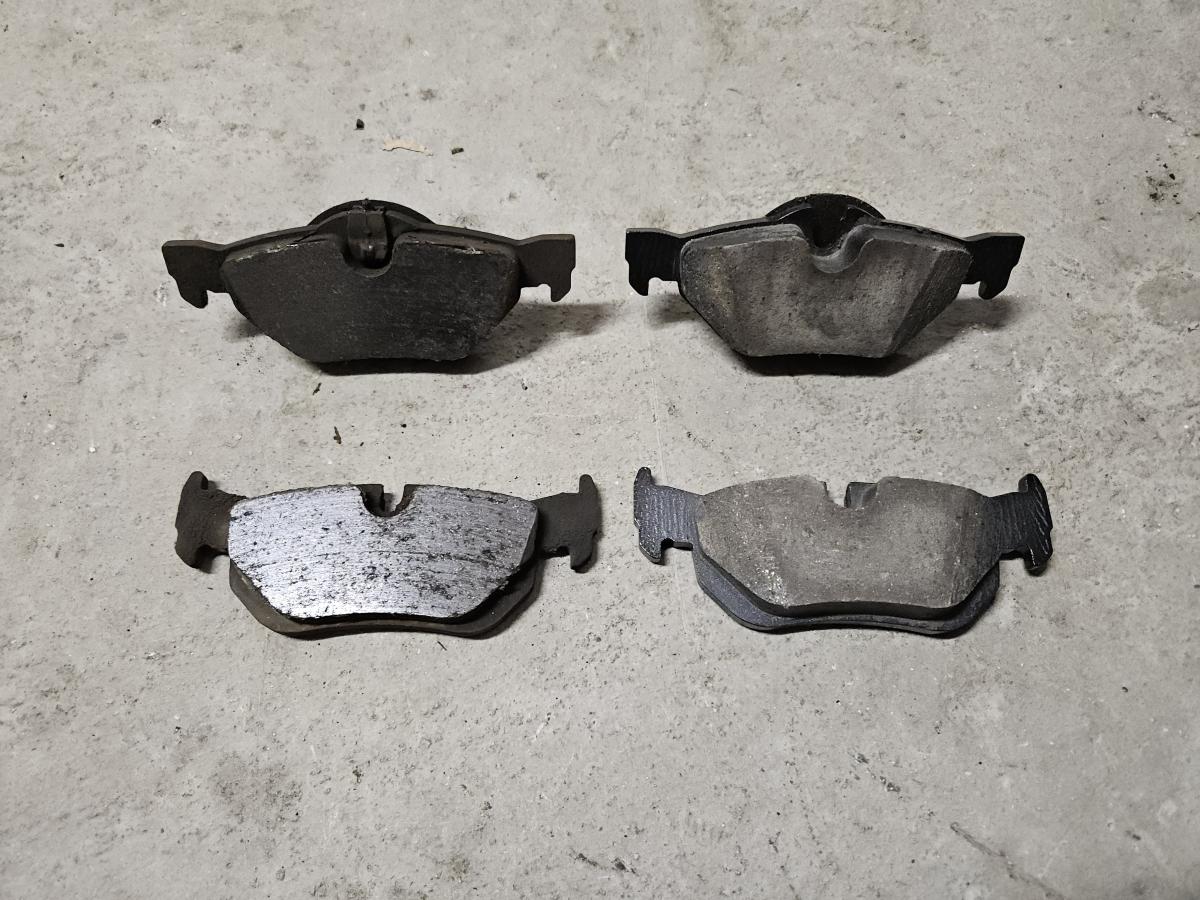

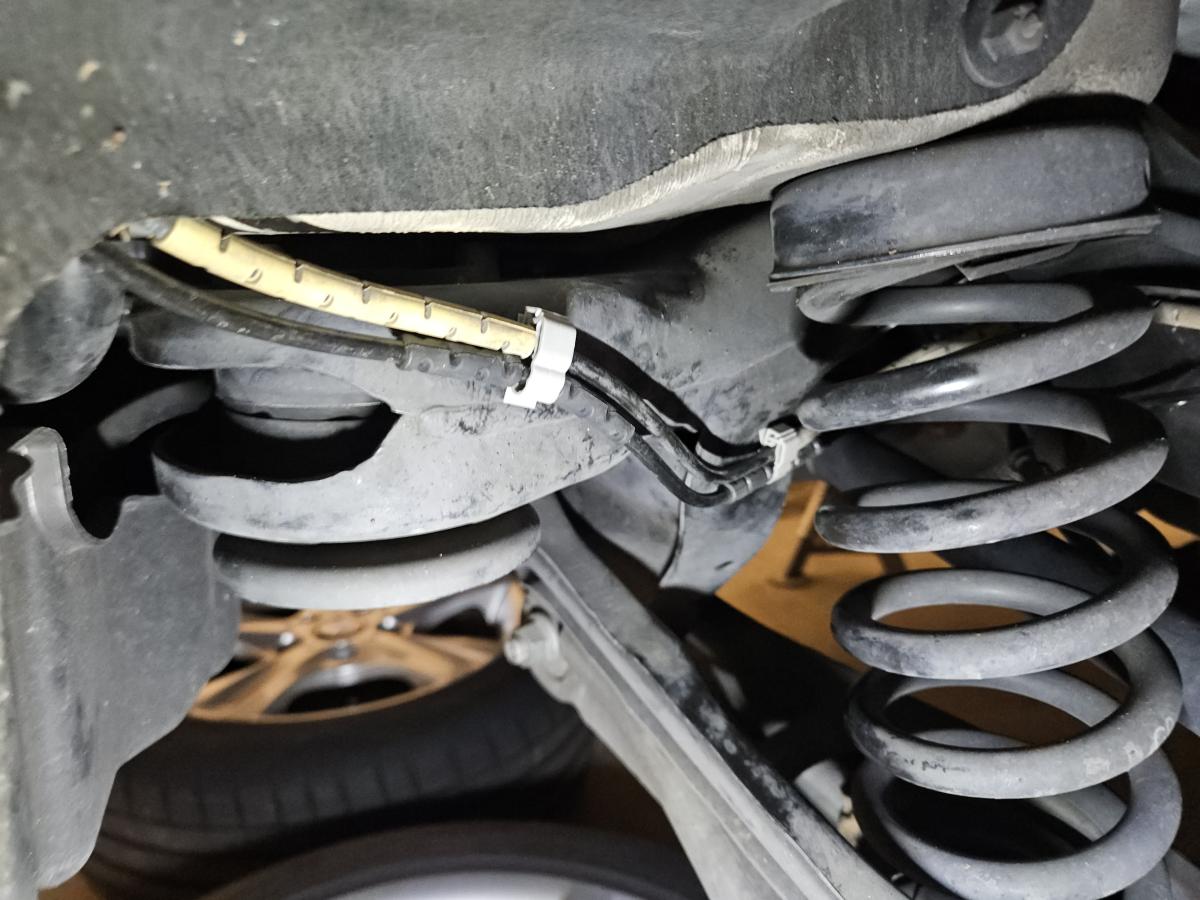

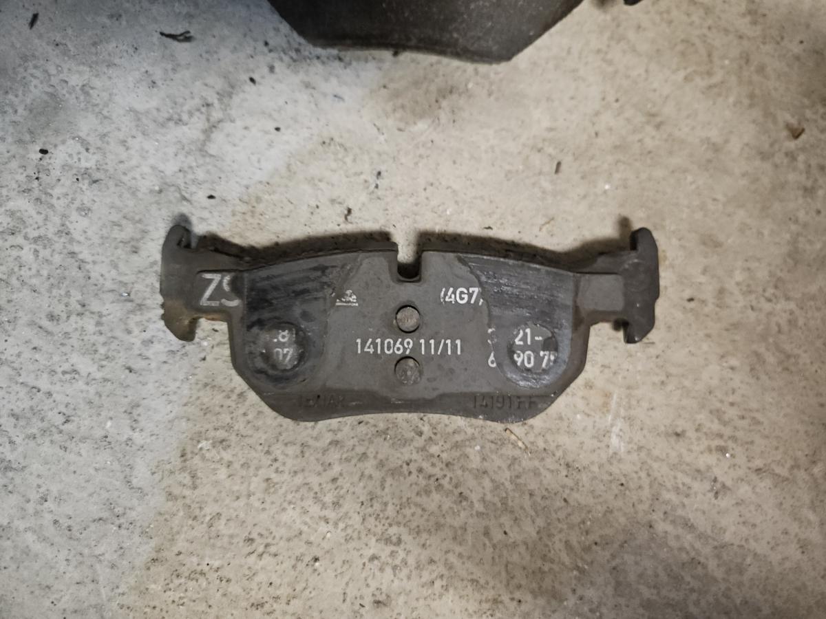

                Exterior rear pads were running low so swapped them (old left, new right):
                Click image for larger version  Name:	20240326_215753.jpg Views:	0 Size:	171.9 KB ID:	260125
                All four rotors and the front pads were doing great, so those were not touched. Turns out rear pads were original to the car!
                Click image for larger version  Name:	20240326_210000.jpg Views:	0 Size:	126.5 KB ID:	260126
                And of course all of the brake pad wear sensor retaining clips disintegrated in my hands when I went to remove them. I forgot to order new ones, so zip ties it is until I place another FCP order:
                Click image for larger version  Name:	20240326_215110.jpg Views:	0 Size:	137.2 KB ID:	260127

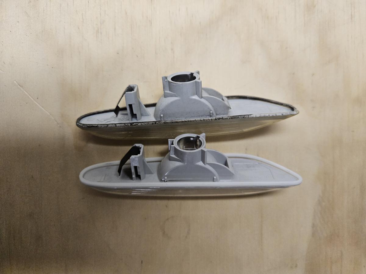

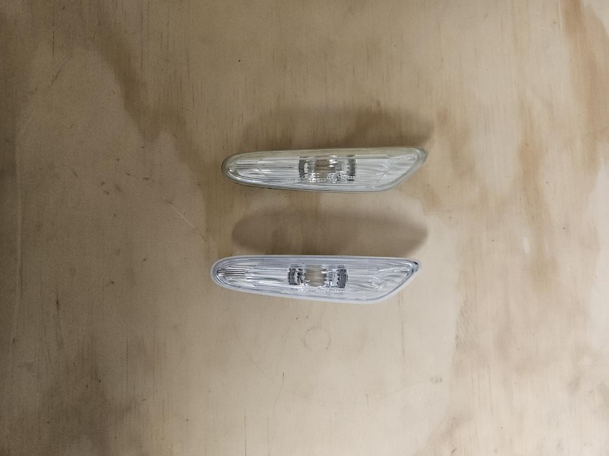

                I then swapped side markers as a decade of California sun had them looking pretty bad:
                Click image for larger version  Name:	20240331_175040.jpg Views:	0 Size:	83.3 KB ID:	260128
                Click image for larger version  Name:	20240331_175115.jpg Views:	0 Size:	80.4 KB ID:	260129

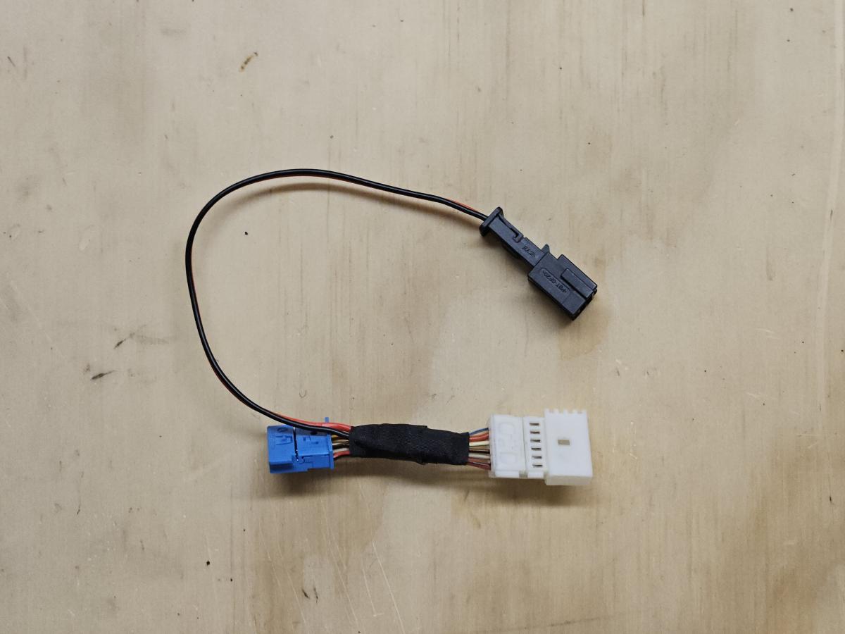

                  #68

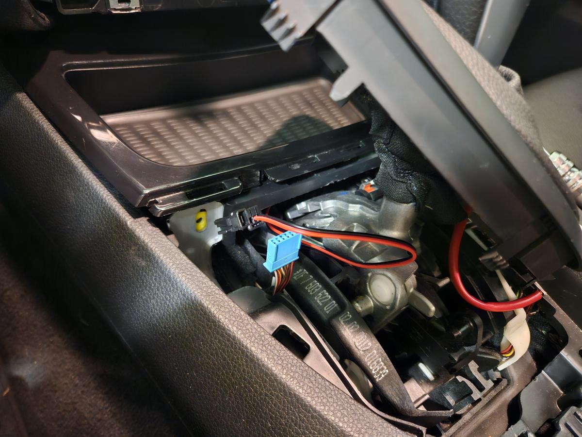

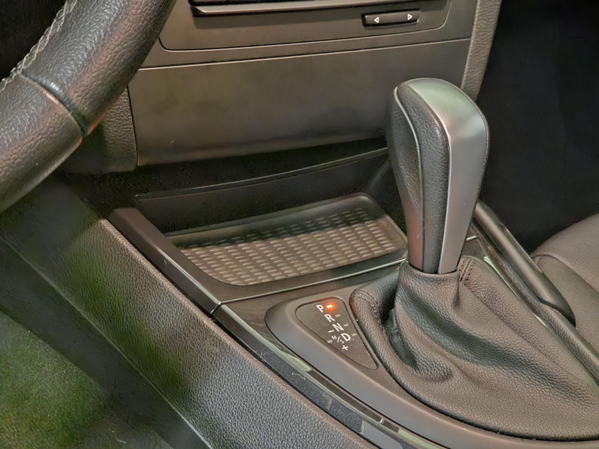

                  Finally took a trip to the junkyard and grabbed the connectors I needed for the wireless charger.
                  Harness for the charger made:
                  Charger installed:
                  And all back together:
                  Very happy with the end result. Looks completely stock!

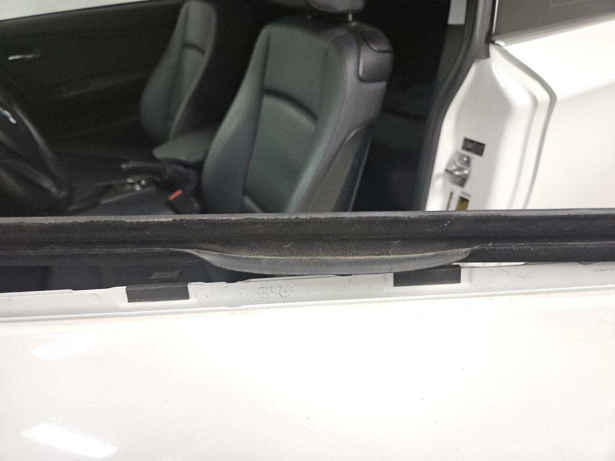

                  Anyway, when I was installing the new unit I found what I'm pretty sure is the root cause of the false anti trap triggering:
                  Looks like the interior rubber surface on that seal had been dragging on the window and adding enough extra friction to trigger the anti trap. I'm not sure what caused this fold in the seal, but the leading theory is that whoever tinted these windows accidentally did this with the squeegee.
                  I cleaned up all the seals and made sure to install this one so that it wouldn't fold over again. Looks to be doing its job correctly, but only time will tell if it's going to need replacement. So far haven't had the anti trap trigger once (in probably 30ish times), so I'm happy!

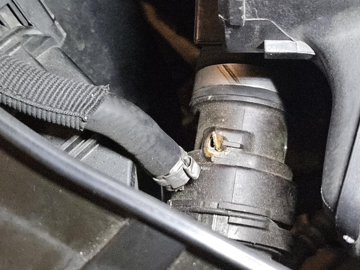

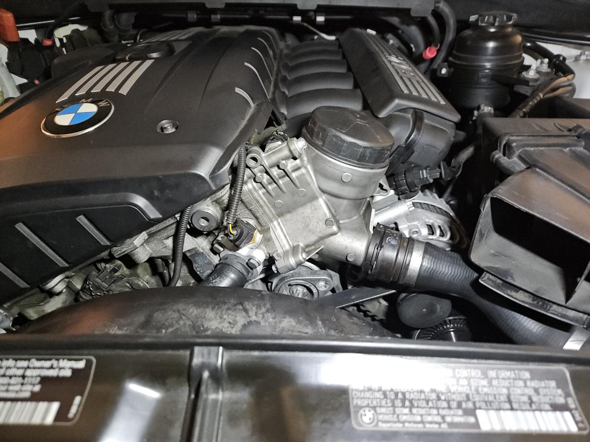

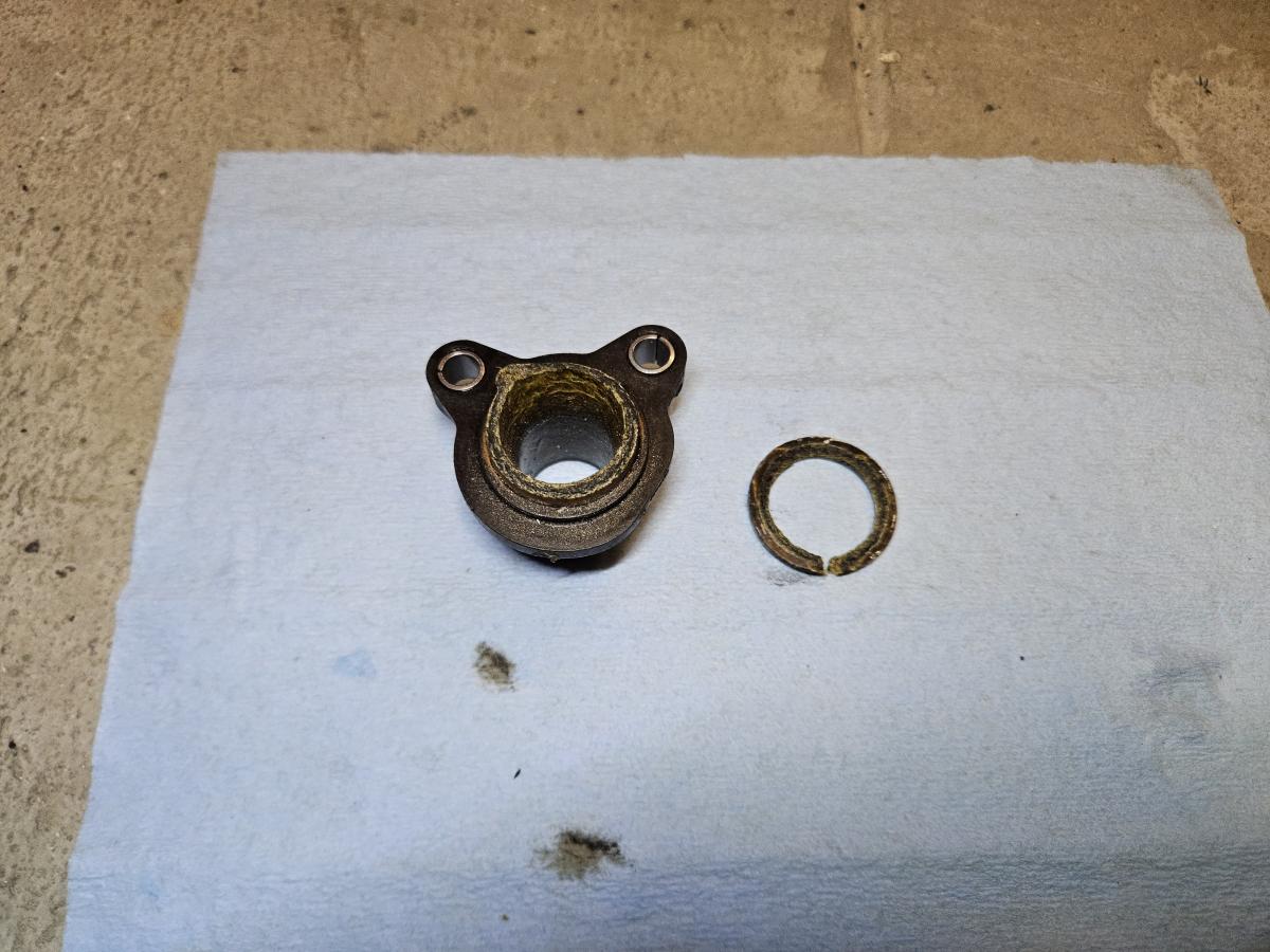

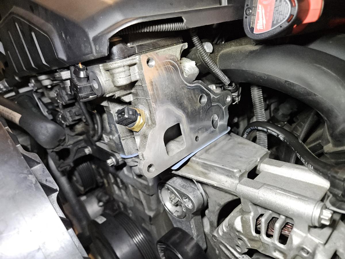

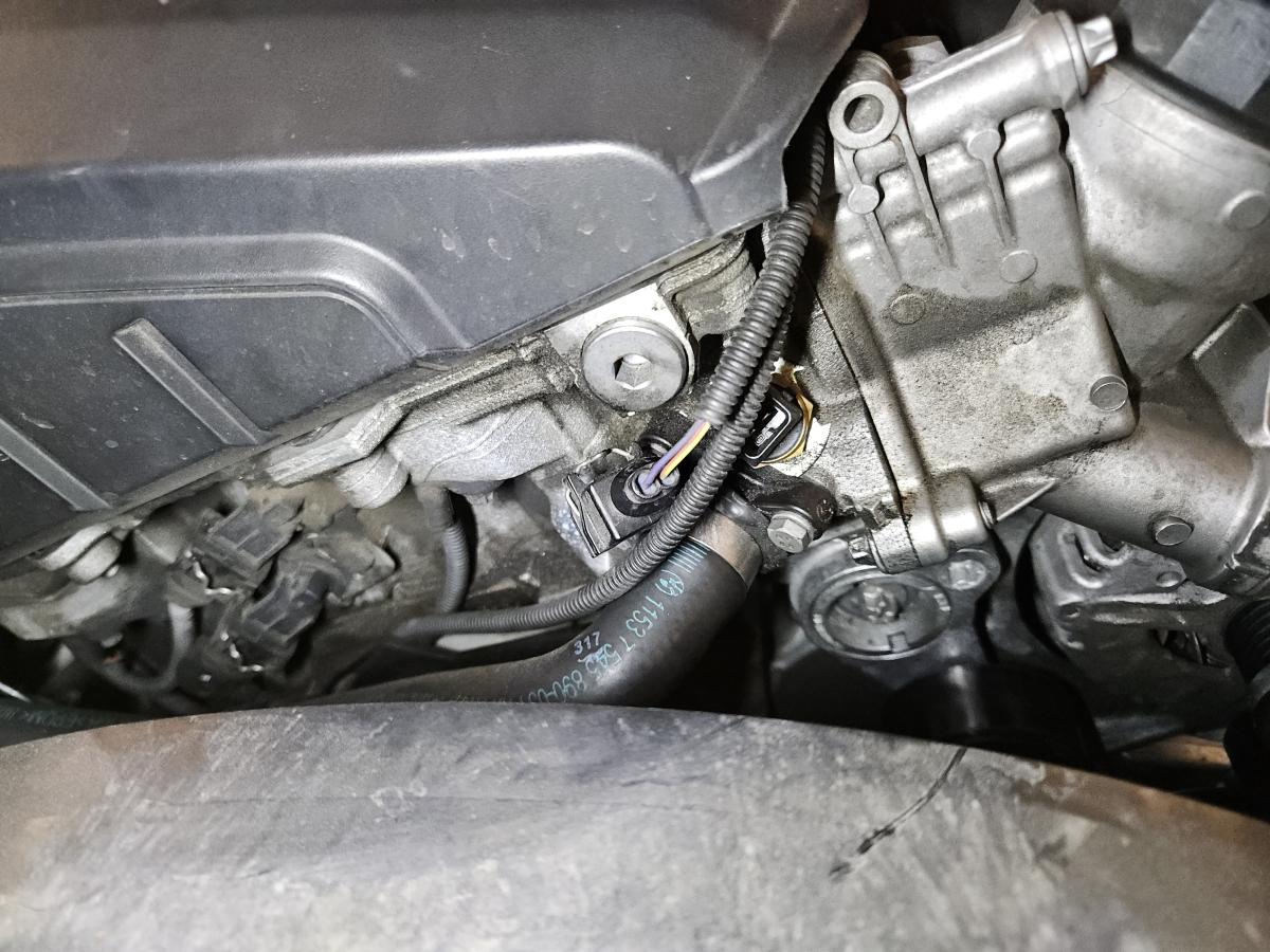

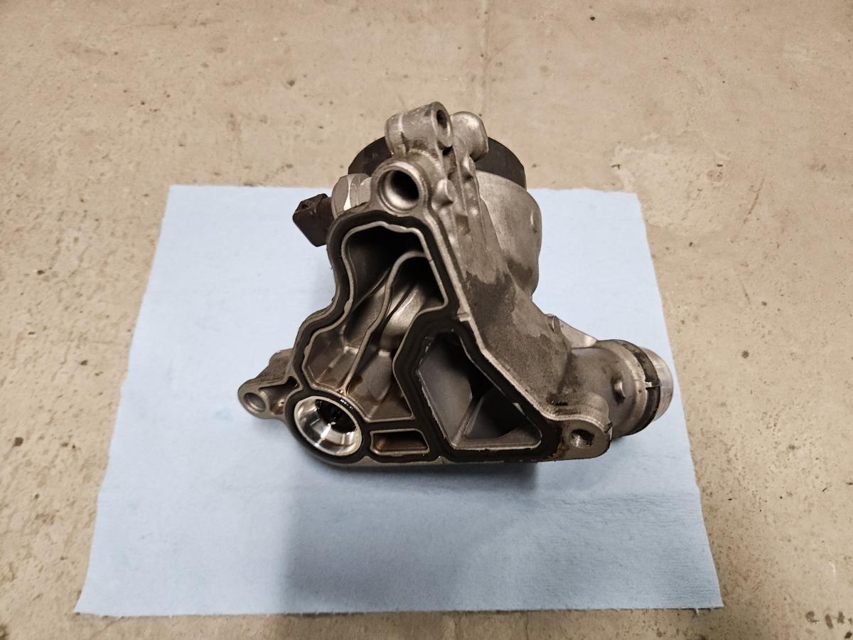

                    Next, the oil filter housing gasket. This is what the area looked like when I started:
                    Click image for larger version  Name:	20241208_150749.jpg Views:	0 Size:	162.4 KB ID:	286512
                    Not terrible (i.e. just weeping, no drips), but the gasket is clearly gone.

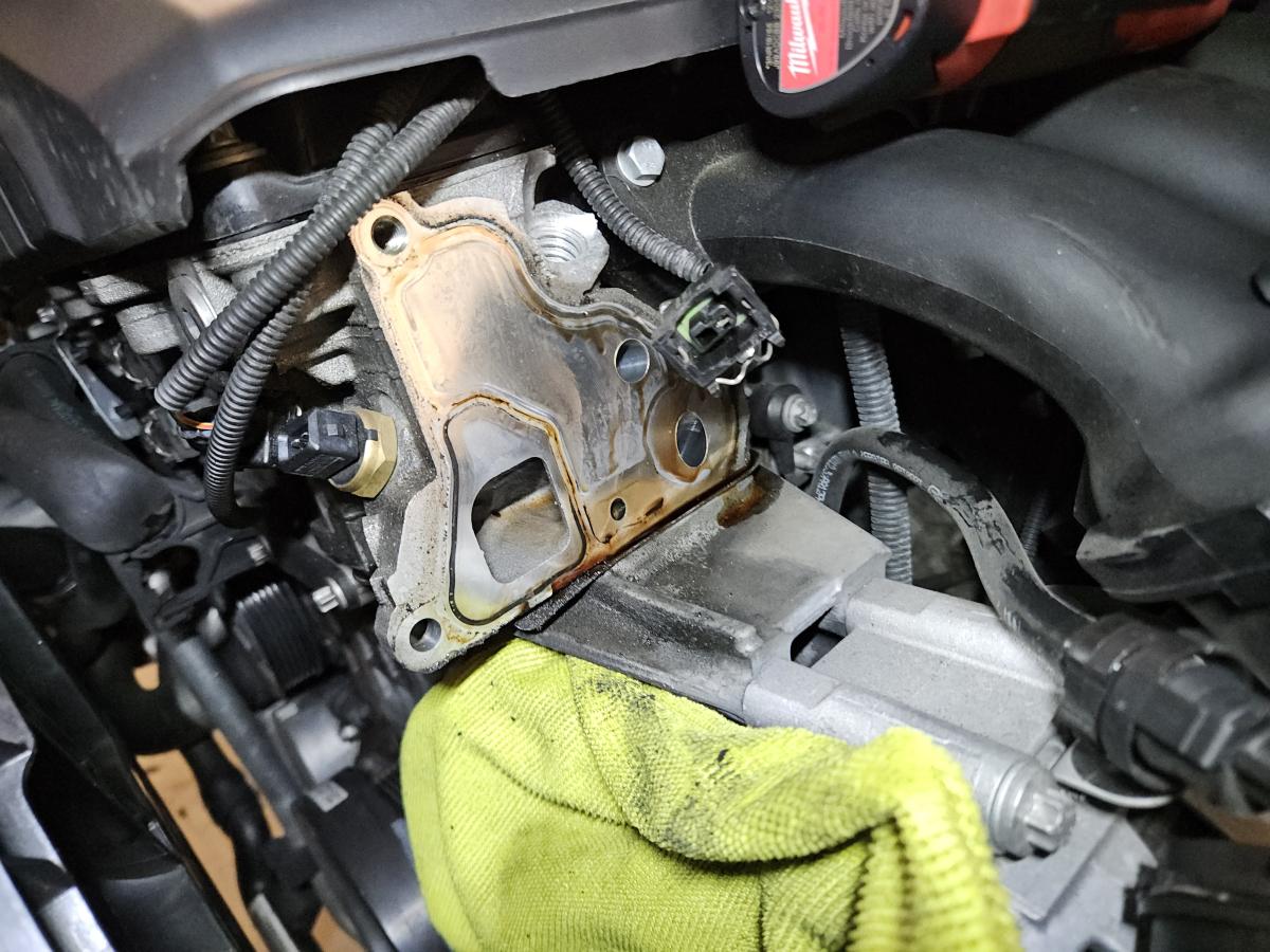

                    Off came the housing:
                    Click image for larger version  Name:	20241208_152308.jpg Views:	0 Size:	158.1 KB ID:	286513

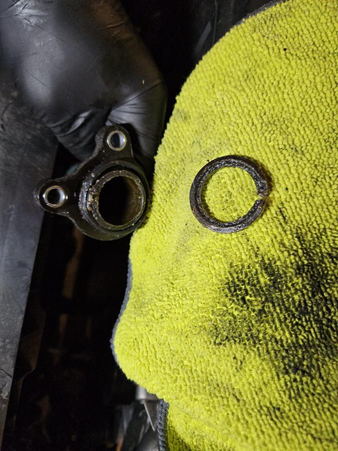

                    Mating surface cleaned up. Didn't want to, but ended up having to use some scotchbrite on the lower left corner, as there was a significant amount of gasket material transfer that did not want to come off:
                    Click image for larger version  Name:	20241208_154644.jpg Views:	0 Size:	160.4 KB ID:	286514

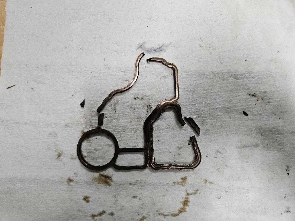

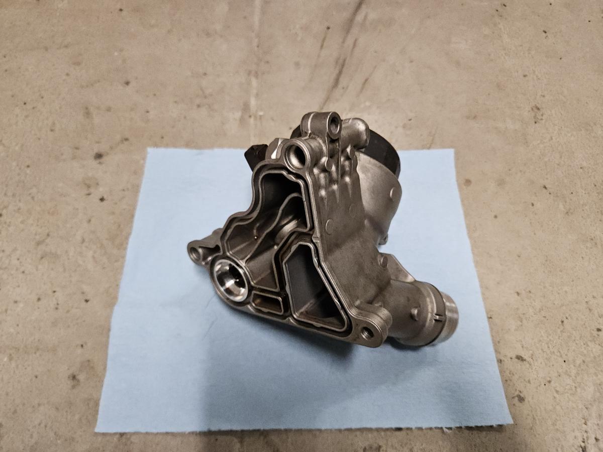

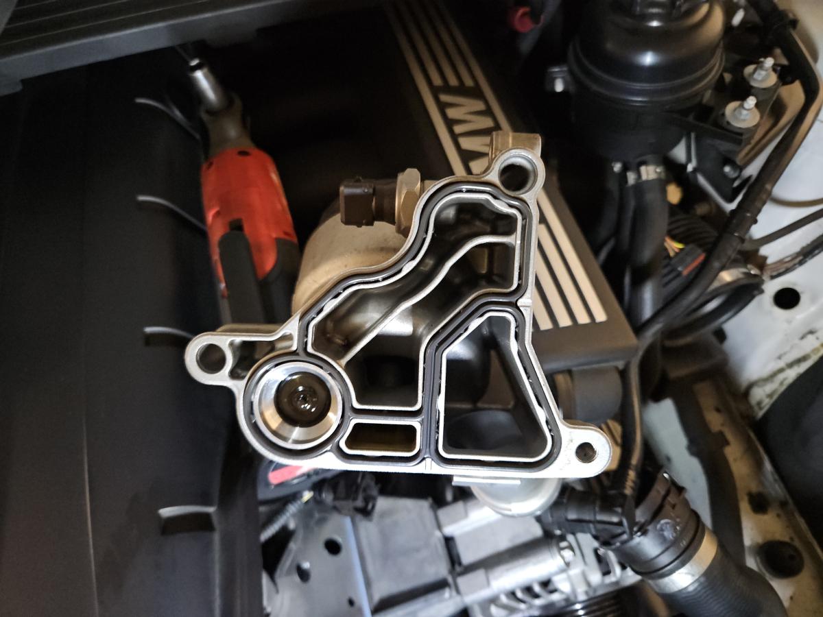

                    Now onto the housing itself. This is what the gasket looked like, in case the mess around the interface wasn't enough to indicate that it was bad:
                    Click image for larger version  Name:	20241208_152256.jpg Views:	0 Size:	111.2 KB ID:	286515
                    Click image for larger version  Name:	20241208_170748.jpg Views:	0 Size:	124.2 KB ID:	286516
                    Housing cleaned up and ready to go back on with a new gasket:
                    Click image for larger version  Name:	20241208_172528.jpg Views:	0 Size:	108.4 KB ID:	286517
                    Click image for larger version  Name:	20241208_172743.jpg Views:	0 Size:	111.1 KB ID:	286518

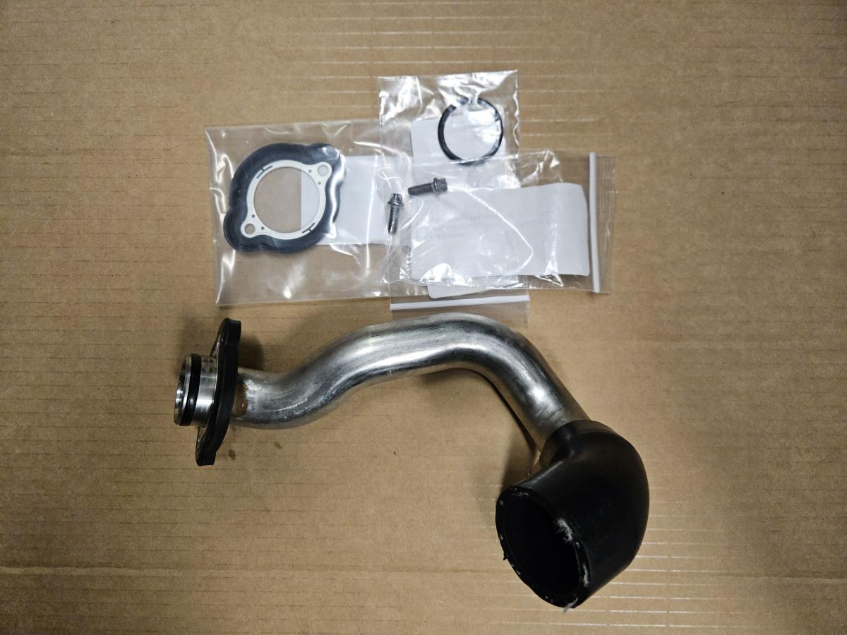

                    I also leaned that Rein/CRP makes an aluminum version of the mickey mouse flange, so picked up one of those. I'm glad I did because this is what happened when I disconnected that hose from the head:
                    Click image for larger version  Name:	20241208_151036.jpg Views:	0 Size:	105.1 KB ID:	286519
                    Click image for larger version  Name:	20241208_164518.jpg Views:	0 Size:	129.4 KB ID:	286520

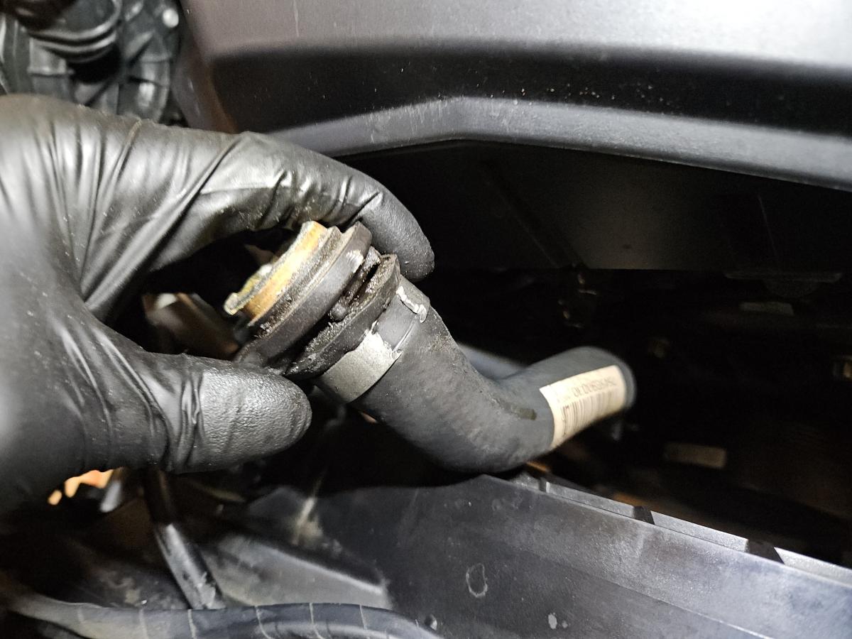

                    The style of clamp used by BMW to hold that flange to the hose needs to be cut off, so I took my time with the dremel and make sure to not nick the hose underneath. Basically went super slow and made multiple cuts, then broke the clamp with a flathead once there was little material left:
                    Click image for larger version  Name:	20241208_164357.jpg Views:	0 Size:	118.3 KB ID:	286521
                    Unfortunately that effort was useless, as the plastic flange had cut the hose up nicely:
                    Click image for larger version  Name:	20241208_164758.jpg Views:	0 Size:	120.3 KB ID:	286522
                    Fortunately, there's a bit of slack in the hose, so I just cut off the end of it and fit it on the new clamp.
                    Much better:

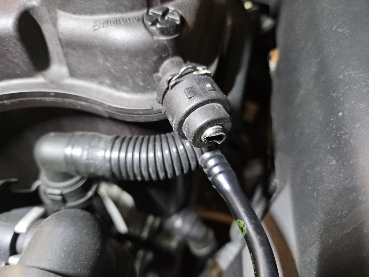

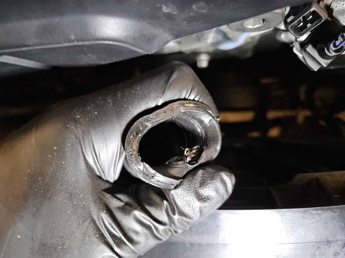

                    I did also have this happen while doing this work:
                    Click image for larger version  Name:	20241208_163424.jpg Views:	0 Size:	109.1 KB ID:	286523
                    Didn't lean on it heavily on anything, guess the plastic was just old and brittle. Honestly a bit surprised to see this as this car only has ~80k mi, but whatever. New hose (+ expansion tank since I don't trust the plastic on that anymore) on their way to me as we speak.

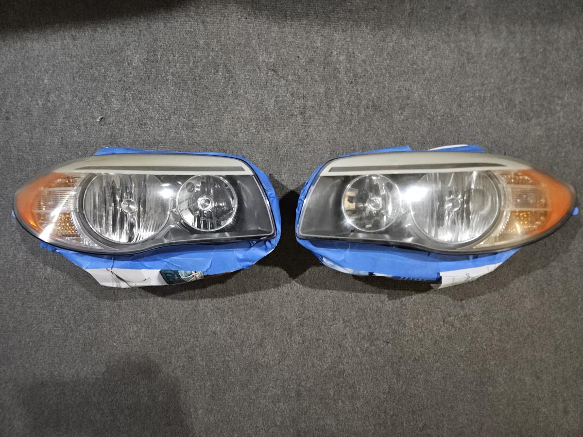

                      And now for the most involved part of it all: my attempt to restore nighttime visibility. I've identified the following as things that are affecting it negatively:

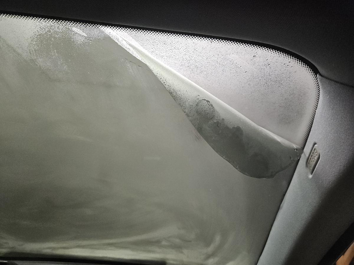

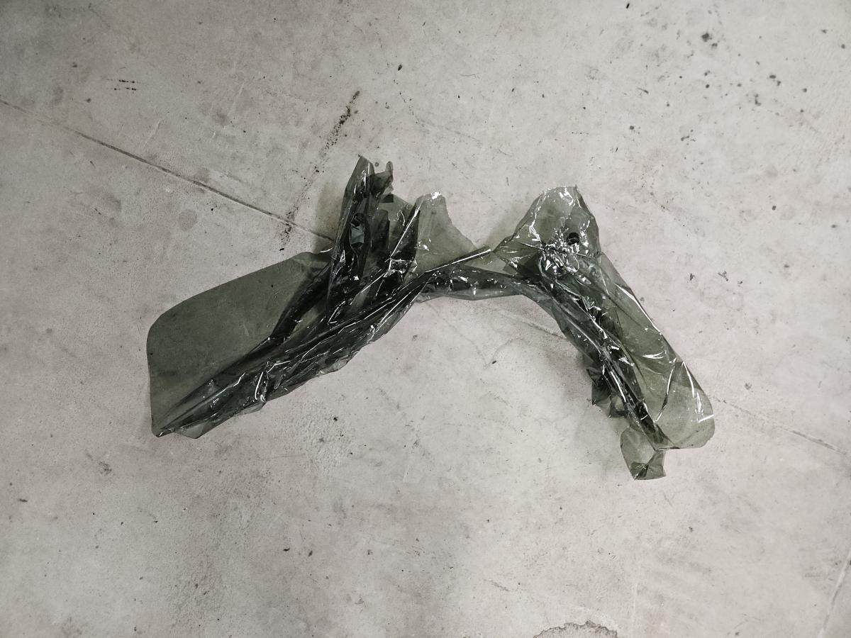

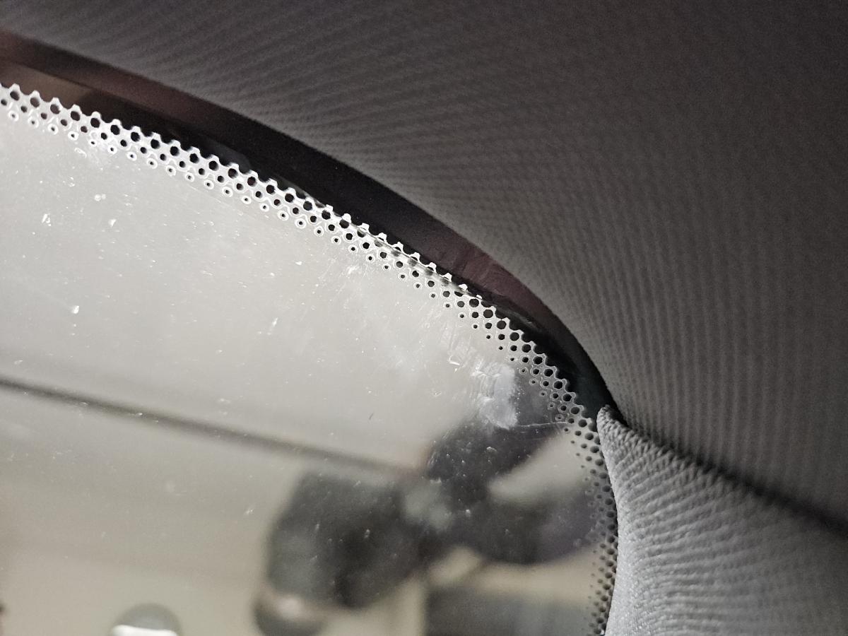

                      Started with what I thought was going to be the worst part of them all, the front tint. However, I was pleasantly surprised to learn that I was mistaken. Pulled up a small corner of the tint, then used a shitty handheld steamer to soften the adhesive and remove the rest of it:
                      I did pull a little too hard at one point and ripped a chunk of tint off without using the steam. This left some adhesive residue on the glass, but I was able to get it off fairly easily with some isopropyl alcohol. Would not want to have had to do this on the entire surface of the windshield though.
                      Overall, the process was way, way easier than I thought it would be. I should have done this years ago.

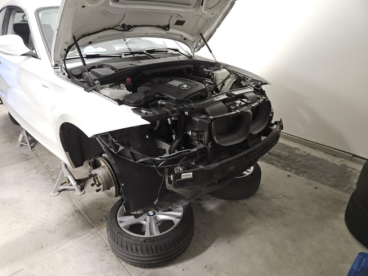

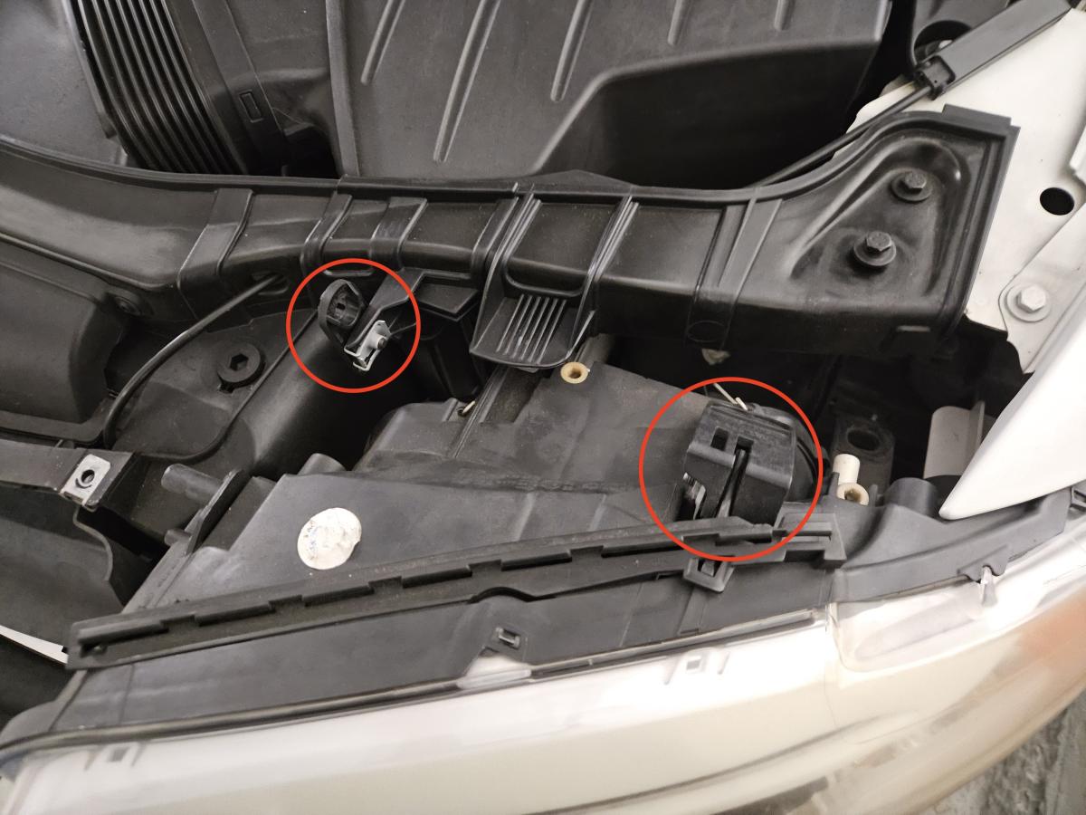

                      Then moved on to removing the headlights. I gotta say that I much prefer the E8x/E9x front bumpers to the E46 ones. Significantly more pleasant to remove and much, much easier to align with the other panels when reinstalling:
                      I did find one more thing that was likely contributing to the bad visibility when removing the driver's side headlight. The two bolts that control the angle of the headlight assembly were loose, so the headlight was able to rock back and forth while driving. Never noticed it doing so, so it must not have been a lot, but still not great. The two circled bolts are what I'm talking about:

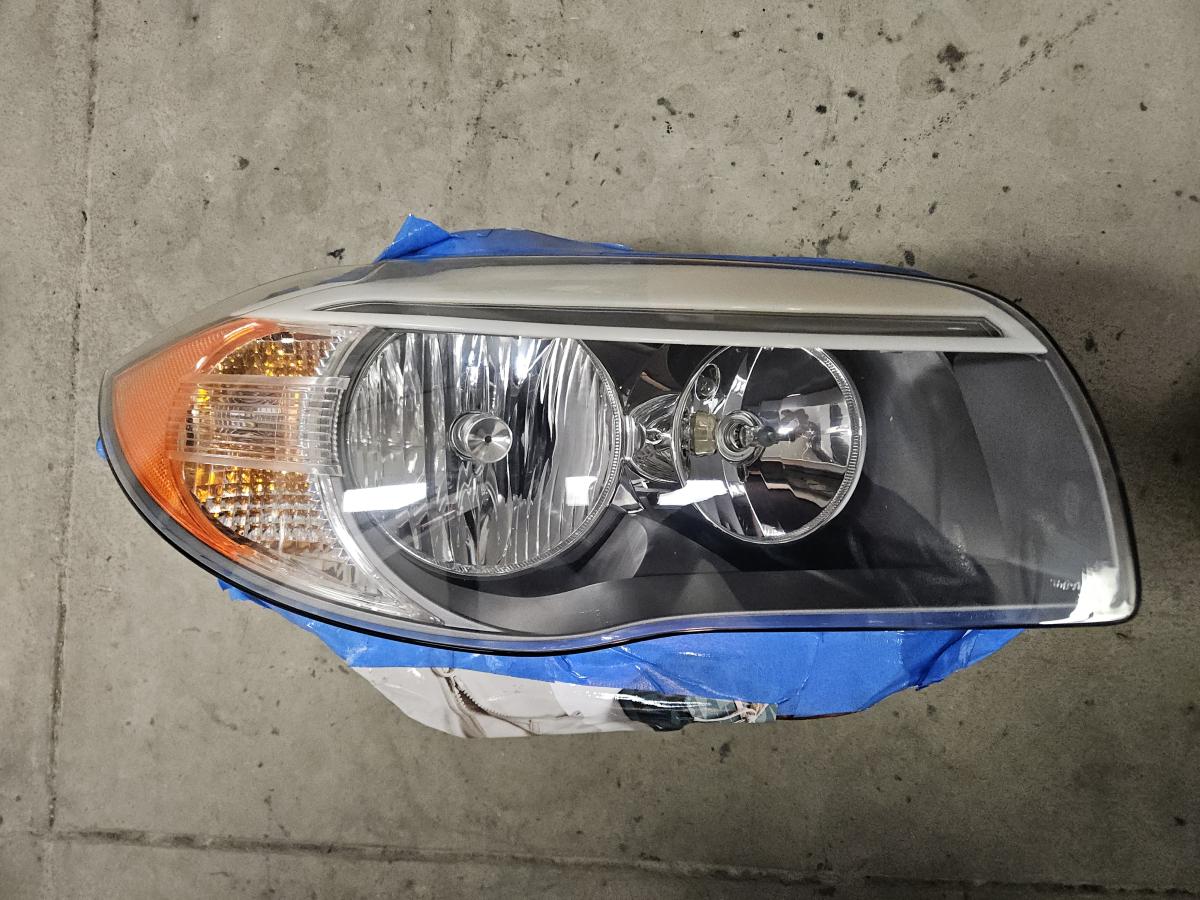

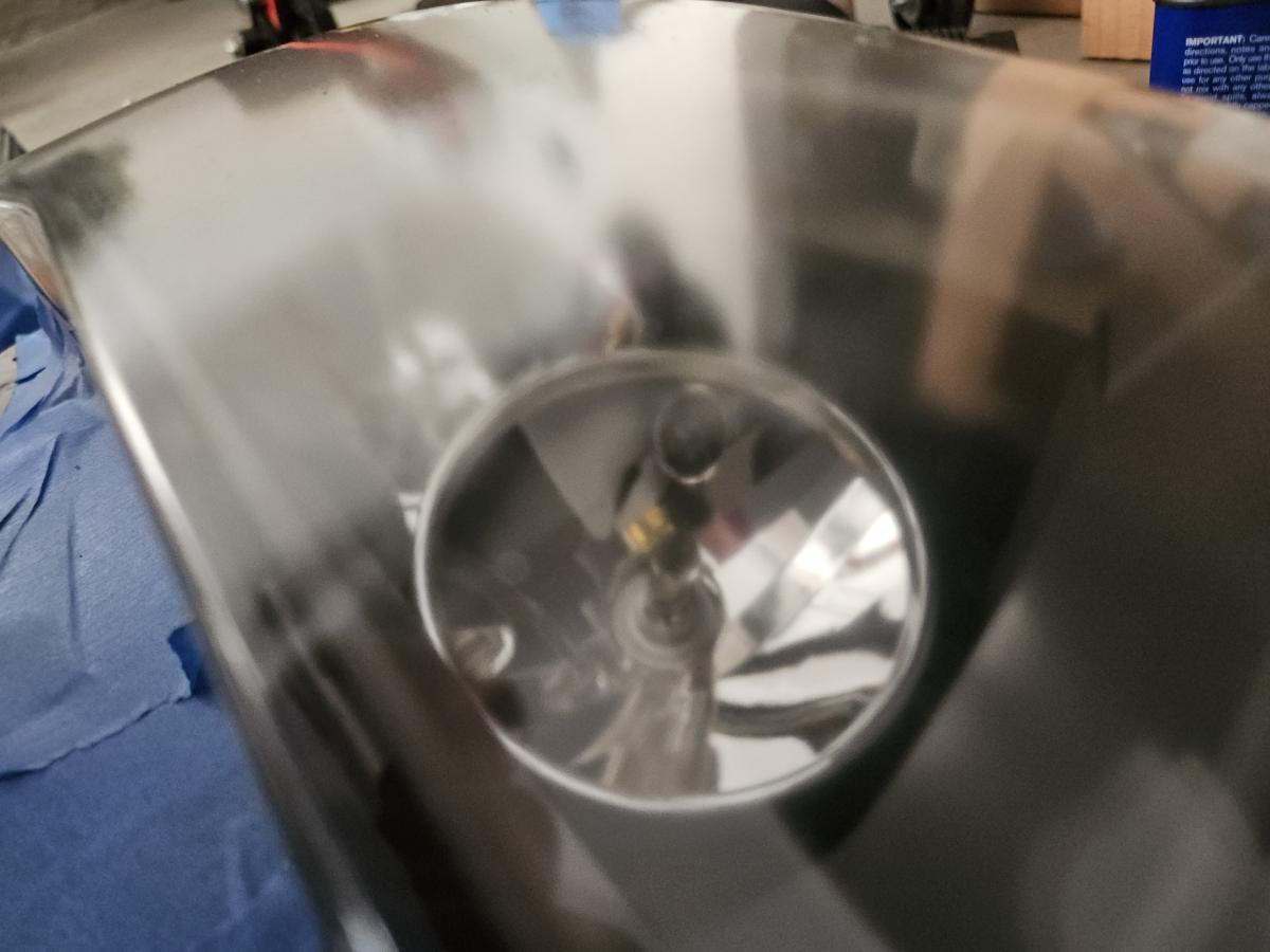

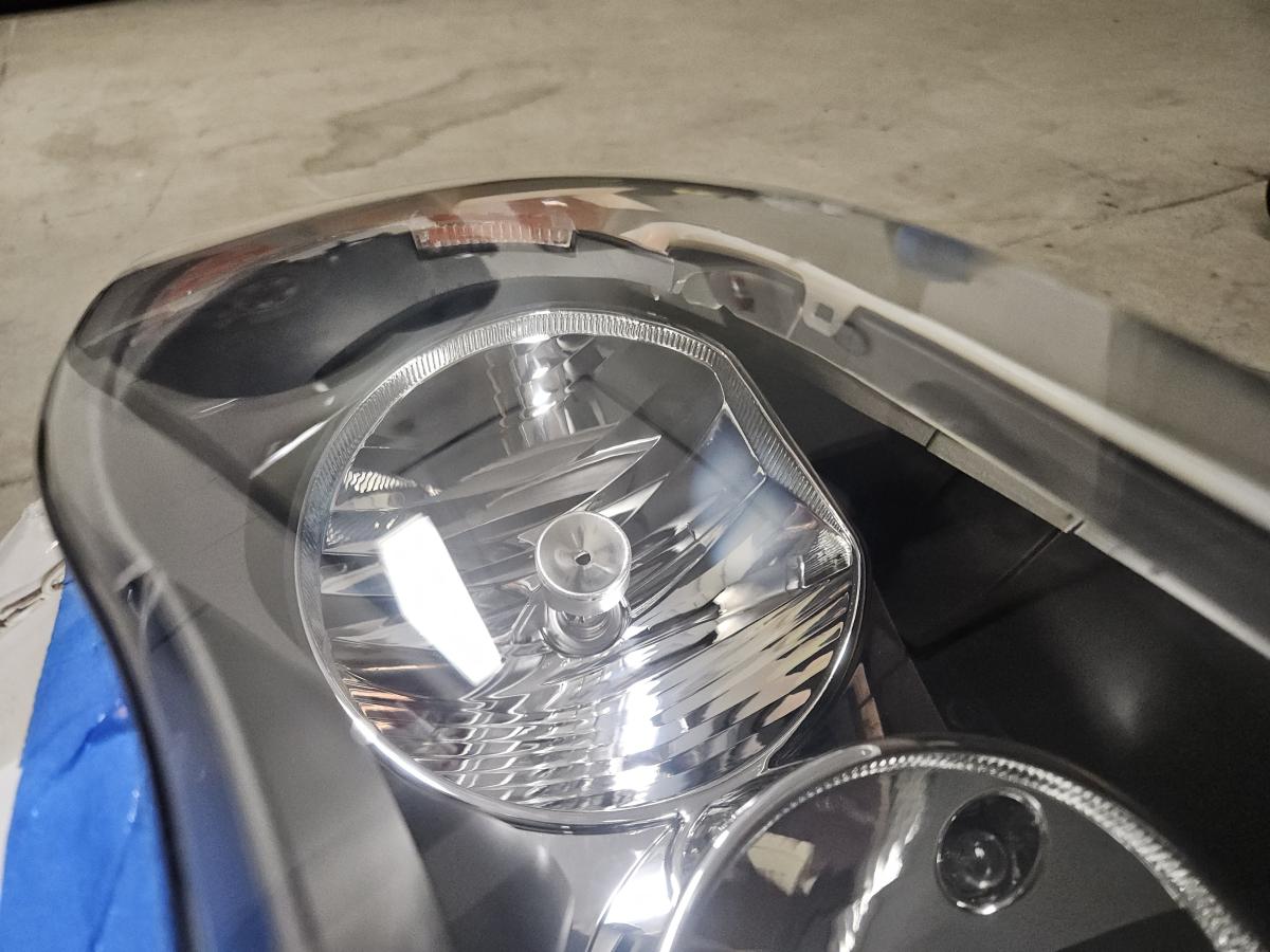

                      This is what the headlights looked like before any restoring (keep in mind I polished them about a year and a half ago):

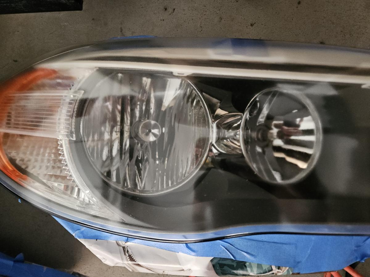

                      Compounded and polished, then added a few coats of Meguiars headlight coating. The results were pretty terrible, which is exactly what happens every single time I try to paint something. Ended up with way more orange peel than I wanted:
                      Initially, I was going to wet sand them and then repolish, but I've decided that I don't want to keep doing this every year. Instead, I've ordered a can of SprayMax 2K Headlight Clear. Will sand them down back to bare plastic then use that to clear coat them. I've heard very good things about these 2K products and the ease of application, but I'm sure I'll find a way to screw it up. I'm just hoping that the results will last way longer than with the regular clear coat stuff. Plus, the car is out of commission until the new cooling system parts arrive, so it gives me time to mess with the headlights.
                      Man, I hate painting stuff almost as much as I hate brake fluid.

                          Great news, fancy clear coat worked incredibly well. Kinda blown away at how good it came out. Here's a closeup of the finish:
                          Bear in mind that this is straight out of the can. No postprocessing whatsoever.

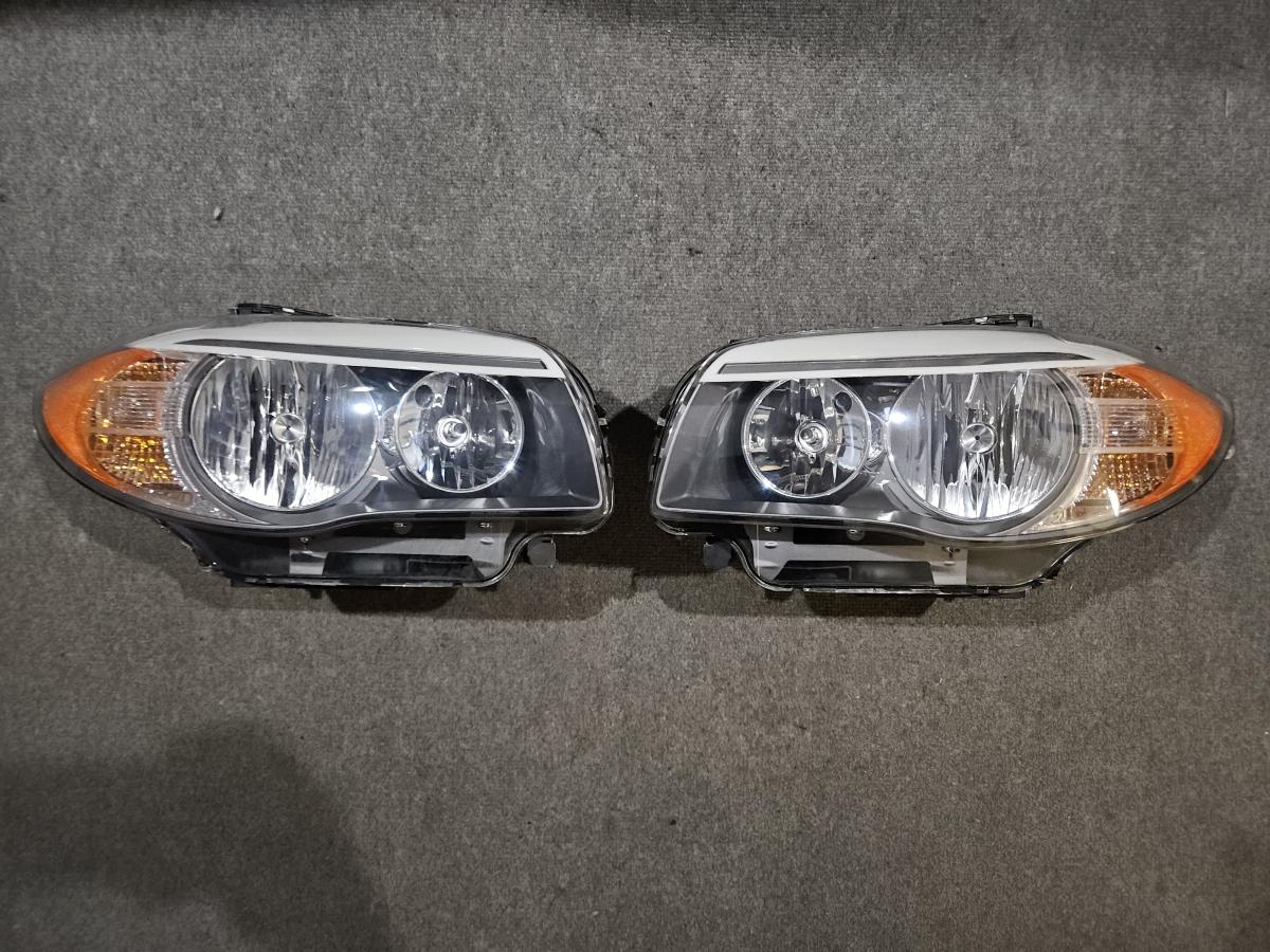

                          6. 2000 grit wet sand
                          7. Shake (warm) can for 3 full min
                          8. Activate
                          9. Shake can for another 3 full min
                          10. Spray light coat and wait 2 min
                          11. Spray medium-heavy coat and wait 2 min
                          12. Repeat step 11 two more times
                          13. Wait 24 hrs for them to fully cure
                          Ended up doing three of the medium-heavy coats instead of just one because I got some pin holes on the first one. Didn't seem to affect the finish quality at all.
                          Anyway super happy with this stuff. I'll likely use it again in the future for things like this. Unfortunately, it is incredibly toxic and requires appropriate PPE. Sprayed outside and took my respirator off ~5 min after spraying the last coat and the smell was still very strong. Respirator immediately went back on and I ended up doing the clean up in full PPE.
                          I also swapped in these bulbs. They should output significantly more light than the stock bulbs, according to the spec sheets. Note the tube of threadlocker I used to make sure those top two headlight screws don't come loose again:
                          Here's a before and after of the entire project:
                          But of course not everything went well. Managed to break another coolant line while replacing the line I broke a couple weekends ago:
                          I thought I was going to be able to cheat the BMW cooling system curse for a bit longer since the car is fairly low mileage (~80k mi), but I guess that's not the case. I bet the high operating temps of this engine also help these plastic pieces degrade much faster.
                          I've ordered every single plastic part in the cooling system and will be replacing all that soon.

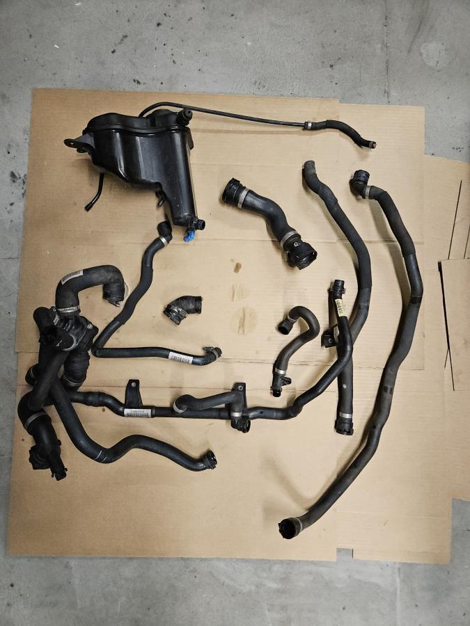

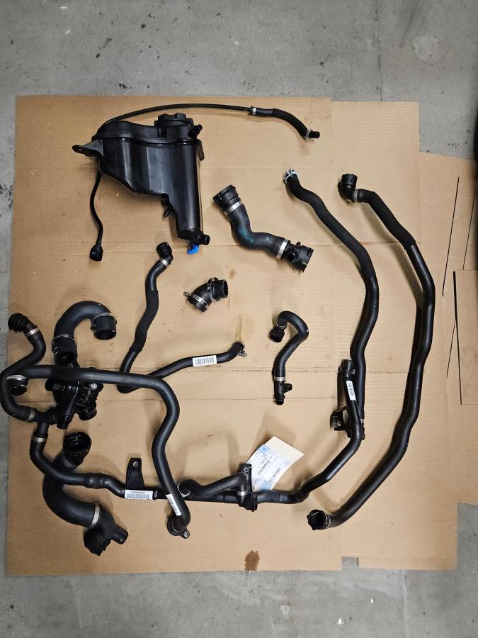

                                Cooling system parts finally arrived!
                                Well, sorta. Radiator is still stuck in a factory in Germany or something, but that's gonna get installed later cause this car was on jack stands for way too long.
                                Nothing really out of the ordinary with the install, just more time consuming than expected. There's a lot of hoses.
                                Old parts:
                                New parts:
                                Replaced the expansion tank and all but one of the hoses with genuine BMW stuff. Thermostat is OE made in Germany Mahle. Ended up keeping the plastic mickey mouse flange that came with the new hose instead of swapping the aluminum part on. It lasted 13 years, so should last 13 more.
                                The only hose that I cheaped out on was the coolant feed pipe that comes from the block. It's mostly metal except for a small rubber elbow where it meets the water pump (seen in the middle of the previous pictures). And of course BMW will only sell you the whole thing for $150. Decided to instead get just the elbow from Rein (made in Turkey), BMW o rings/seals/bolts for the block side and chance it. Here's the hose off the car with the old seals but new Rein elbow:
                                The thing was fairly hard to remove/reinstall. Flange is right underneath the exhaust manifold so access is tricky. Took a while and a lot of trying different extension combos, but got it in the end.
                                I also skipped replacing the water pump since that's metal, seems to be working alright and is easily accessible. Will replace it at some later date.
                                With the new parts in, I filled the system up and ran the bleed procedure. Unfortunately, the coolant temp sensor o ring was leaking quite a bit. This o ring is not listed separately from the sensor in the parts diagrams, so I completely forgot to order it.

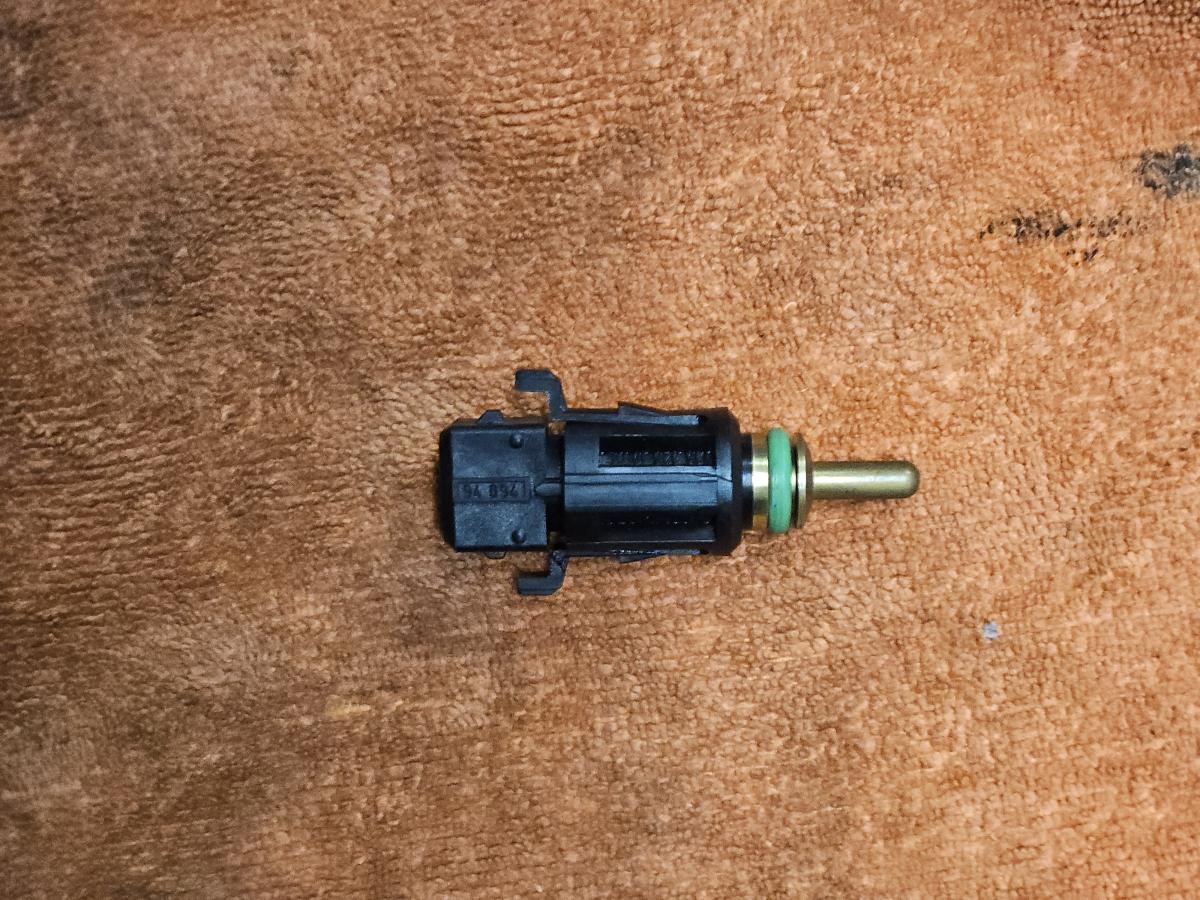

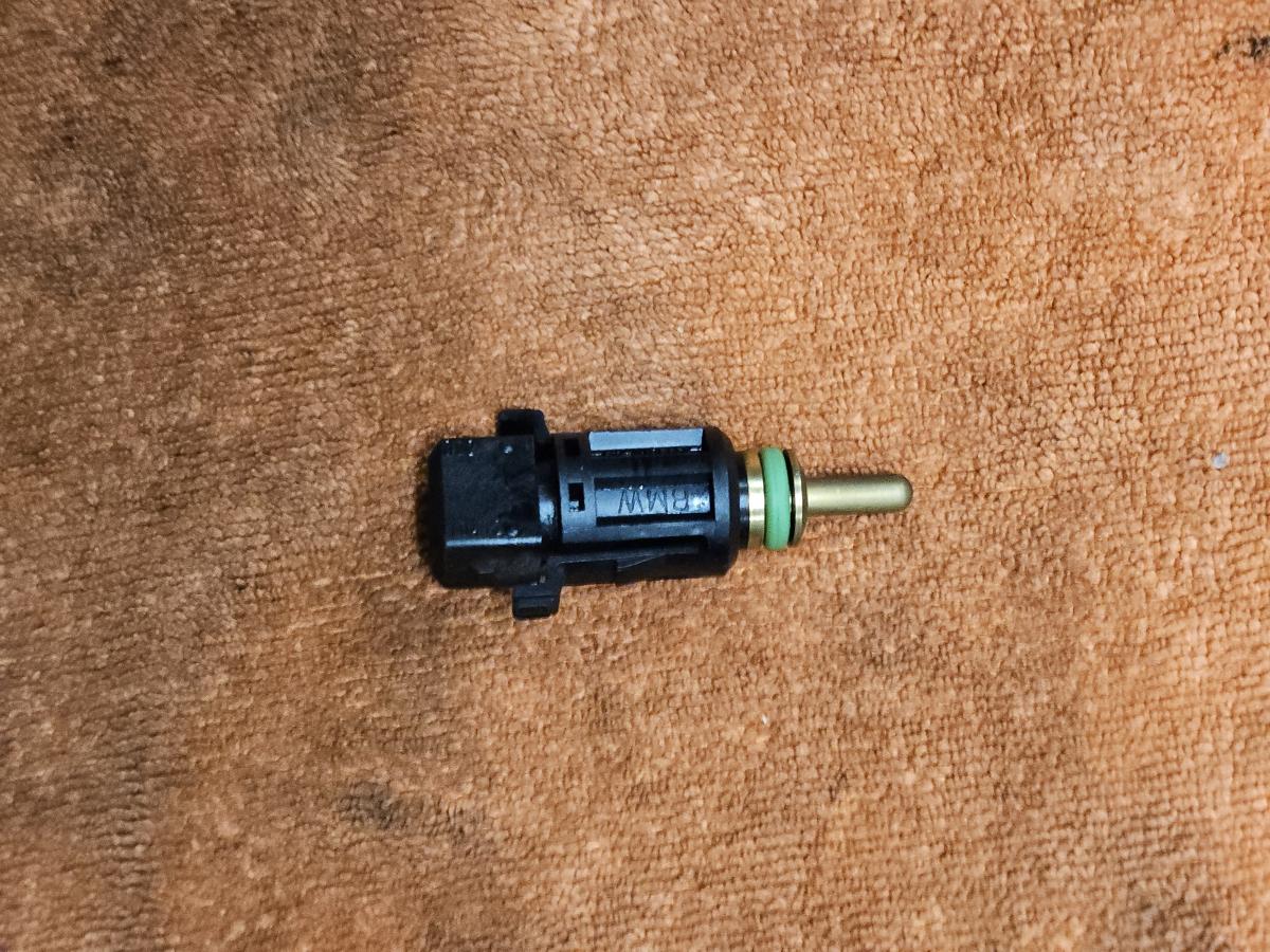

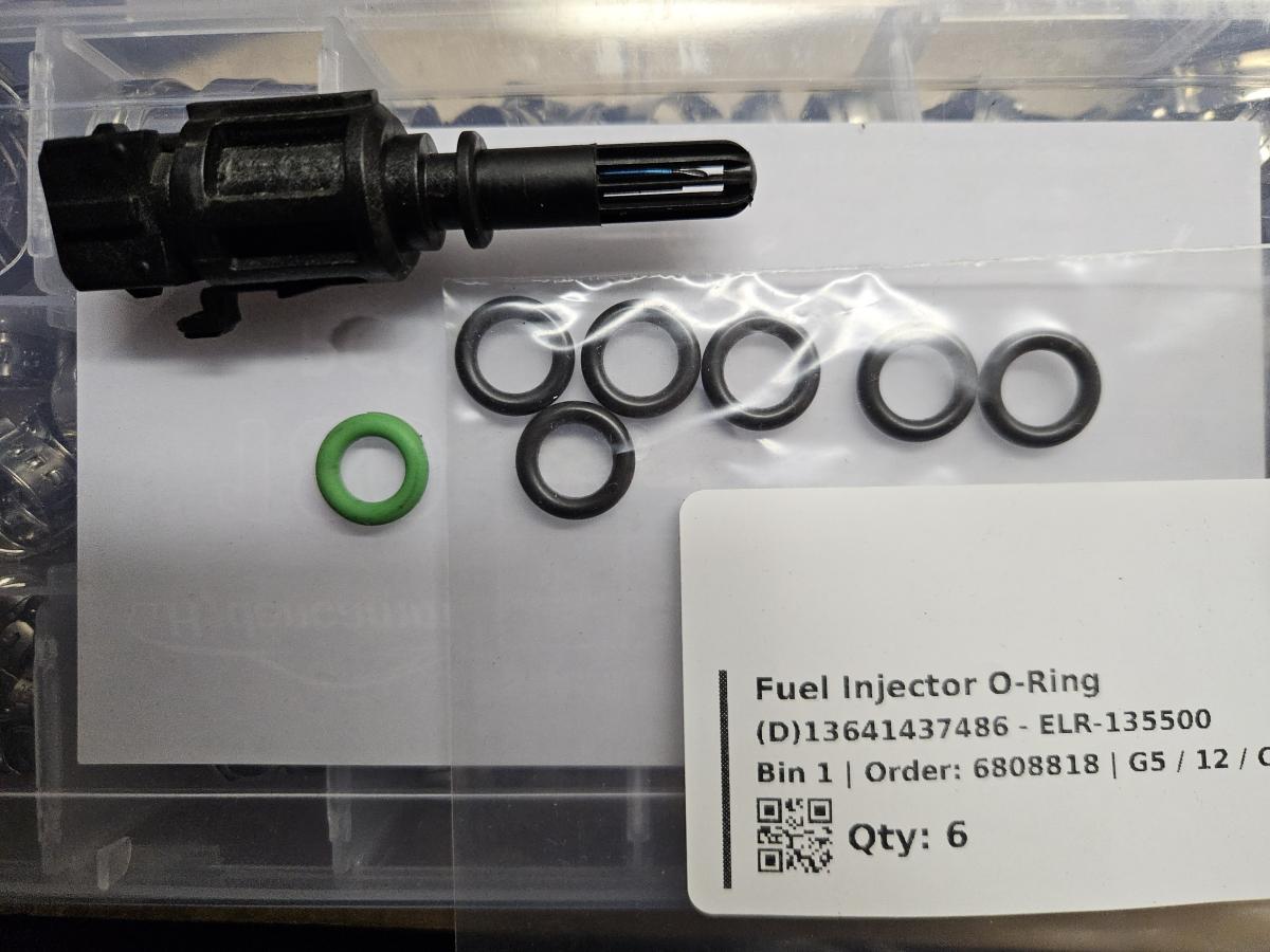

                                After a bit of searching, I found that the CSL IAT o ring is the same part, so I stole it from the M3 and put it on the E82.
                                Old o ring:
                                Less old o ring (from CSL IAT):
                                Buttoned it back up and no more leak! Seems to be sealing perfectly fine, but this isn't permanent. I'll replace it with a viton part from WOLFN8TR in a few weeks when I swap the new radiator in.
                                I also found that the M3 fuel injector o rings are pretty close in size to this green one, so I grabbed one of those from the stash and reinstalled the CSL IAT with it on:
                                Definitely seals well enough for an IAT, but will also replace this in the near future.
