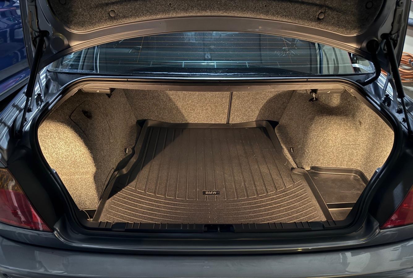

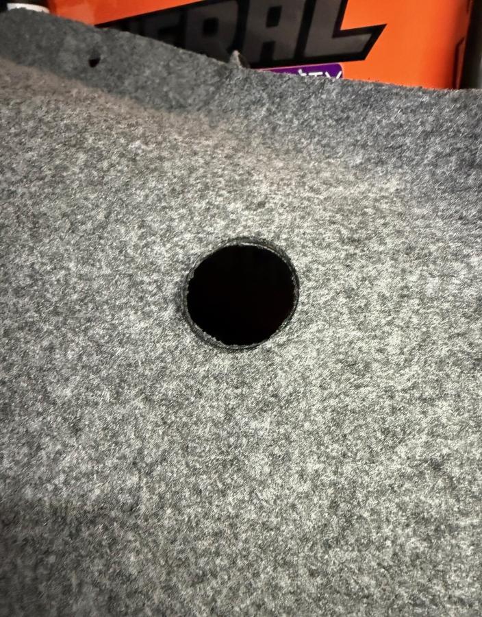

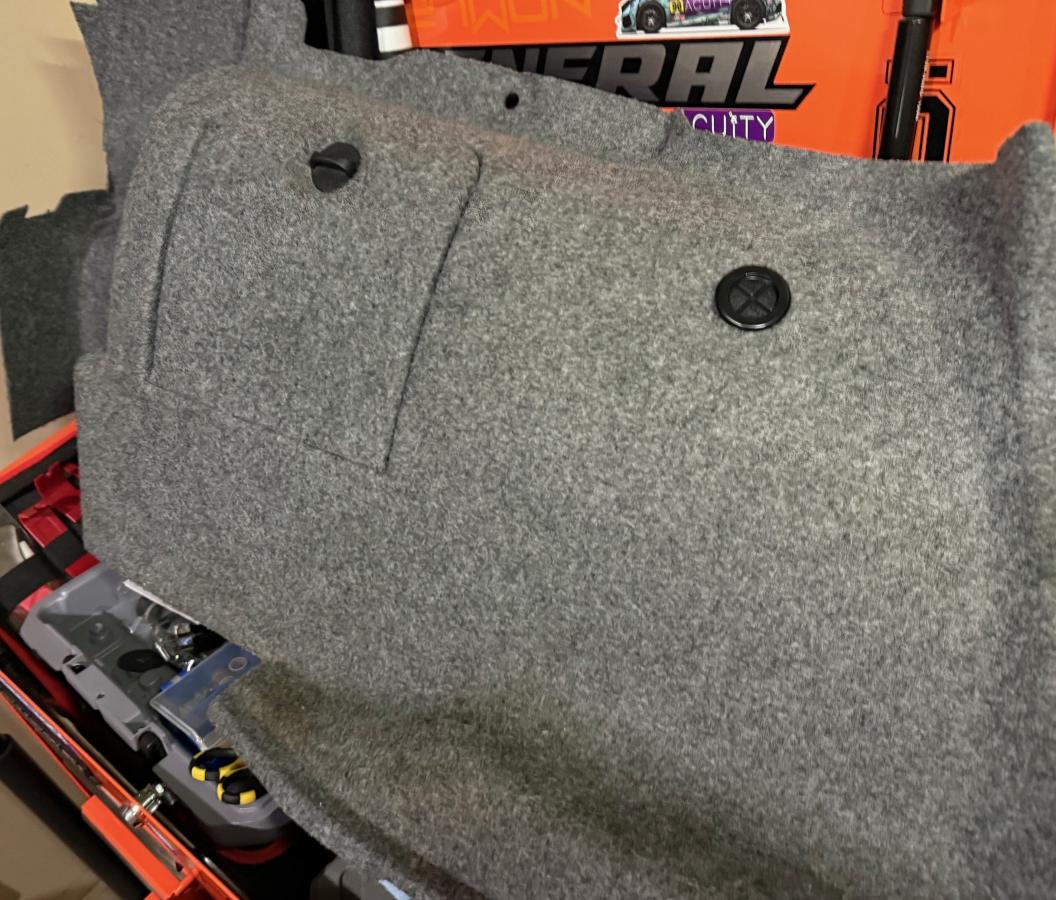

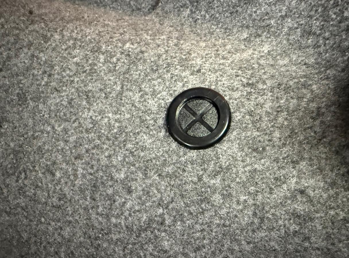

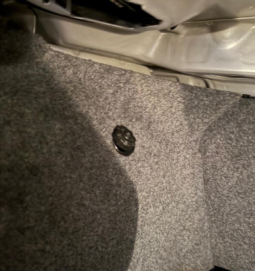

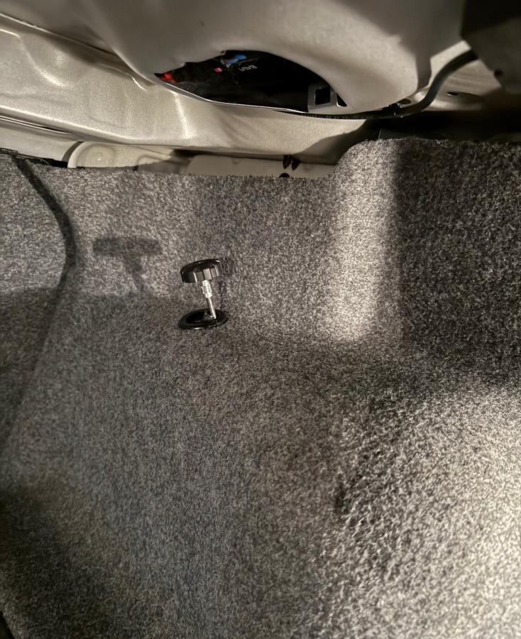

    the last bit was the trunk, and the only reason I haven't done it yet was because I wanted to figure out the best way to modify the carpet for the ohlins rt damping adjustment knobs. the shop just cut some holes in the carpet and it looked like ass, so I figured I'd give it shot. turned out pretty good, just wish the passenger side was a bit more centered.

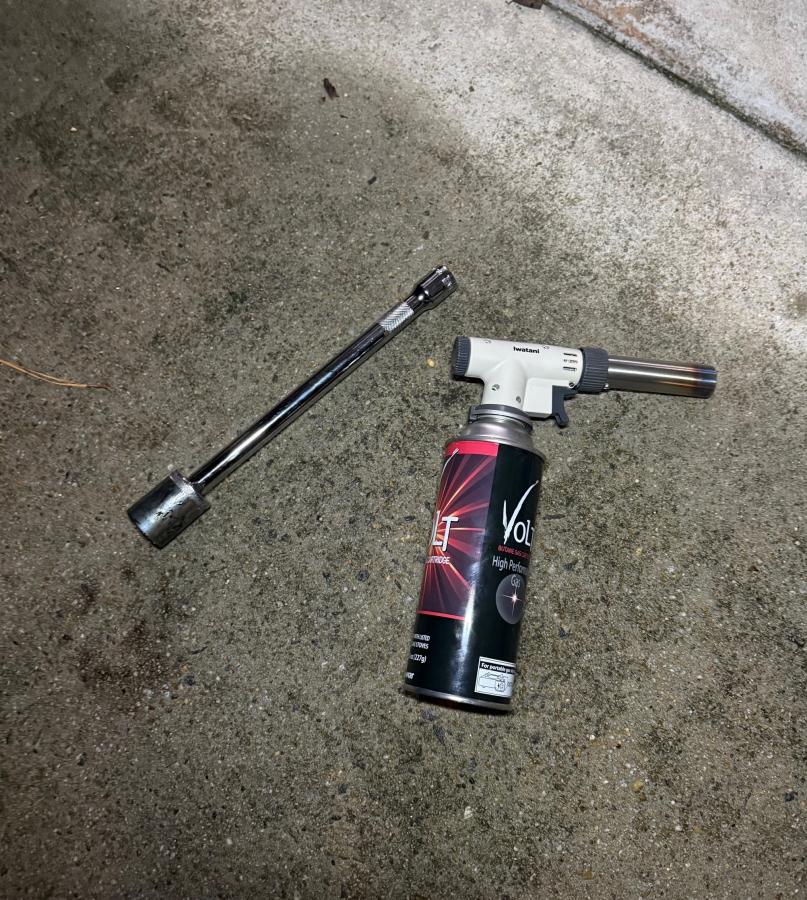

    I ordered the grommets below from amazon and use the second largest one. i just torched a 1" socket for at least 30-45 seconds and used a decent bit of pressure to press through the carpet. it turned out really nice.

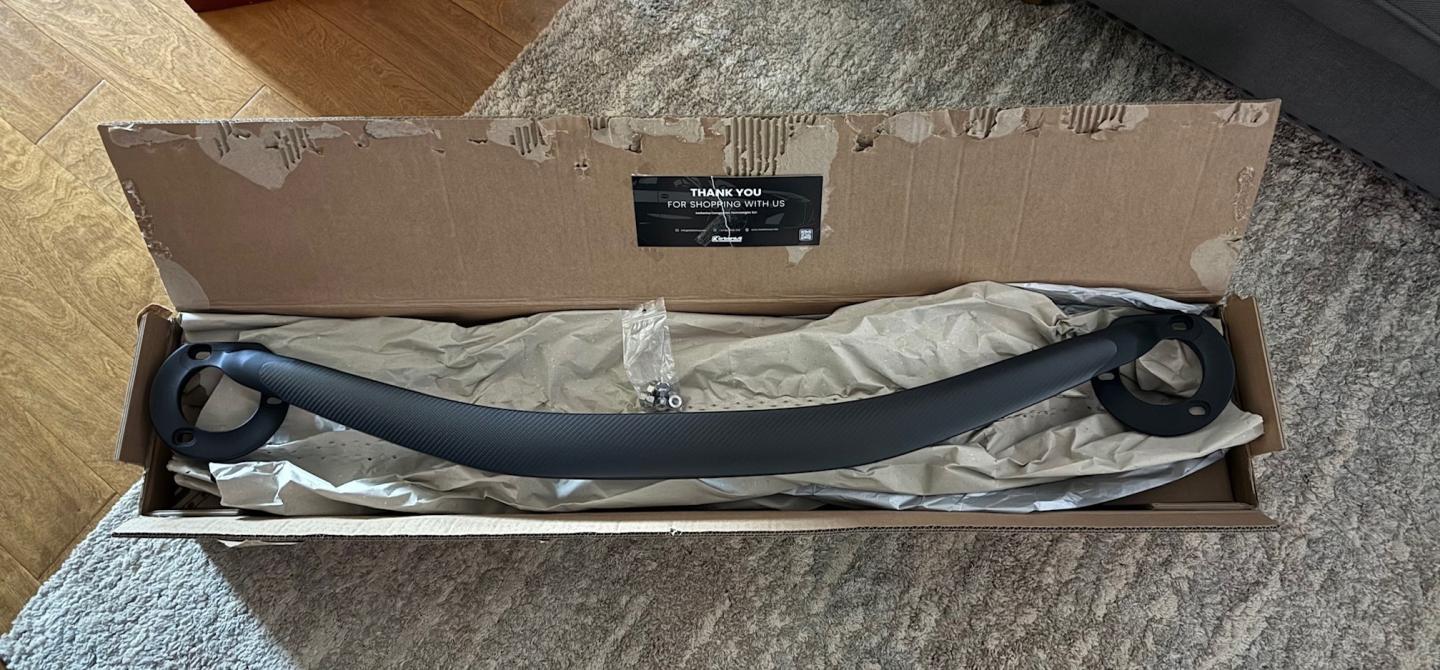

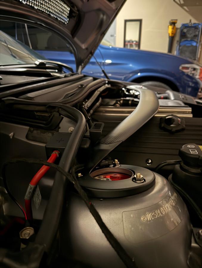

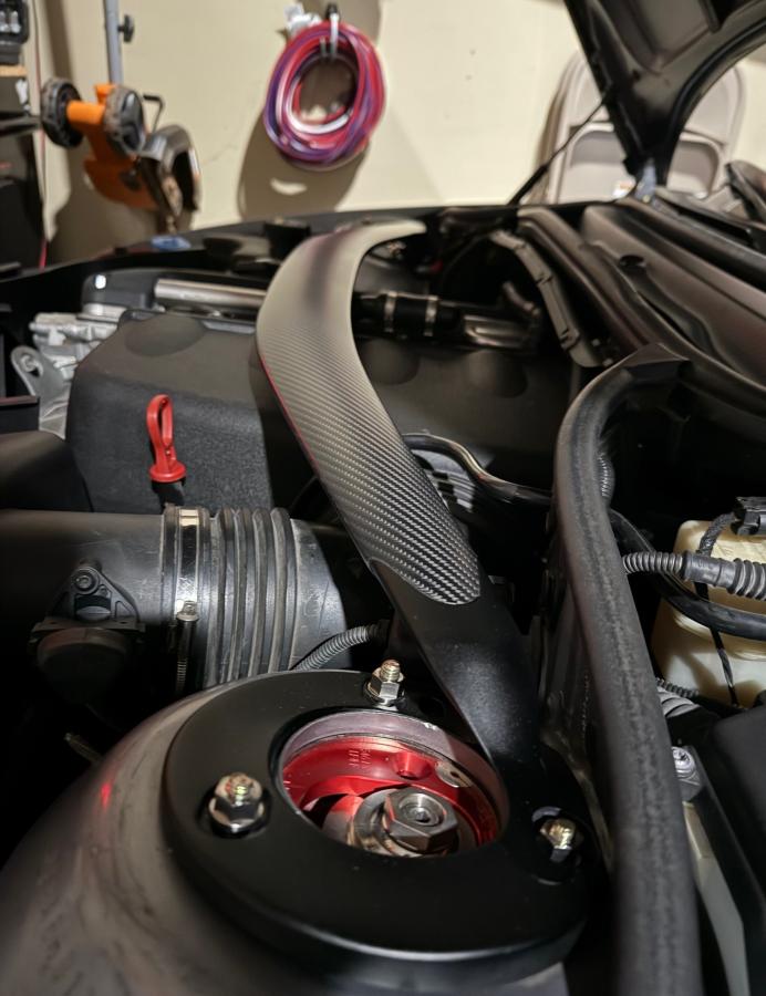

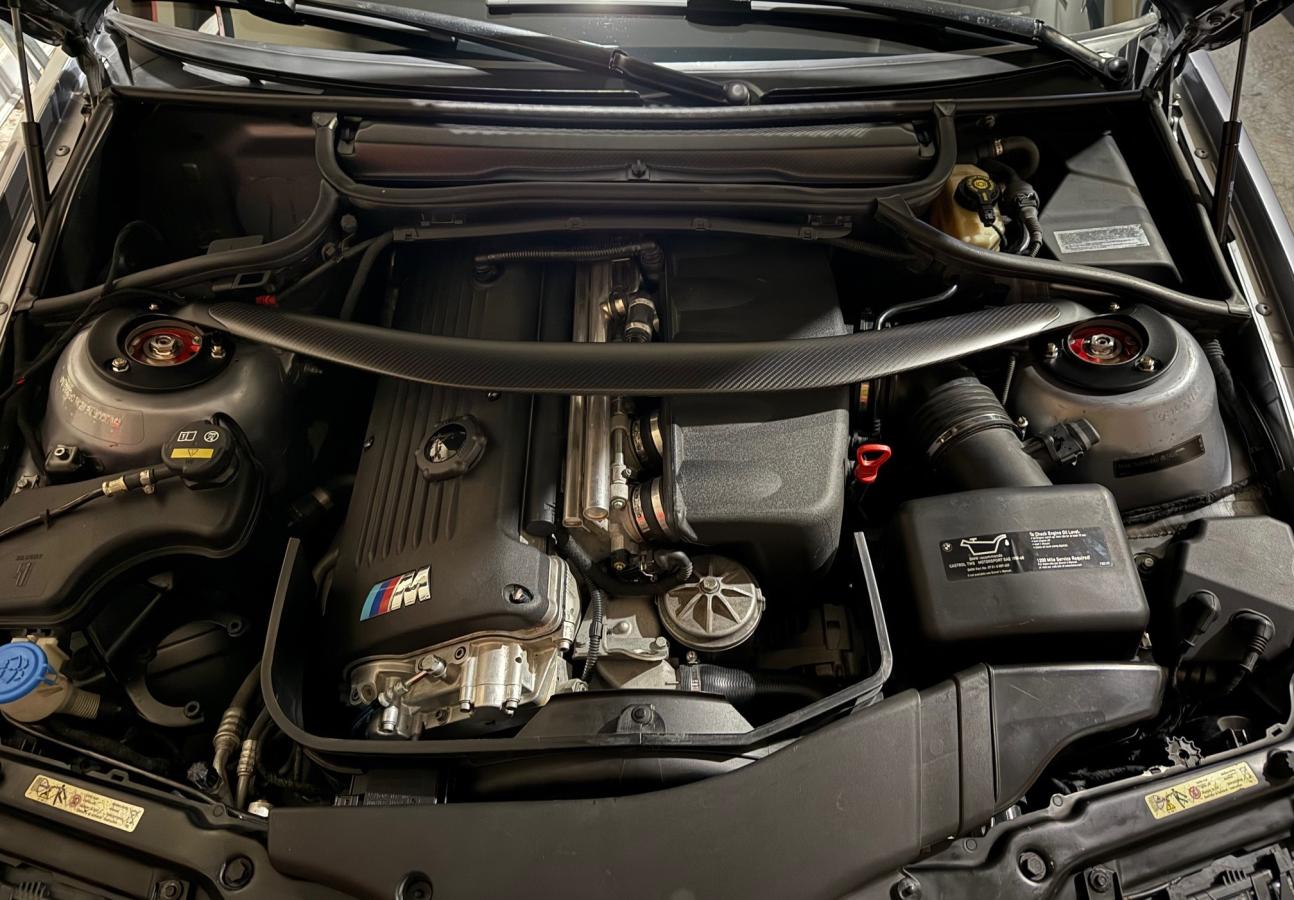

      ordered the all black version of the Karb strut bar. order was placed on 10/23, and received today 11/27. $1160 euro equaled out to $1257.44 USD at the time for currency conversion. also had to pay customs duties to DHL to the tune of $45.82 USD. really beautiful piece from Karb as always, I'm still waiting to install the intake and engine cover, but thought this was simple enough to knock out in a few minutes.
