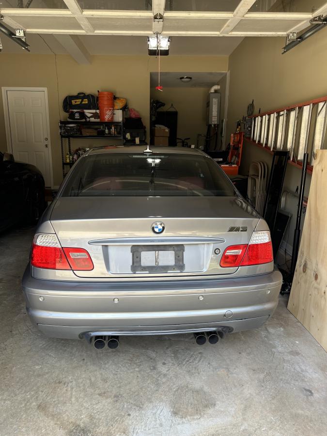

    Day 1
    First day, made it home on a roughly 2 hour drive back.
    Click image for larger version  Name:	front quarter 19.jpg Views:	0 Size:	168.8 KB ID:	224098
    Click image for larger version  Name:	rear.jpg Views:	0 Size:	86.7 KB ID:	224099

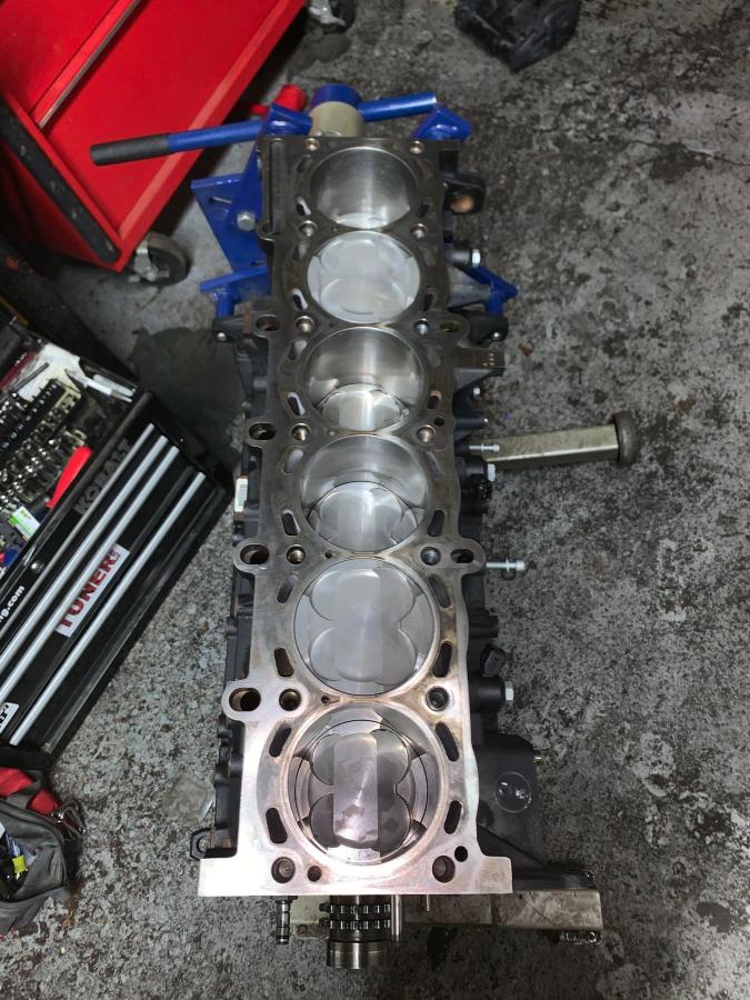

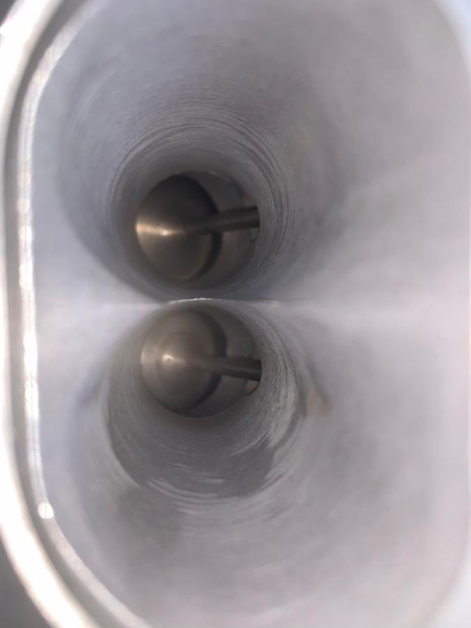

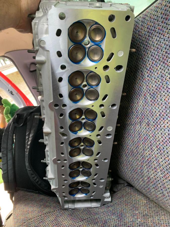

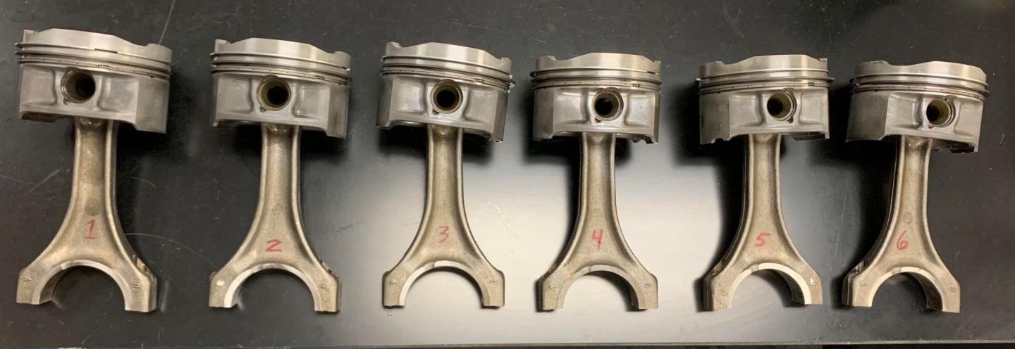

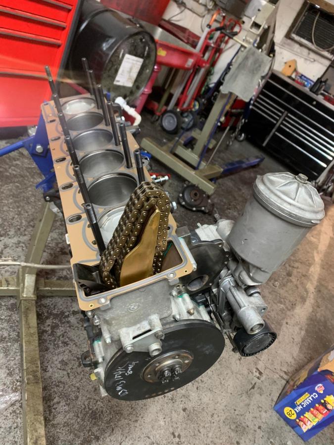

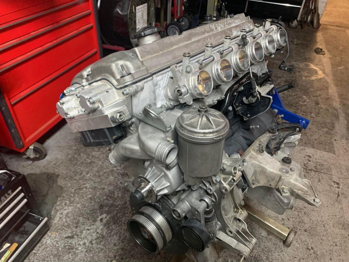

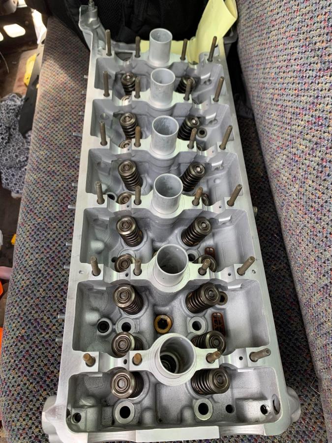

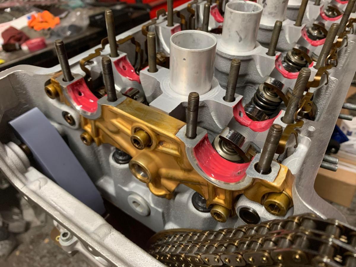

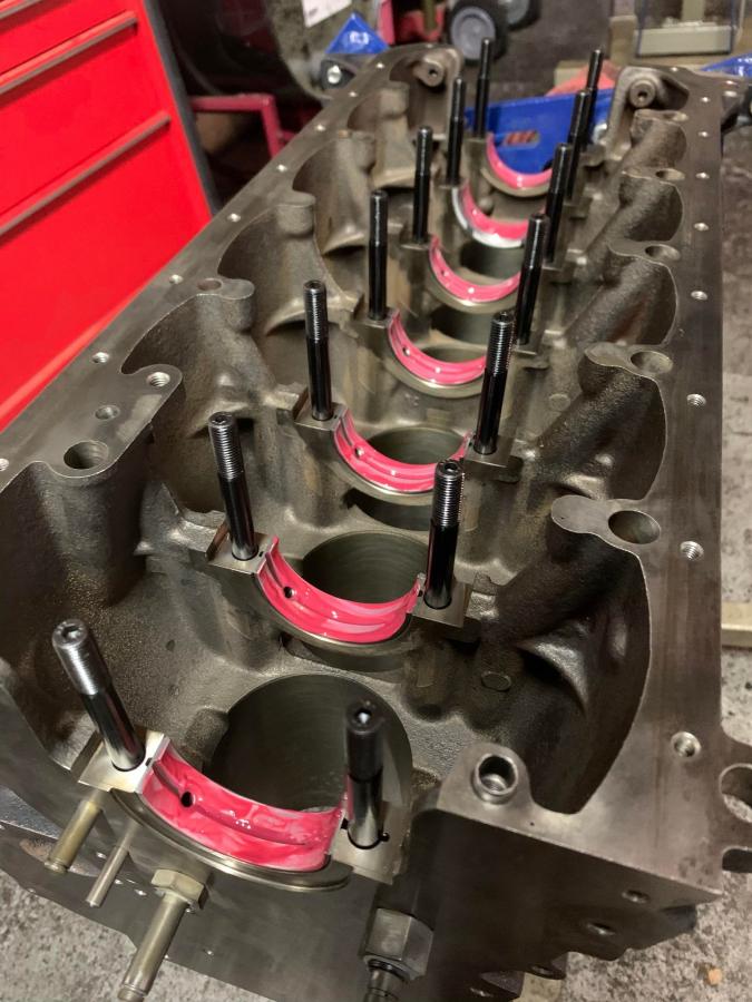

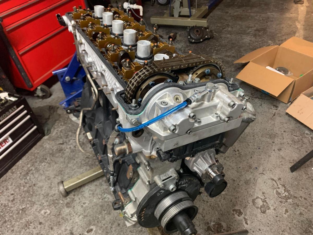

    Some pictures that were shared to me from previous owner of the engine rebuild. I think he did a great job, and the motor runs awesome. It did throw a code when I was there and he mentioned that I would need to change the VANOS solenoid soon. Have one on order from Beisan and it looks like a simple process. Car actually cut off on me a few times so I turned the AC off and it ran without issues.

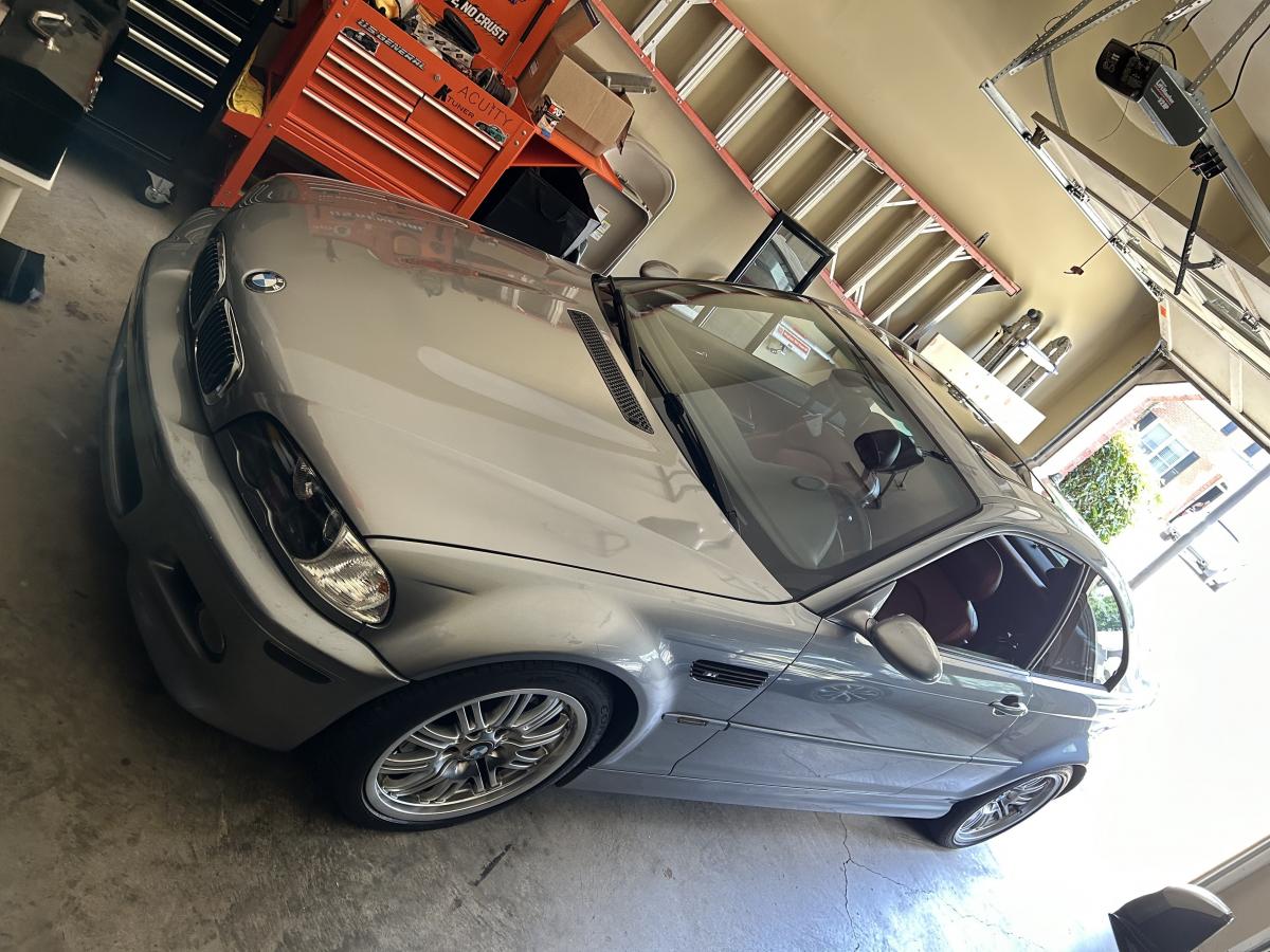

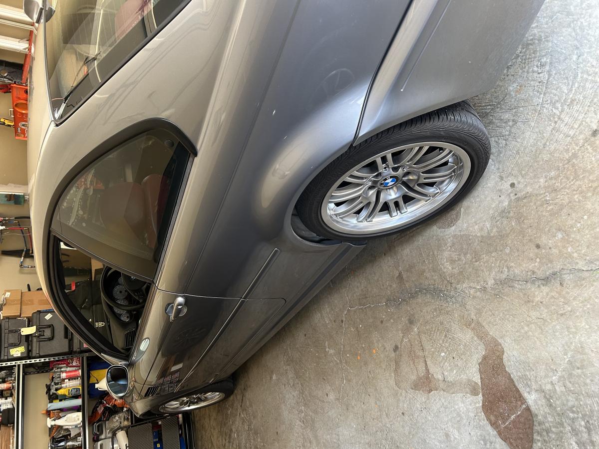

      Traded a local fellow enthusiast for his 18" style 67's. May end up trying to save some money and acquire a couple more rear wheels to go square setup on factory 67's. Not sure...need to consult some of the local guys who know way more about setups to make a decision.
      Click image for larger version  Name:	rear quarter 18.jpg Views:	0 Size:	174.4 KB ID:	224115
      Click image for larger version  Name:	front quarter 18.jpg Views:	0 Size:	167.7 KB ID:	224116

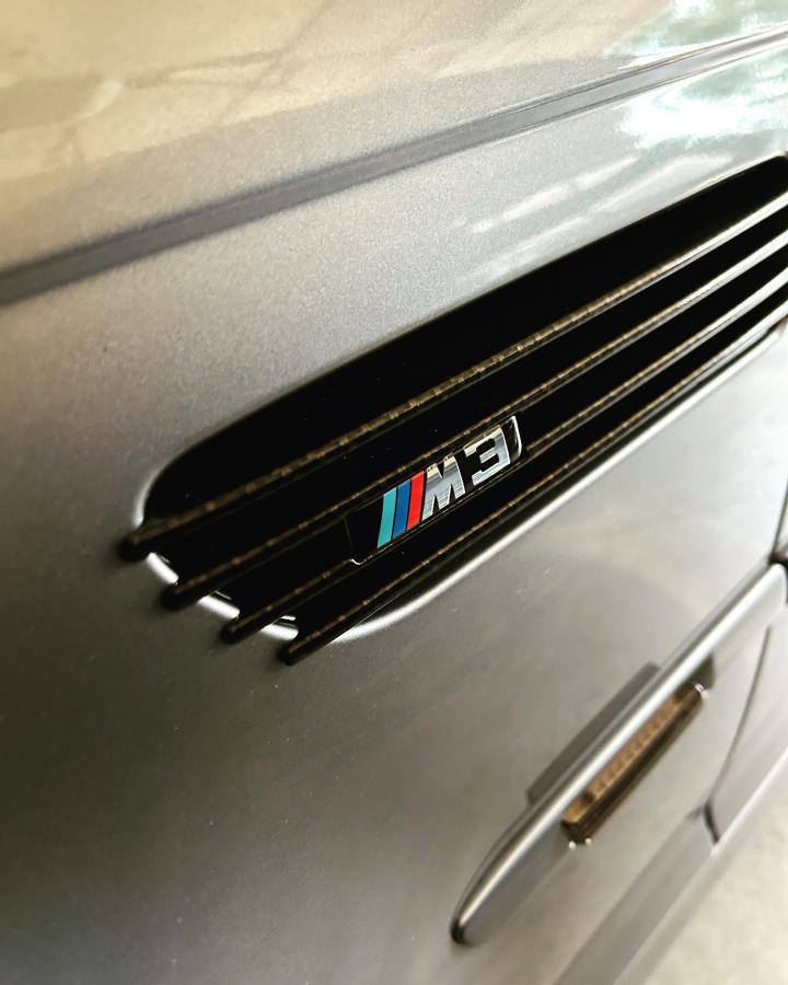

      Looks like the side grills are some aftermarket ones...well, the logos had faded and bubbled pretty bad so I replaced those.
      Click image for larger version  Name:	new side emblem.jpg Views:	0 Size:	60.2 KB ID:	224117

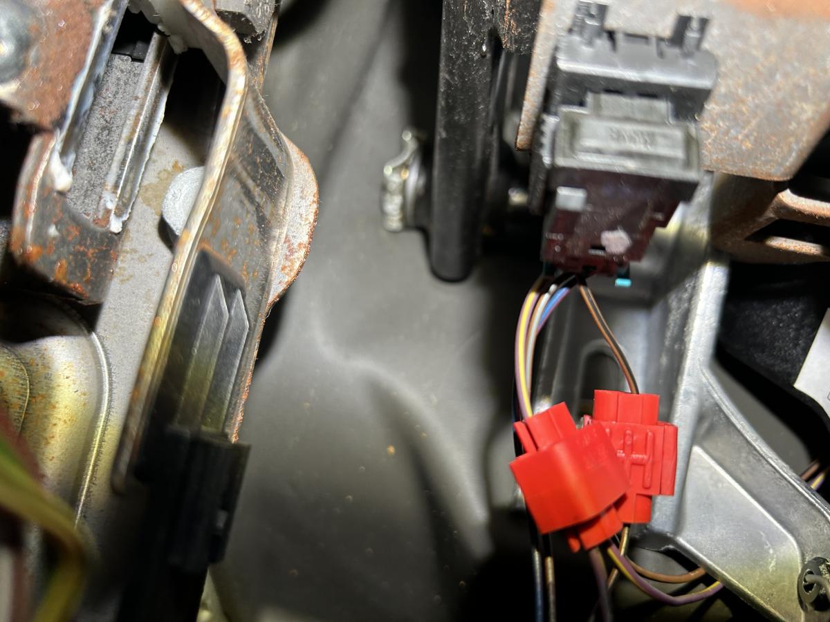

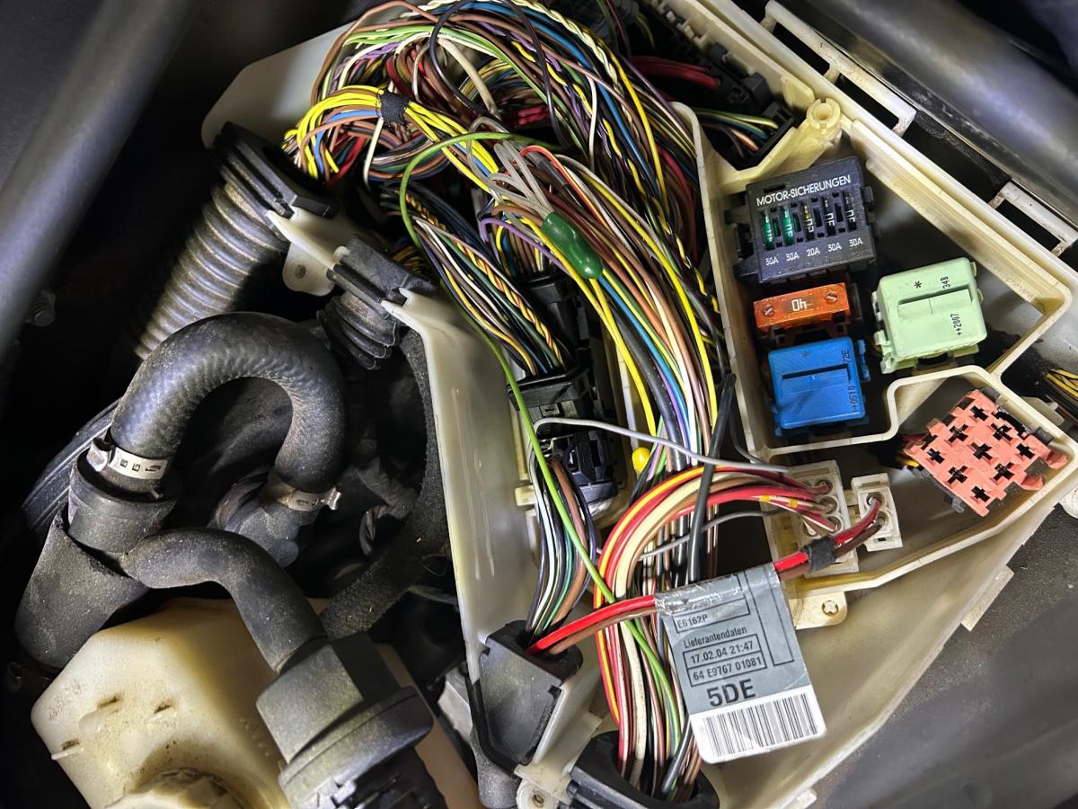

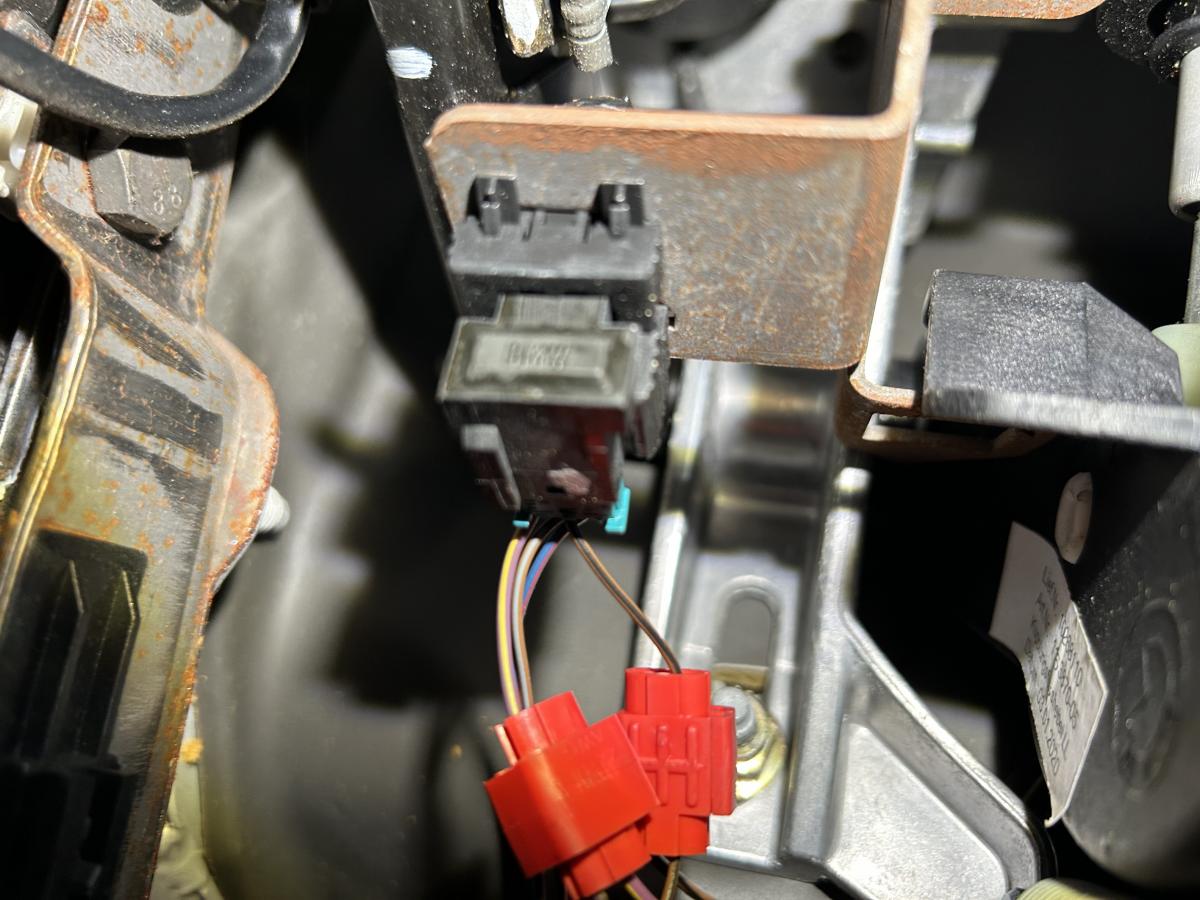

          I thought the intermittent stalling issue was fixed with the new AC compressor since it was driving beautifully all the way home, then of course on the lip getting in to my garage...I stalled. I basically spent hours upon hours trying to figure out what the hell is going on and it dawned on me that a lot of these SMG-to-6spd conversions have the same issues. The problem is that most of this information is scattered across the internet, which can make it frustrating to put the pieces together.
          I noticed there were a couple different ways of wiring out to pin 20 on the DME and it was based on whether or not a gear identification switch (23-14-2-229-113) was installed during the conversion. I figured this would be the first thing I would tackle once on jack stands. I think it's all sorted out now, after making some changes to the .bin file, checking to make sure SMG was coded out, etc. There were definitely some speedbumps here and there, but so much of it is due to variations between models, where the information is coming from whether it's a stock car, or engine swap, and even more variables. I come from the electrical testing world, where you absolutely need to verify contractor work.

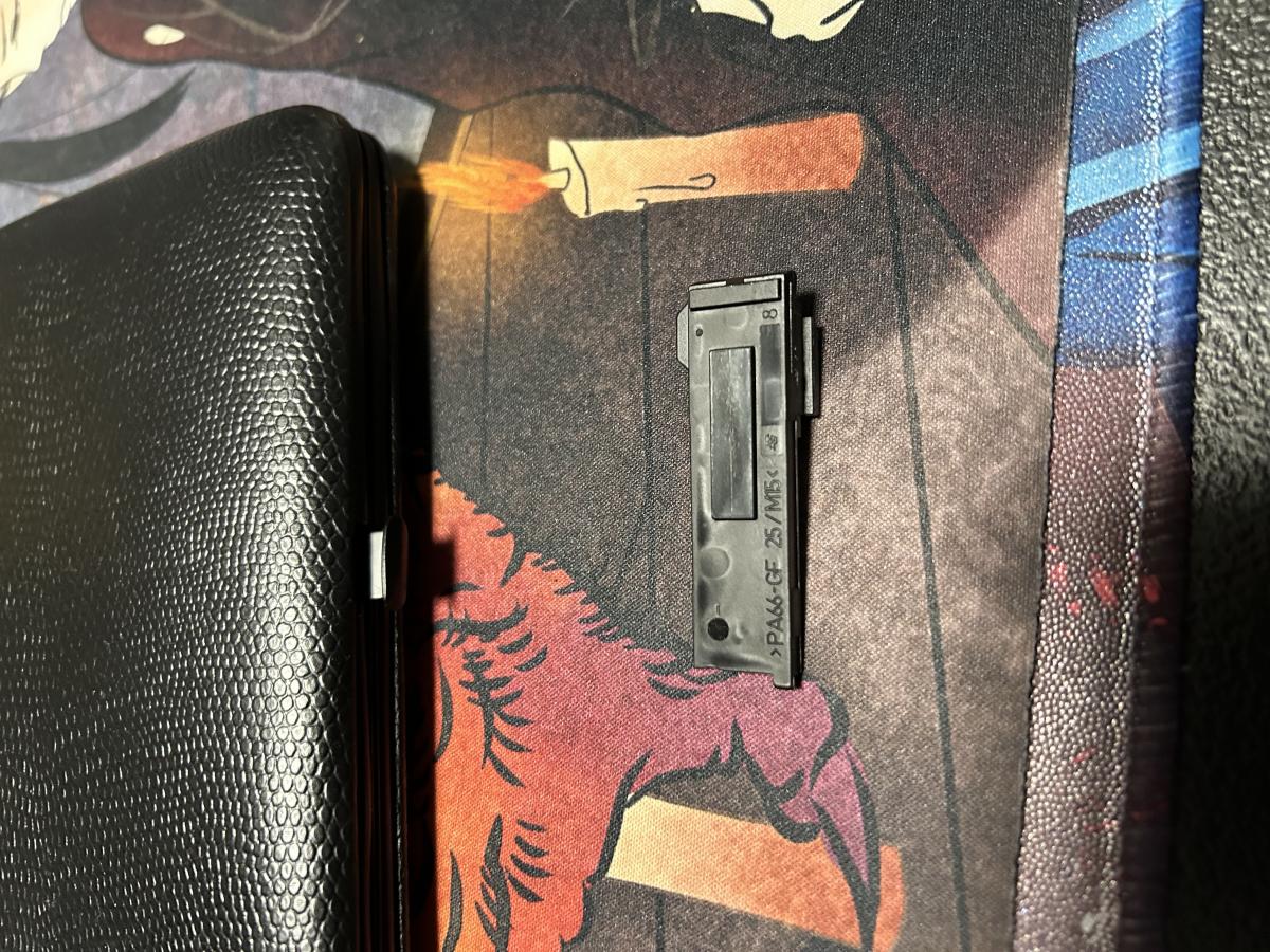

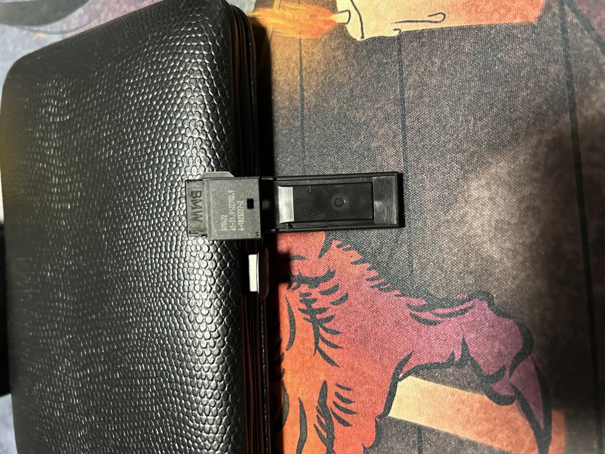

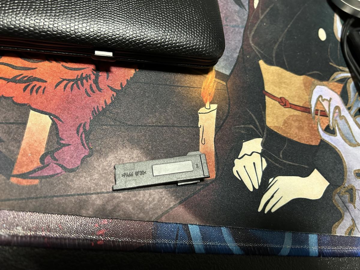

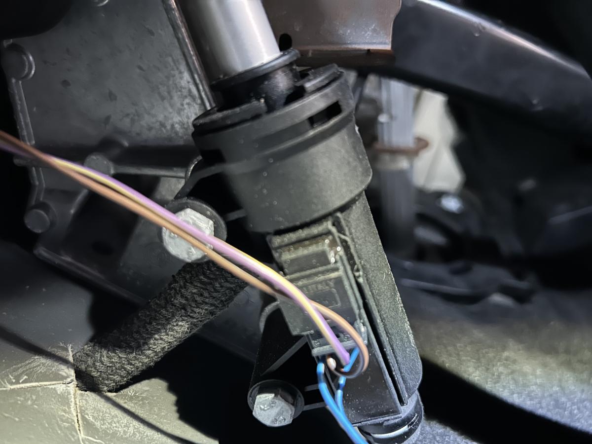

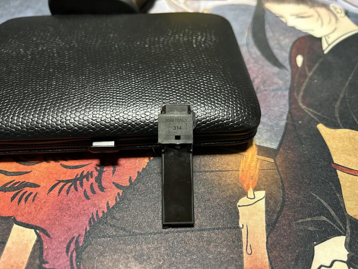

            When I went to take a look at how the clutch was wired, I noticed the wiring looked okay but the switch was unidentifable. No part number or anything, it just 20M Italy 314 on one side, and >PA66 GF30< on the other. Replaced it with the black 61-31-9-122-700 switch.

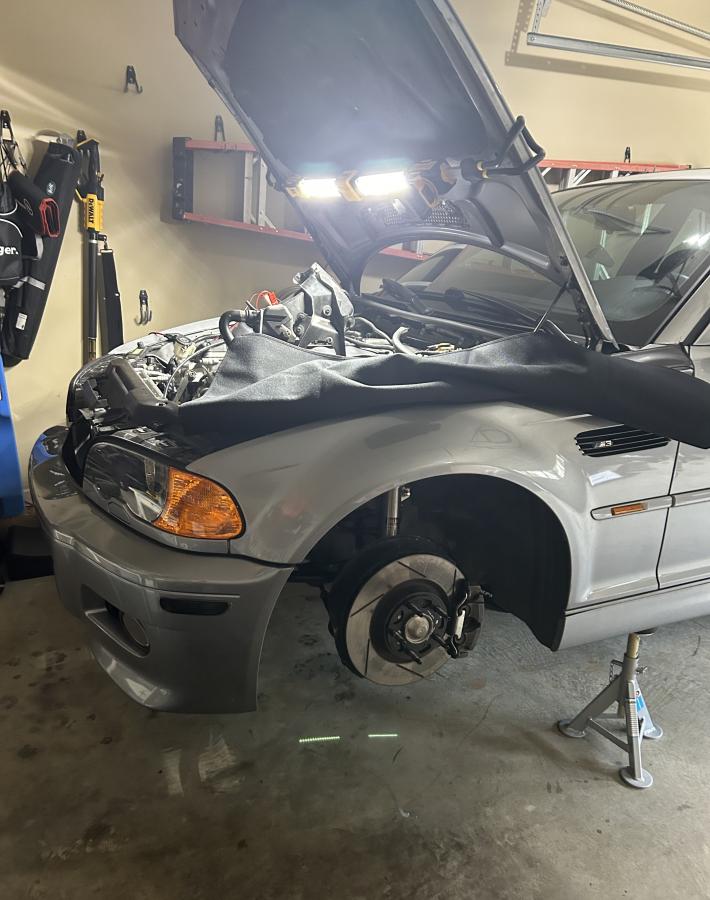

              I've been working at a snail's pace just due to a combination of having to go out of town during the week for work, waiting on parts, and trying not to get too into the weeds with this car.

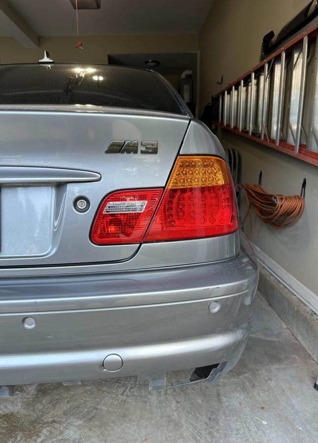

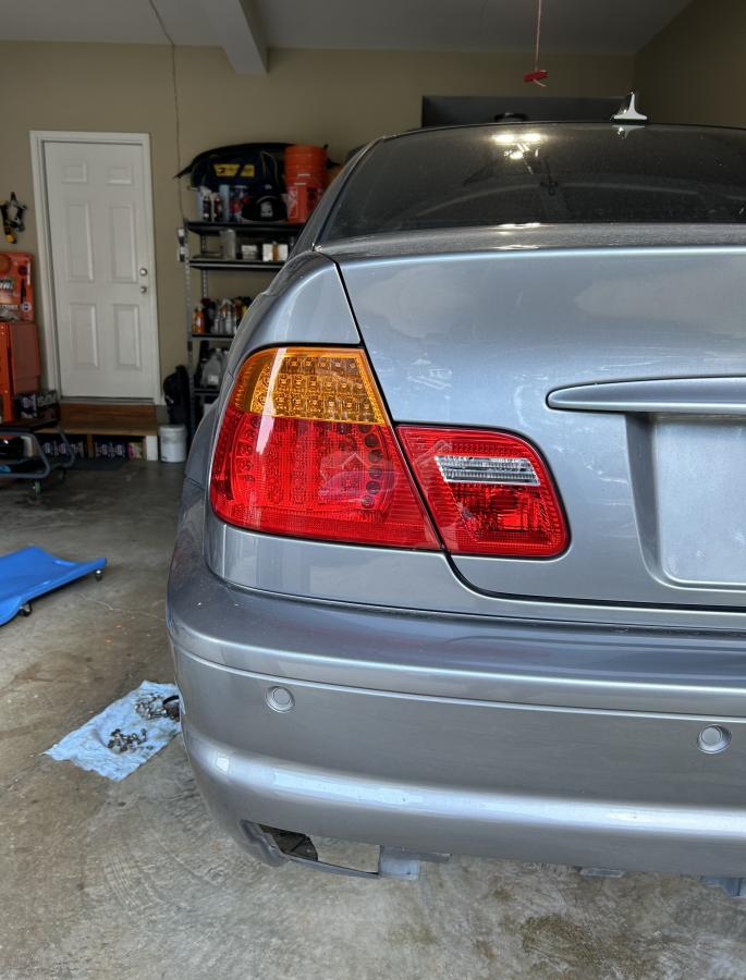

              I was able to source some amber tail lights, since I've seen some other members have some on their SG and it looks great. While I was waiting on parts to finish the exhaust system, I changed the front sway bar and end links, rear sway end links, new headlight level sensors front and back with new brackets or bushings.

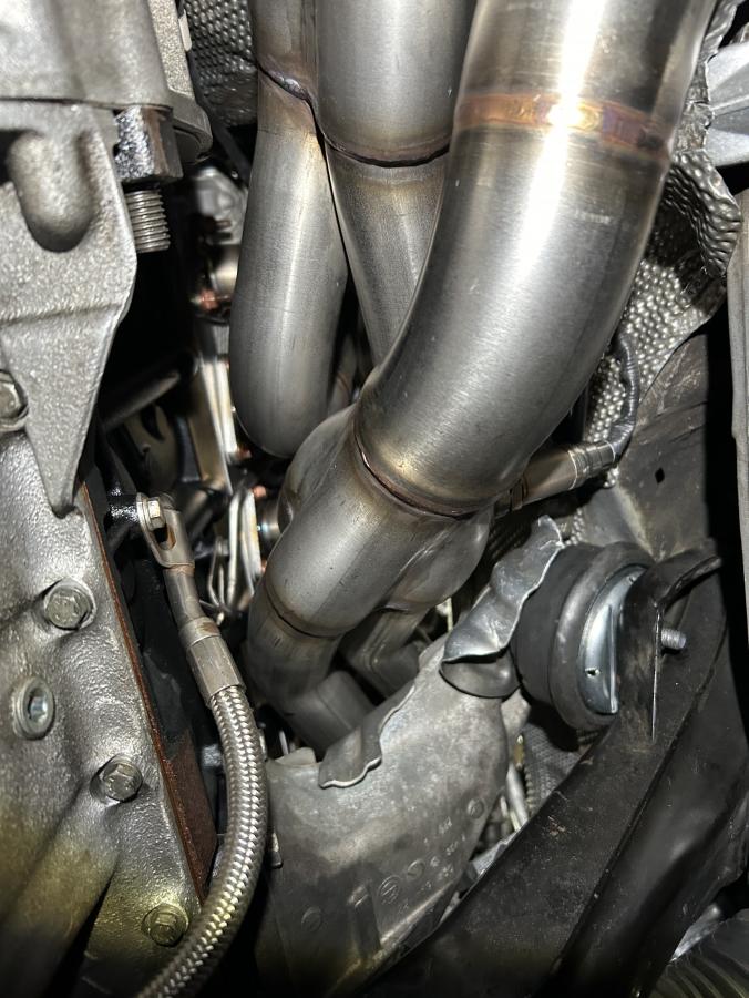

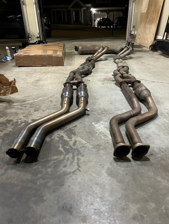

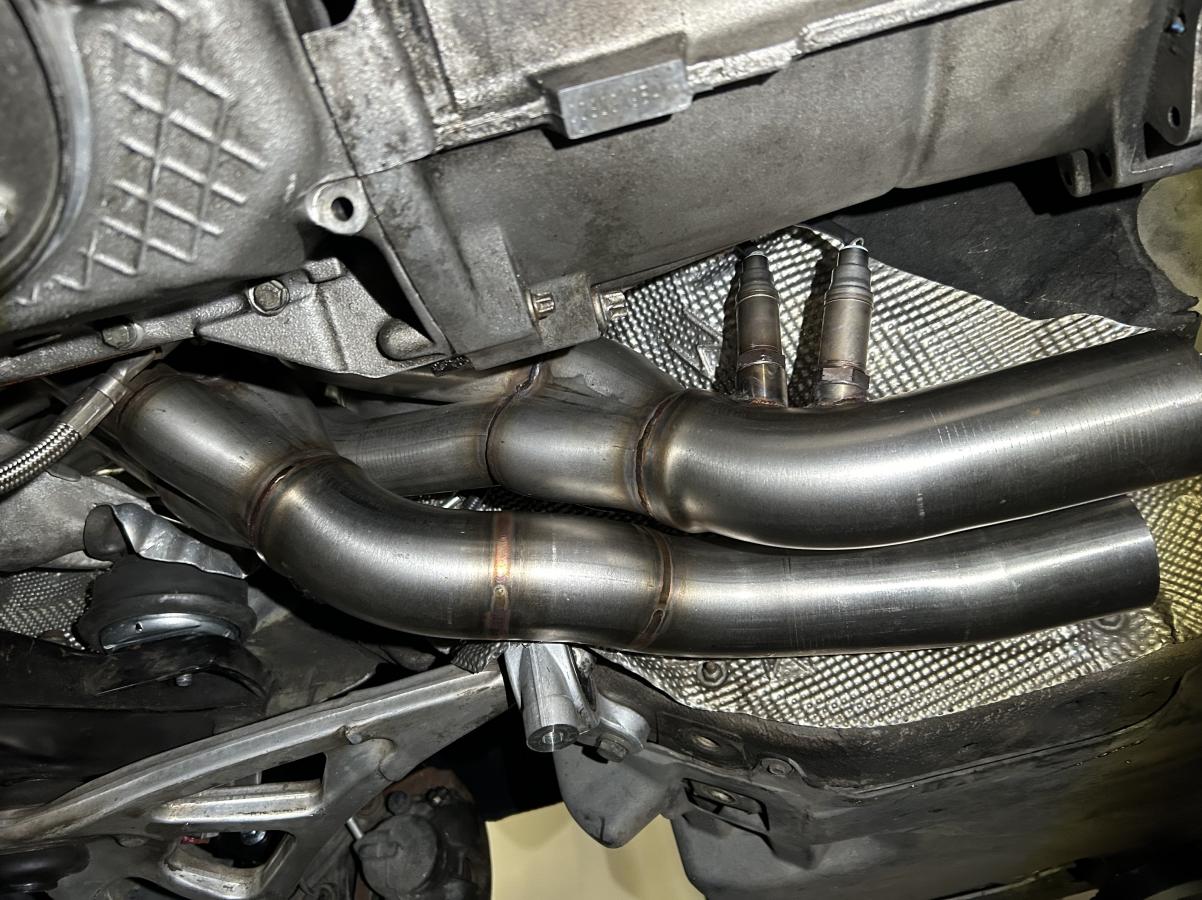

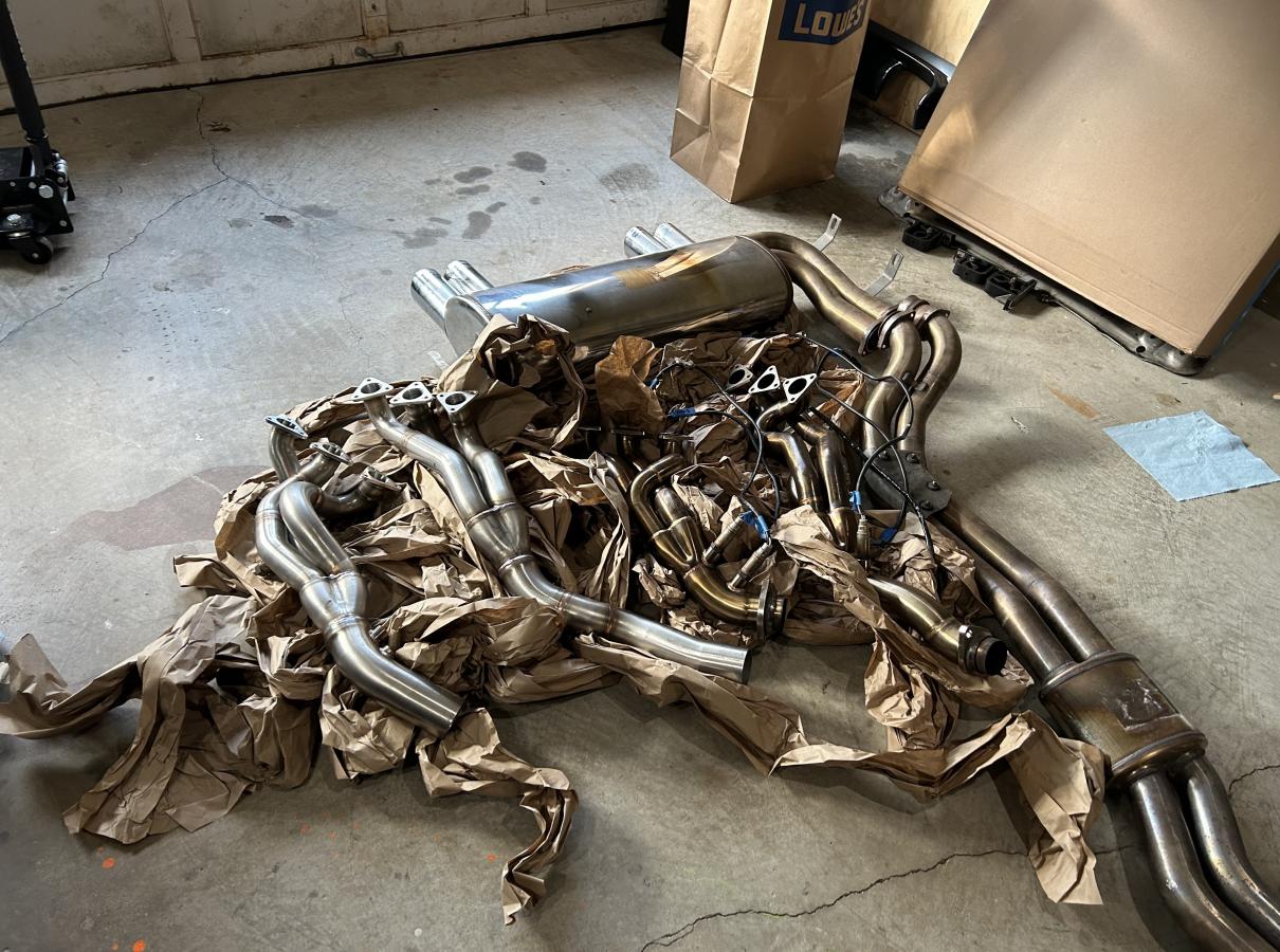

                Below are some pictures of the CPI headers side-by-side with the SS V1's. To be honest, I feel quite dumb for even starting this endeavor. Mainly because the car sounded pretty good already and i was happy with the headers. But I was able to snag sections 1-3 for a great deal so I said screw it, let's go slip-on!

                  Car's been apart for over a month now which sucks but I don't imagine it will be like this in the future. There were many missing components that I found my constantly jumping on FCP euro to order parts. Or even something simple as the camshaft position sensor leaking on the exhaust side, tools to do CPV, or finding the bushings for the headlight level sensor completely gone.
                  Section 1's were clamped down a bit tight making it really difficult to slip them on to the headers so I am just waiting on a 1/2" drive 1-1/8" impact socket to use a pipe expander to make my life easier. I didn't want to be that guy driving with open headers to an exhaust shop...
                    Ambers on SG all day
                      Got the inspiration from you bro!
