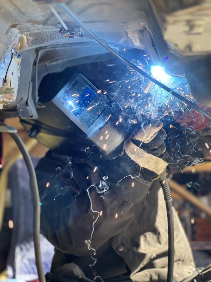

                Update: WELL... As we all know, life can throw curveballs sometimes. Turns out, we are moving into a new house, which is great! But the timing is shit. Now I basically have to haul ass and get the car back together, I do not have any spare time to do any "optional" cosmetic cleanup or restoration type of things. This is good overall but not what I was originally planning. Welder is coming Saturday. I will post some updates after the plates are on there.
                '01 M3, Imola/black
ID:	252624 Midway through the plate installation…
