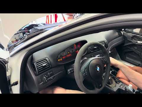

      Hello everyone! You may know me from the ‘Gram as @bmwwagonguy, and/or from my previous builds such as the M5T that sold on BaT for a record price, or the Ferrari Red M3T that is currently getting a stroked S54 installed, but this thread is about a car I began building for my lovely spouse last year and am still working on.
      In late 2022, I was searching for a natural brown E46 interior for my daughter’s Orient Blue wagon. I found one, but it was unfortunately nearly across the country in Utah. We made a deal on the interior bits, but shipping was the problem. The owner then told me he was willing to sell the whole project, unfinished, because he needed to move on to something else. The owner before him started a ZHP swap with a minty low-mileage donor only to get frustrated and quit. He sent me some photos:
      Now here’s the interesting part. He fully intended to complete the project, and had just recently spent over $12k on brand new parts to do so, but I guess just got frustrated and wanted out. The car came with all of these parts, many of which were already installed on the 115k mile M54B30/ZHP engine, and the rest were jammed inside the chassis when it arrived. Besides a complete (and I mean *complete*) engine refresh, these parts also included a brand new Ground Control coilover suspension with camber plates, brand new genuine BMW Mtech2 bumpers and side skirts (complete with all genuine trims, grilles, clips, fog lamps, etc) and various other bits. Goldmine, especially for the price I paid.
      We made a deal for the whole car instead of just the interior, and he got it loaded on to a trailer and sent my way:
      And a few days later, it was here:
      Time to unpack the fully-loaded interior and see just what was included in my amazing deal:
      That’s a LOT of stuff. All genuine parts. First things first, let’s explore and see what’s what. First thing I noticed was that the first guy who started the project cut the muffler off and put some awful (and awfully long) straight pipes on it. Sounded and looked awful. Luckily I had a donor and was able to swap in a proper stock exhaust.
      Afger getting a quote for paint from my favorite local high-end shop, and having it be lower than expected, I decided to go for the bumper and side skirt paint right away, so I dropped those parts off for them to get started.
      Meanwhile, it was time to get started on finishing what he started. Headliner goes over to upholstery shop for conversion to M-sport, and chassis breakdown and inspection.
      Luckily the subframe was in excellent shape, but we’ll reinforce it anyway. More on this later. Next, let’s inspect the RTAB pockets for any issues:
      All good! Ditch the exhaust, put on a nice stock system with brand new tips from BMW, and she’s already looking better:
      My buddy Paul Martin from Fixels (find him on FB) does amazing DME and cluster work so he sorted out the mileage discrepancy on the cluster and fixed the mileage:

      Now back to the story….
      In January I had my good bud Evan from Dynamic Details NC come and do a paint correction and we used AMMO NYC’s Reflex Pro 2 to ceramic coat the body, in anticipation of the painted parts later.
      In February, we replaced the subframe bushings with Powerflex Poly (for street use), new OE diff bushings, replaced the rear lower control arms with Powerflex adjustable units, new Bimmerworld stainless brake lines, flushed the brake and clutch systems, ditched the DEPO side signals for OE units I found on another car (they are NLA from BMW), and installed the repaired cluster from Fixels.
      In February, I also tossed in new center stack components including cupholder, console, sunglass tray, and surround. Decided I didn’t like the ***** head unit included with the car so I put in a Dynavin N8-Pro, backup camera, and microphone, tossed in a subwoofer and installed the freshly reupholstered black headliner with all the pillars and trim bits that came with the car. A new battery, fresh alignment, AC recharge, two brand new BMW keys, new BMW floor mats, and a freshly welded shifter bracket also went in (PO had screwed the bracket to the chassis – bad!)
      Finally by April, the body parts were ready and I got them installed along with freshly refinished upper window trim (from chrome to matte black) and brand new BMW lower window trims in matte black.
      In May, I installed brand new rear wheel bearings and hubs, swapped out the UUC shifter for a Rogue shifter (much better), new factory selector rod instead of UUC, and a few other misc things.
      Airbag recall was done in September and I also opted to upgrade the headlights with much higher output projectors, white halos for DRLs, and installed Morimoto projector fog lamps as well.
      In October, I fixed some PDC errors so that it was fully functional.
      Here is where it gets interesting. My wife loves how the car drives (we both do) but she loves how my M3 wagon feels and smells (new leather) when she gets in, so she requests a fresh interior. My original plan was to get some M3 seats and reupholster them in new natural brown leather but I ended up finding a source for nappa cinnamon leather instead, so I bought some used M3 front seats, my friend Stephen helped retrofit brand new foam, lumbar support, and heaters from another set of donor seats, and I sent the entire interior to the upholstery shop for the new leather. The seats are now fully functional M3 seats, but in a wagon, and without the side handles that we deleted during upholstery. They feel and smell amazing.
      Comparison of cinnamon (top) vs natural brown (bottom):
      Rear seats installed, front still original:
      Fronts installed:
      Door panel comparison (Note: I’m not happy with how the door panels turned out so I’m having them redone soon):
      Now that the interior is done, and my old S54 will soon be available, I had a thought. What if I just M3 convert the wagon so she’ll have some more power and fun and as a bonus, this would allow keeping the S54 “in the family” since I’ve owned it and maintained it since 2016 and know it well. I contacted my friend Jorge at MPartsWorldwide and we put together a huge crate of parts in order to start the conversion process.
      The parts arrived and I began planning the next phase. But first, since I’ll be pulling the rear end anyway, it’s time to do rear subframe reinforcments and a nice bonus – the V-brace from the M3 can be retrofit using some cool brackets from Attilla Csontos at M3Projekts in Hungary. My friend Jon from Speed House in Durham brought his welder over and got started. He’s done this multiple times and I wanted someone experienced to do the work. He's not cheap but quality rarely is:
      Next, I spent a few days disassembling the M3 parts, refurbishing and repainting as I went along. New upper and lower bearings, new wheel bearings, new hubs, new diff bushings, transfer the poly subframe bushings from the 330 subframe over, new diff cover, a freshly rebuilt diff from RacingDiffs.com (it’s so smooth and quiet), and a host of other things. I’m a bit particular so I also clean all the hardware as I go along. Since the S54 isn’t ready to go in yet, I decided to install all of the M3 rear end parts now while we wait. Here’s how that turned out:
      Now, in preparation for the F80 M3 brake upgrade, I realized that the ZHP Style 135 wheels do not fit over them, so I upgraded to Bimmerworld TA5R wheels in 18x9 square:
      And in the mean time, I sent the four calipers to a local powdercoat shop, had new seals and bleeders installed, ordered some ///M decals online, installed the decals, gave them each 4 coats of 2k clear, and now we wait 30 days so I can ceramic coat them before they go on the car:
      This is where the car stands now. Waiting on S54…will get back to this project soon.​

                          Sport button wired up and cluster installed:
