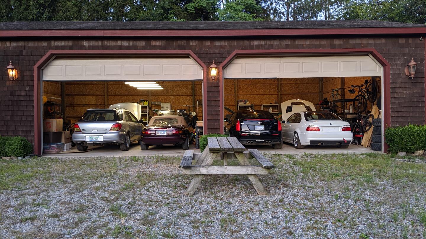

    That is one sweet stable you have there! I'm in Toronto and I'd count myself lucky to have even a 2 car garage.
      Thank you! Downside is I have to deal with a mile of dirt road to get home
      Love Toronto, looking forward to visiting again once the borders open.

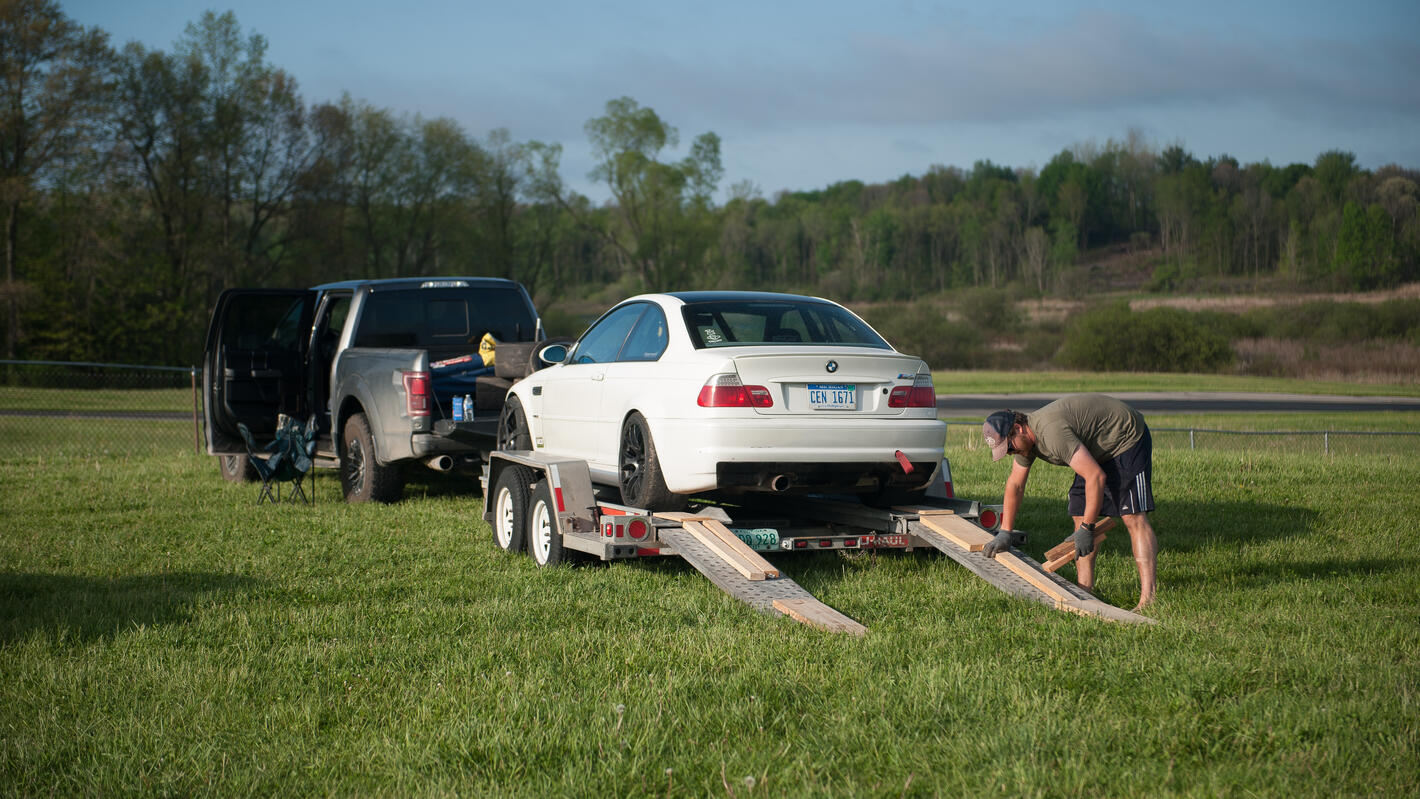

            that a nice trailer! where did you purchase it? I am in the market for one as well. I am getting tired of driving the car after a hot track day with those track tires.
              That's actually a rented U-Haul trailer, which i wouldn't suggest if your car is lowered - the "trays" for the tires have a lip that is high enough to interfere with parts underneath and rip bumpers off...
              Facebook marketplace and RacingJunk.com are good sources for trailer sales

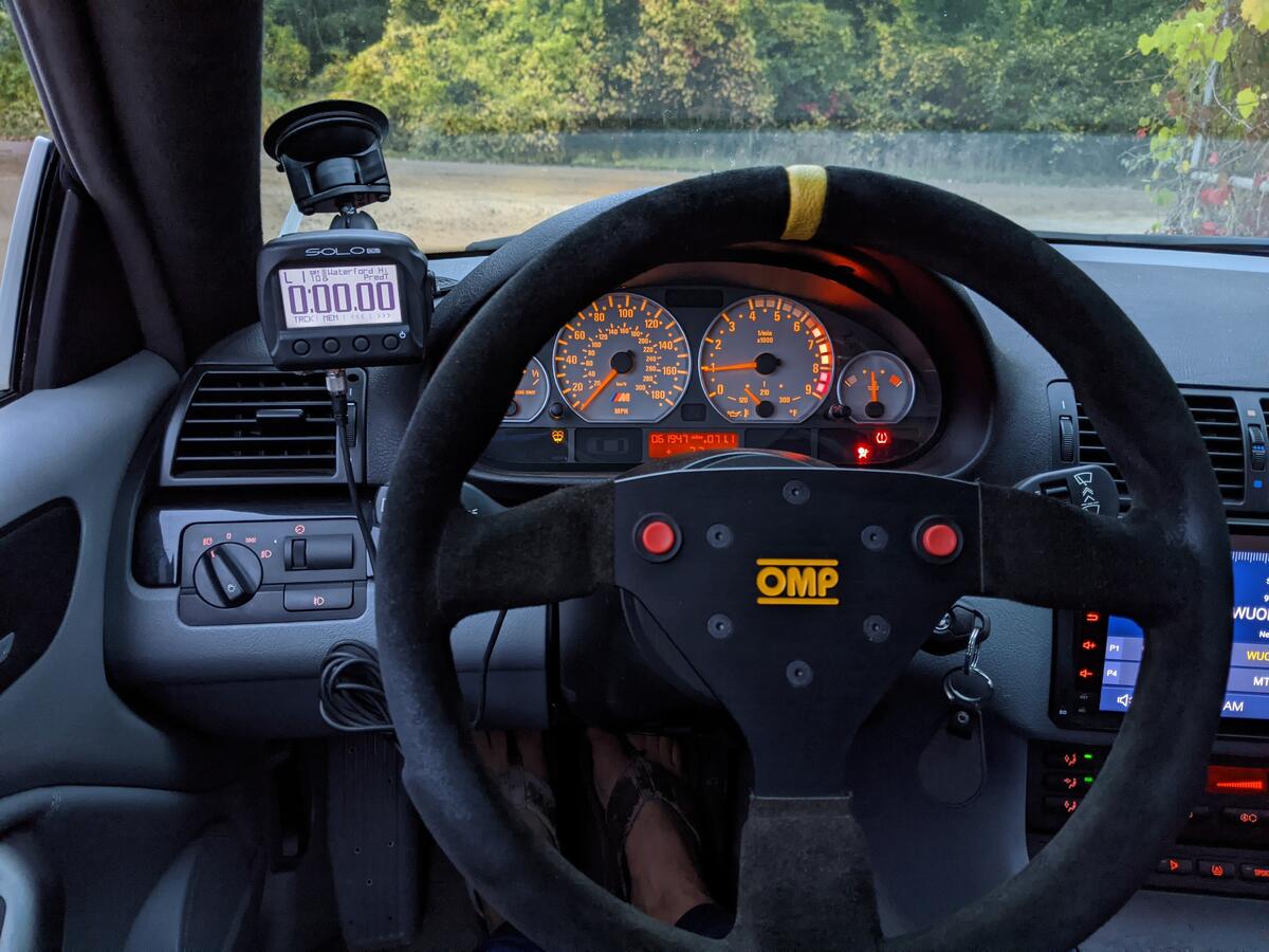

                Nice build Ross! I too have a Magnetic Gen 2 Raptor towing an Alpine White M3 haha. Would you happen to have a pic of where/how you mount your AIM SOLO 2 DL? Mine is on the way and I want a good idea of where to mount it.

                  Woo - sorry for the super long delay - I use a suction cup mount and place it just to the left of the gauge cluster. My steering wheel is smaller than stock so visibility is a bit better. It's a great spot to keep your eyes up, but still see splits and predicted times
