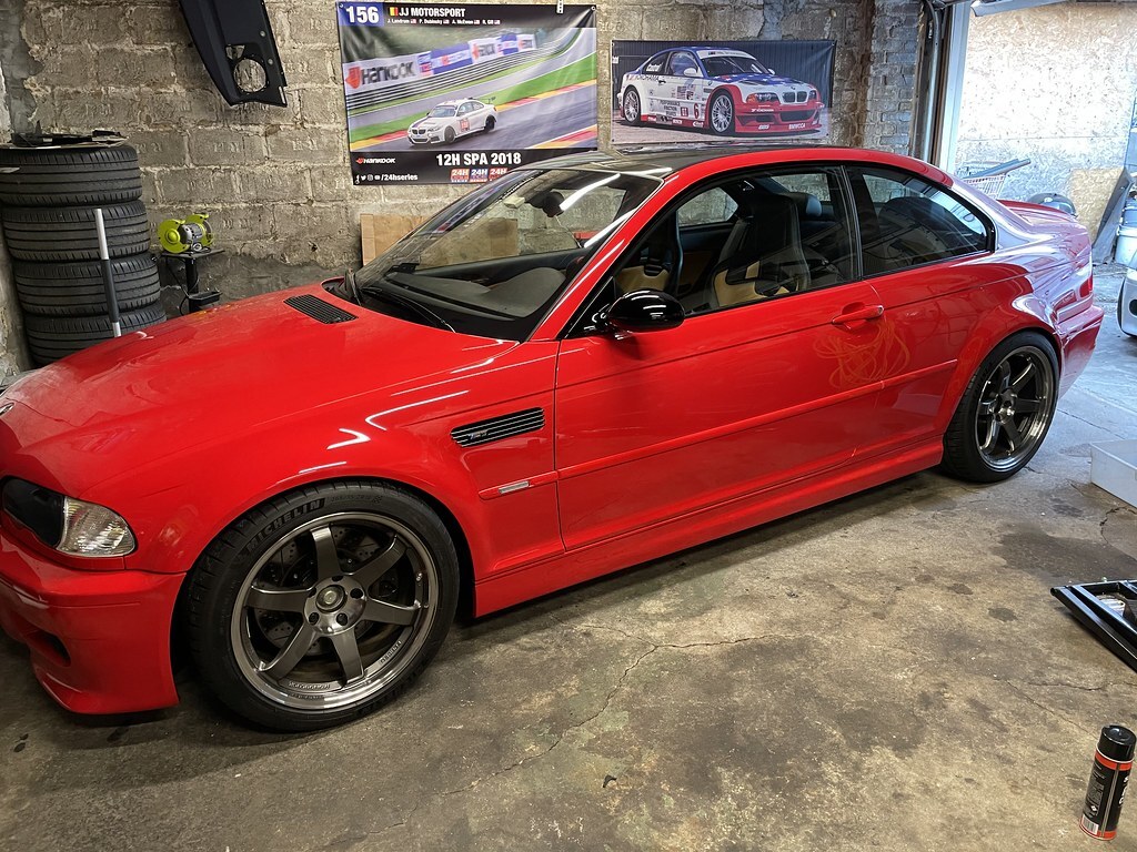

    I attempted to clear bra the front bumper and that was a complete fail... Just couldn't get it to cleanly stretch and stick and eventually gave up and just coated everything. Calling the exterior done for now!
    Click image for larger version  Name:	50780476191_e53625b326_b.jpg Views:	0 Size:	216.0 KB ID:	76429
    Click image for larger version  Name:	50779709238_4fb16f1107_b.jpg Views:	0 Size:	261.9 KB ID:	76430

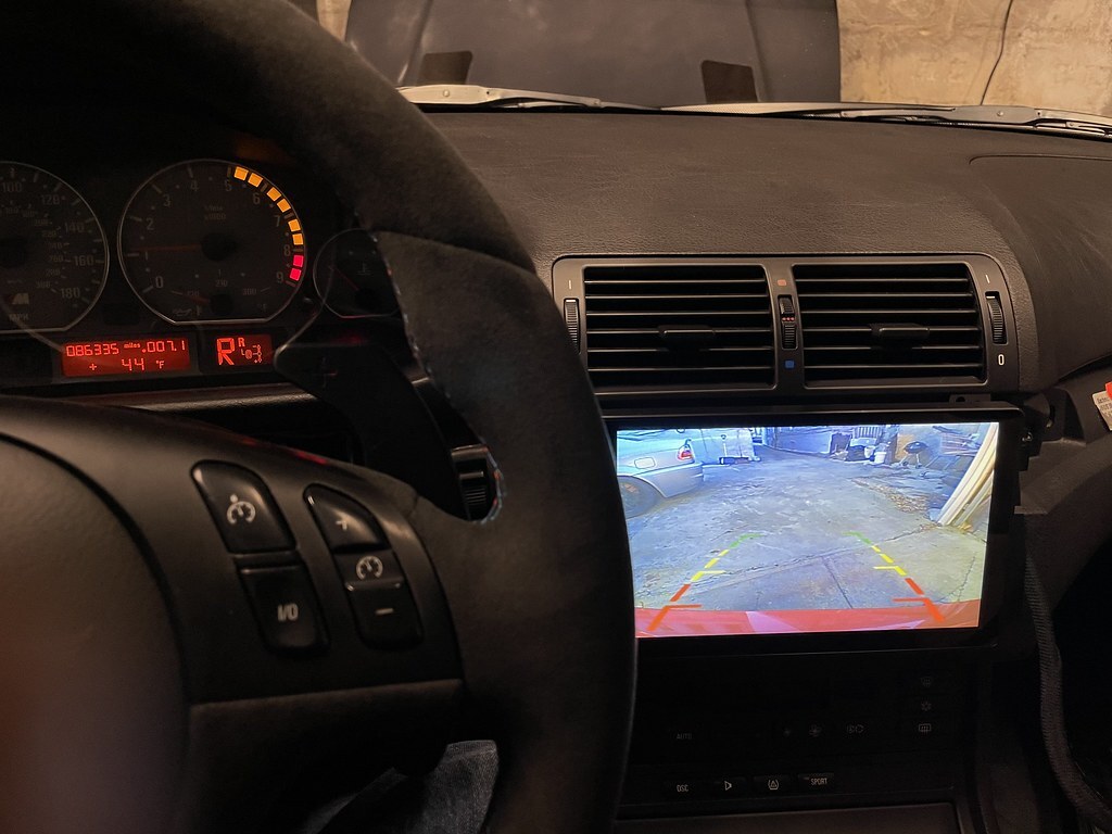

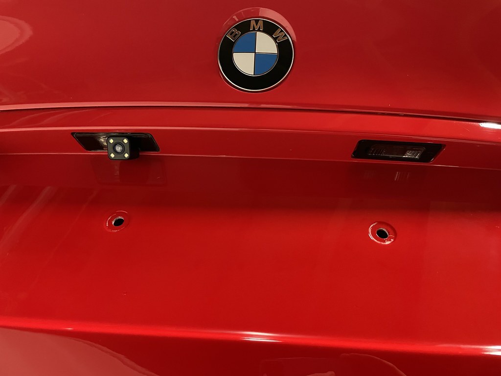

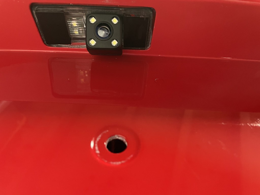

      Then I moved on to the trunk to get the backup camera installed as well as the remaining trim. I had previously run all of the wiring so now just had to hook it all up. Took a lot of trial and error to get this to work properly. There is no instructions and Avin just references a bunch of DIY threads that aren't very clear. Ultimately this is the wiring that worked for me:
      1. License plate light wiring:
        1. Connect Blue/Yellow and Ground to black LED license plate light ground
        2. Connect Blue/Brown to red LED back up to wire
      2. Camera Wiring:
        1. Connect both the red positive from camera power, and the red wire from the RCA (camera activation trigger) to the positive backup light.
        2. Connect the black ground from the camera power line to the brown wire of the backup light.
        3. At the head unit, connect the red RCA activation wire to the green harness bundle wire marked backup.
      All installed! I added some strips of black vinyl to cover up some openings in the camera housing:

      Head unit view in reverse:

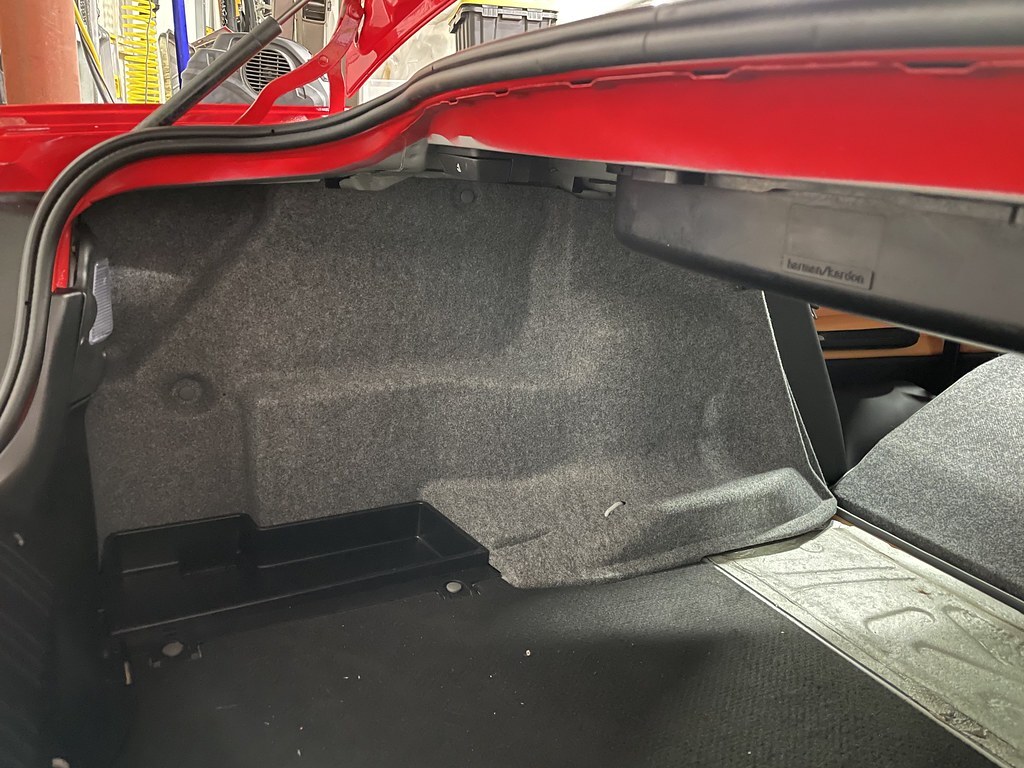

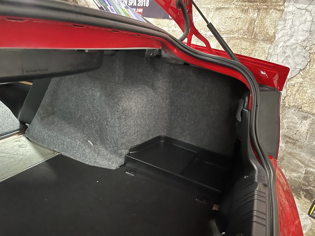

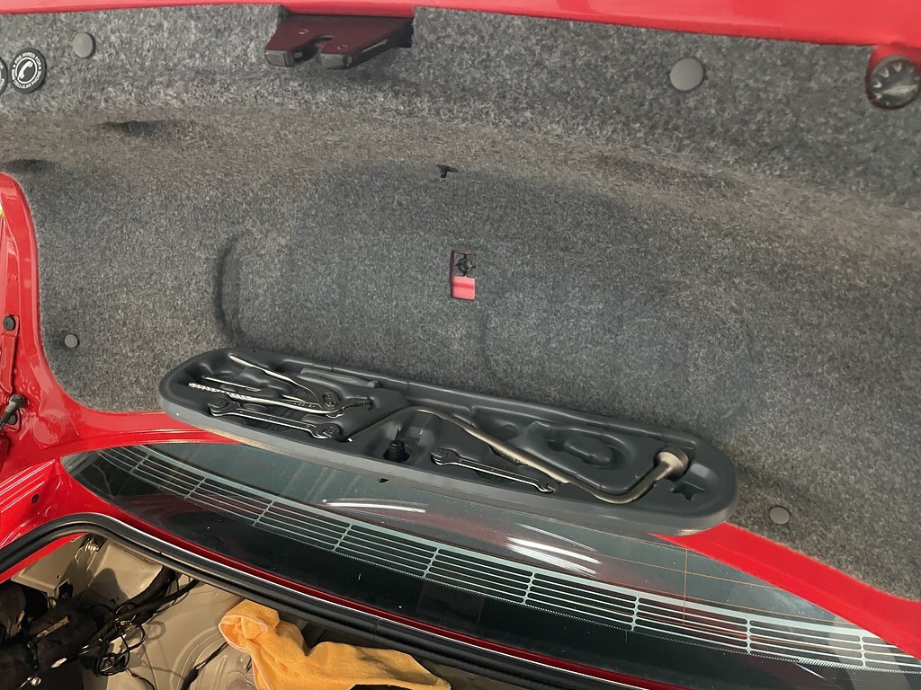

      With the camera installed all new trim installed in the trunk including tool set. Found a couple places I need to touch up red paint to wrap around the visible edge.

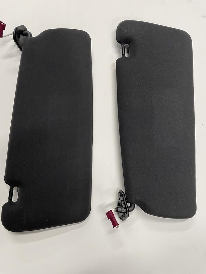

      Also cleaned up the visors and removed the airbag labels:

        That looks great! How did you remove/clean where the stickers were?
        Instagram: @_Frank_Stone_
          It was surprisingly easy. I sprayed it with some griots interior cleaner and then rubbed it with a microfiber towel and it came right off.

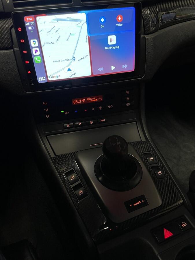

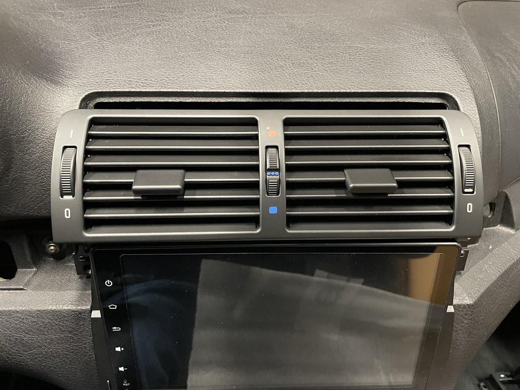

                      Was waiting for a couple parts to finish up the dash and center console. First I replaced the center vents, old one was cracked and had clearly been taken in/out a few too many times:
                      Click image for larger version  Name:	50815460757_971f3de172_b.jpg Views:	0 Size:	187.6 KB ID:	78045

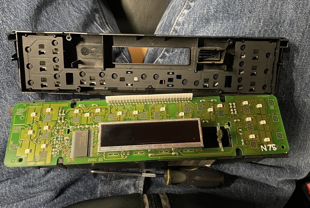

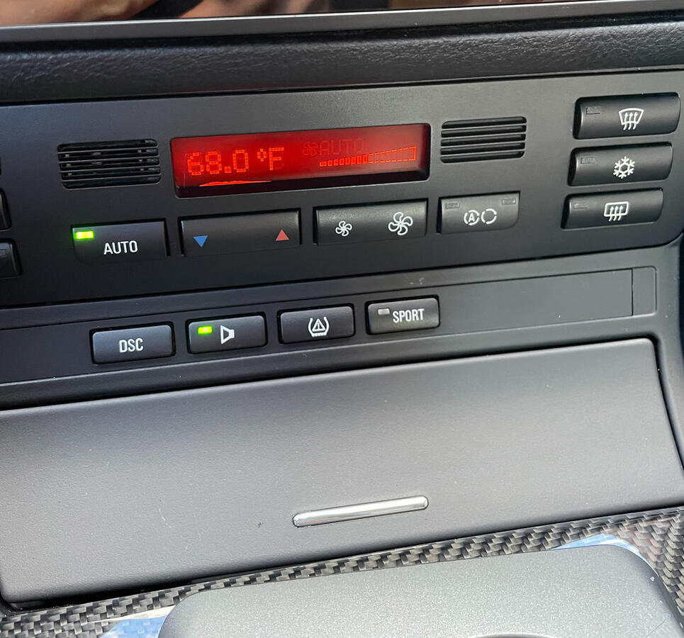

                      Next I decided to replace the HVAC controls as the LED had some bleed at the bottom:
                      Click image for larger version  Name:	50814610528_0fb8962de7_b.jpg Views:	0 Size:	117.8 KB ID:	78046
                      I picked up a cheap replacement on eBay but the finish was worse than whats in the car. So I pulled the LED panel out of the eBay unit and used the existing face plate. Worked great and now the center dash is complete!
                      Click image for larger version  Name:	50815355481_462df13011_b.jpg Views:	0 Size:	266.6 KB ID:	78047
                      Click image for larger version  Name:	50815355471_69eb9a6da2_b.jpg Views:	0 Size:	53.4 KB ID:	78048

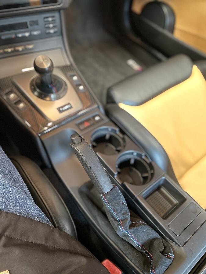

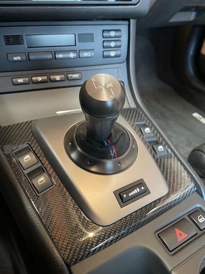

                      Next was getting the Colby Wheel shift and ebrake boots installed. Replaced the entire ebrake so I had a new leather handle. Also used the custom gaiter ring that i got from Billy Bogdziewicz on the old M3Forum and love them!! Not sure if he is still around:
                      Click image for larger version  Name:	50815460832_70ab1184a5_b.jpg Views:	0 Size:	70.6 KB ID:	78049
                      Click image for larger version  Name:	50815460752_904603cb55_b.jpg Views:	0 Size:	80.3 KB ID:	78050

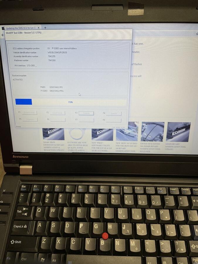

                      One more SMG improvement, I flashed in the CSL SMG "255" settings using the instructions from ECUWorx (thx @Martyn).
                      Click image for larger version  Name:	50815355476_9666a4ed1c_b.jpg Views:	0 Size:	81.1 KB ID:	78051

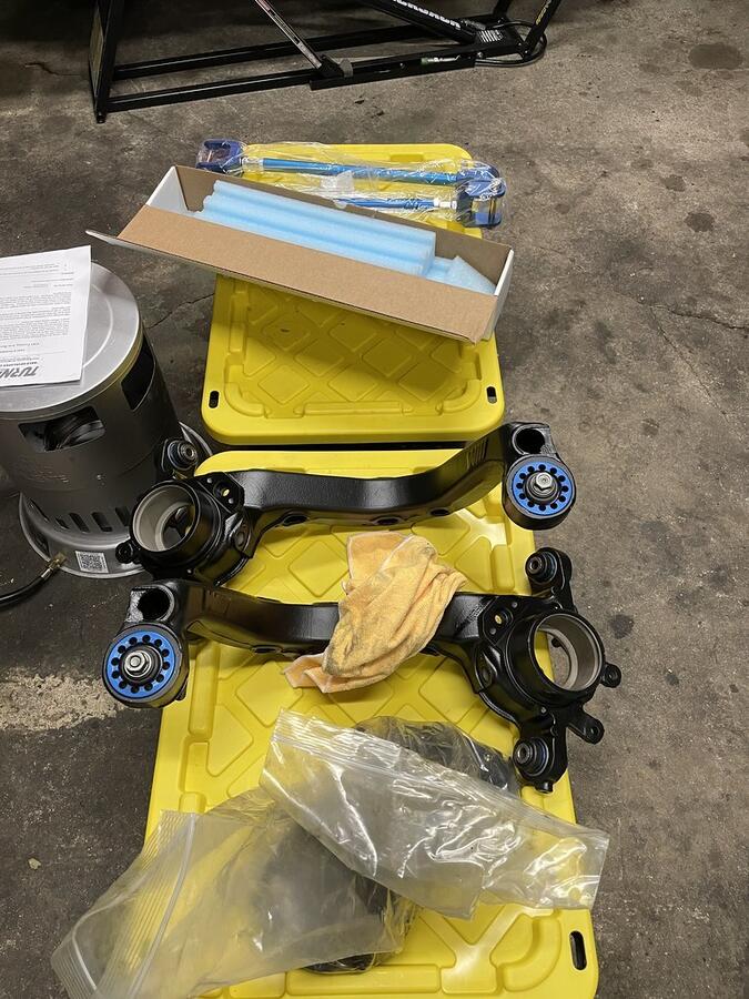

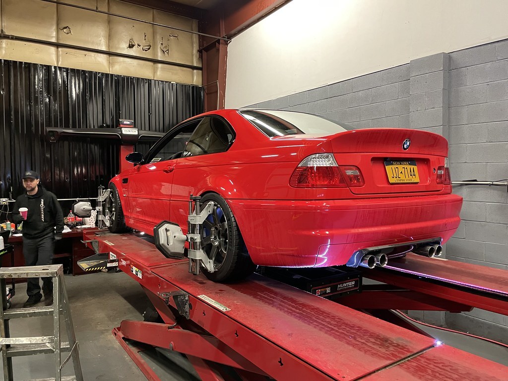

                            One thing that has been bugging me is that the alignment is clearly off. The wheel is not centered and it was a little squirmy under acceleration. I headed over to Ivans Alignments in Jersey to get it sorted out. I went with pretty standard street specs with 2.5 camber up front and 2 in the back along with pretty neutral toe. Took it for a test drive and immediately the wheel was off again... On closer inspection we determined the RTABs were shot and not holding the alignment. The original plan was always to do a full rear subframe rebuild but I was hoping to push that off for a couple of years. The subframe had been reinforced by previous owner so I assumed bushings had also been replace. Clearly not . So... back to the garage to replace the RTABs and install new adjustable lower camber arms. I'll save full rebuild for a later date. RTABs coming out pretty easy:
                            Click image for larger version  Name:	50853041618_7a5ba53fbb_b.jpg Views:	0 Size:	197.1 KB ID:	81372

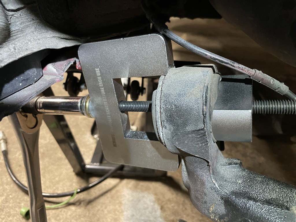

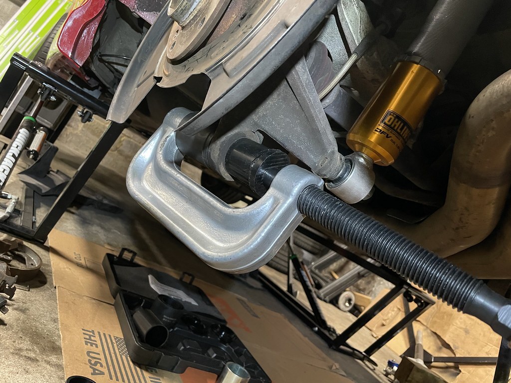

                            Camber arms not so much... What a nightmare. The outer bolts were completely seized in the ball joints and no amount of penetrating fluid, heat and BFH would budge them. So had to cut off the old camber arms and bolt heads. Then make a run to Harbor Freight to pickup a clamp style ball joint pusher. Of course the this tool interfered with the brake rotors and shields , so had to take those off and finally was able to get ball joints out:
                            Click image for larger version  Name:	50853856087_c4fccbef8d_b.jpg Views:	0 Size:	207.9 KB ID:	81373โ€‹
                            Next I had to pull the new Turner RTABs and OE ball joins out of the trailing arms I previously built and get them installed on the car. All of that went pretty smooth.
                            Click image for larger version  Name:	50853856137_26d858ae66_b.jpg Views:	0 Size:	123.4 KB ID:	81374
                            Back to Ivans and now the alignment is perfect!!
                            Click image for larger version  Name:	50853856057_09aa2cd720_b.jpg Views:	0 Size:	196.7 KB ID:	81375
