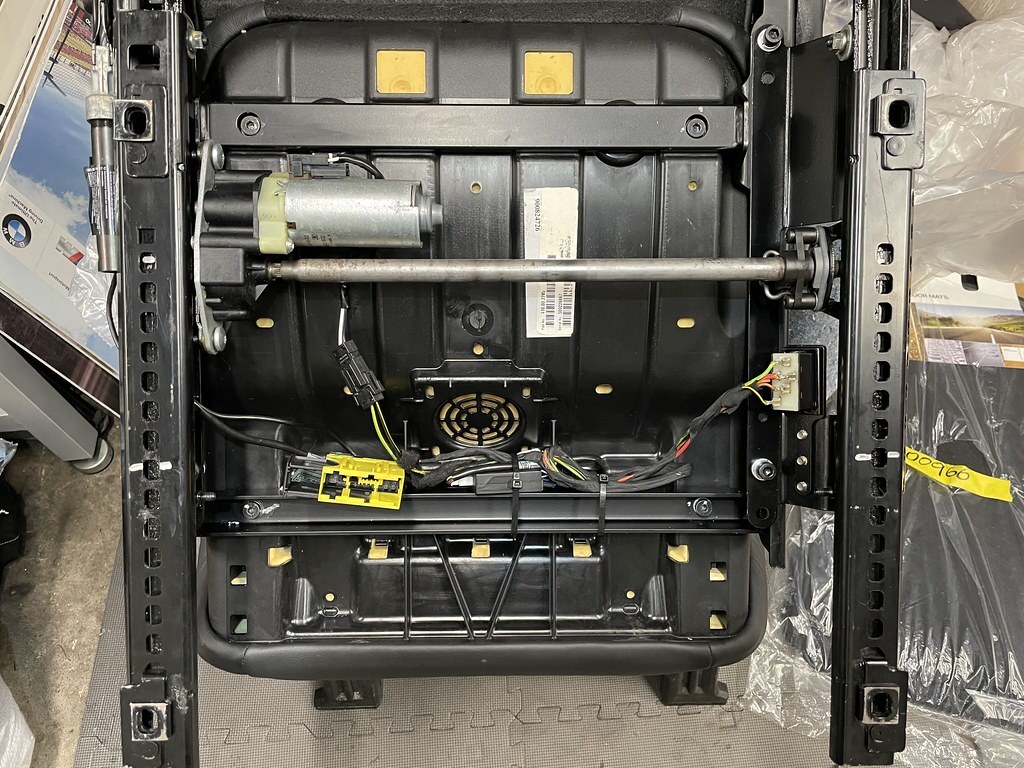

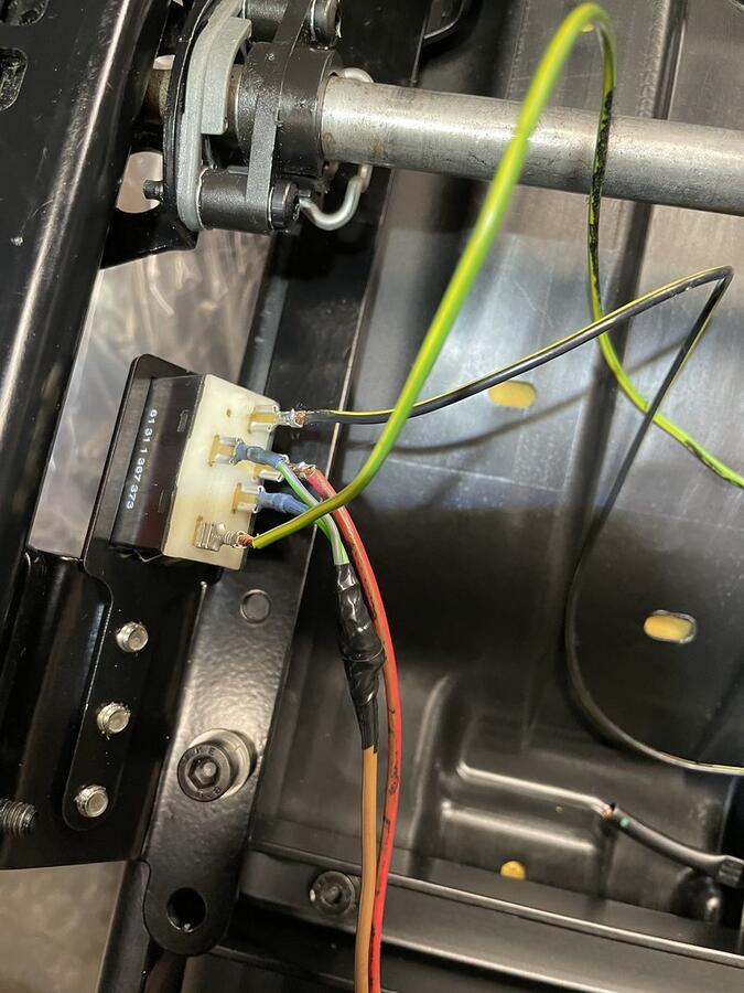

              Back to the front seats. I had previously installed the mounts and wired sliders on the passenger seat, so the drivers seat went much faster. Unfortunately while I was test fitting the seats I scratched the new carbon fiber door handle trim on the passenger side 😒. Going to have to go back on sand/polish that out. I stripped out all off the unused wiring and got it down to the four wires needed for the forward/back button:

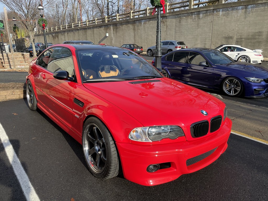

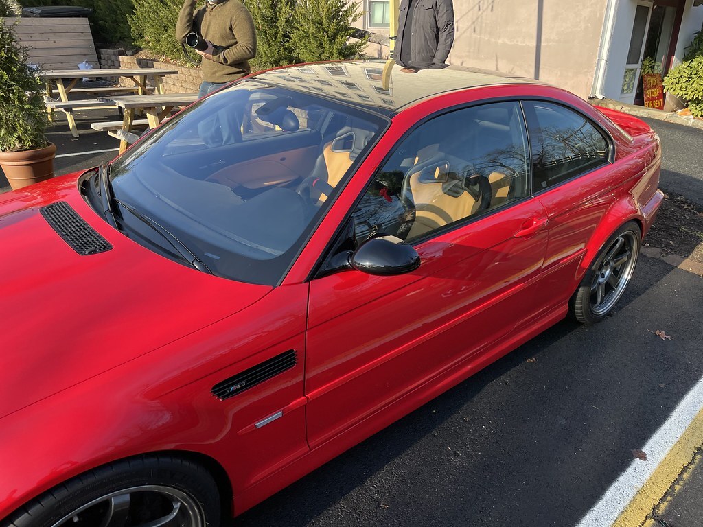

                Big debut!! Got up super early on Sunday to take care of a couple exterior items. Popped the new gloss black grills/gills and badges on and give the car a quick detail. Paint is still basically bare but the plan is to give it a final polish and ceramic coat in the next week. Plus some clear bra on the bumper and headlights. Then drove over to NJ! Some pics from the C&C:

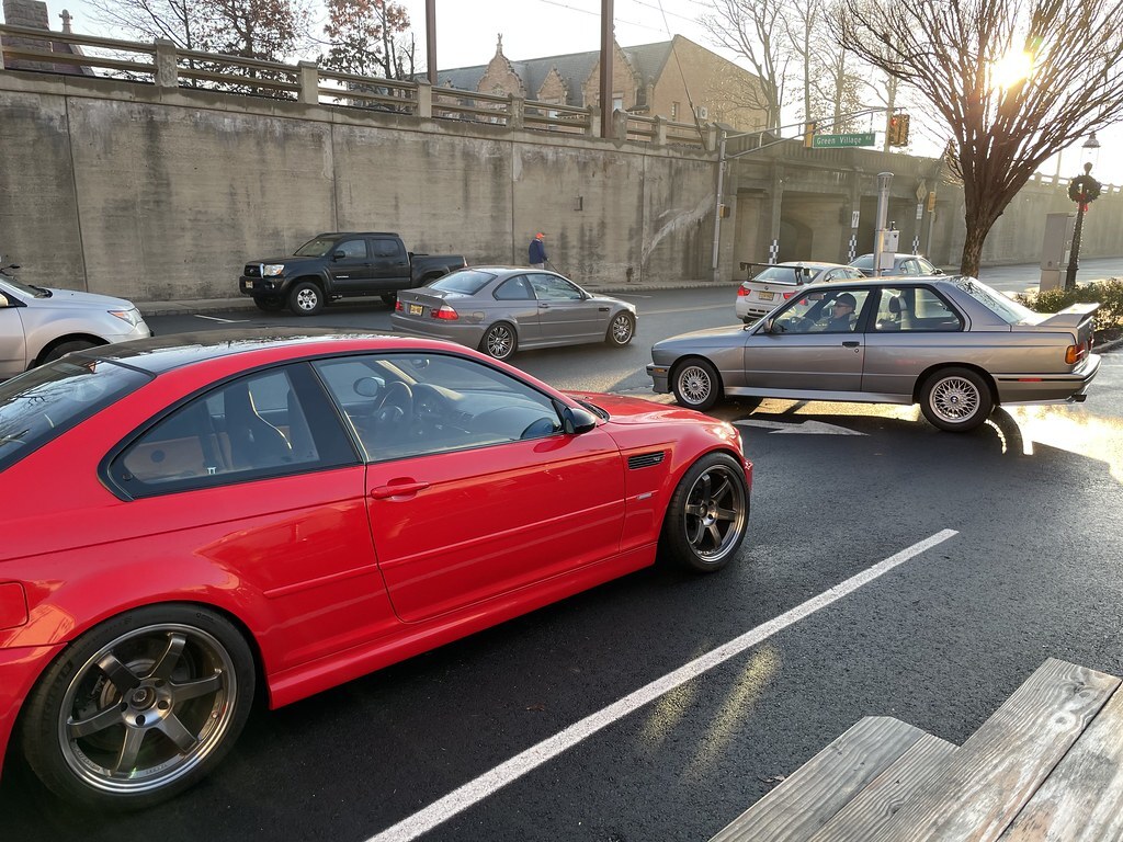

                3 Gens 1 Pic! Also super nice Nardo Grey E46M.

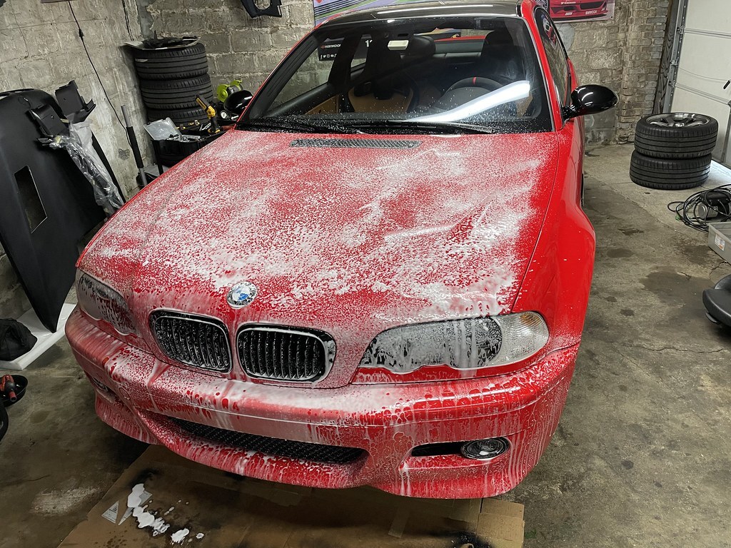

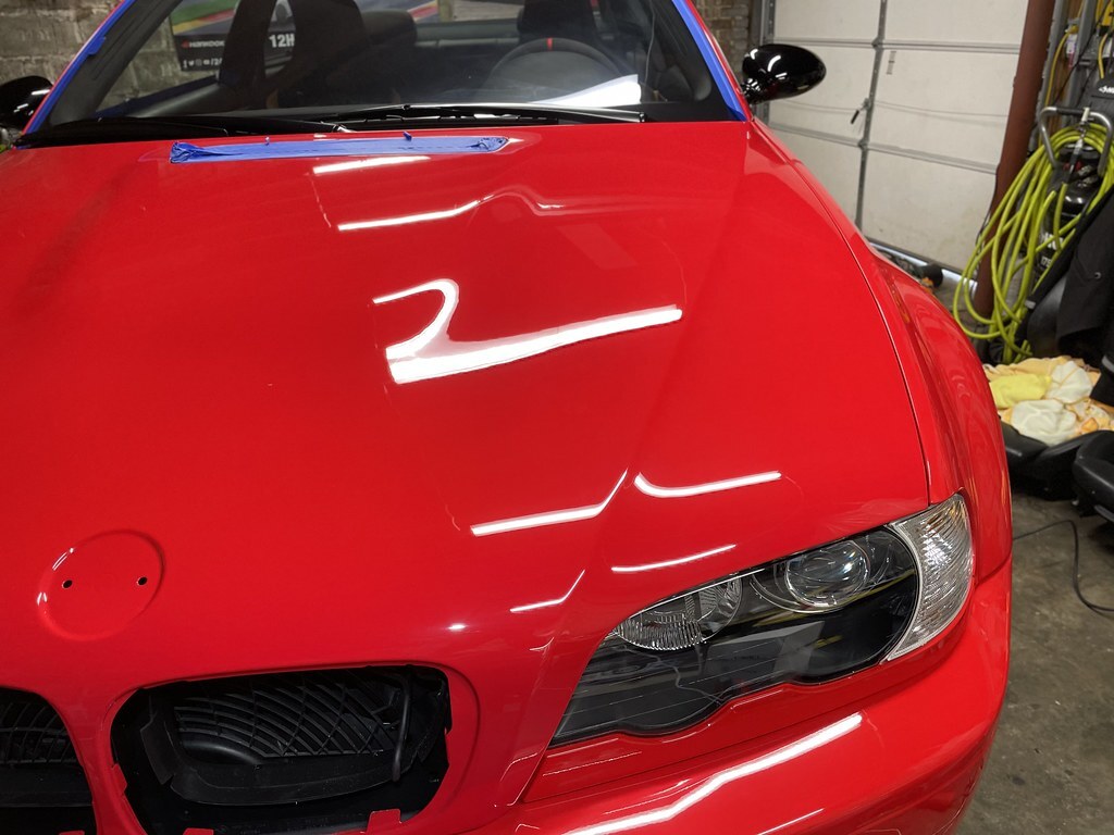

                            With the car back in the garage after its first big outing my top priority is paint protection. Its had plenty of time to gas out and I really don't want to drive again until its protected. I've decided to clear bra the front bumper and headlights with Xpel and then coat it with AMMO Reflex Pro Enamel Coat. First I gave the car a wash with the AMMO Lift Hoesless wash. This stuff is great for a quick clean in the garage. Then took the grills/gills/badges back off and masked some of the rubber trim.
                            Click image for larger version  Name:	50763612488_2c25534697_b.jpg Views:	0 Size:	309.4 KB ID:	75513
                            Then I wiped down all of the paint with diluted isopropyl alcohol to get it completely clean. The paint is just about perfect from the body shop but there are some swirls and sanding marks I want to tackle. So I gave it a full compound and polish. That took way longer than I expected but worth it. Paint lookin awesome!
                            Click image for larger version  Name:	50764459562_b4714e77b1_b.jpg Views:	0 Size:	128.4 KB ID:	75514
                            I've got the week off next so I'm planning on getting the bra and coating done as well as some finishing touches to the interior. If the weather improves and schedules line up I'm also hoping to get it over to RK Tunes for a final dyno tune.
