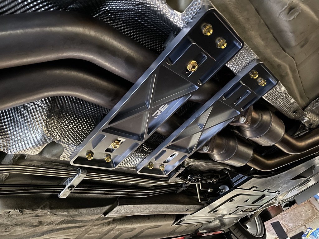

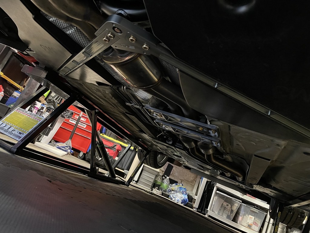

      Not much driving now that its winter and NYS is dumping salt all over the roads. No big projects planned this winter just a bunch of small ones. Checked off a couple today:
      • Check Cam wear and valve tolerances. Everything looking good!
      • Install new RE braces. Its too bad these are under the car where no one can see them:

        Very nice, sir. Is there a benefit to the RE pieces other than sex appeal?
        D-O
        Old, not obsolete.
          I'll be following the auto dim mirror mod. I might have a lead on a used set and might be trying it out on mine as well. It's a nice modern feature with all these super bright lights that seem to be the norm these day. Found myself having to lean to one side sometimes just so I'm not being blinded at night. Even in my old pickup (which also does not have it).
          Seems like simple wiring which I'm comfortable with. Im in the understanding you tap into the wireing for the rear view mirror? I would also imagine you would have to splice a E90 connector in place of the original one for the mirrors?
            Very nice, sir. Is there a benefit to the RE pieces other than sex appeal?D-O
            Yeah mostly undercarriage sex ap​peal 🤣. Also hopefully more corrosion resitance and it is nice to just undue one side of the Y brace when you need to drop the exhaust.
