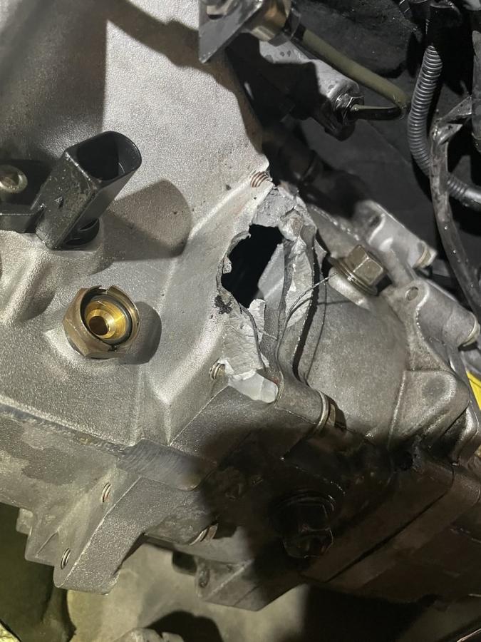

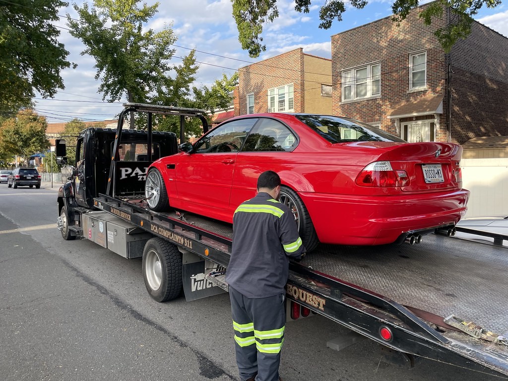

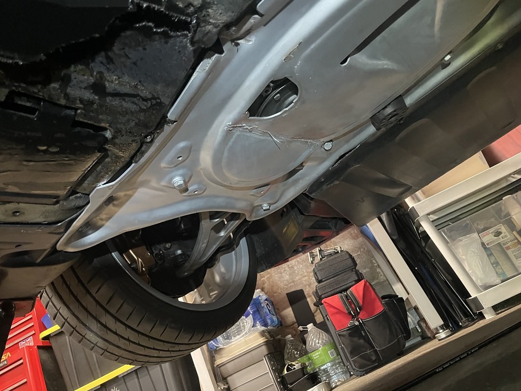

                Bad news... Got up the next morning and was taking the car back to the garage. On the Cross Bronx the car in front of me swerved to miss something in the road and I had no time to miss it. Trailer ball hitch lying on its side in the middle of the lane. Just tried to center it and hope it would clear. NOPE! Hit it hard and sounded like a freakin bomb going off under the car. Fortunately it was right before my exit and was able to get it off the highway and to my garage. I could smell trans fluid so knew it wasn't going to be pretty:

                I just fucking installed this transmission 😩!!!
                Good news! Insurance has worked out really well and they covered a tow over to Rogue Engineering in New Jersey.

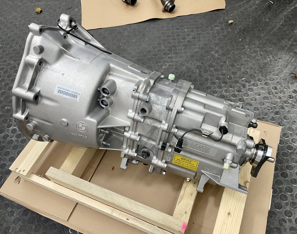

                Ben has been awesome and ultimately insurance is covering the full repair with the highlight being a shiny new 6 speed straight from BMW. 1 of 2 left in North America. Sooooooo fresh!!!! Would have been nice for this to happen BEFORE I did all the SMG conversion work but hey, at least its now a true (new!!) 6 speed.

                Stopped by the shop yesterday and they have already started work. Front subframe is being replaced with one of REs reinforced ones and the trans should go in early next week. Also going with an aluminum belly pan from Turner plus all new underside trim panels. Fingers crossed it will be ready for E46M.East next weekend.

                        Curious if the second gear is still crunchy on your new unit. Was talking to someone recently who once swapped in a brand new manual transmission into their 8 series (same internals as 420G from what I understood) and it still had that crunchy second gear.

                              Yeah I do notice second gear is "tight". I notice it most in low speed/rpm shifts from first to second. I assume it will break in over time.
