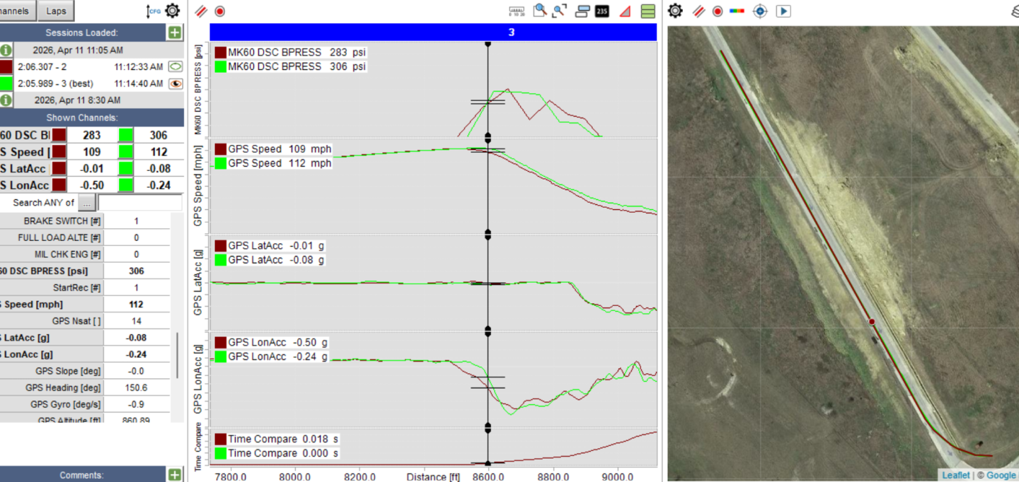

    Finally getting into some deeper data analysis now that I can get brake pressure data. Throttle and steering are easier to analyze and improve without a ton of data.
    This is a very helpful video to setup Race Studio for AIM users... https://youtu.be/8bcPAwmzkM4?si=nY_IB_Q-KIK5lxmV
    This is from my last event at ECR. I had two big time deltas. One was just a matter of rolling more speed into the corner. This one was more interesting. The delta just started climbing from this point. It was not obvious looking at speed and long/lat acceleration. This is where the MK60 brake pressure data is critical The brake trace on top was very different. The green line (fast lap) was a relatively smooth ramp up and then release with less trail braking than the red line.
    The red line is I ramped up the brakes slower, perceived to not slow the car enough and then got on the brakes again. That should unbalance the car more than the green trace. Lesson learned is I really need to be more precise in my braking and that is where the time is. That was my theory but it helps knowing it.

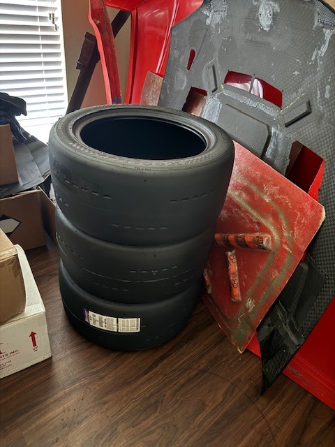

      My tire bounty from NASA. Almost a set of 4!

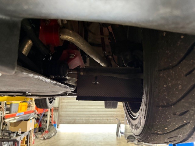

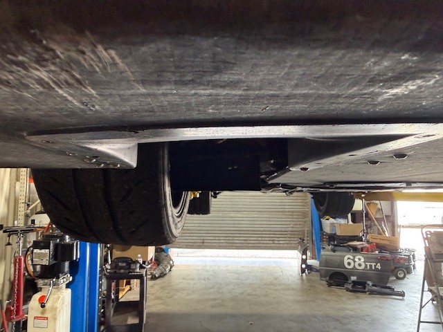

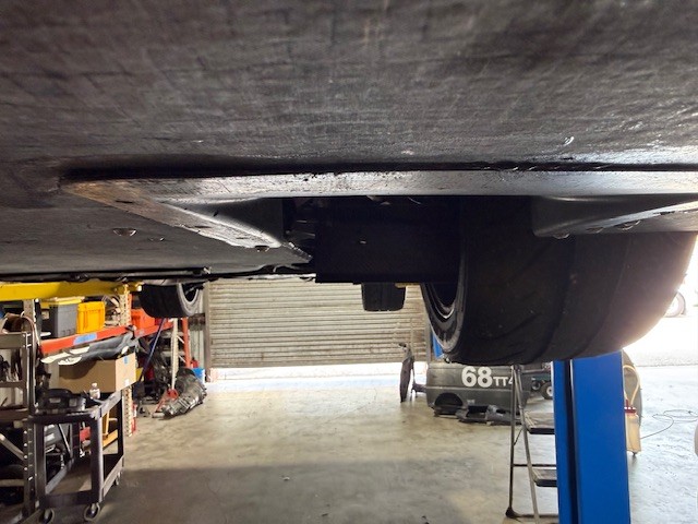

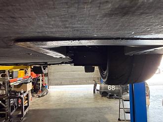

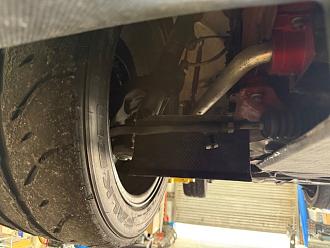

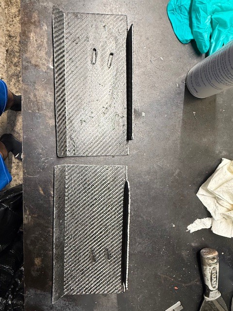

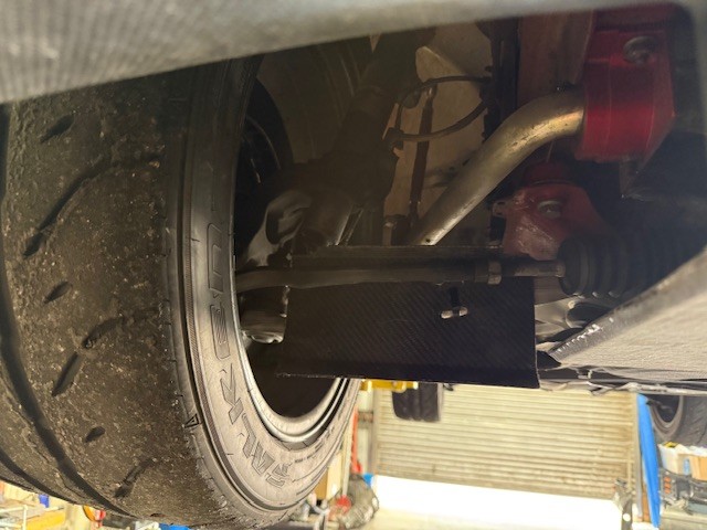

      Carbon fiber brake deflectors finally done! Geez...I'm so behind! Here is info from my initial test with an aluminum deflector -
      I did some testing this past weekend with some send cut send made brake deflectors. Pretty simple, just need to notch the upper corners for clearance. Mounted to the control arm with a heavy duty zip tie. I've seen some deflectors available but never seen any actual results. Love that when tuners sell stuff that they don't know
      Click image for larger version  Name:	IMG_5948.jpg Views:	5 Size:	128.8 KB ID:	353634
      Simple install with a zip tie. I had a 65-70 improvement with the deflectors with a flat splitter. This time, I am using a splitter with tunnels. Honestly, got a lot lucky that the deflectors line up perfectly with the tunnels. Hopefully the deflectors don't interfere with low pressure zone at the leading edge of the tunnels.

      More testing this weekend to see if the tunnels increase brake cooling.

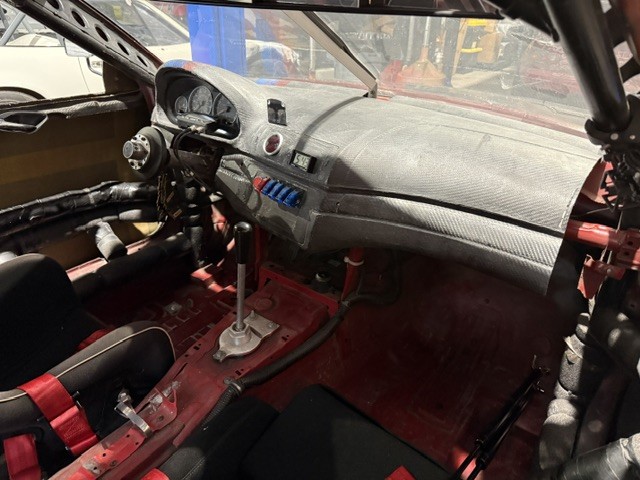

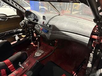

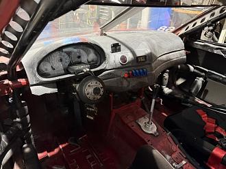

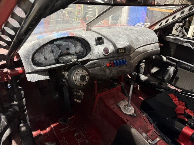

              Dashboard installed! I did slice my leg open on the lower edge getting into the car. I just tin snipped the corner off out of anger. It was a tricky install. I used send cut send to fab some brackets and then bonded them on the back of the dash.

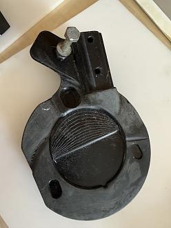

              The carbon fiber strut plates have survived!

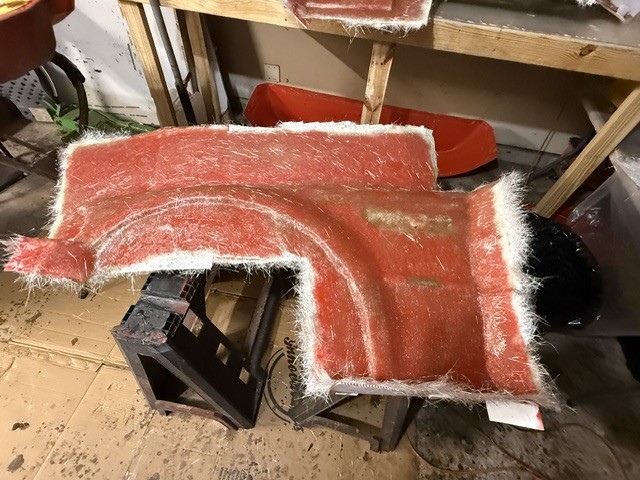

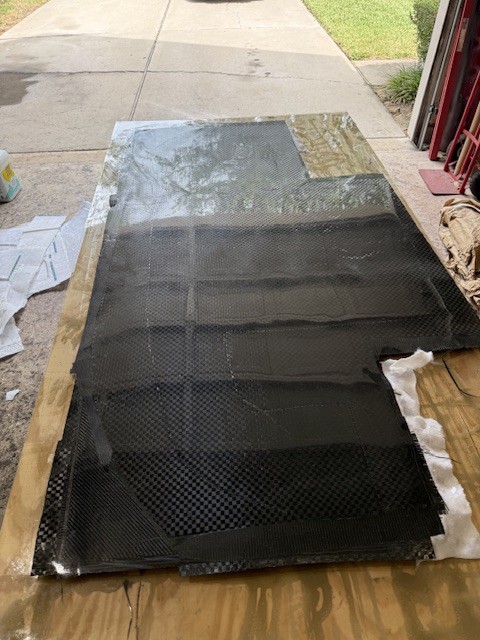

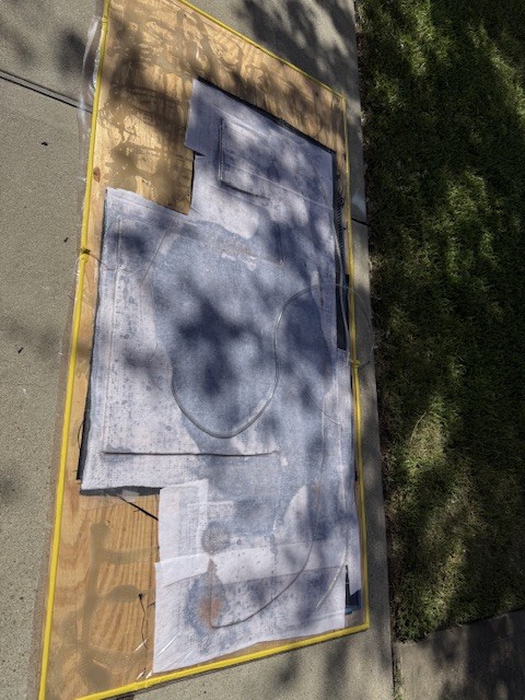

              Making some revised carbon fiber floor adaptors. Mold is in progress.

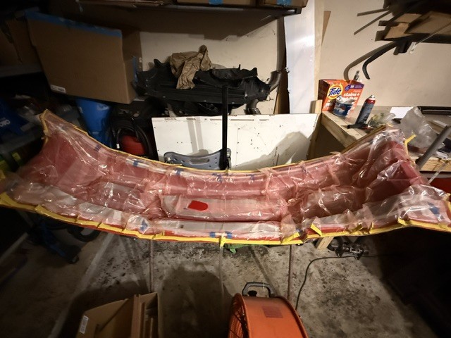

              Front bumper is ready to infuse. Epoxy backordered two weeks ago, just got it in today.

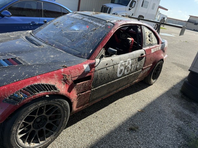

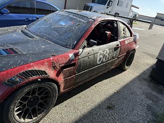

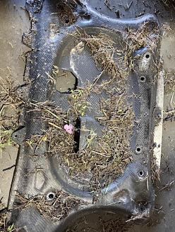

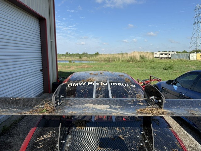

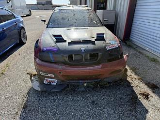

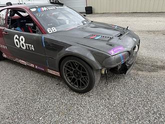

                MSR Houston is, how can I explain it, a shit hole. The track is bad wet but it is WAY worse when its green. It is basically like driving on a gravel road now, all of the asphalt is worn away so all grip is totally reliant on tire rubber. The grip is inconsistent in a way that it goes from grip to zero is really weird spots. The key is to tippy-toe around a couple of laps to figure it out if that is possible.

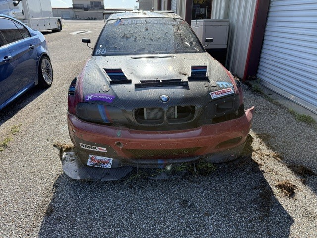

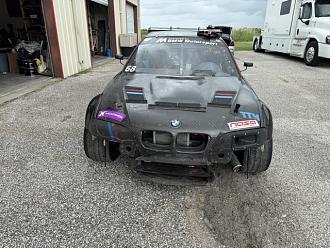

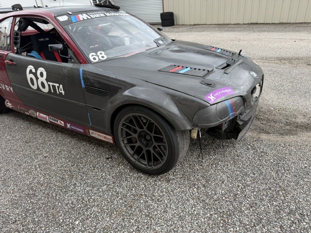

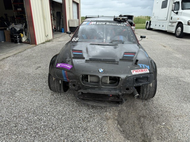

                Well...it rained heavily the night before. I did a sighting lap and then went a little faster on the 2nd lap. Fast right hander into a double right hander - the back end snapped to the inside of the track at 112mph, left the pavement going backwards at 70mph, about 175' off the track, still doing 60' and went off 374' from the track.
                Click image for larger version  Name:	IMG_5982.jpg Views:	8 Size:	129.6 KB ID:	355916
                Click image for larger version  Name:	IMG_5984.jpg Views:	8 Size:	104.0 KB ID:	355917
                Click image for larger version  Name:	IMG_5983.jpg Views:	8 Size:	133.4 KB ID:	355923
                Click image for larger version  Name:	IMG_5986.jpg Views:	8 Size:	162.3 KB ID:	355924
                Click image for larger version  Name:	IMG_5985.jpg Views:	8 Size:	123.9 KB ID:	355918

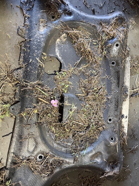

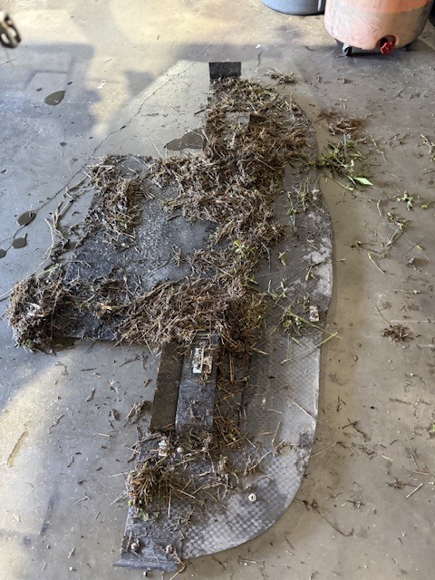

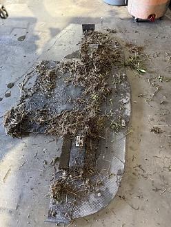

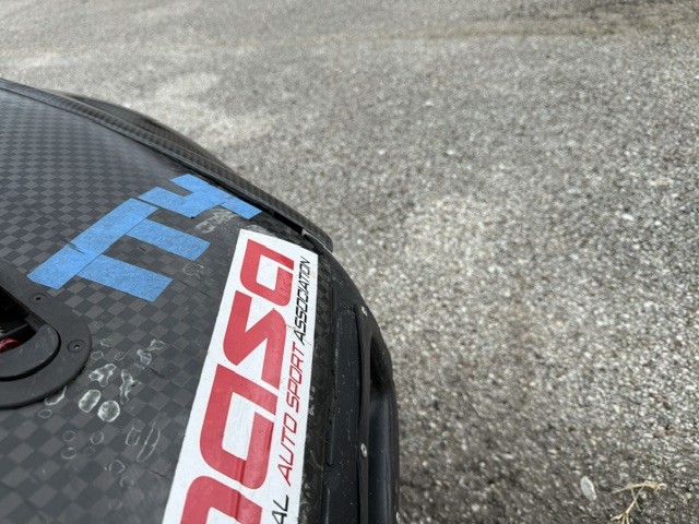

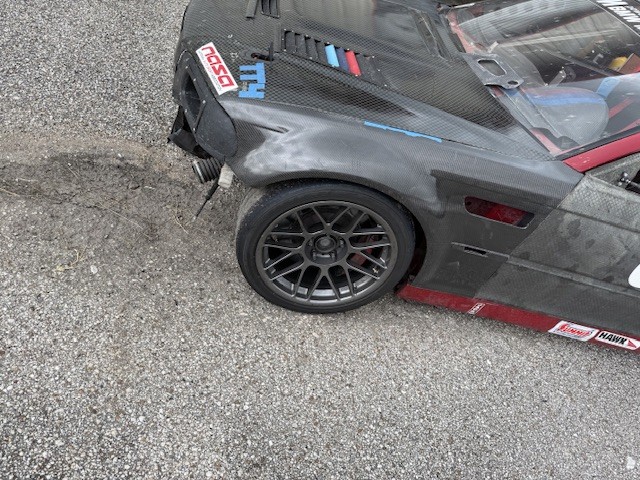

                The bad thing about going off backwards is every panel under the car scoops up dirt and grass. The splitter was probably over 50 lbs, I couldn't even hold it up, just fell to the ground. Good thing is, I went off backwards so not much dirt and grass go into the car. The front kevlar rebar pulled off when I got towed up, normal M3 stuff. For some reason, I had panel bond with an extra mix nozzle at the track. I was able to bond the bar back to the aluminum plate and I was back on track the next day!

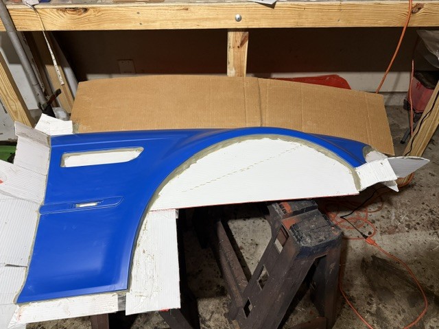

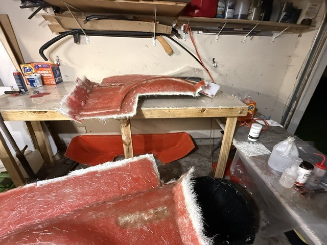

                Fender molds...going mostly well so far!
                Click image for larger version  Name:	IMG_6069.jpg Views:	8 Size:	113.5 KB ID:	355920
                Click image for larger version  Name:	IMG_6070.jpg Views:	8 Size:	100.8 KB ID:	355921

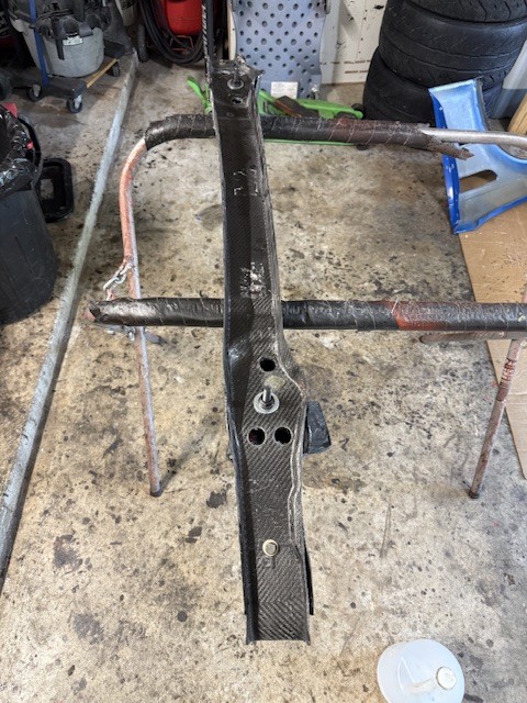

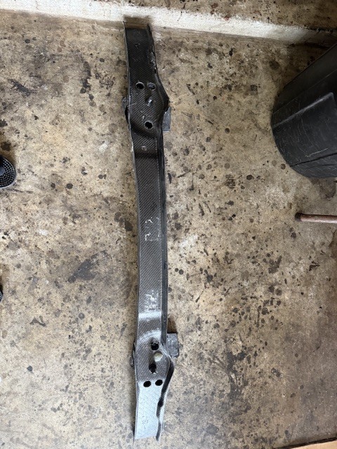

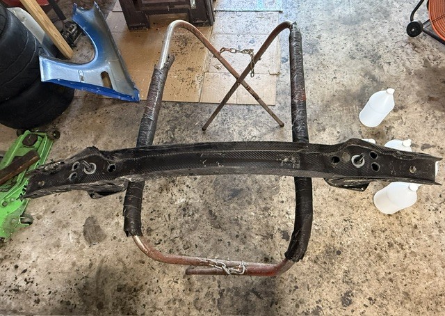

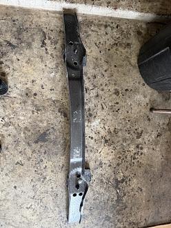

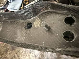

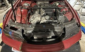

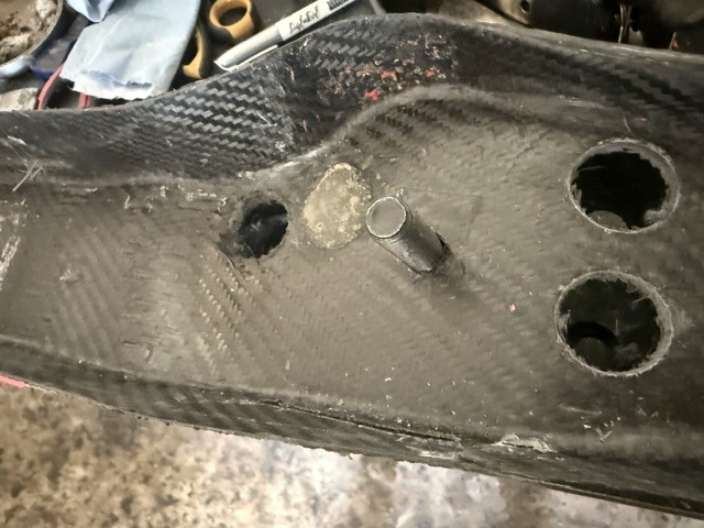

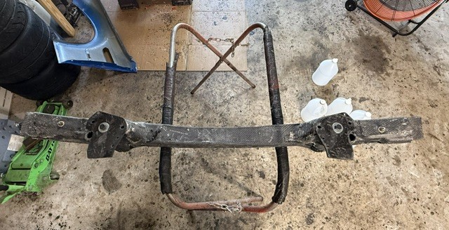

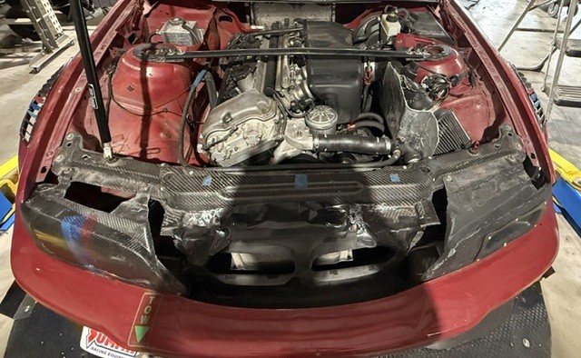

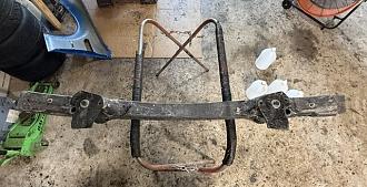

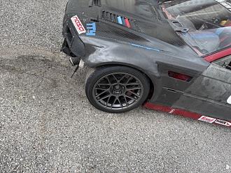

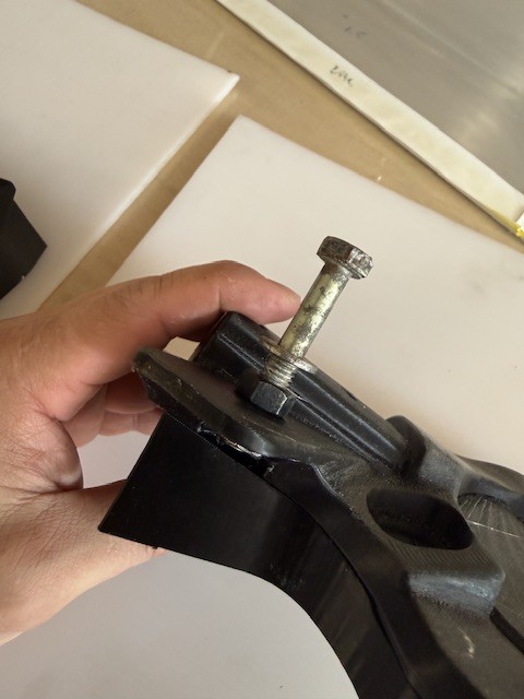

                The carbon fiber front rebar work moves up the priority list due to recent events. I want to prevent the bar from being pulled apart in the future. I am using a bolt through on both sides and the carbon plates should be strong enough to withstand being yanked out. I has gone together OK...OK is good enough.
                And damnit! The bolt is about 1/2" too long. I can chop the end off but grinding through a class 10.9 hardened steel bolt won't be fun. I don't think it will be an issue.
                Click image for larger version  Name:	IMG_6071.jpg Views:	8 Size:	86.7 KB ID:	355922​
                It is together. The panel bond is holding up but I still cheated and added two more bolts towards the outer edges.
                Click image for larger version  Name:	IMG_6074.jpg Views:	8 Size:	128.2 KB ID:	355926
                Click image for larger version  Name:	IMG_6076.jpg Views:	8 Size:	95.0 KB ID:	355925
                Click image for larger version  Name:	IMG_6072.jpg Views:	8 Size:	135.3 KB ID:	355928

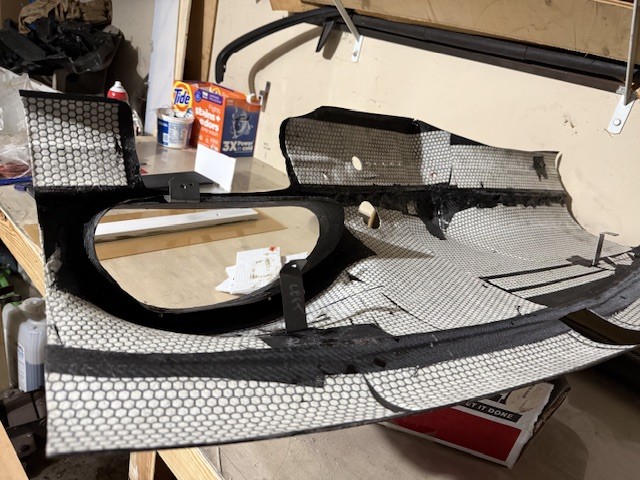

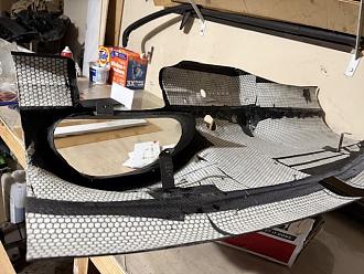

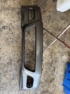

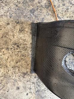

                        I'm happy with the front bumper. I included some flanges on the ends to mount tire blockers to. Now I need to figure out how to mount it. 4lbs lighter than an unpainted OEM bumper.

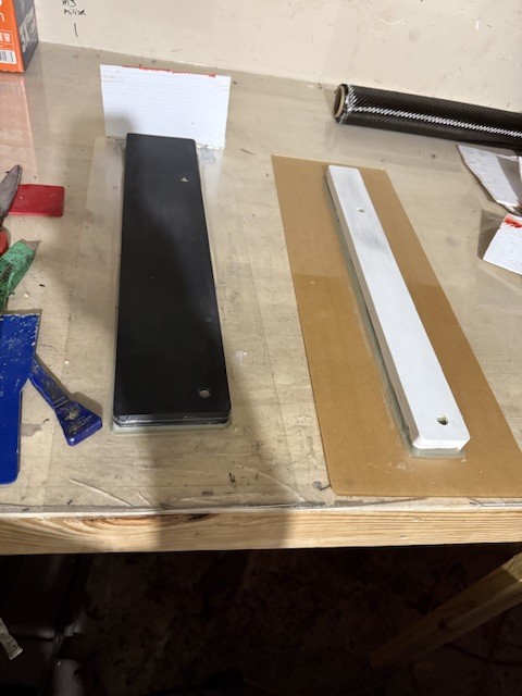

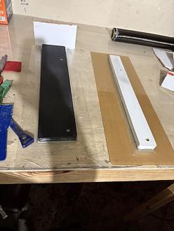

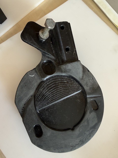

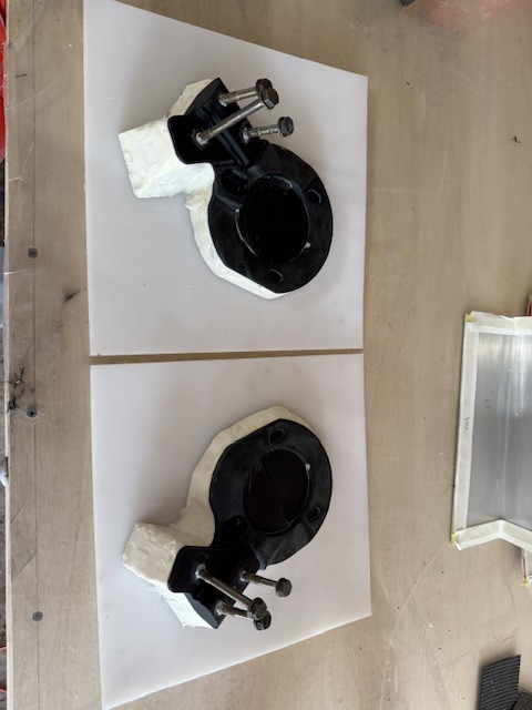

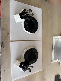

                        Working on the Heinzboehmer strut plates V2 mold. Just waiting on the casting resin to arrive. Two major things - need to fill in any cracks or crevices AND create a draft angle underneath the part to make it easier to release and allow excess resin to escape.
                        Same as V1, I will mold threaded inserts for the strut bar. I want to mold a threaded insert into the spot where the triangle braces bolt to, we'll see how it goes. For now, I glued a nut into the bottom to make sure the hole will line up.

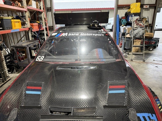

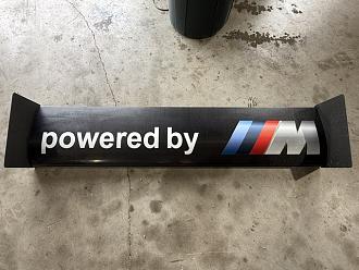

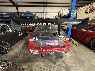

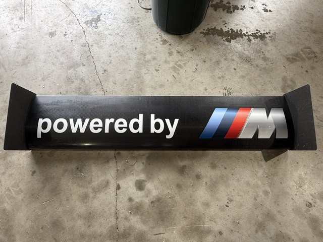

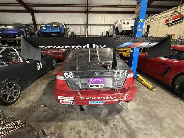

                        Adding 20hp! I should have lined up the decal with the back edge of the wing.

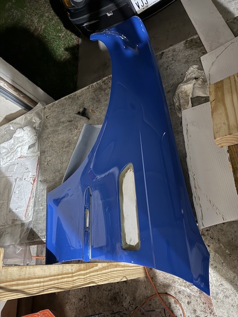

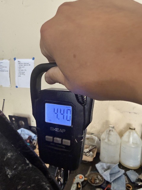

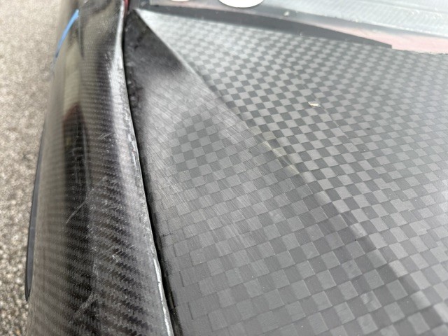

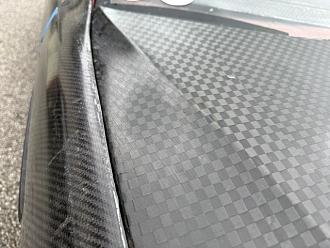

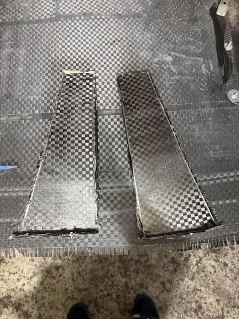

                        Finally finished the carbon fenders! Came out really good. Not perfect fitment but it fits. I'm pretty sure I could make it fit perfect but that would require a lot more time. Basically I'd have to cut the flanges short, apply more carbon to the joints and then bag the part.
                        1.80lb carbon part vs 6.6lb stock.

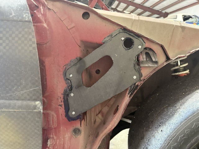

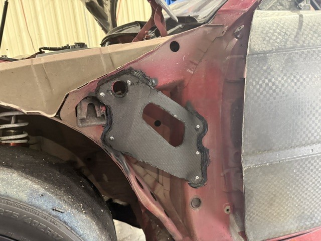

                          Finally got Bry5on's wheel well reinforcement plates on. Bonded and riveted.

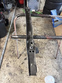

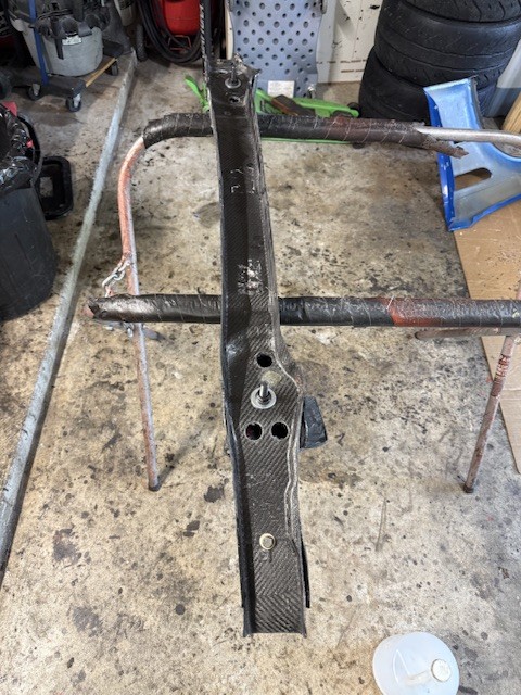

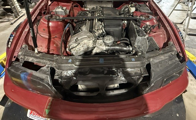

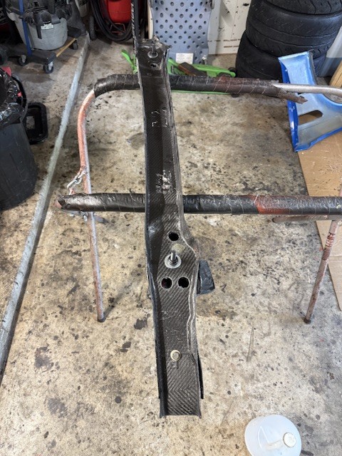

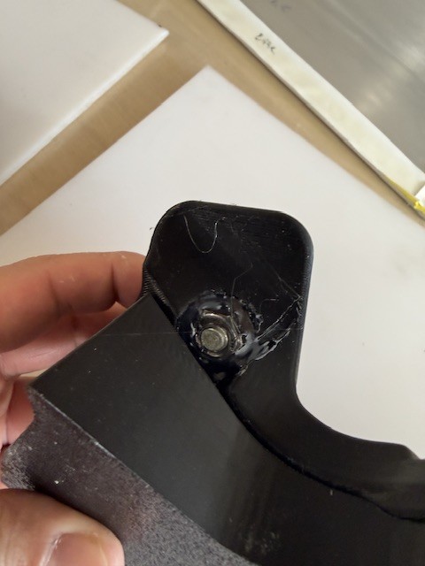

                          And failure on the CF front reinforcement bar. The spacing was off. Onto attempt 2 later in the year.

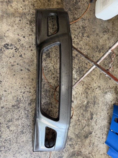

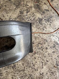

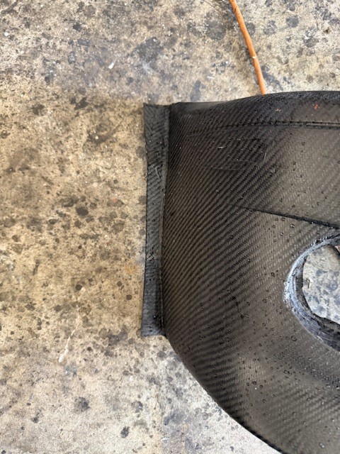

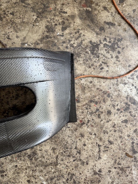

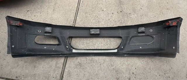

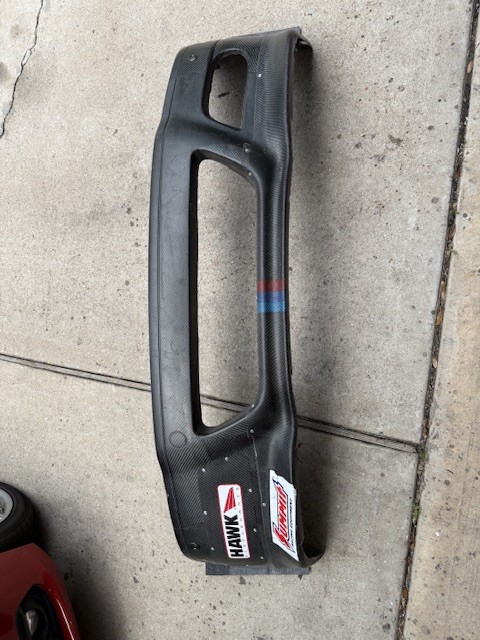

                            Front bumper done! Made a partial "foam"'piece and the end mountings. I am finishing up the end brackets this weekend. The bumper will be easily removable to remove the splitter for easy loading onto trailers when needed.
                            Click image for larger version  Name:	IMG_6296.jpg Views:	0 Size:	117.5 KB ID:	362697
                            Click image for larger version  Name:	IMG_6297.jpg Views:	0 Size:	63.7 KB ID:	362696
                            4.8lbs fully dressed with the air dam. Yay! That's over 4 lbs off the nose of the car.
                            Click image for larger version  Name:	IMG_6298.jpg Views:	0 Size:	98.5 KB ID:	362698
                            Tire blockers done. They just need a
                            trim and final install.
                            Click image for larger version  Name:	IMG_6259.jpg Views:	31 Size:	137.4 KB ID:	362699

                                I am making some repair plates for the factory kevler front crash bar. It takes one tow to bend the OEM aluminum plates. I will bond some forged carbon plates in place of the aluminum plates and run a bolt through the passenger side. Then I will need to upgrade the bolts which hold it to the frame rails. I'm just getting tired of screwing with this stupid crash bar - it has been a constant, although minor headache that becomes a major headache at the worst moments.
