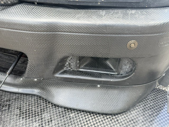

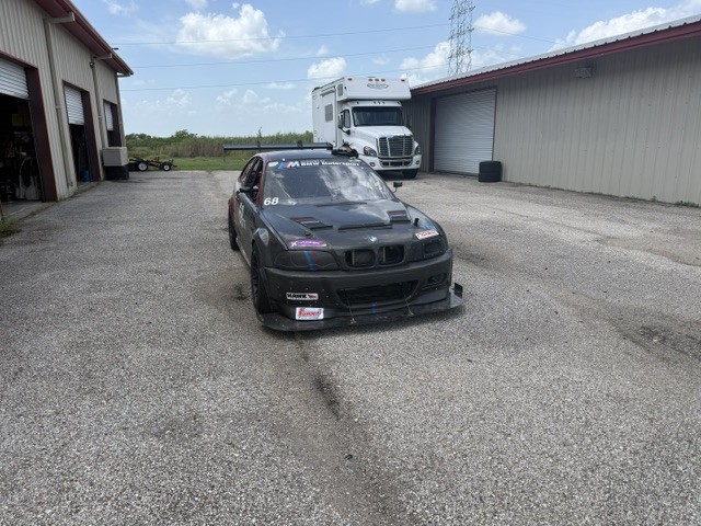

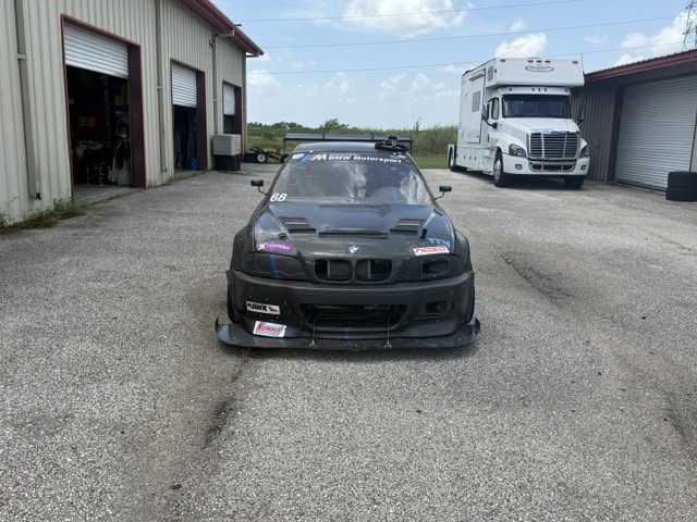

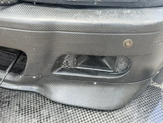

              The front bumper is a success! It is finally on the car after 3 failed attempts at making a mold and the mounting complications. Not finished, still have some details to work on. Fitment is pretty good, just need to make an adjustment on the left side latch pin. I think I am going to just glue on the center grill and also need to install a gasket around the left fog light opening to seal off the duct.
              The one complication I did not foresee is the splitter height needs to be more precise since carbon is far less forgiving than plastic. The front splitter needs to be lower. While I have height adjustments at the two primary mounts, the outer mounts don't since they are eBay box lid struts. Also, need longer front support struts. Currently brainstorming how to add adjustability with the shocks. I want to keep some sort of shock in place, they have done a great job of being a firm mount while allowing some upward forgiveness when scraping. The upside is I get to trim more carbon off which I'll be a couple more ounces lighter! Lol
              Once I lower the splitter, the bumper will be very easily removable. Hopefully I can still load the car onto my trailer using race ramps with the splitter on. The splitter takes less than 5 min to take off and pin it back on for transport. It is still a chore I'd like to avoid at the end of a long hot weekend.

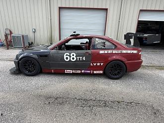

              Thinking of a new name since it is only about 33% red.

              With it being around 100 degrees outside...close enough for now. Someday I'll order a TT4 decal...

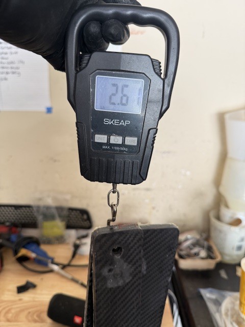

              Forgot to snap a pic of my new compression molded carbon fiber floor mount seat adaptors. 29 layers of carbon, 6 layers of kevlar - 3/8' thick solid carbon/kevlar.
              My current carbon mounts were vacuum infused in 2 halves and bonded together to a similar thickness using mostly unidirectional layers. Learning has occurred and decided to use a 2 pc compression mold which creates more compaction than vacuum infusion. This achieves a better higher fiber:resin ratio which results in a stronger, stiffer, and lighter part.

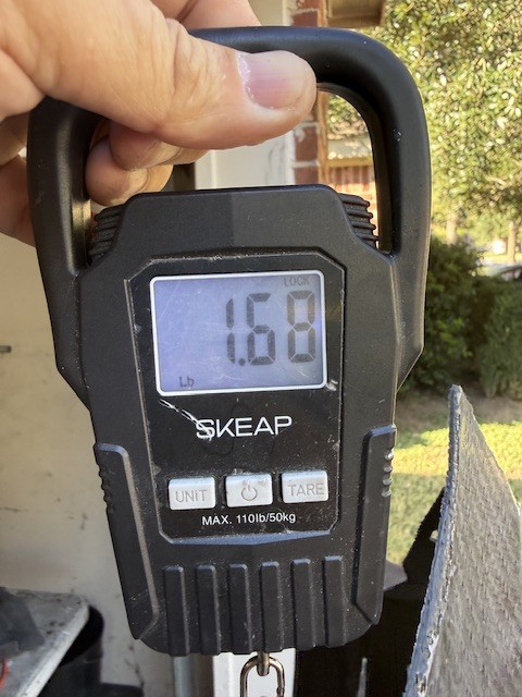

              2.6lbs for the inner and outer mount. I think it will be slightly more than what's in the car but the new mounts are also a little thicker (6 more fabric layers).

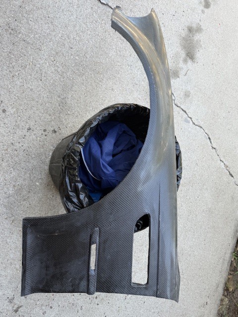

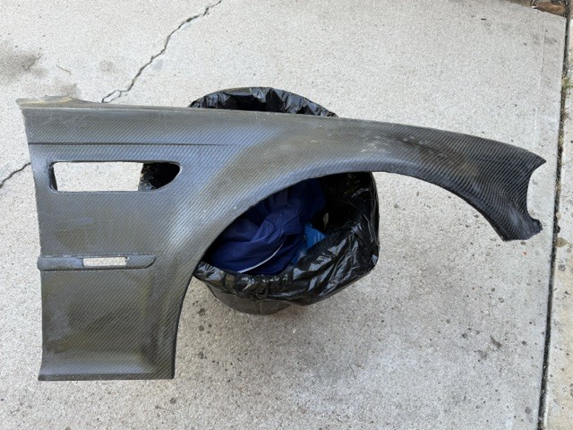

              My spare fenders are done. Really odd how one side is .6lb heavier than the other. I measured three times. Both sides are similar in stiffness. I did mess up and had the bag tape come undone - didn't clean off the release agent from underneath - so I temporarily lost vacuum. Not sure which side it was but it shouldn't have resulted in that much more weight. Both sides used a similar amount of epoxy. First time I've been that off on a left-right or like part. That's one thing I've been fairly consistent at.

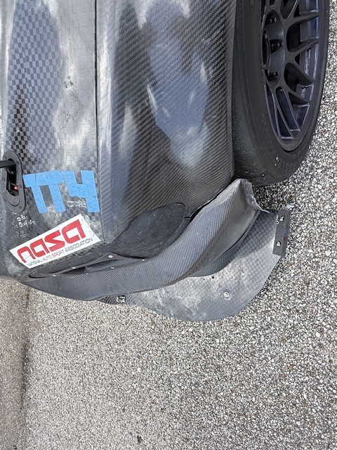

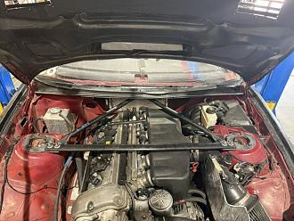

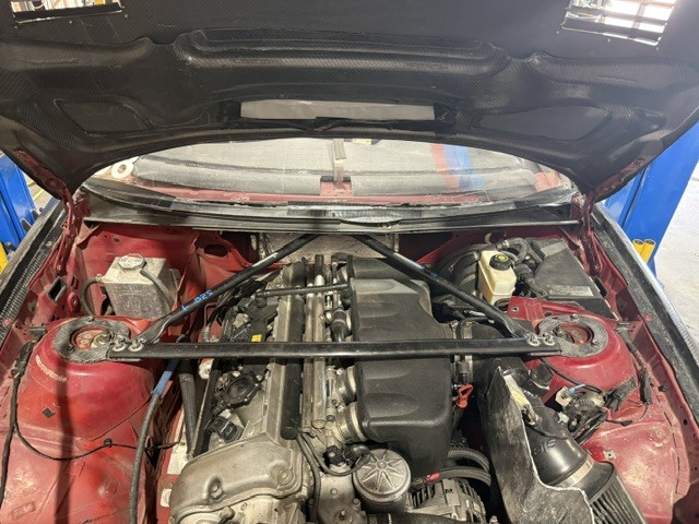

                First time on track since May with Heinz's strut brace, Bry5on's wheel well reinforcements, and carbon front bumper and fenders. Normally MSR Houston is terrible in the heat. I'd describe the feel of the track as slimy meaning the car just slides. Understeer right into oversteer.
                I wasn't pushing the car but holy shit the front end felt so much more responsive in conditions where it would normally be mush. This is a HUGE improvement! Thanks for heinzboehmer and Bry5on for their excellent ideas!

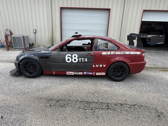

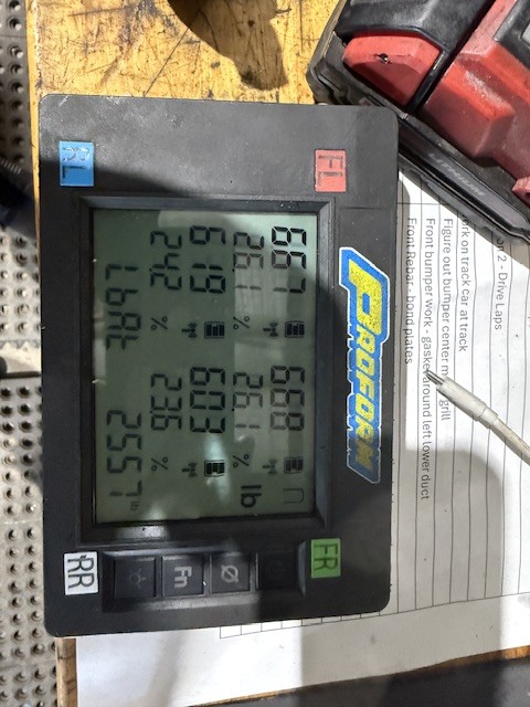

                FINALLY!!! I should be under 2500lbs!
                2557lbs with a pass seat, harness and 35L of fuel. Realistically, around 2485lbs dry - no fuel, no ballast.

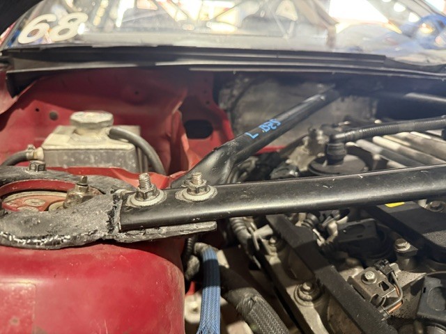

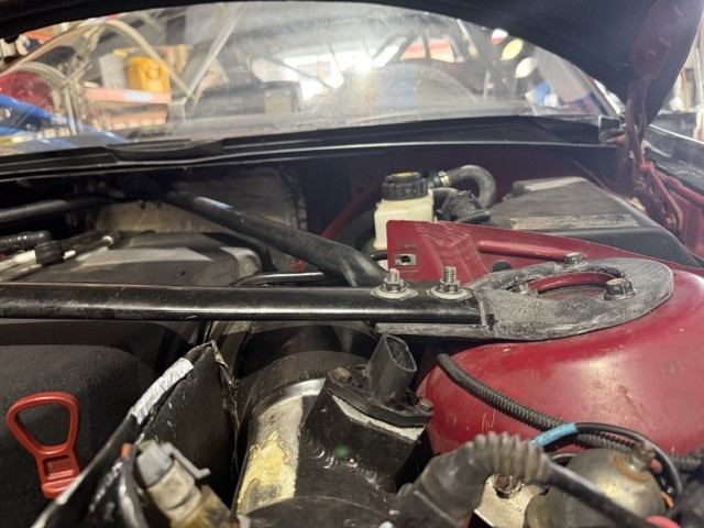

                At some point, I will make the E86 braces from carbon tubes. I'll be buying them from Dragonplate.com. Not sure about the center bar.
                Click image for larger version  Name:	IMG_6371.jpg Views:	0 Size:	111.7 KB ID:	366324
                Carbon fiber strut tower brackets

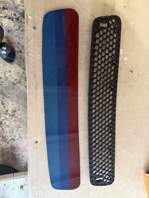

                My cheeseball carbon fiber HVAC cabin air filter block off plate.
