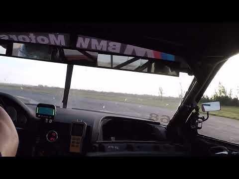

    Day 2 - ready to go! Hoosiers on! Now my GoPro is having issues but I did capture the interior video! lol
    Did a disappointing 1:41.055 on session 1. My TC Klines are officially completely worn out. The car was bouncing when turning in at 124 mph. I could have gone deeper before every braking zone but I wasn't sure if the car would turn in. I pushed as hard as my nerves could take. Winner and lap record was a full second faster.

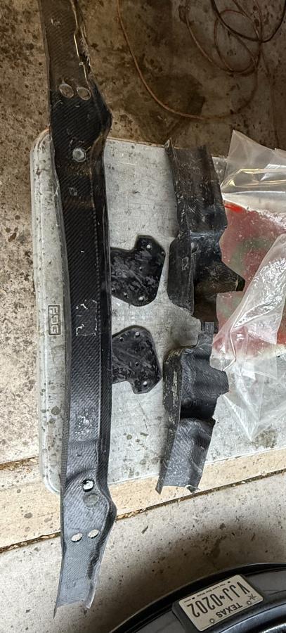

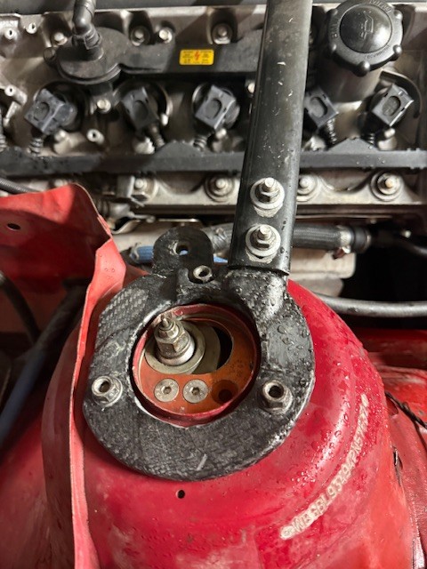

      Forged carbon strut tower plates came out good! Someday I'll finish Heinzenboehmer's strut brace project. Getting closer.

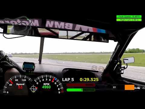

              It has been awhile but finally set a new PR at my home track! Despite having to go around a spun Miata, did a 1:40.56. Goodyear Supercar 3R with 10 heat cycles, no ballast, full power.
              Previous PR this direction was 1:40.9. I was on a predictive 1:40.0 before I encountered the Miata. The goodyear supercar 3Rs had 10 heat cycles so far and were an easy 1 second faster than a Toyo RR, probably closer to 2 seconds.
              Removing the ballast caused quite a bit of oversteer over the only elevation change on the track.
              No data because apparently the Solo 2 DL has a 10 minute internal battery. Oh...so that's why it came with a charging cable. Unfortunately I sold the charging cable with my old Solo DL.

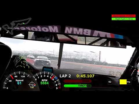

                ​Could be my last ride at COTA. New PR of 2:27.0 with a virtual best of 2:26.7. Ran Falken RT660s on day 1 and Goodyear Supercar 3Rs on day 2. It was an easy 4 second difference! Ran a 2:30 with cold tires at the start of the lap and a far from optimal lap.
                I installed a passenger seat and ran a higher fuel load which greatly helped the balance.
                  The carbon fiber strut base plate has seen 1.9g of lateral loads. I consider this to be tested and good to go. I had no doubts when compared to the case aluminum OEM part. The nuts holding down the bar have been torqued a couple of times. The threaded inserts seem to be holding.

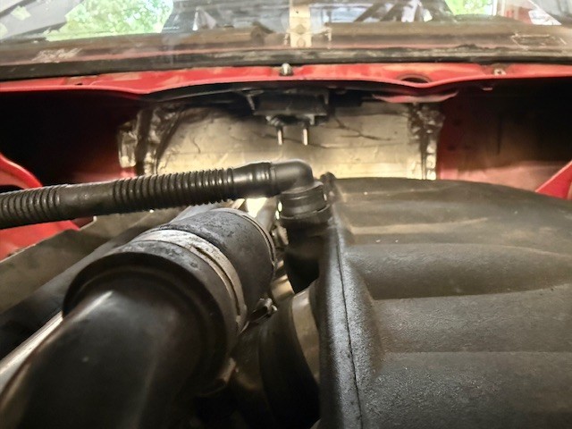

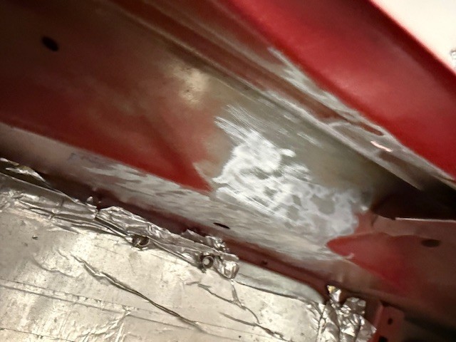

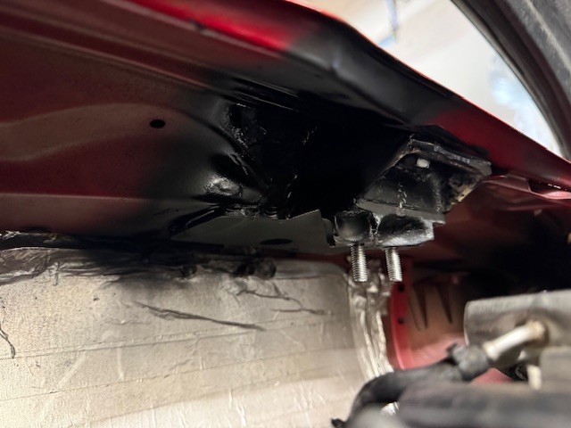

                  Next step is to get the firewall mount bonded. I used a combination of an air angle grinder with a roloc disc and 120 grit sandpaper. Bonded on with buck bond which is a 3M panel bond knock off. It has served me well so far...

                    You still planning on making your own CF braces?
                      Hell yeah! That's awesome
                      Yes. I plan to use tubes from Dragonplate.com. They have a whole system with bond in ends.

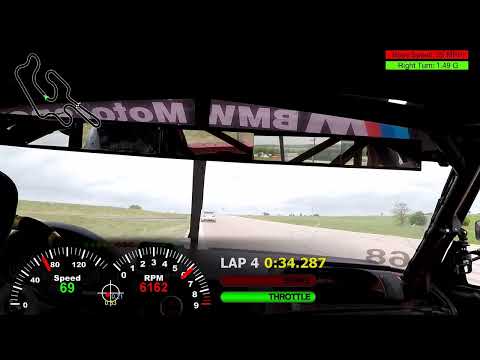

                        NASA at Eagle's Canyon Raceway! Came in 2nd on Sat and skipped Sun. ECR is a solid 5 hours away and I had to get back for my ice hockey season championship game. Hockey > Cars...sorry!
                        It was going to rain Sun and then dry out so there was no point in running in the wet. I have no windows and I have to drive through DFW and Houston to drop off the car and trailer were also reasons to leave early.
                        ECR is my weakest track in TX mostly because it's the one I have the least amount of laps on. Best lap to date was a 2:08 and I showed up and had no clue where I needed to pick up time. I was thinking I need to be at least in the 2:06s to be competitive. 7 entries in TT4 so tires were up for grabs!!! Test and Tune on Friday I was running a 2:14 on RT660s. I was like WTF. Threw on the Goodyear 3Rs and boom...2:08s! The RT660s are 5 years old...never checked the DOTs. Ran on Sat with Hoosier R7s and barely broke into the 2:05s.
                        Still trying to figure out T6 and T7. Otherwise, understeer is the theme. I need more front end. There are 3 places where I need to be braver getting on the throttle. I guess the good news is my 14 year old TC Klines are still technically working but the right strut is completely dead. The car does not like left turns and this track has 10.5 left turns vs 6.5 right turns. And most of the right turns are faster so really need the car to turn left really well.
                        There is an easy second just with better braking. I was on 8 heat cycle R7s, probably a second in tires. I think there is 2-3 seconds in the suspension. Could be in the 2:01's in optimal conditions.
                        I also have the question where the detune + Hoosier R7s are the right choice. The rear has so much grip with the AJ Hartman wing that I have to slow down and use more steering. If I had to describe my driving still is to nose the car in and then aggressive throttle application to turn the car. BUT...I really can't make a good decision until I get the FCM dampers in.
                        I think I'll be second in the season points due to missing two days. Lesson learned on the first event when I sat out a day with a bad ABS sensor. Should have put in at least a slow lap to get points. I'm still in great shape. One other guy has been to all of the events but he's in a stockish GR86 so not at the front end of TT4. But I may still need to go to Hallett if he does.

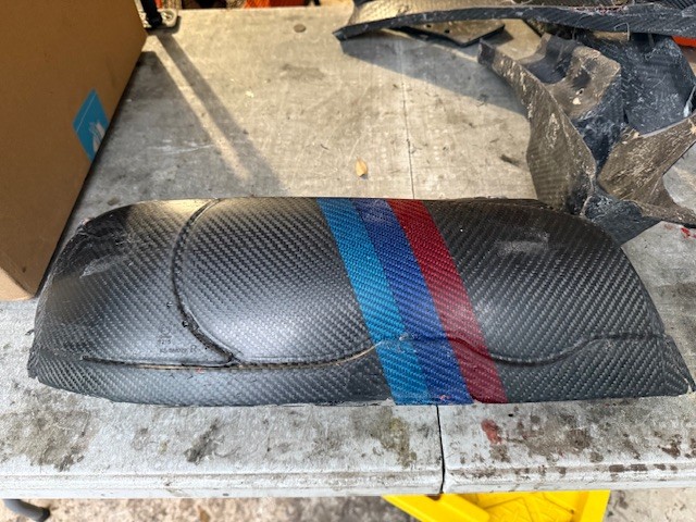

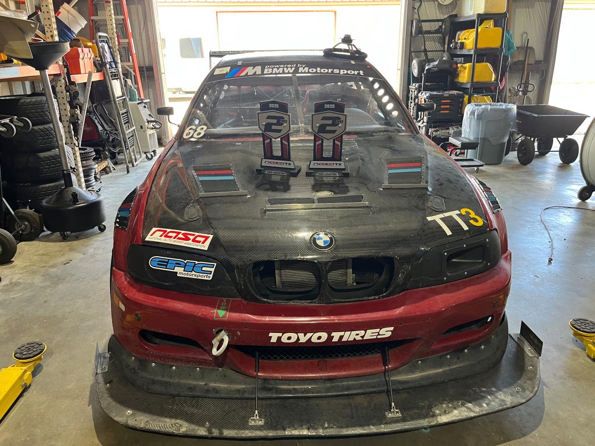

                          Carbon fiber/kevlar front crash bar. This has been a painful experience. Lots of lesson learned but demolding the damned thing...was epicly shitty! No one will ever question my commitment to remove 25 more lbs over the front axle!!!
                          The parts are 3.6lbs. I think the OEM bar is 11lbs or so. Not sure if it will all fit...not good so far. That's why god created hammers and pry bars! The carbon will be stronger than the OE part. The issue is once the carbon yields, it has zero strength. Kevlar has the best material toughness meaning it will yield but retains a lot of strength. I used 2 layers of kevlar, maybe I needed to use more.
                          If I had to do it over, and I'll probably have to, I'd use make a 2 part compression mold and use sheetwax to offset the inner and outer mold. Then make the part to a specified thickness. Then it would fit together. I started making the molds awhile ago and figured all of this out since then. The good news is this is from all scrap stuff so really didn't cost anything except for some pvc tubing, spiral wrap, a roll of tacky tape and some epoxy - $50? Time...that's another story.

                            Damn...got the colors in the right order but the slant is the wrong way 😫
                            F'it...it's going on the car!
                              Click image for larger version  Name:	IMG_5892.jpg Views:	0 Size:	118.2 KB ID:	352854
                              It's functional, hah! What does the driver's side look like?
                                It has an intake air opening.
