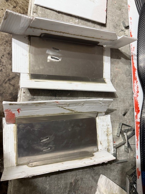

      Air dam is almost done. Needs a little more trimming.

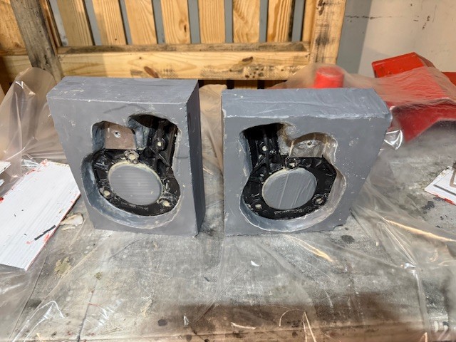

      I'm happy with the brake deflectors. So mold making has started! I think I have an idea for mounting. More to follow!

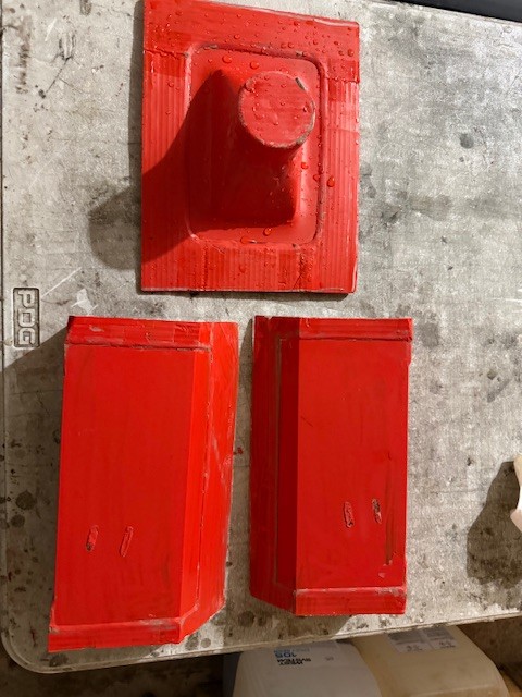

        Single air duct and brake deflector molds done. Still working on the wheel well plates. Had a gel coat issue so I'm starting over.
        Click image for larger version  Name:	IMG_5489.jpg Views:	0 Size:	91.2 KB ID:	332321

              Half way done! The 2nd half of the mold will be a PIA. All of the little details will provide opportunities for a bad release.
              Maybe consider making the underside flat? The details are just there to save weight for the cast part.
              (which means you'll end up with a heavier carbon part if you fill that in, of course)
                I did but I don't think it will be a huge issue. I use release wax and then a chemical release. So I just need to spend more time getting the wax into the corners. Then the chem release is a solvent so it should provide a good backup to the corners and edges.
                  You could also do a hybrid. Fill the tight corners with putty to open up the radii and make release easier with little weight penalty.
                    I would more likely do that for the first half but I'm willing to risk it for the 2nd half. The 2nd half uses about 1/3 the casting resin and is relatively quick to setup. Most of the work is in the first half of a compression mold.
                      2nd half of the mold is done. Once again, I forgot to install drive pins in the negative side to get the part out. So I had to drive the part out by threading a bolt in. I chipped the mold around the bolt hole which will require a repair. It will be a pain but maybe I'll learn my lesson this time.
                      Also didn't catch a negative draft around the inner opening. So I need to make 2 small repairs on each side.
                      Overall they came out really good!

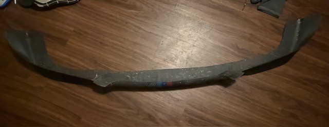

                          Splitter is made and came out great! The spread tow fabric looks outstanding as always!
                          Foam core cut and shaped
                          Click image for larger version  Name:	IMG_5545.jpg Views:	20 Size:	86.6 KB ID:	340672
                          This was a wet layup and the vacuum bag. Not 100% optimal but the foam core presents some infusion challenges without infusion channels. The foam core is impermeable so the large flat surface will not enhance resin flow in an infusion. Some resin with flow through the carbon except for any spot where layers of carbon tows line up. And then any air will have an extremely hard time to flow towards the vacuum side.
                          I drilled over a hundred holes in the foam to allow air to flow from the mold surface. Even then, I didn't want to risk large epoxy voids in an infusion. The holes in a wet layup will allow for excess resin and air to be pulled through the holes and towards the vacuum. But damn...a wet lay is a LOT more work! Critical to use a very slow hardener and mix in smaller batches to prevent exotherm. I used Pro-Set extra slow so I had 3 hours.
                          If you do a wet layup, it is important to thoroughly roll the layers under the foam to remove as much air as possible to minimize the risk of air being trapped under the foam. Air creates resin voids which results in a weaker part.

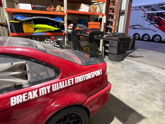

                          AND...AJ Hartman rear wing. Somethings are better left to the professionals. A rear wing is one if those things. Expensive but the E46 kit is comprehensive. Took an hour to mount. Easy peasy!
                          Click image for larger version  Name:	IMG_5561.jpg Views:	21 Size:	116.8 KB ID:	340671
                          Click image for larger version  Name:	IMG_5560.jpg Views:	22 Size:	114.9 KB ID:	340673

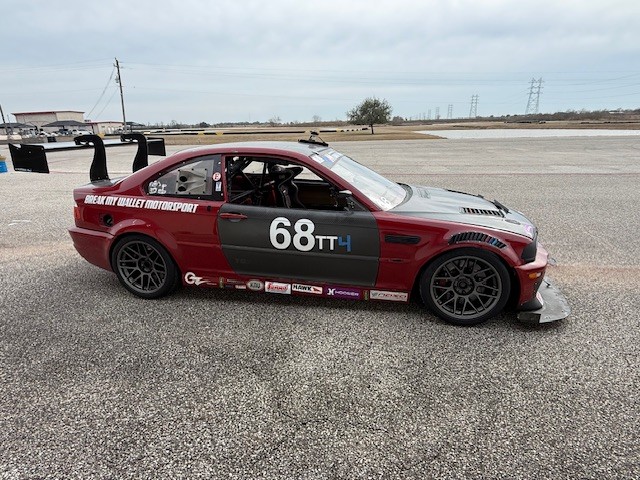

                                Had to go back to the old splitter for TT4...all ready to go!
                                Click image for larger version  Name:	IMG_5620.jpg Views:	7 Size:	127.6 KB ID:	342546​
                                Click image for larger version  Name:	IMG_5621.jpg Views:	7 Size:	126.8 KB ID:	342539
                                Click image for larger version  Name:	IMG_5623.jpg Views:	7 Size:	117.7 KB ID:	342543
                                Click image for larger version  Name:	IMG_5619.jpg Views:	7 Size:	129.1 KB ID:	342547
