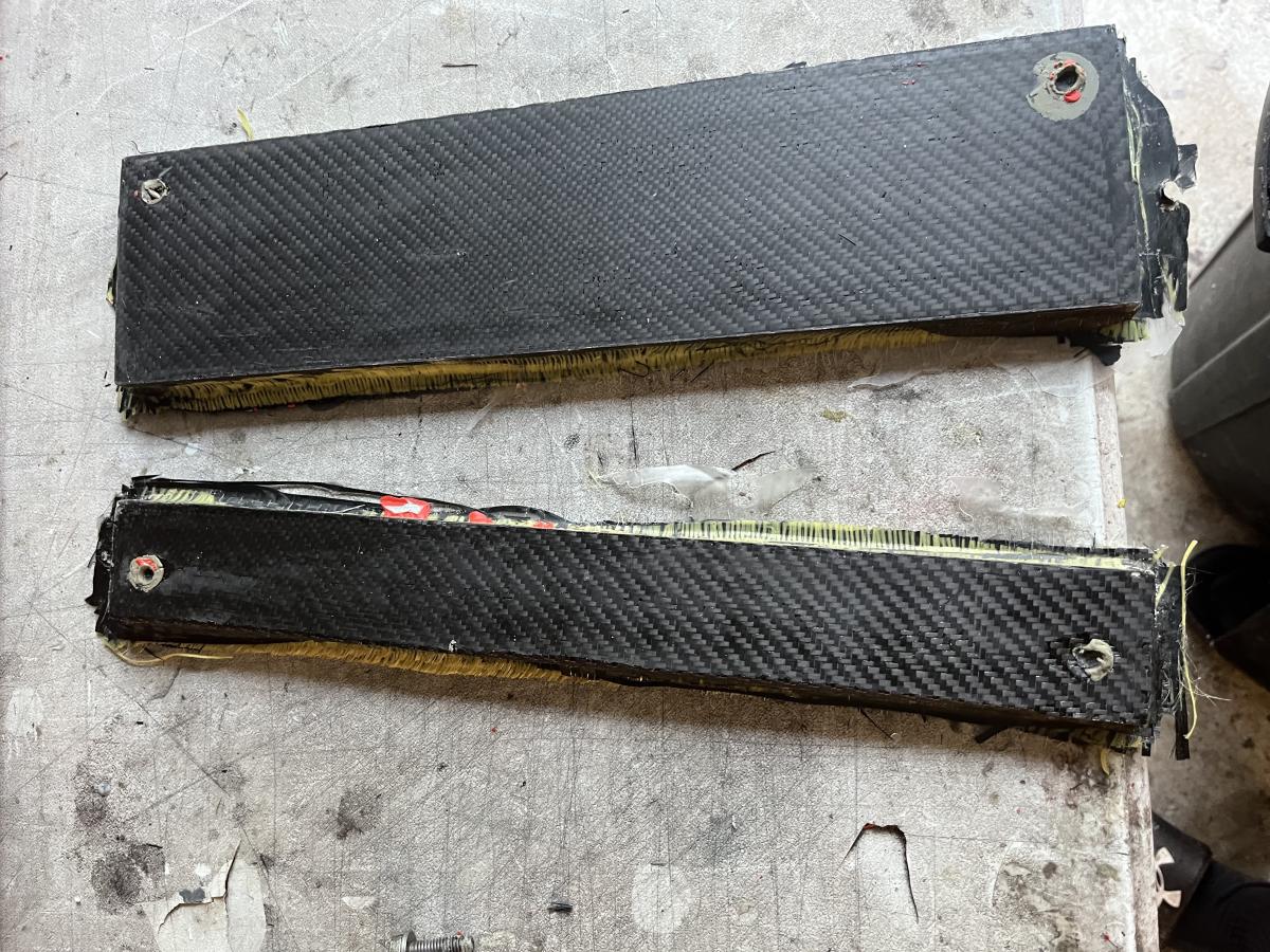

          Carbon fiber racing seat floor mounts! The backside didn’t go as planned but they turned out great otherwise! 2.25lbs for the outer and inner. 90% Carbon and 10% kevlar. These will be a mutha f’er to drill. Have to figure that out. Might have to outsource that.

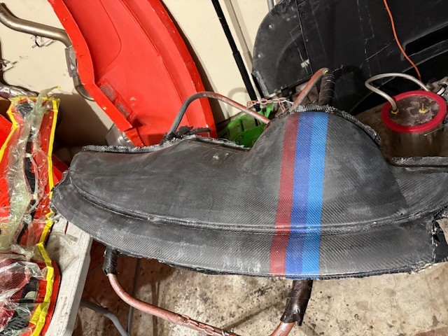

                  The dash is done! 3.3lbs full size, 3lbs trimmed to fit around the roll cage. I think this will be 10lbs of weight loss.
                  Click image for larger version  Name:	IMG_5105.jpg Views:	0 Size:	84.3 KB ID:	316798
                  Click image for larger version  Name:	IMG_5106.jpg Views:	0 Size:	72.6 KB ID:	316799
                  The dash has the OE texture so it comes out dull. Just can’t sand it or really do anything to keep it not shiny. I used a dash with some sort of cosmetic issue above the center vents. Got it cheap and its for a track car.

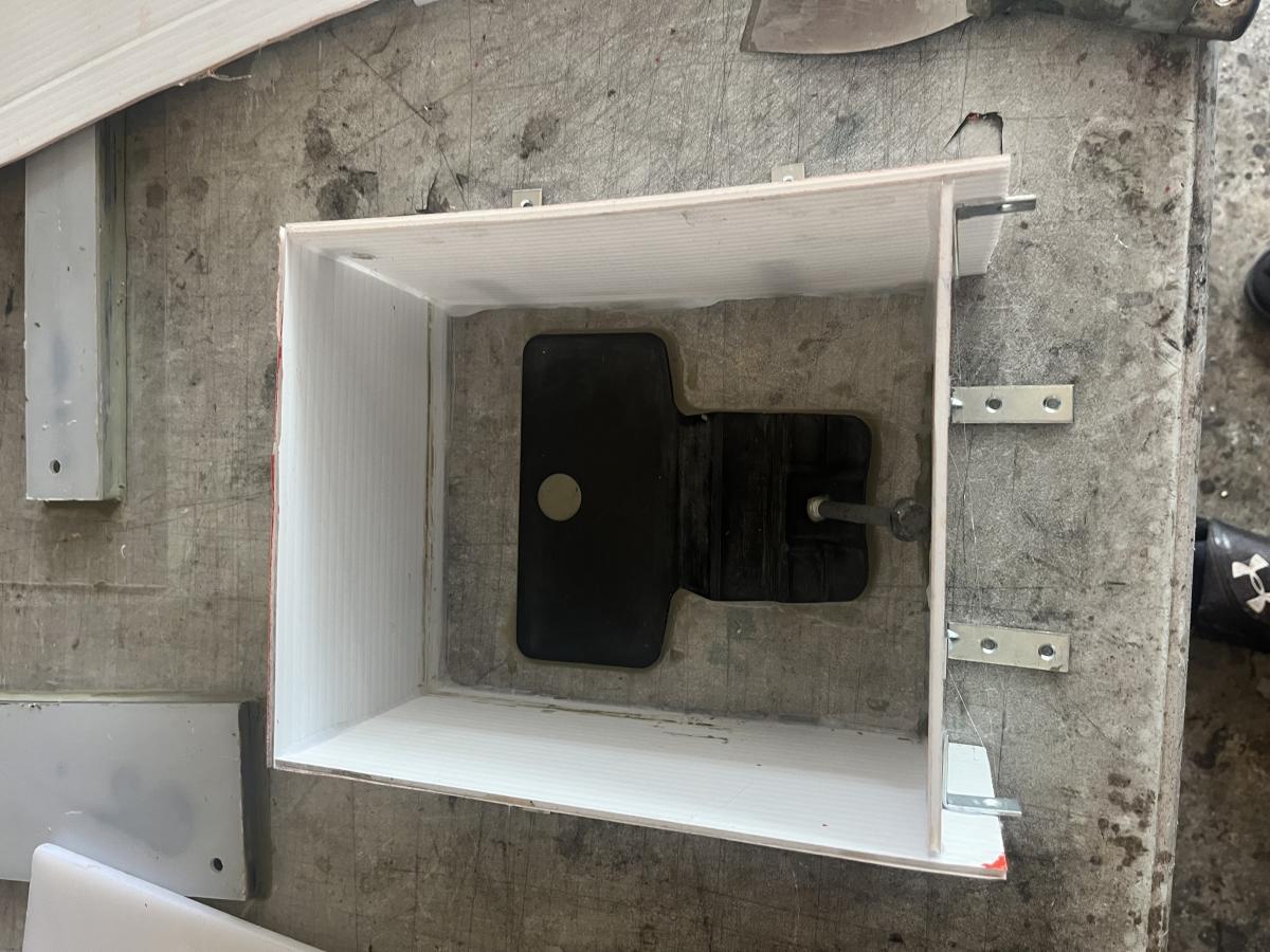

                          So I’m using heinzboehmer’s strut bar design to learn how to cast molds and also add some front end stuffness.
                          Huge thanks to Mr Heinzboemer for sending some 3D prints of the center mounting!
                          It is mildly mindbending to think in reverse of the reverse of the actual part.
                          First, need to prep the plug to cast. Can’t have any negative or 90 degree angles! Create a draft angle at the base, seal and release and then make a fence.
                          Click image for larger version  Name:	IMG_4622.jpg Views:	0 Size:	88.6 KB ID:	320345
                          pour the casting resin

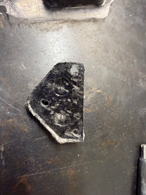

                          Chop up some carbon, mix epoxy and you have a carbon copy!

                            I molded in threaded inserts instead of studs - studs were $21 a piece! Then I’m going to bond the 2 parts together since I don’t have to worry about servicing my wipers are blower motor.
                            I’m going a different route for the strut bar plates. I am planning to bolt the extra bars onto the existing studs. I will need longer studs and I think I may need to make the strut bar end plates from something stronger - carbon fiber!
