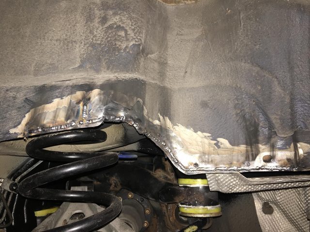

  • timmo
    replied
    Yup, had the same cracks on my ZHP. When I had the plates welded in, I made sure to have them also weld that split seam back up:

    replied
    Originally posted by thegenius46m View Post
    Excellent build! Makes me want to redo a build thread on mine lol. Would highly recommend getting rid of those stock subframe bushings. They're probably the worst designed thing for this car. Originally when I had reinforcement plates welded in I went OEM because I didn't know better in the early days. Well a few years ago I went solid aluminum in the subframe and pulled the oem ones which only had 40k on them. Believe it or not they already had play in them! Aluminum with oem diff bushings was the best thing I ever did.
    Okay, yeah I'll for sure check that out. I have stock bushings in the rear. The RTAB are OE style with the sandwich plates on each side.
    No problem, I wish it were easier to see before you bolted up the subframe, but you could most likely get at it with the damper removed.
    You were spot on. Check out the pictures below. I'll have to remove the damper to get it all welded up but that easy enough.
    I'm pointing to the crack

  • thegenius46m
    replied
    Leave a comment:
  • Slideways
    replied
    Good call, you were right it is cracked right there. I didn't even notice it. Doh! I'll have that fixed. Much appreciated.
