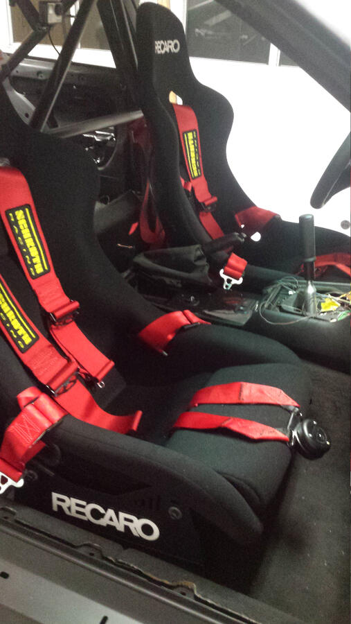

                    Interior pics? Need to see those Recaros!
                      Just have this one from during the build at the moment, but will get some high quality shots of the finished product once it's out of winter storage.

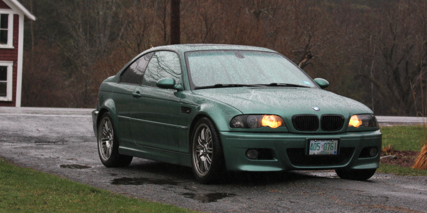

                        Great build! Where's the DD?
                          awesome build. I thought I recognized club motorsport and then saw the NH plates. Hope to see you at the track sometime. I'm a white mountain member and attend most all the Boston/NH events.
                            Here's the beater out in the elements where it usually lives. I flew to LA in 2013 to buy it from an M3Forum member at 124k miles and then drove it up the coast all the way to Seattle. Since then, it's been my year-round car and has been all over the country. I've driven it through snow storms on Loveland Pass, up the Coq to Lake Louise (Highway Thru Hell), down 15 from Calgary to Yellowstone, and back and forth to New Hampshire a few times. It's been to Aspen, Jackson Hole, The Badlands, Sun Valley, Alta/Snowbird, and many other fun destinations. Sees enough road salt to eat a Subaru annually.
                            Coming up on 200k miles on the original rings and mains despite my abuse. Finally gave it a much deserved paint job with a color change to Aston Martin Racing Green (FKA Almond Green) this past summer. I've tried to keep the driving experience as stock as possible with this one, but I'm a sucker for a CSL trunk, so got an OE one of those, a Euro bumper, and a CSL diffuser during the respray.
                            Still puts a smile on my face every time I drive it. BMW just nailed it with these cars.

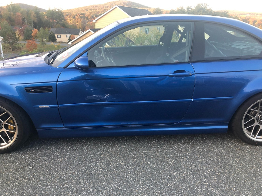

                            What a track Club Motorsports is! I'm definitely planning on making it out to events this summer, so say hi if you see the car. I have a bit of an issue to deal with first though:
                            Click image for larger version  Name:	2.jpg Views:	0 Size:	606.0 KB ID:	99114
                            Click image for larger version  Name:	1.jpg Views:	0 Size:	116.5 KB ID:	99115
                            That's what I get for street parking I suppose. Should've stayed safe and only driven it on track...
