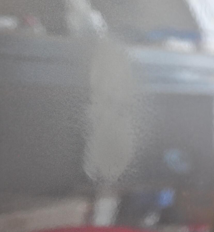

    You can see that the shape of the damage is very vertical and narrow. So, I rolled up the sandpaper to match the shape

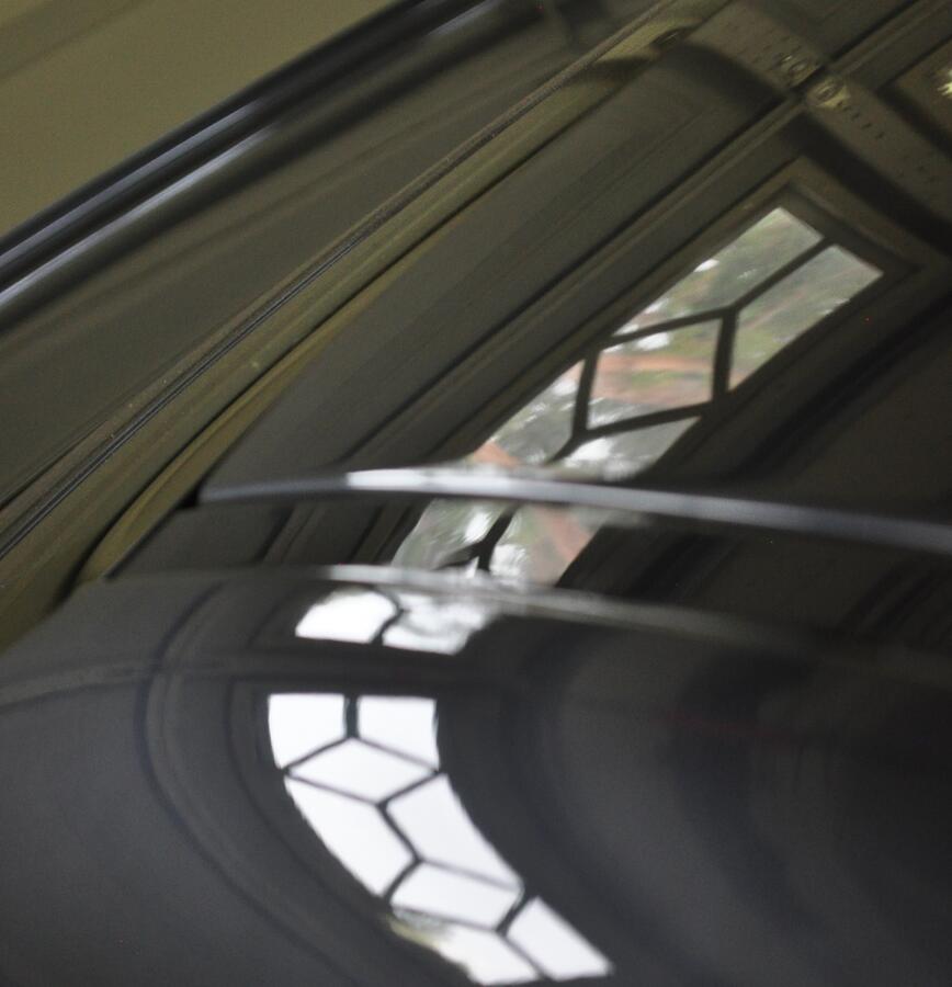

    Again, hard to see in a picture vs. real life, but if is definitely smoother and less egregious. Orange peel doesn't look as "disturbed," but also not too flattened either, which can happen if you remove too much clear with sanding.

    Further back, more realistic view - can't even see anything at this distance.

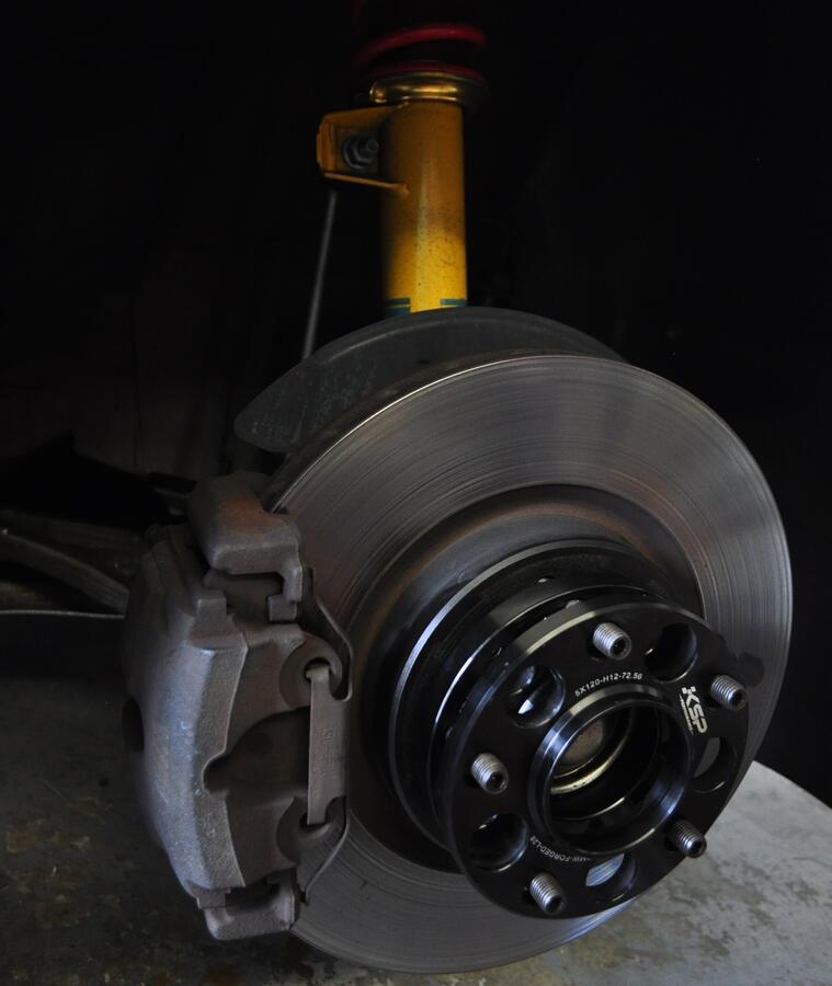

    Decided to go from 12mm spacers up front to 15mm. Not a huge difference, but these stock wheels need all the help they can get. I don't like using spacer, but I also don't like the stock wheel look, so 15mm is my compromise - won't go to 18mm or 20. Pictured is the old 12mm (KSP - really nice), 15mm is behind it. I tried to put the 12mm in back, but with the fat 255/40 tire on 9" rim, it rubs, so went back to 10mm which is fine - only really wanted more "poke" up front.
    Pretty decent poke

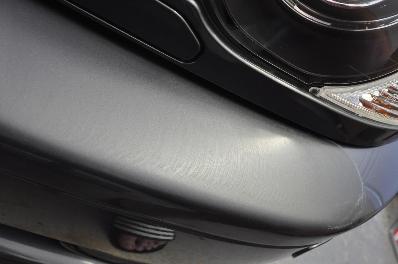

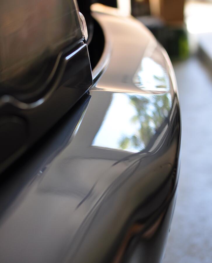

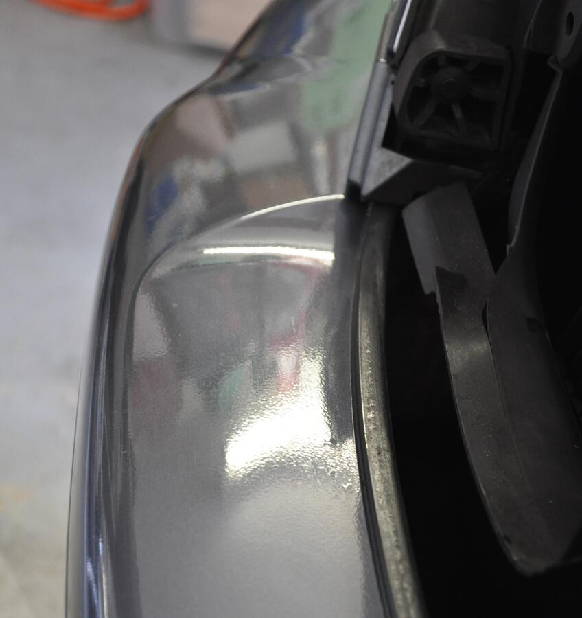

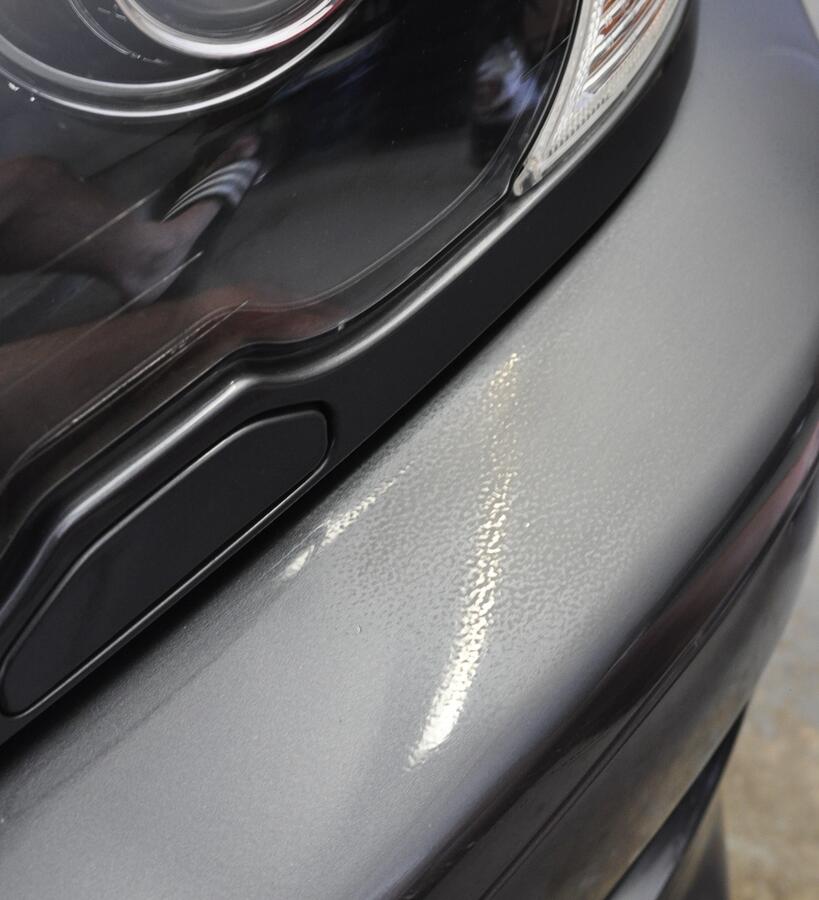

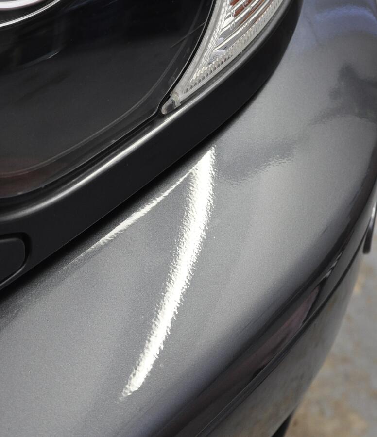

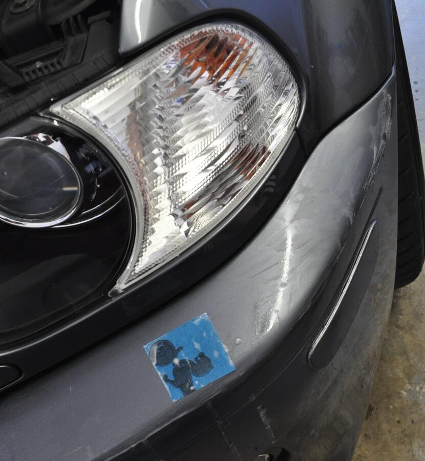

      More wet sanding. Front bumper is also a poorly finished respray.
      Examples of orange peel:
      IIRC, I used 2k grit, but not much pressure.

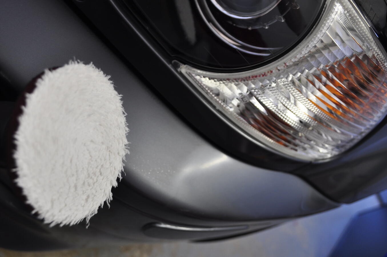

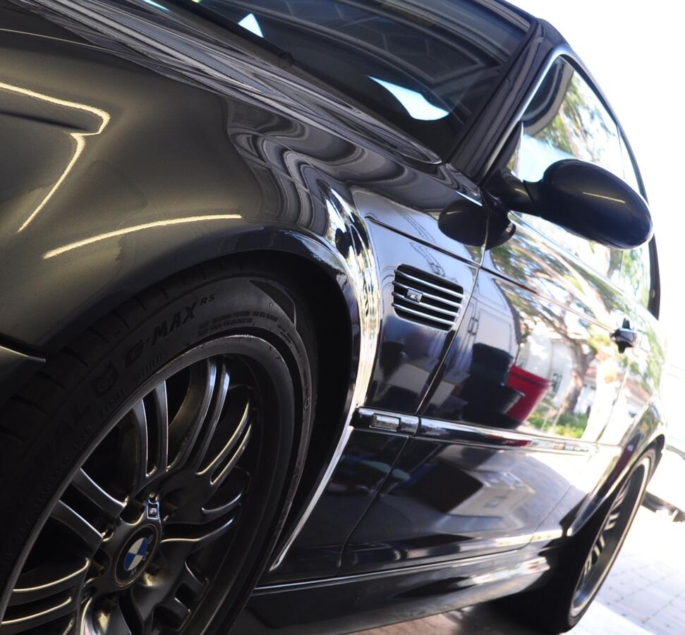

      3" Meg's MF pad on forced rotation using Griot's fast correcting cream
ID:	135660 Click image for larger version
      All done

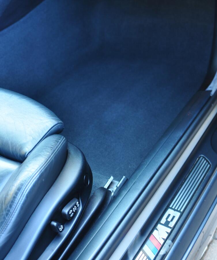

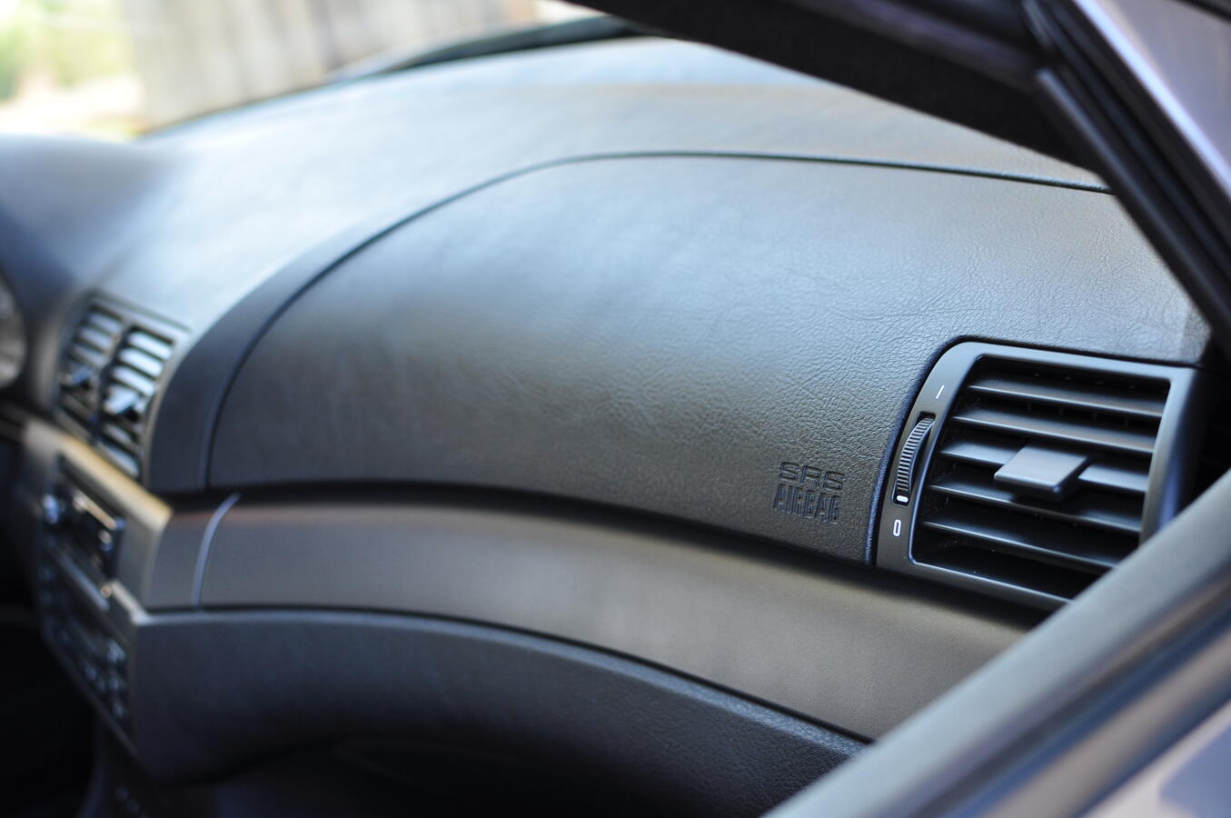

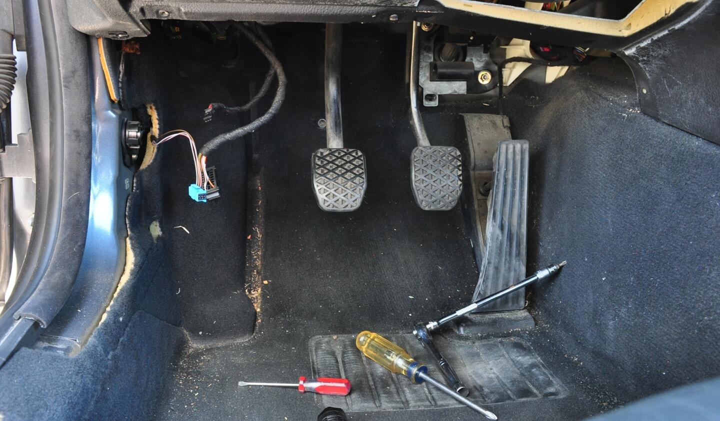

          Want to post some more progress of the interior. I haven't changed too much yet, just more and more cleaning.
          While installing audio cables, I cleaned the driver footwell/pedal area and trims
ID:	136165 Click image for larger version
ID:	136162 Click image for larger version

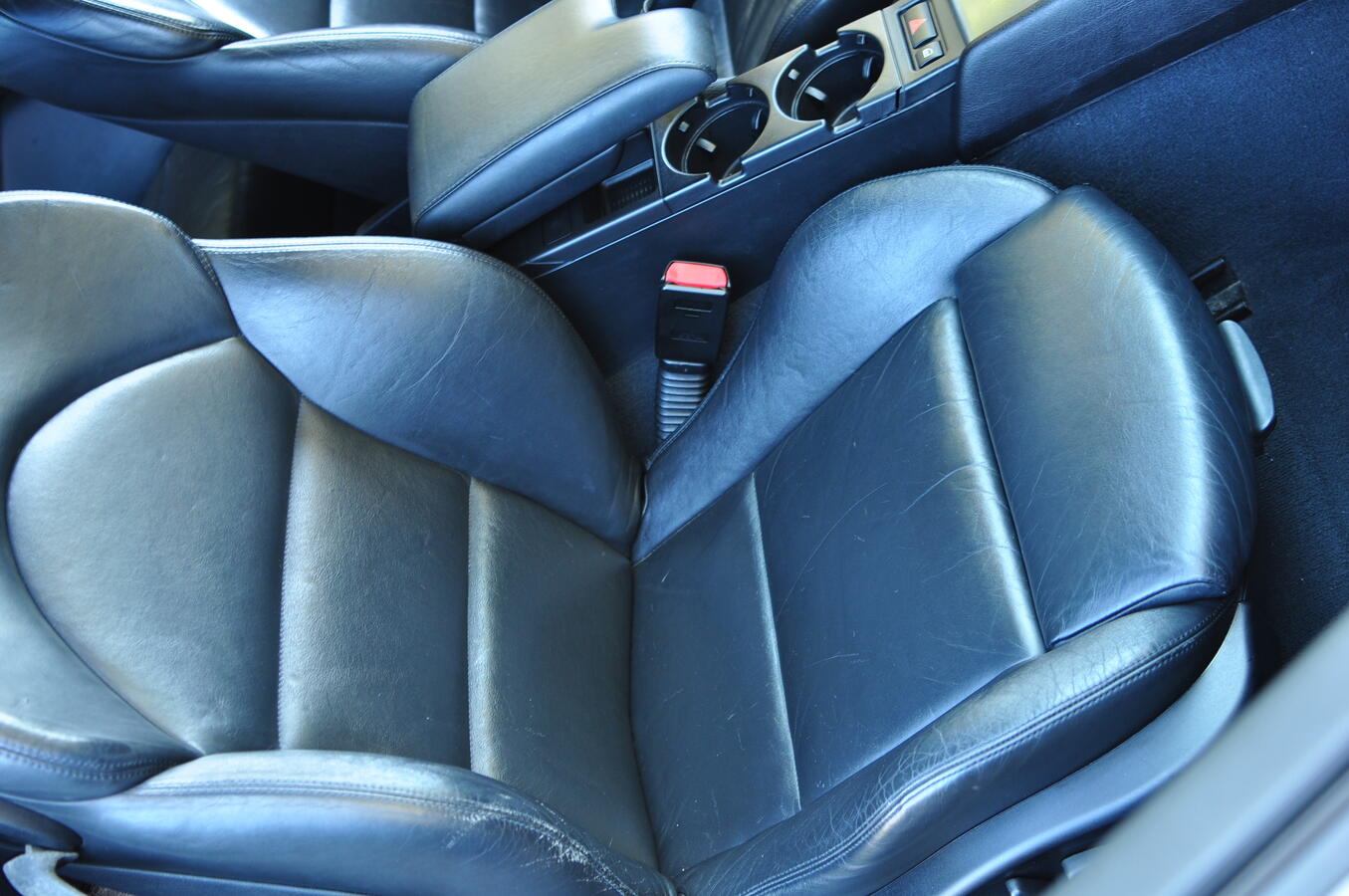

          Seats are in fair condition. I cleaned them well enough, but am not going to take it any further as I'm actually going to be installing a whole interior from a lower mileage car in the not too distant future (still black).
ID:	136176 Click image for larger version

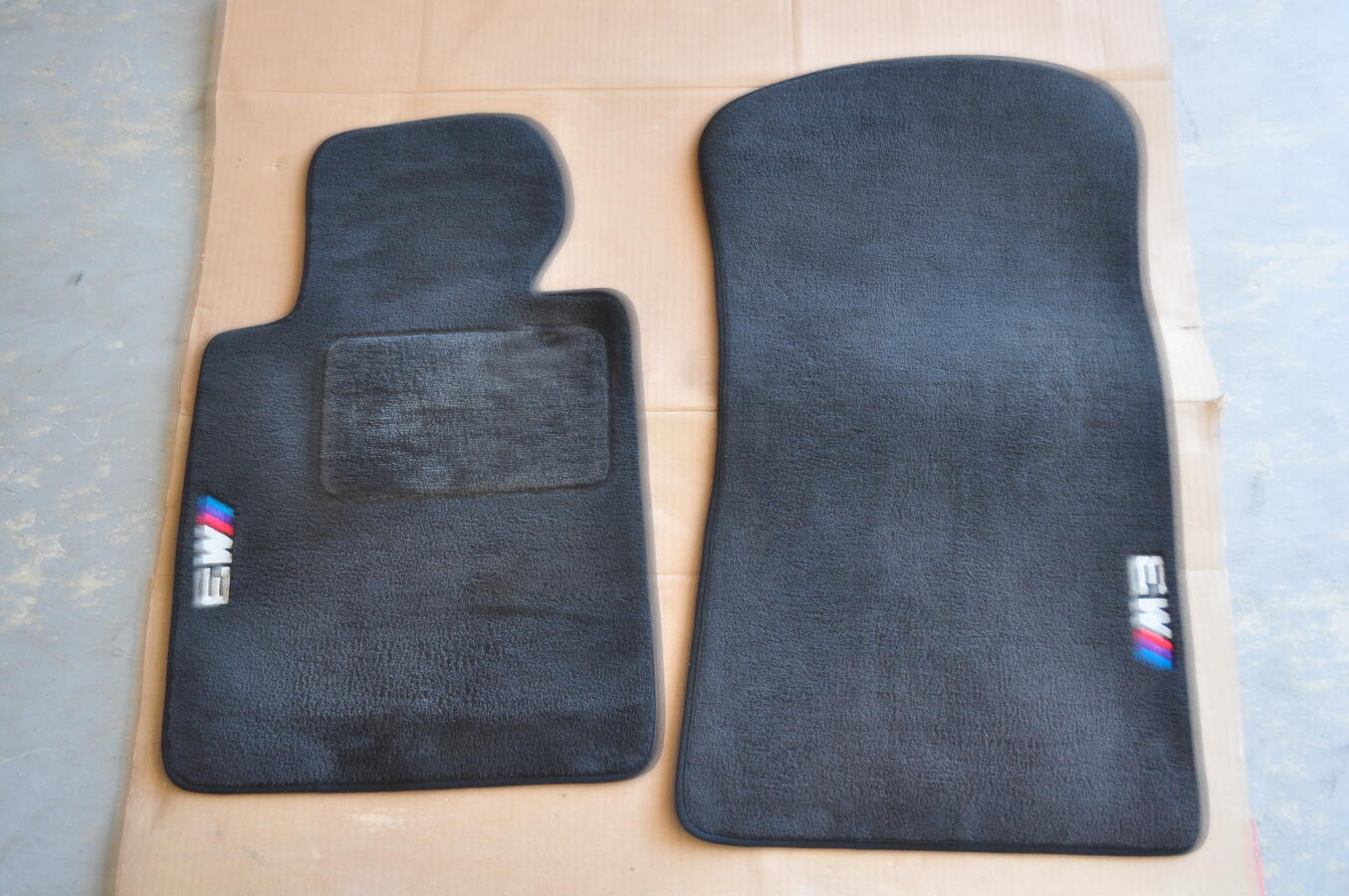

          After cleaning the mats, I actually received a better condition front pair from a friend, oh well! I'll replace those and then the interior will be done until I swap out the seats and door cards.

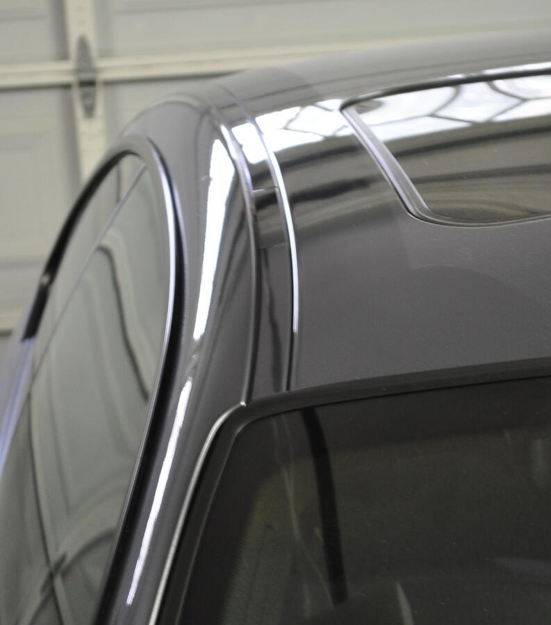

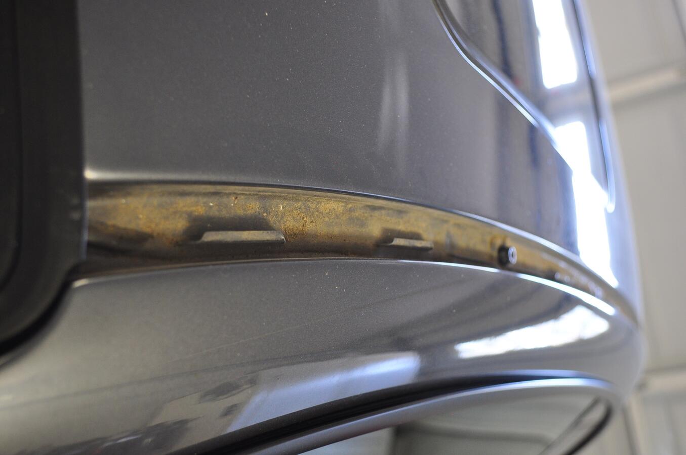

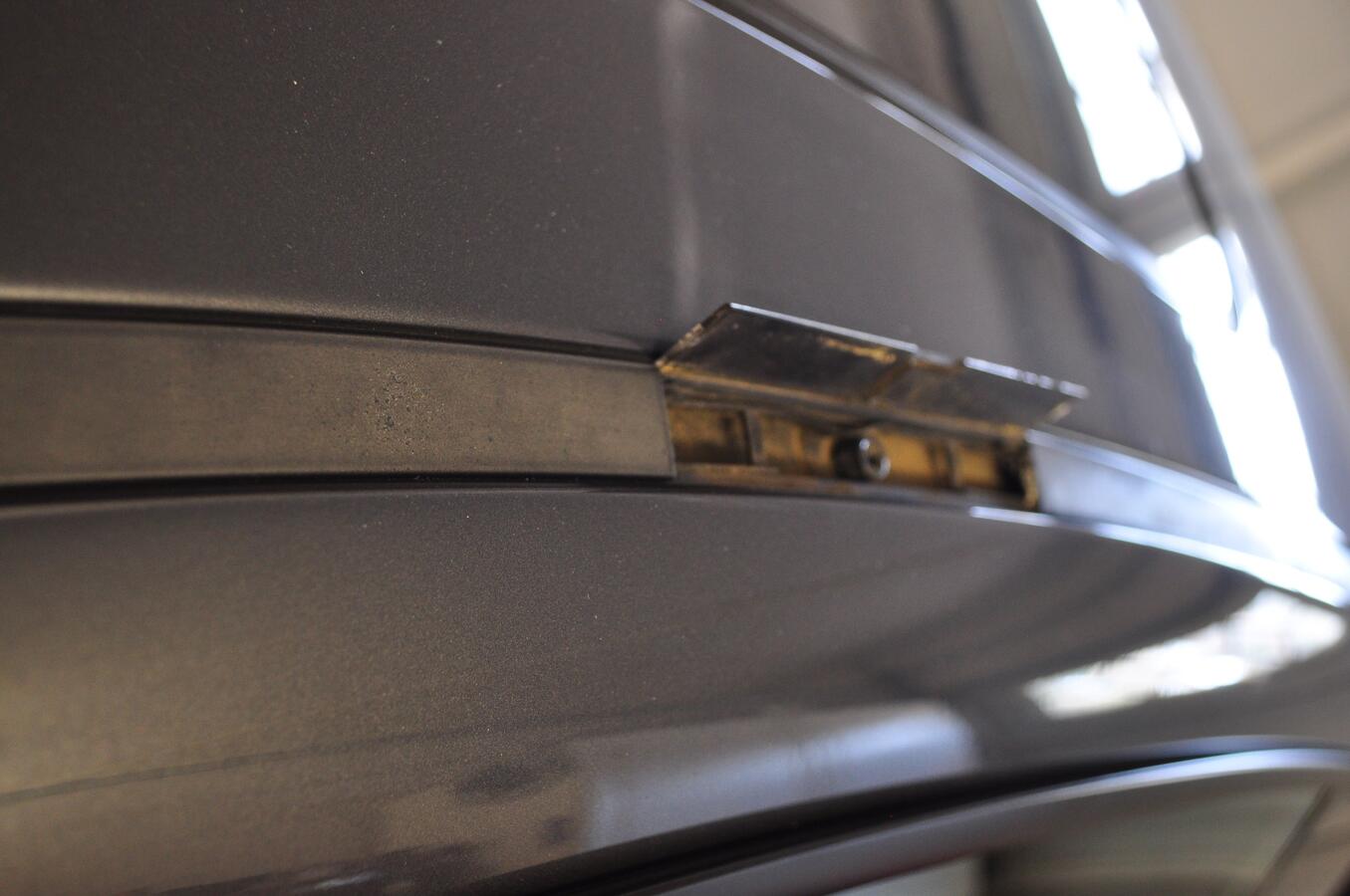

            Repainted Roof Rails
            Luckily, none of the original paint on the body panels has any clear coat failure, but the roof rails certainly do, and not so little that I could just polish it finely to make it passable. At least they can be removed easily and repainted without much fuss.
            Click image for larger version  Name:	roofrails01.JPG Views:	0 Size:	80.9 KB ID:	137435
            Click image for larger version  Name:	roofrails02.JPG Views:	0 Size:	95.3 KB ID:	137436

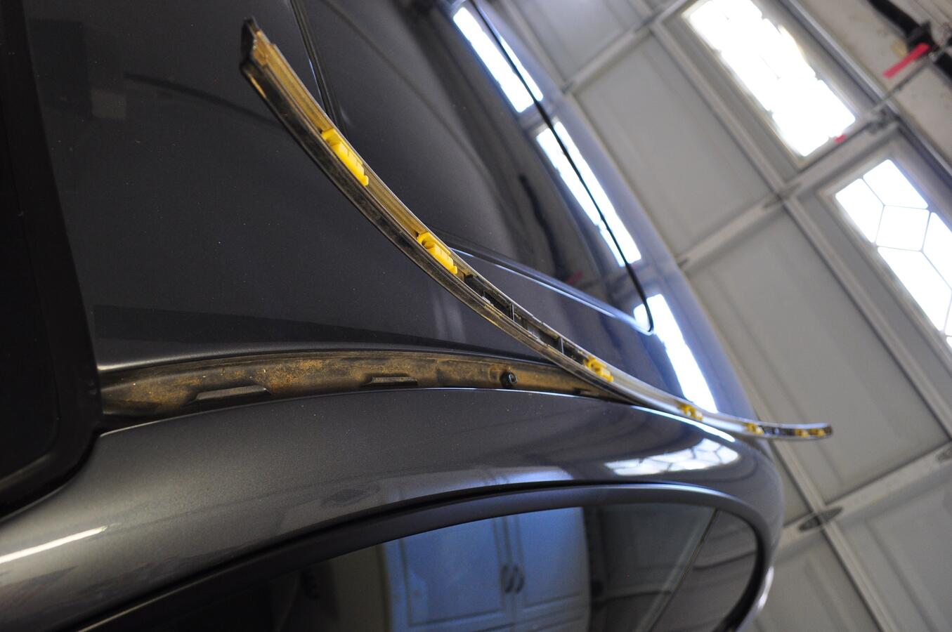

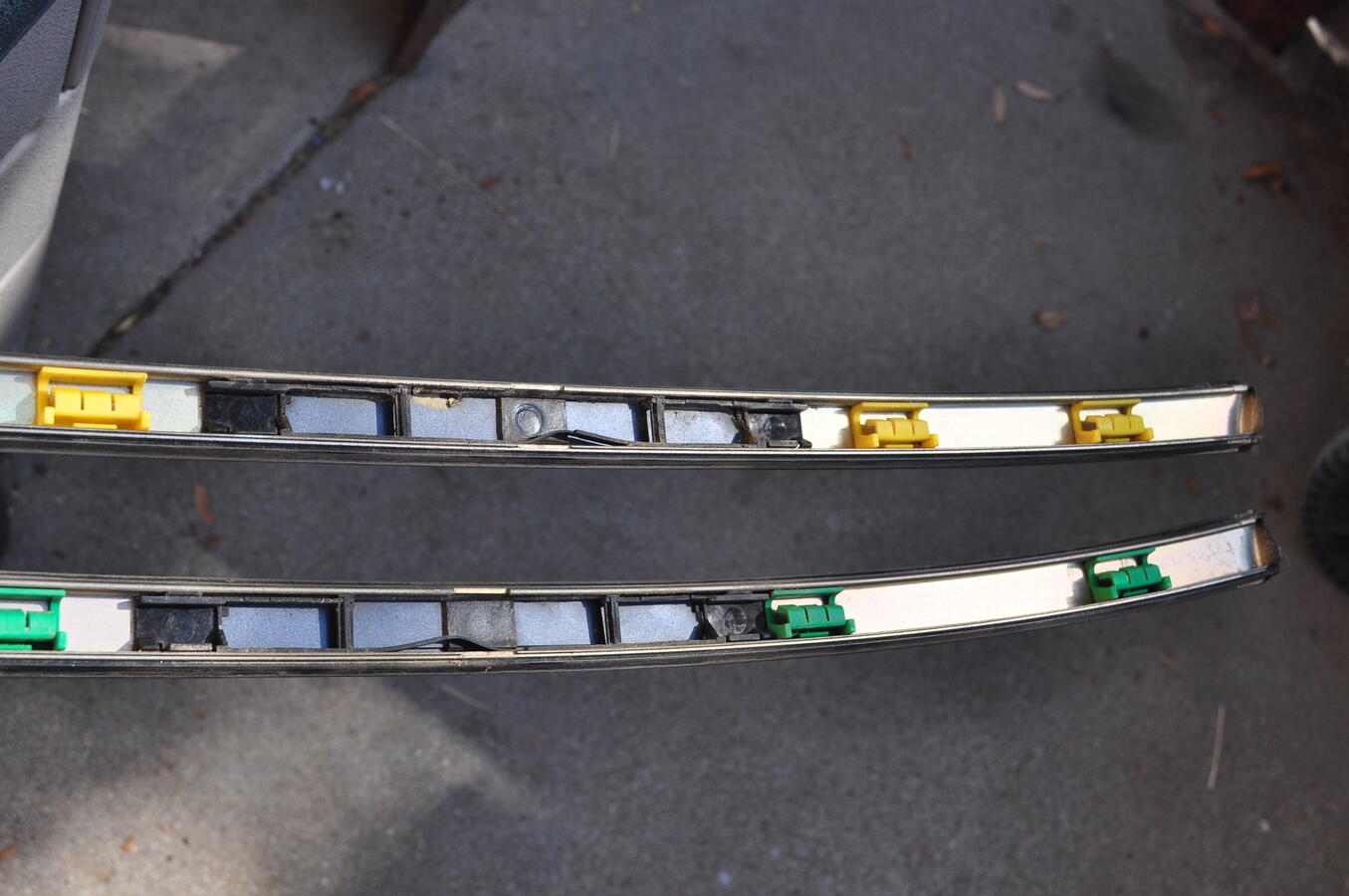

            They just pry up. I used a small flat head to get started
            Click image for larger version  Name:	roofrails03.JPG Views:	0 Size:	72.2 KB ID:	137434 Click image for larger version  Name:	roofrails04.JPG Views:	0 Size:	94.6 KB ID:	137433
            Another newly exposed area shows the level of dirt I've had to deal with on this car.
            Click image for larger version  Name:	roofrails05.JPG Views:	0 Size:	80.6 KB ID:	137437
            And dead bugs to boot
            Click image for larger version  Name:	roofrails06.JPG Views:	0 Size:	100.0 KB ID:	137440

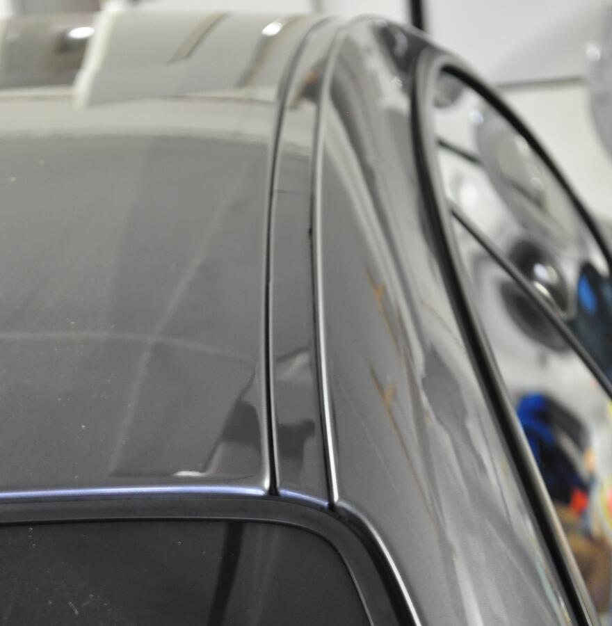

            Cleaned up:
            Click image for larger version  Name:	roofrails07.JPG Views:	0 Size:	69.7 KB ID:	137438
            Click image for larger version  Name:	roofrails08.JPG Views:	0 Size:	67.2 KB ID:	137439
            Nothing broken luckily, and not too dirty here.
            Click image for larger version  Name:	roofrails09.JPG Views:	0 Size:	105.5 KB ID:	137442
            Hosed them off, then applied protectant to rejuvenate while I prepare the surface to be painted
            Click image for larger version  Name:	roofrails10.JPG Views:	0 Size:	183.4 KB ID:	137444
            Well worn
            Click image for larger version  Name:	roofrails11.JPG Views:	0 Size:	98.5 KB ID:	137441

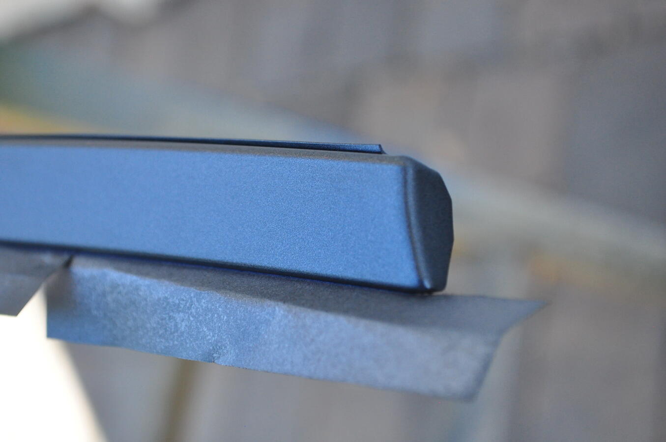

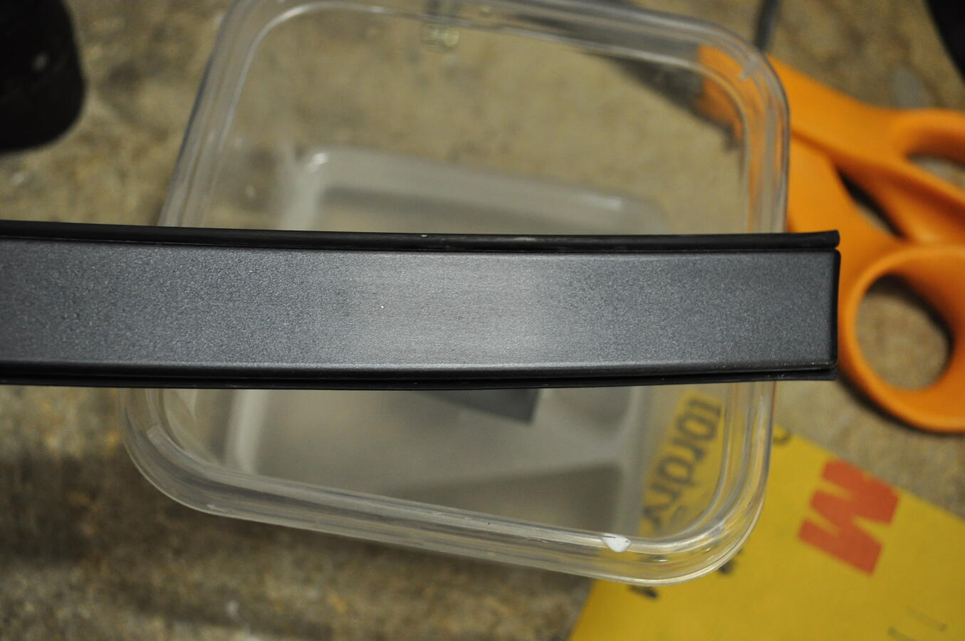

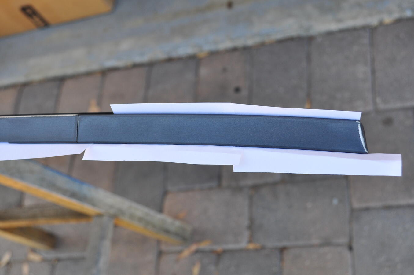

            Sanded them down. Rather than try to remove and possibly hurt the rubber, I tried blocking it off with paper. It sort of worked, but some of the pieces ended up falling out. No biggie, the paint is easily chipped off the rubber at the end.
            Click image for larger version  Name:	roofrails12.JPG Views:	0 Size:	64.2 KB ID:	137443

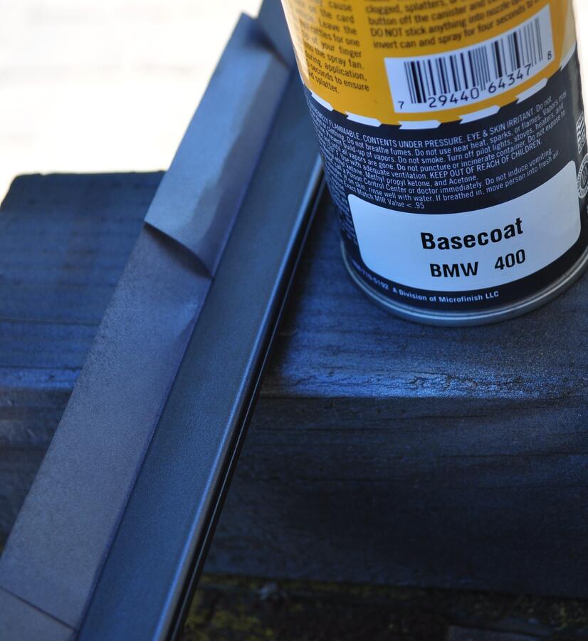

            I bought a rattlecan of steelgrey 400 from automotivetouchup.com. *I should have used primer. It ended up fine, but I did a couple extra coats of base and actually used up the whole can on the 2 trim pieces.
            Click image for larger version  Name:	roofrails13.JPG Views:	0 Size:	78.7 KB ID:	137445
            Click image for larger version  Name:	roofrails14.JPG Views:	0 Size:	66.3 KB ID:	137447
            Then I used 1k clear which is decent enough for this small job vs. 2k. Plus I don't have professional equip/vent
            Click image for larger version  Name:	roofrails15.JPG Views:	0 Size:	74.3 KB ID:	137446
            So metallic in the sun!
            Click image for larger version  Name:	roofrails16.JPG Views:	0 Size:	181.5 KB ID:	137448

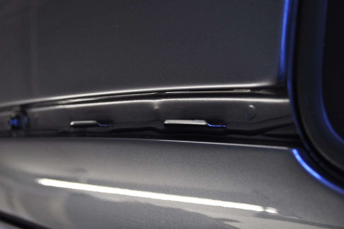

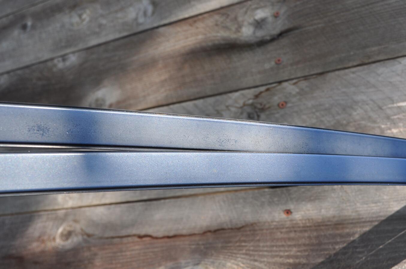

            After drying, before finishing, I wanted to see the color/metallic match
            Click image for larger version  Name:	roofrails17.JPG Views:	0 Size:	50.2 KB ID:	137449
            Pretty darned good! A hair darker, but not much. I *think* using primer might have resulted in a slightly better match. Another:
            Click image for larger version  Name:	roofrails18.JPG Views:	0 Size:	47.4 KB ID:	137450

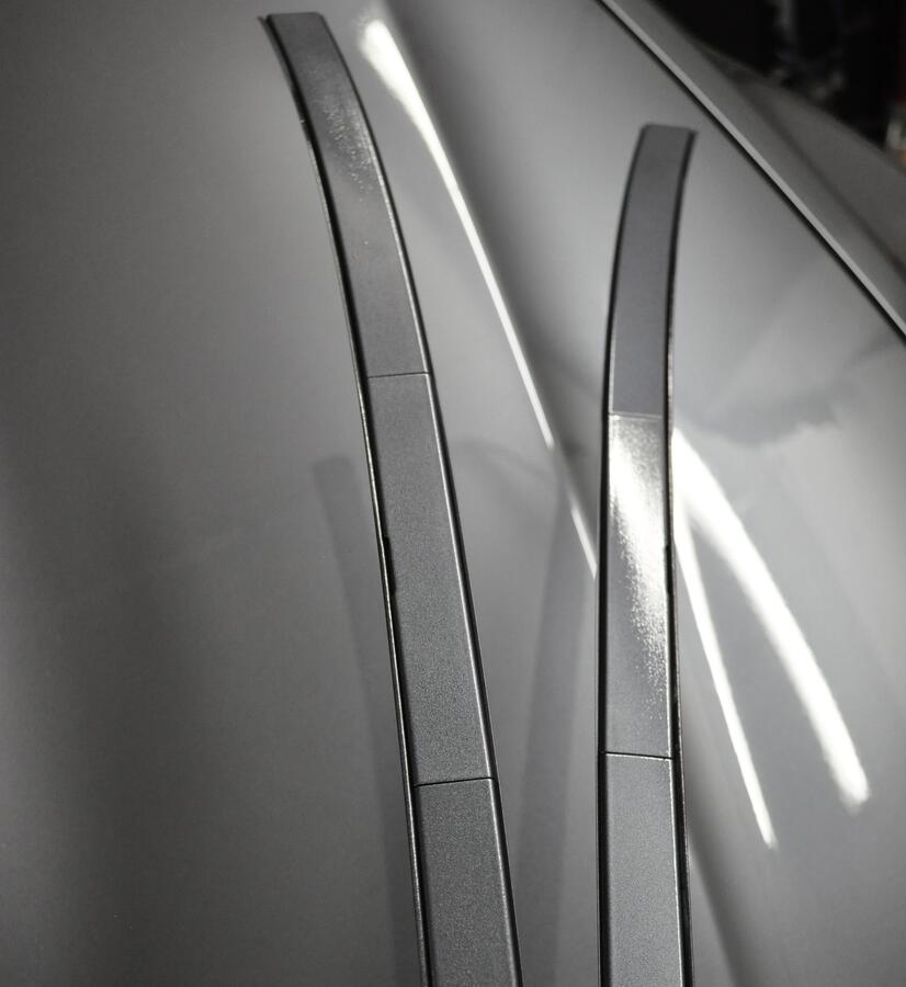

            Ok time to color sand and buff. Used 2.5k. In hindsight, I should have done one more coat of clear to give myself a little more wiggle room. I took it easy on the sanding, and it worked out.
            Click image for larger version  Name:	roofrails19.JPG Views:	0 Size:	120.1 KB ID:	137451
            Click image for larger version  Name:	roofrails20.JPG Views:	0 Size:	105.6 KB ID:	137452
            Now to buff and restore clarity. A little compound first
            Click image for larger version  Name:	roofrails21.JPG Views:	0 Size:	138.2 KB ID:	137455
            Now polished
            Click image for larger version  Name:	roofrails22.JPG Views:	0 Size:	104.6 KB ID:	137456
            Click image for larger version  Name:	roofrails23.JPG Views:	0 Size:	38.9 KB ID:	137453
            Ok, time to reinstall (step 1: push down. step 2, there is no step 2 )
            Click image for larger version  Name:	roofrails24.JPG Views:	0 Size:	58.4 KB ID:	137454
            Click image for larger version  Name:	roofrails25.JPG Views:	0 Size:	74.3 KB ID:	137459
            Click image for larger version  Name:	roofrails26.JPG Views:	0 Size:	40.2 KB ID:	137457
            Click image for larger version  Name:	roofrails27.JPG Views:	0 Size:	45.3 KB ID:	137458
            Click image for larger version  Name:	roofrails28.JPG Views:	0 Size:	51.8 KB ID:	137461
            Click image for larger version  Name:	roofrails29.JPG Views:	0 Size:	48.2 KB ID:	137460
            I'm really pleased with this. The faded roof rails were really killing the car's vibe. Even more than the shit tint, I was dying to get these redone. Spent about $40 in base and clear cans. A big win!

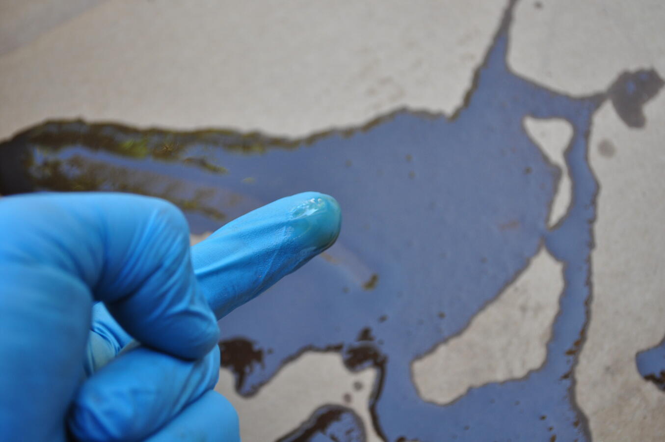

                    I had flushed the tranny with some Liqui-Moly conventional 75w gl4 to clean it out. As I documented, there was a lot of synchros (brass) dust in the, I'm sure, original factory fill. So now I wanted to flush that and put in the "permanent" lube, but it's about impossible to find Pentosin MTF2 anymore. You can buy the OE MTF-LT2 still, but it's pricey. I decided, with FCPeuro warranty returning in mind, to try Pentosin's MTF2 replacement, FFL4.
                    I actually put some in a friend's 6spd a couple of years ago, and it's been working well. FCPeuro had it on sale as well, so here we go...
                    Click image for larger version  Name:	FFL4.1.JPG Views:	0 Size:	80.4 KB ID:	139567
                    The conventional 75w gl4 looked great (only had 2k miles). Happy to not see any synchros bits at all. Now I'm confident the tranny will be fine for years, with fresh fluid and relatively smooth (for the 420g) operation with no lockout or any issues.
                    Click image for larger version  Name:	FFL4.2.JPG Views:	0 Size:	63.2 KB ID:	139569

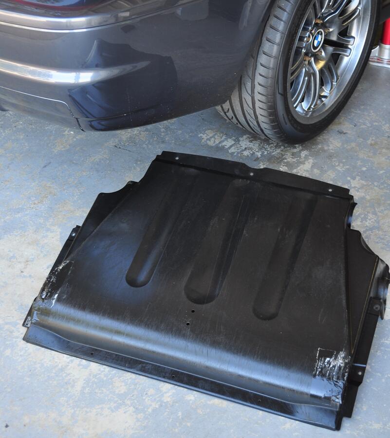

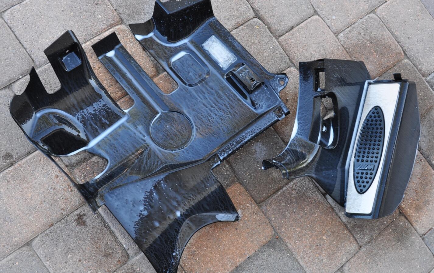

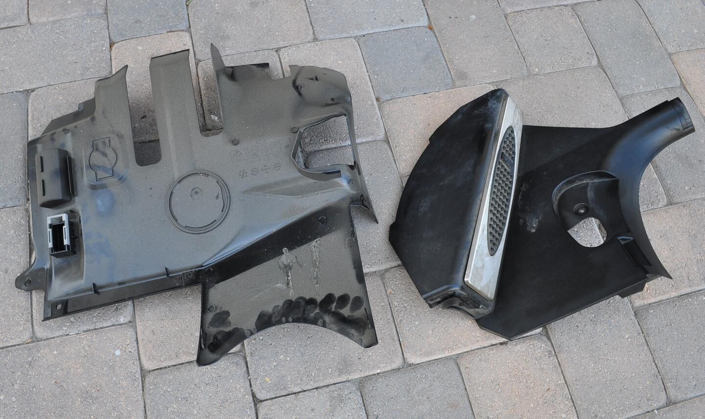

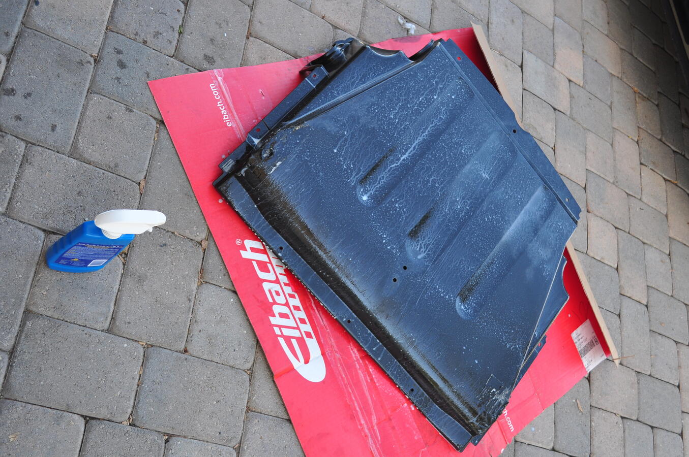

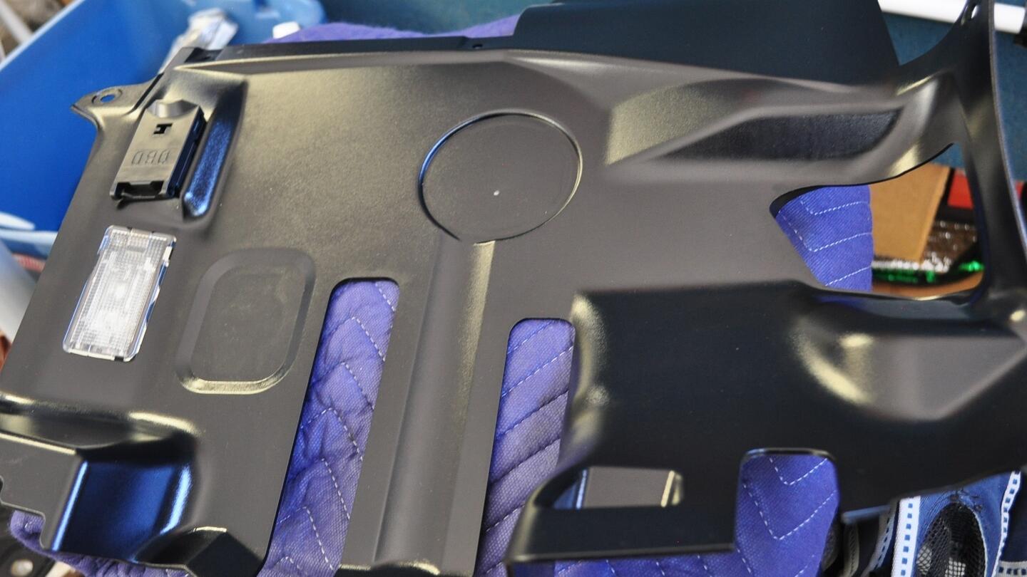

                    While doing this, I had ordered a new belly pan for my other M, so my old one got spruced up and installed on this car now
                    Click image for larger version  Name:	FFL4.3.JPG Views:	0 Size:	223.9 KB ID:	139570 Click image for larger version  Name:	FFL4.4.JPG Views:	0 Size:	86.2 KB ID:	139568
                    All back together. Now there are no more missing/broken pieces!
                    Click image for larger version  Name:	FFL4.5.JPG Views:	0 Size:	52.5 KB ID:	139571

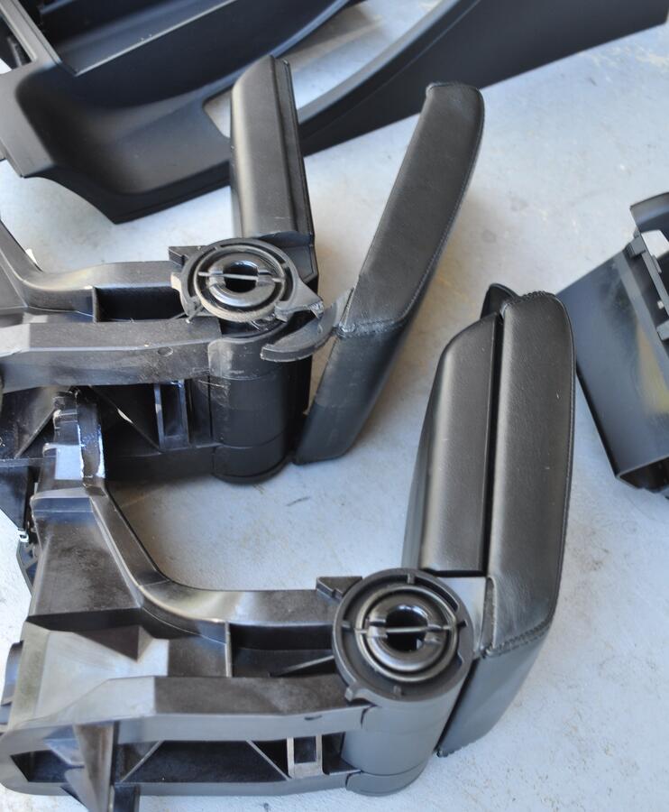

                    The armrest's leather is actually in great condition, but unf, the hinge is broken and not repairable
                    Luckily, my friend had a spare black armrest for me. You must disassemble quite a bit to get it out:
                    Click image for larger version  Name:	Armrest1.JPG Views:	0 Size:	144.0 KB ID:	139574
                    Good to remove the center console anyway as it needed a good cleaning
                    Click image for larger version  Name:	Armrest2.JPG Views:	0 Size:	59.2 KB ID:	139572
                    Here, you can see how it's broken compared to new one (bottom). Console cleaned/treated.
                    Click image for larger version  Name:	Armrest3.JPG Views:	0 Size:	72.6 KB ID:	139573

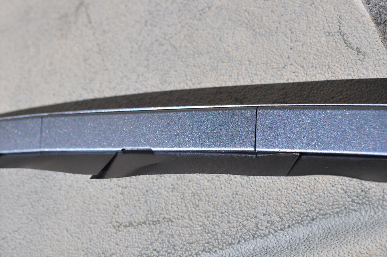

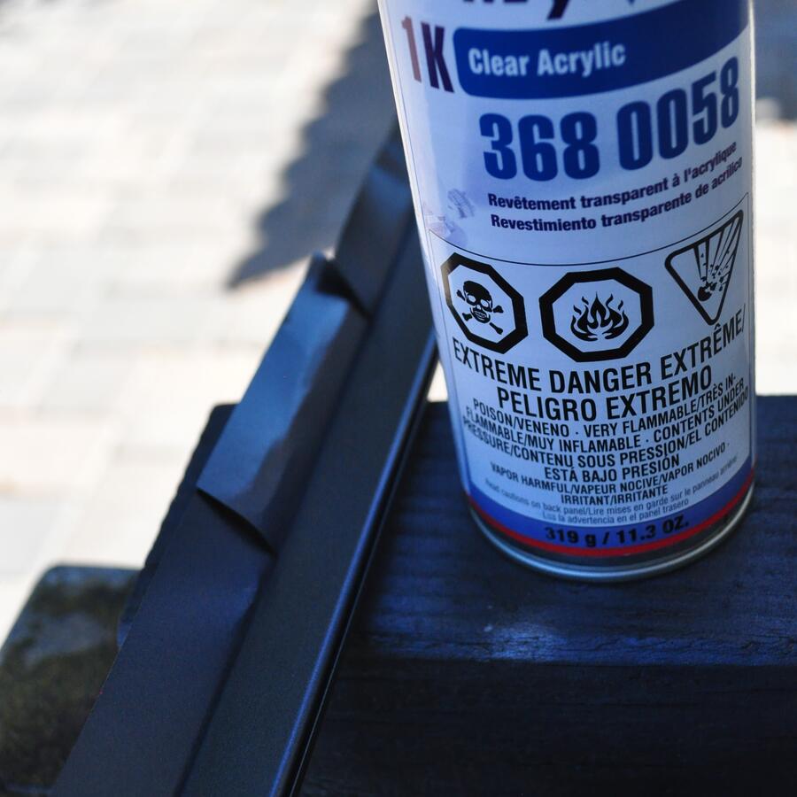

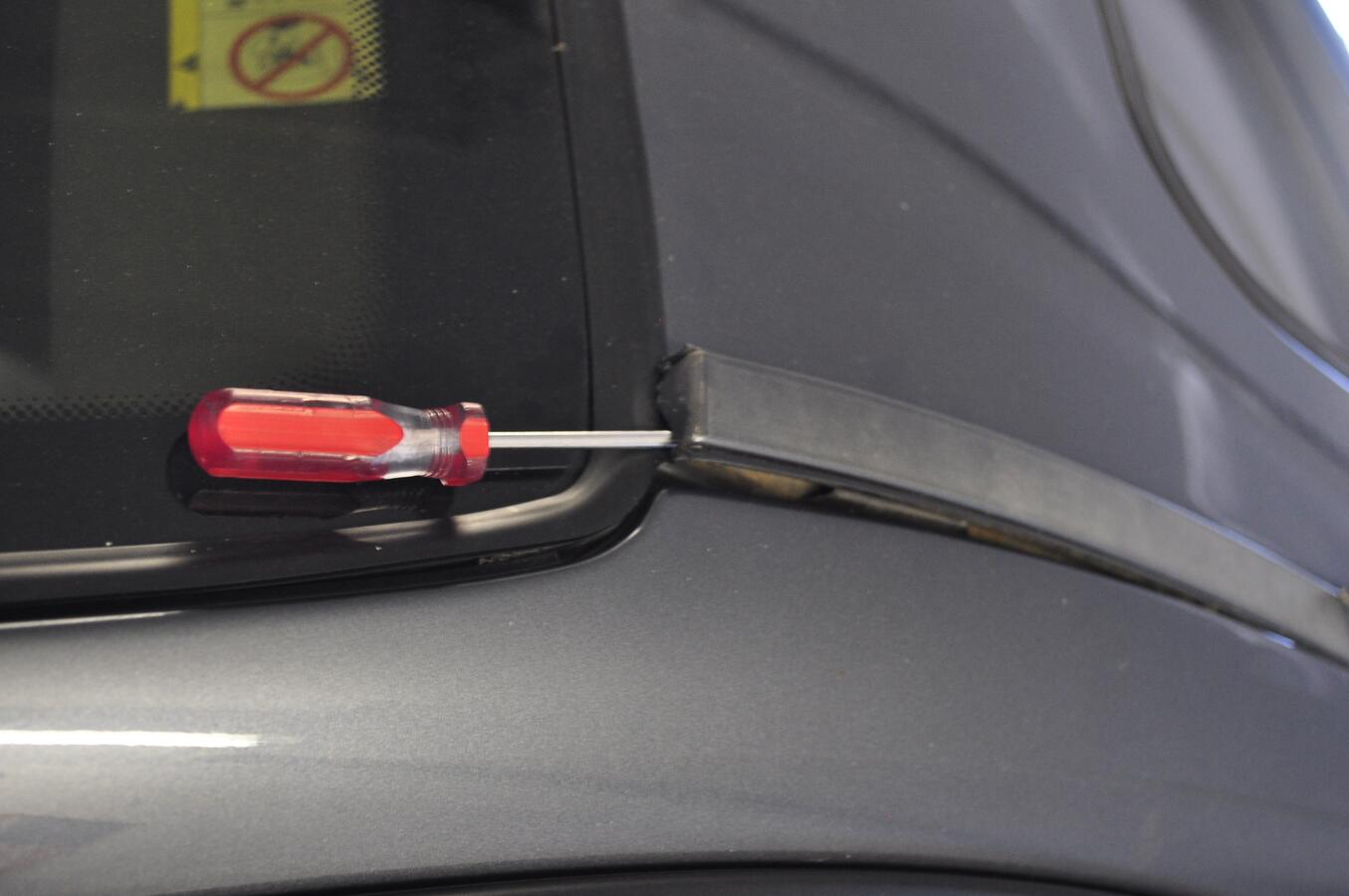

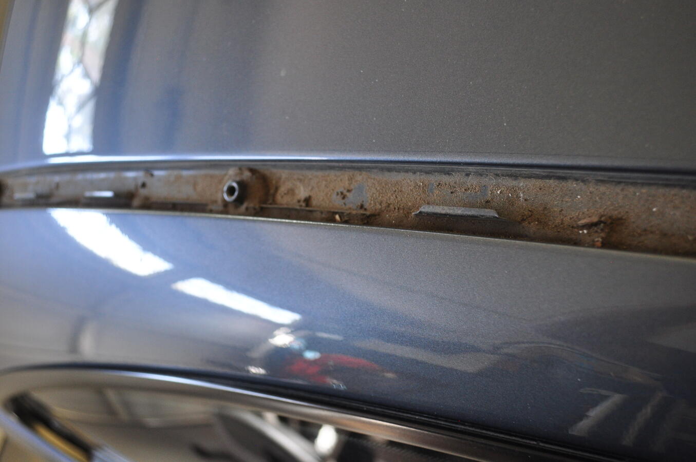

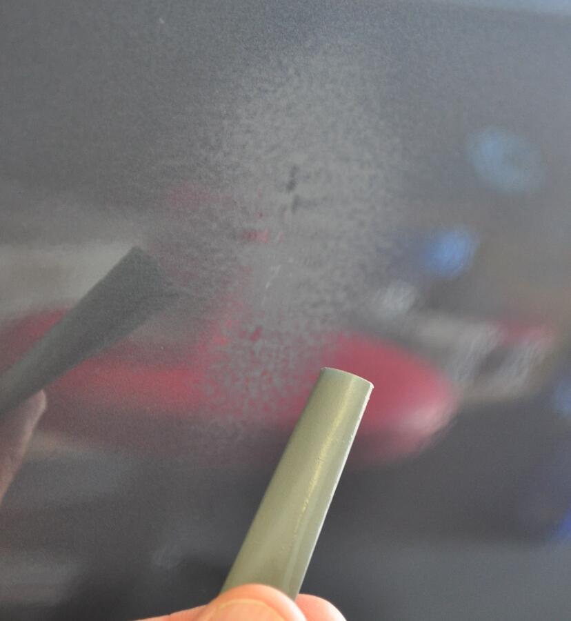

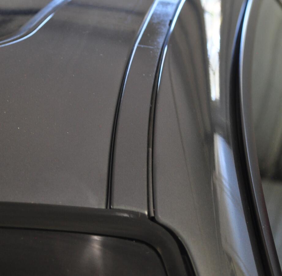

                                Hey, thanks for this quick DIY. My roof rails are the only thing on my car with clear coat peeling and I was wondering if I could just repaint them. Definitely filing this away for the future.
