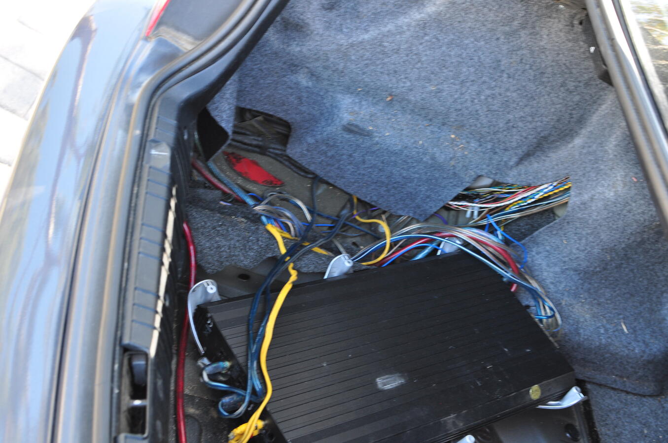

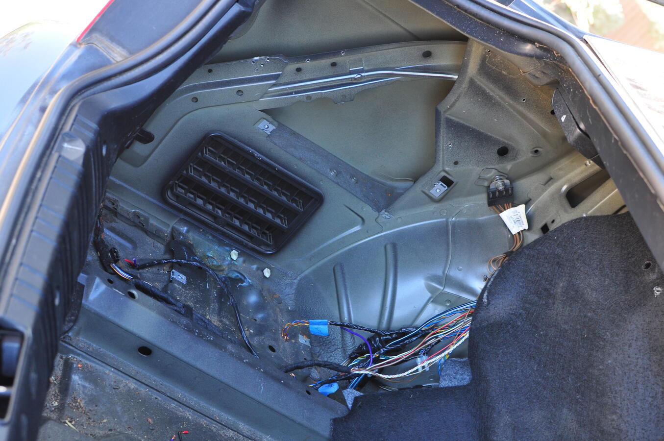

            Then I uninstalled this mess of a sound system:
            Click image for larger version  Name:	SG0223214.JPG Views:	0 Size:	166.0 KB ID:	108966
            Click image for larger version  Name:	SG0223217.JPG Views:	0 Size:	183.6 KB ID:	108967
            I'll clean up the harness later with amp install. Look at this ground they did lol:
            Click image for larger version  Name:	SG0223216.JPG Views:	0 Size:	136.3 KB ID:	108965

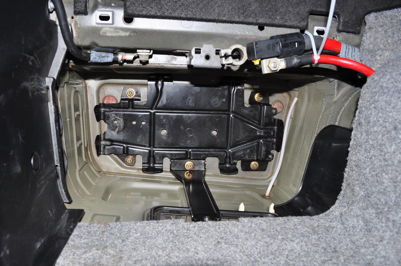

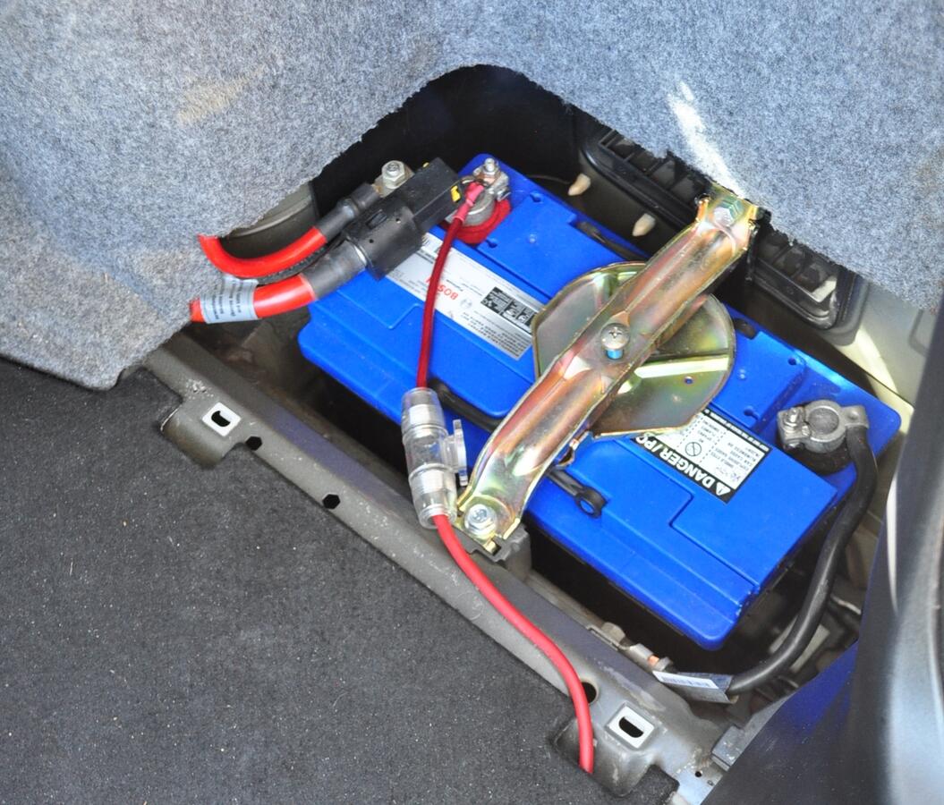

            Found a nice looking oem battery under the sub tho
            Click image for larger version  Name:	20210603_222905.jpg Views:	0 Size:	185.9 KB ID:	108973

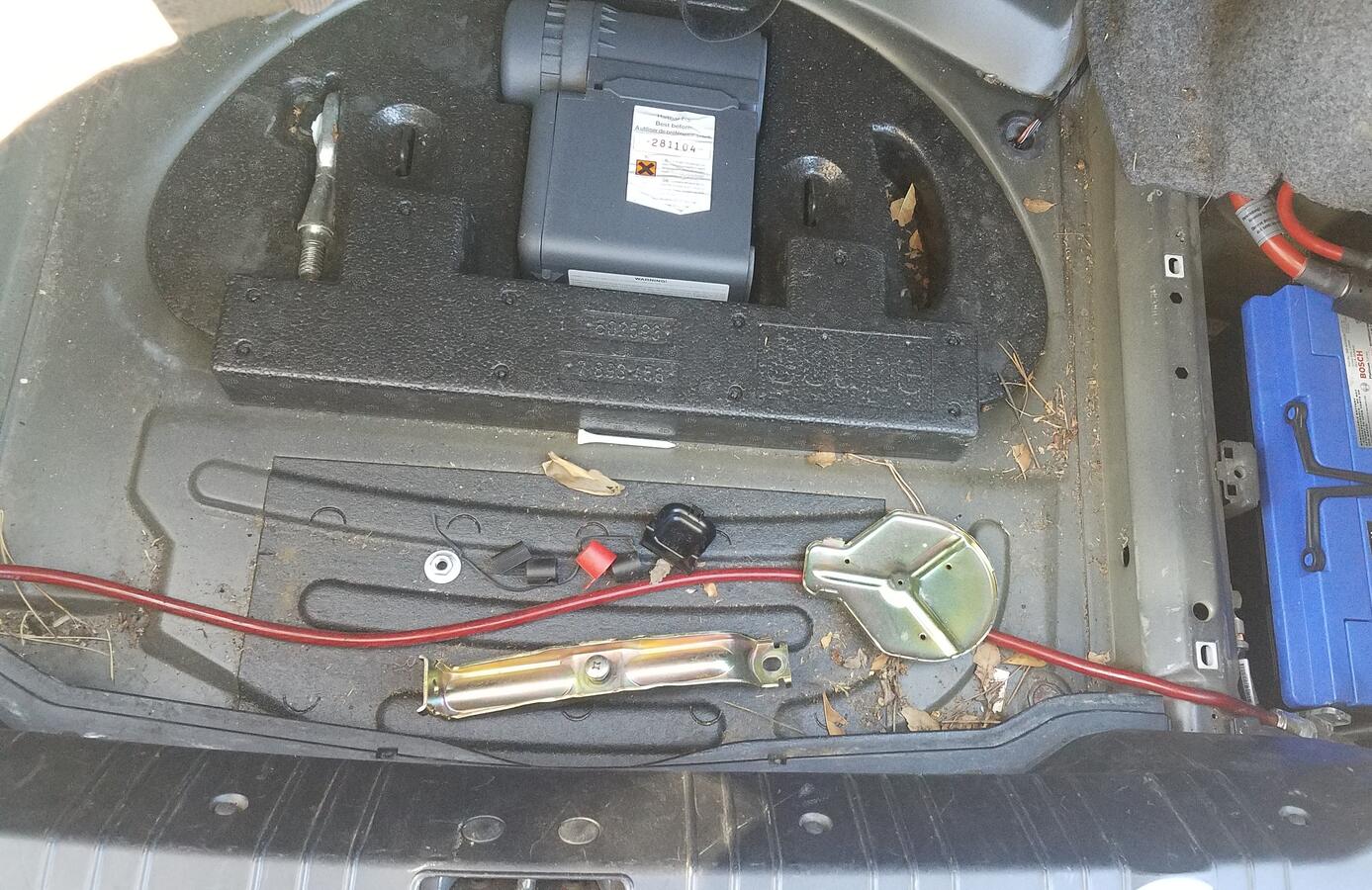

            Oh there's the bracket and more debris
            Click image for larger version  Name:	20210603_222931.jpg Views:	0 Size:	223.7 KB ID:	108974

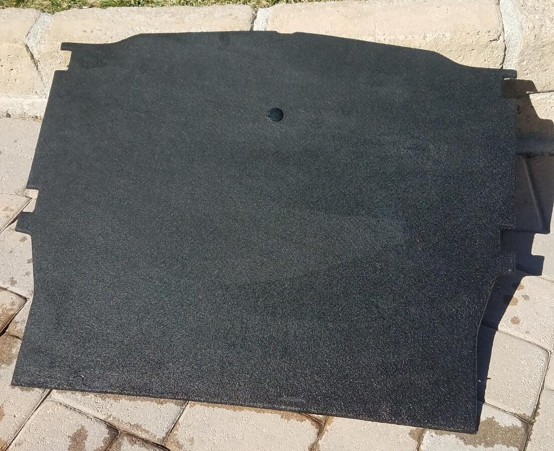

            Cleaned the hardboard
            Click image for larger version  Name:	20210603_223624.jpg Views:	0 Size:	232.8 KB ID:	108977

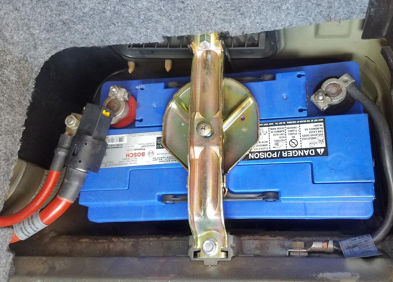

            With new hardware, got the battery secured
            Click image for larger version  Name:	20210603_223703.jpg Views:	0 Size:	185.7 KB ID:	108979

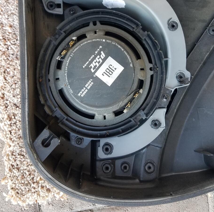

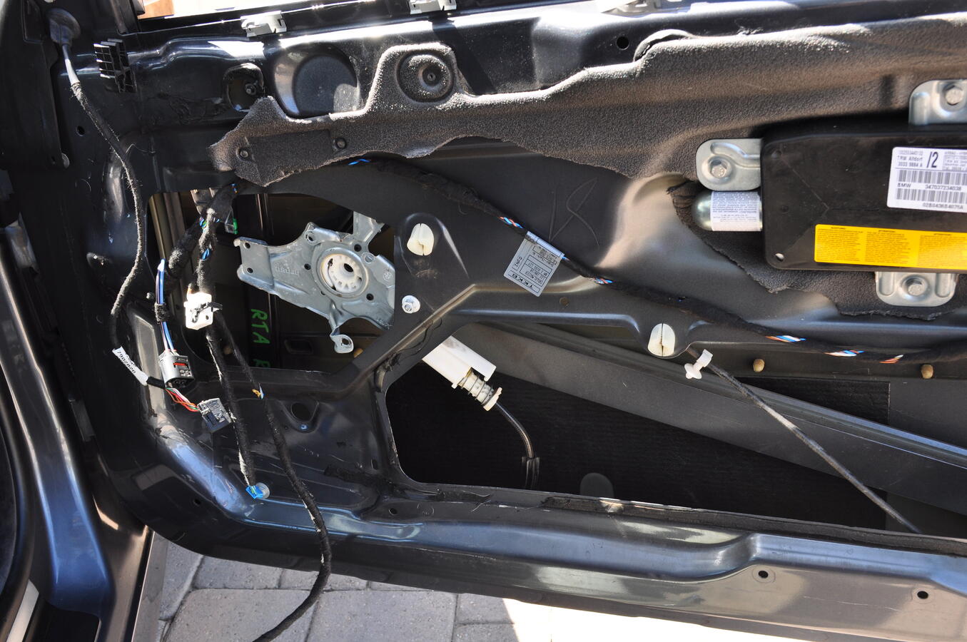

            Pulled passenger door to fix window, they put in some shitty 5.25" coaxials lol
            Click image for larger version  Name:	20210603_223913.jpg Views:	0 Size:	129.0 KB ID:	108976

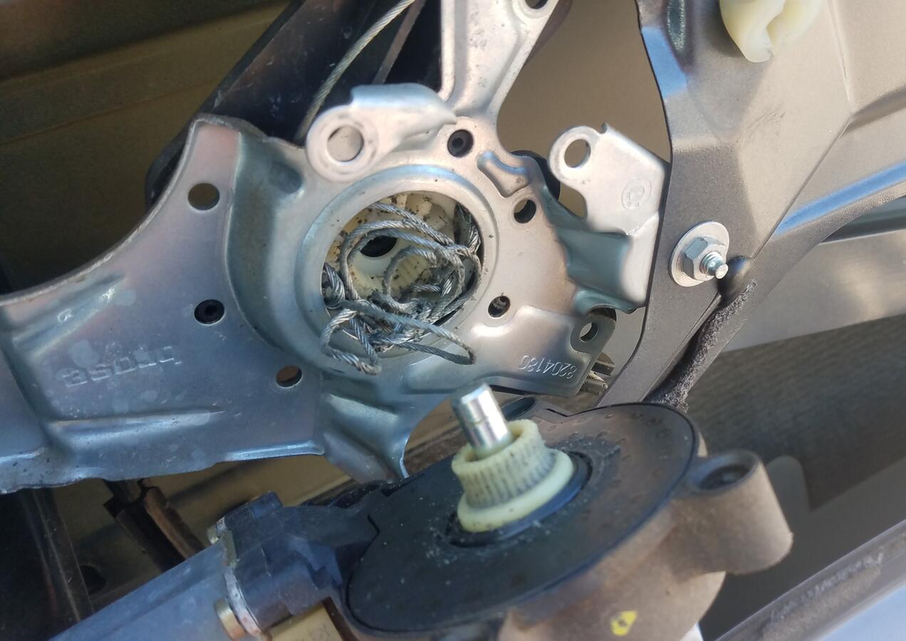

            The window wouldn't move, no wonder:
            Click image for larger version  Name:	20210603_223825.jpg Views:	0 Size:	105.2 KB ID:	108975

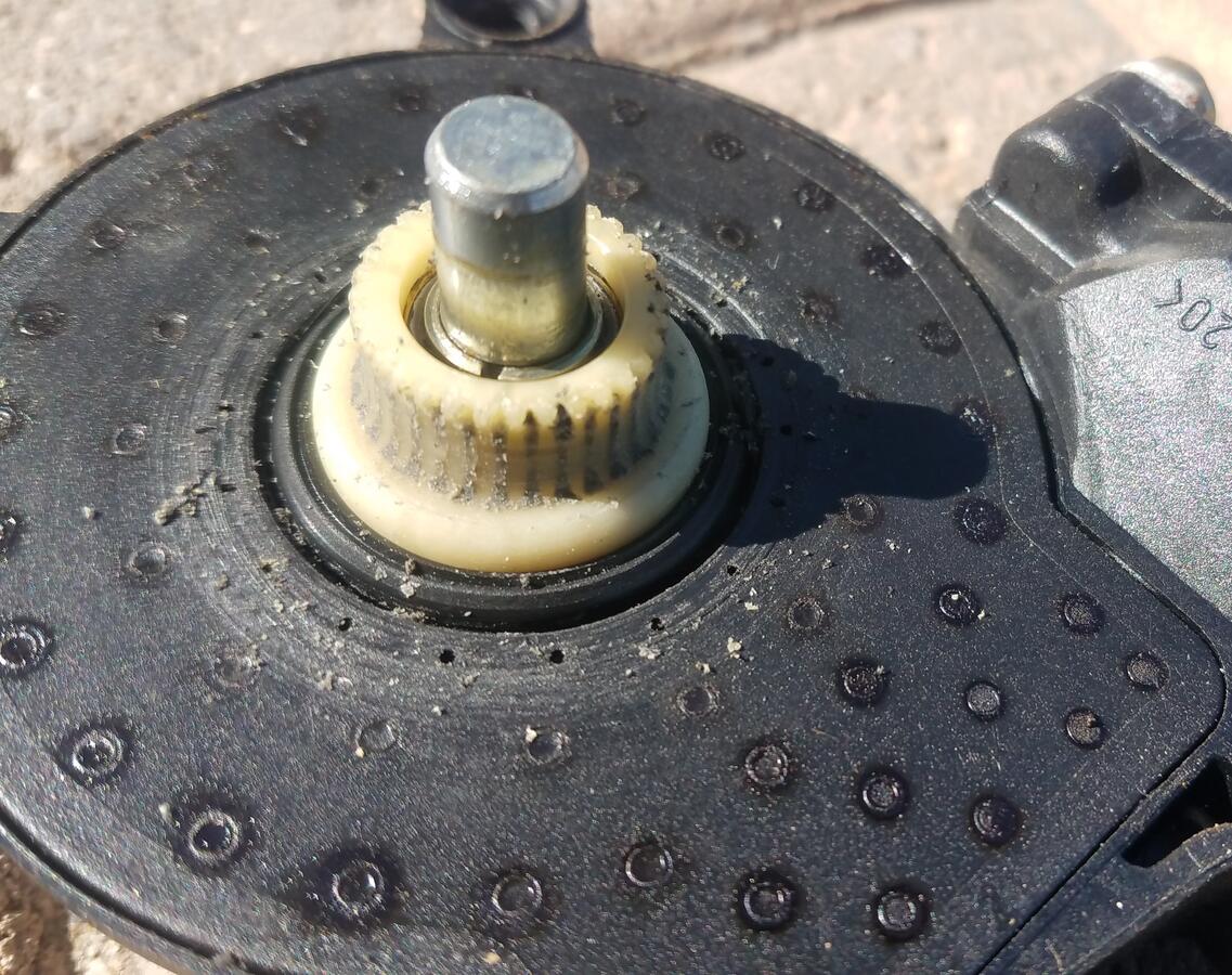

            And the gear wore itself out so I need a motor too
            Click image for larger version  Name:	20210603_223845.jpg Views:	0 Size:	194.5 KB ID:	108978

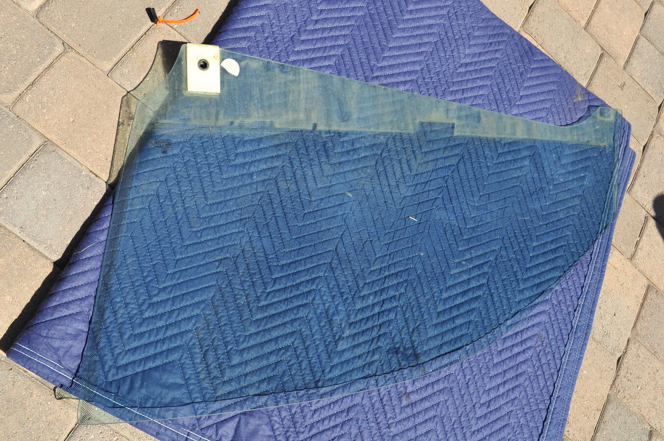

              Got the glass out and put it in the sun so tint just peeled right off

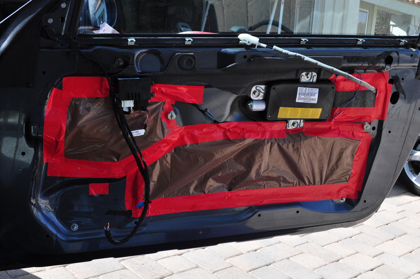

              Replacement regulator with motor. You might notice the vapor barrier missing.
              Click image for larger version  Name:	regulator23.JPG Views:	0 Size:	173.1 KB ID:	108982
              So I sealed it up cheaply. Those thick, reusable plastic shopping bags are useful!
              Click image for larger version  Name:	vaporbarrier02.JPG Views:	0 Size:	154.4 KB ID:	108981

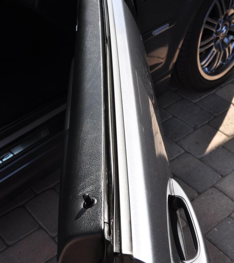

              Installed a new outer door trim to finish. All of the trims need replacement
              Click image for larger version  Name:	20210603_233413.jpg Views:	0 Size:	71.5 KB ID:	108985

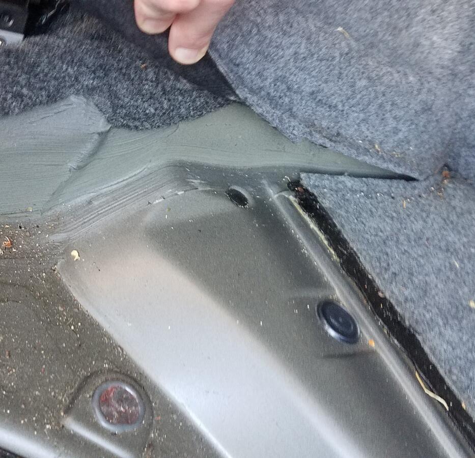

              Checked the areas you might see cracks/separation, in the trunk, and find zero evidence. The same for what's visible underneath. I'm not in a hurry to address the racp (other than add rear strut brace for more rigidity) esp not really driving much anymore with WFH
              Click image for larger version  Name:	20210603_223946.jpg Views:	0 Size:	128.5 KB ID:	108984

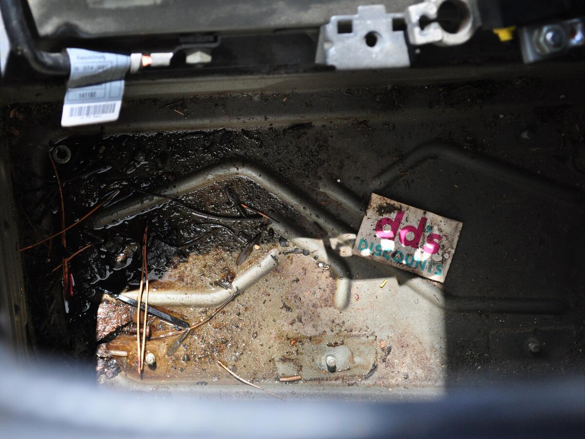

              Went to install stereo power wire, and noticed debris down in battery tray so ended up pulling battery out. Seems like water's getting behind taillight.
              Click image for larger version  Name:	20210603_233750.jpg Views:	0 Size:	143.0 KB ID:	108986
              Cleaned
              Click image for larger version  Name:	regulator24.JPG Views:	0 Size:	181.6 KB ID:	108987

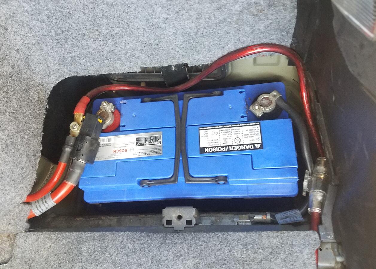

              Power wire/fuse holder installed, and battery back in
              Click image for larger version  Name:	20210603_233940.jpg Views:	0 Size:	159.8 KB ID:	108988

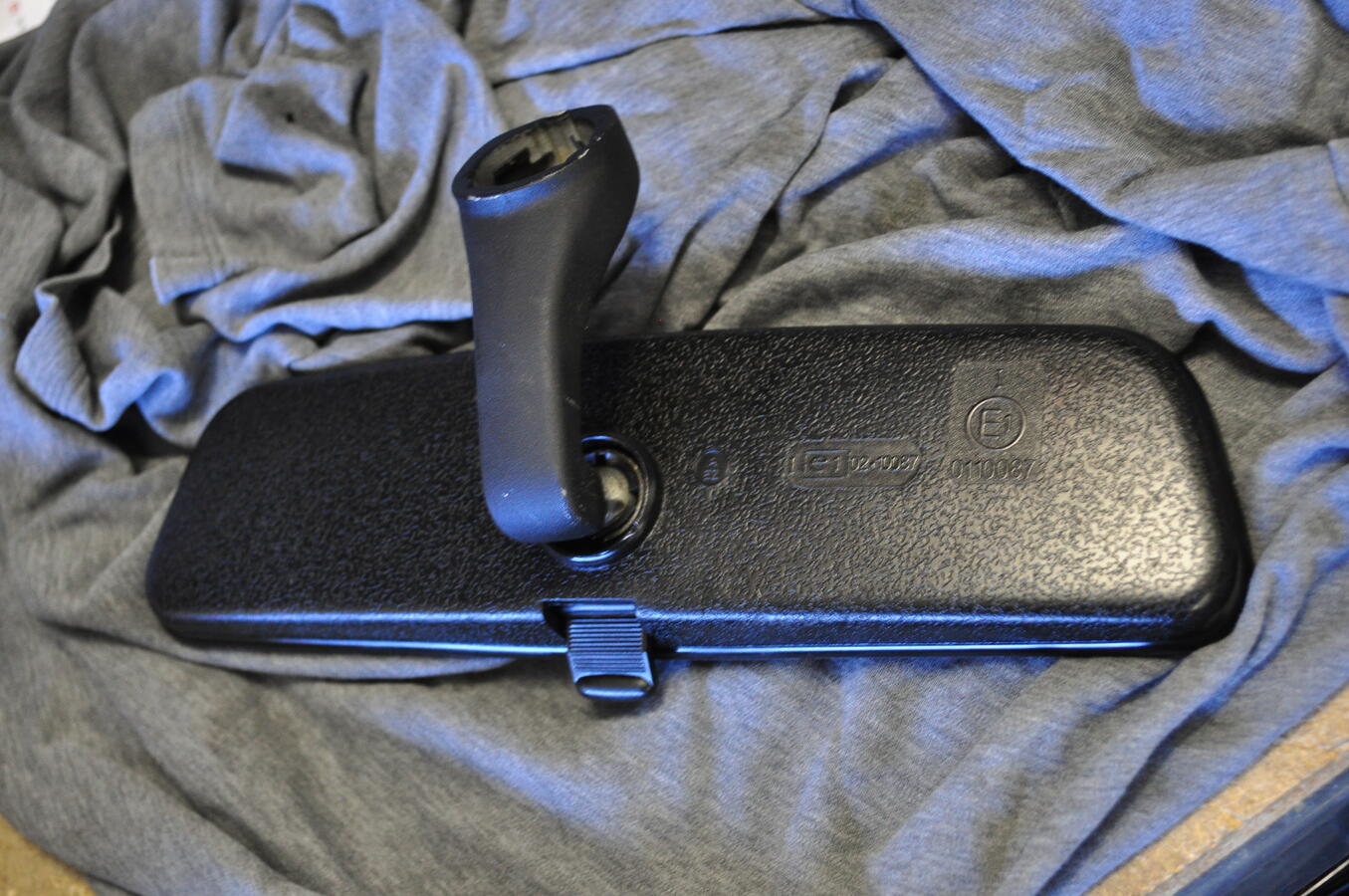

                      Rear view mirror was leaking, so put in an e34/36/38 era one that I have in silvergrey too from my old 325i. Simple, light, wide.
                      Click image for larger version  Name:	thursday6.JPG Views:	0 Size:	186.3 KB ID:	109410

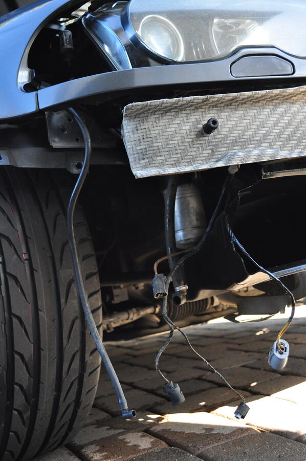

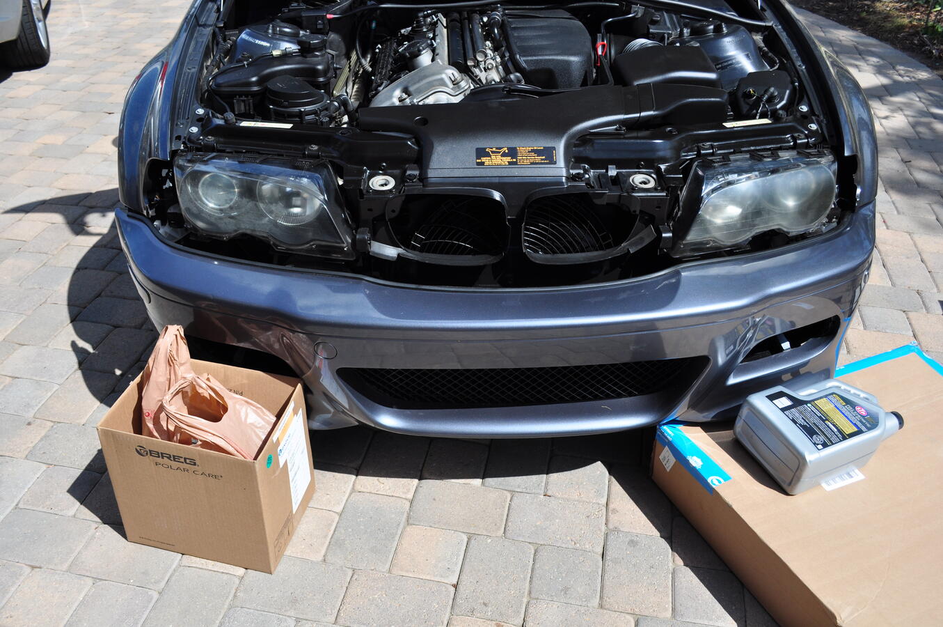

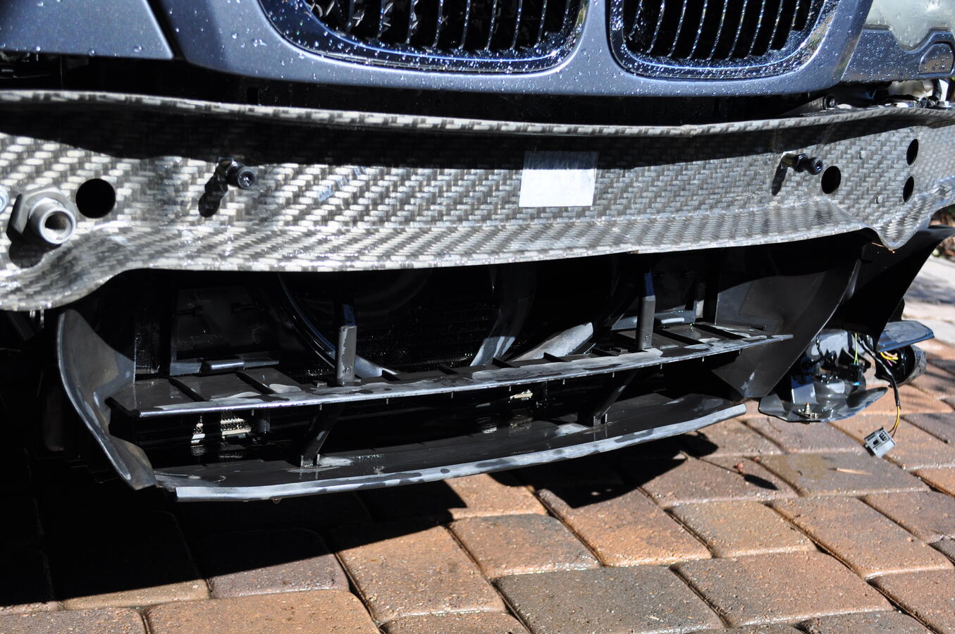

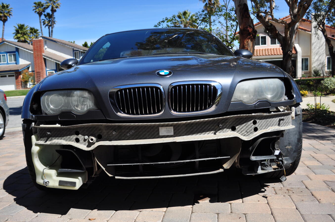

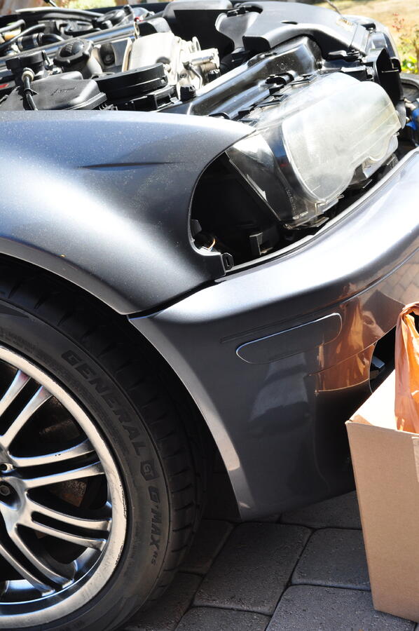

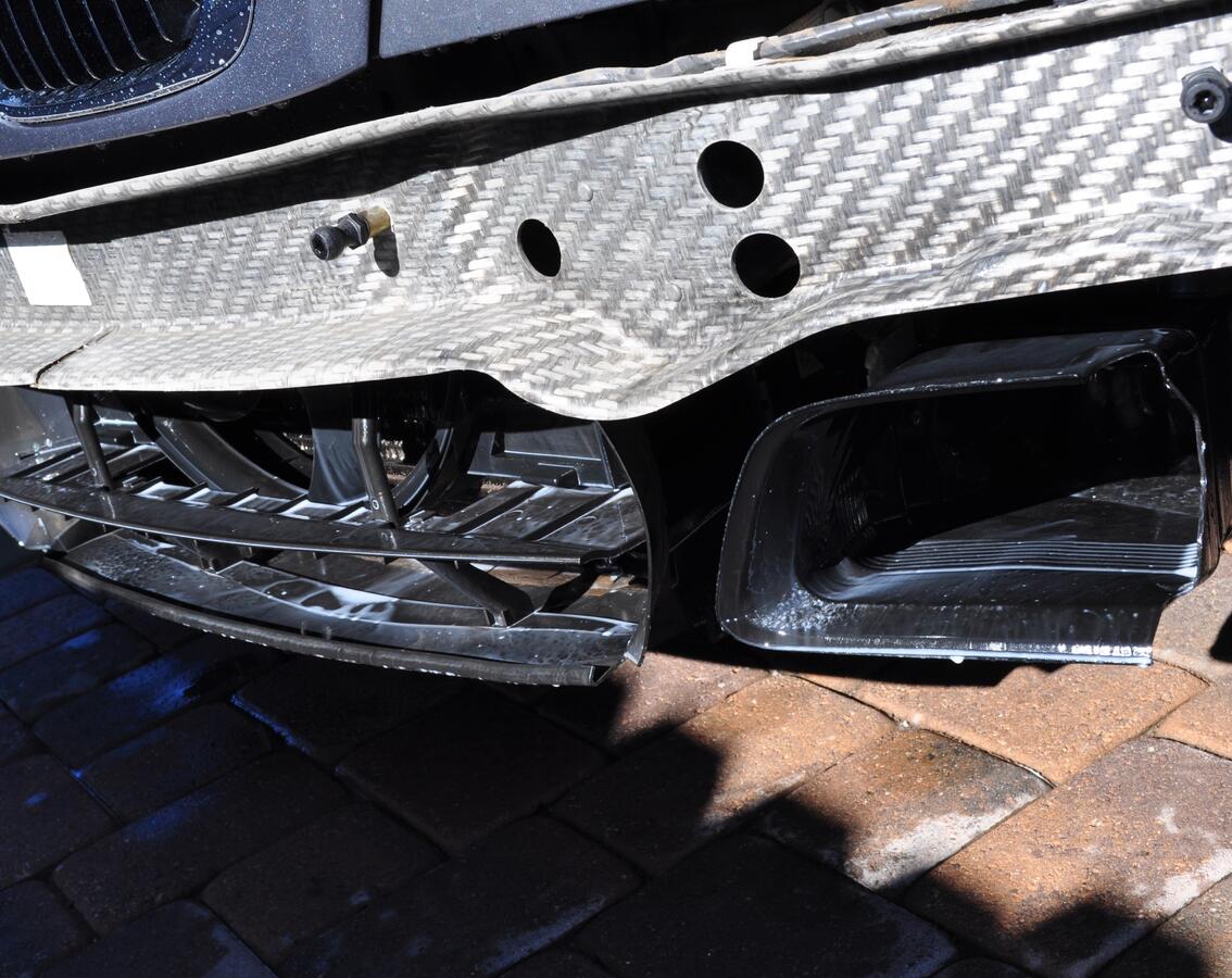

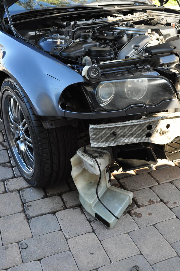

                      Took the front bumper/cover off to fix it, using a new pass lower liner and guides, but also remove washer tank/pump
                      Click image for larger version  Name:	20210603_235309.jpg Views:	0 Size:	141.0 KB ID:	109409

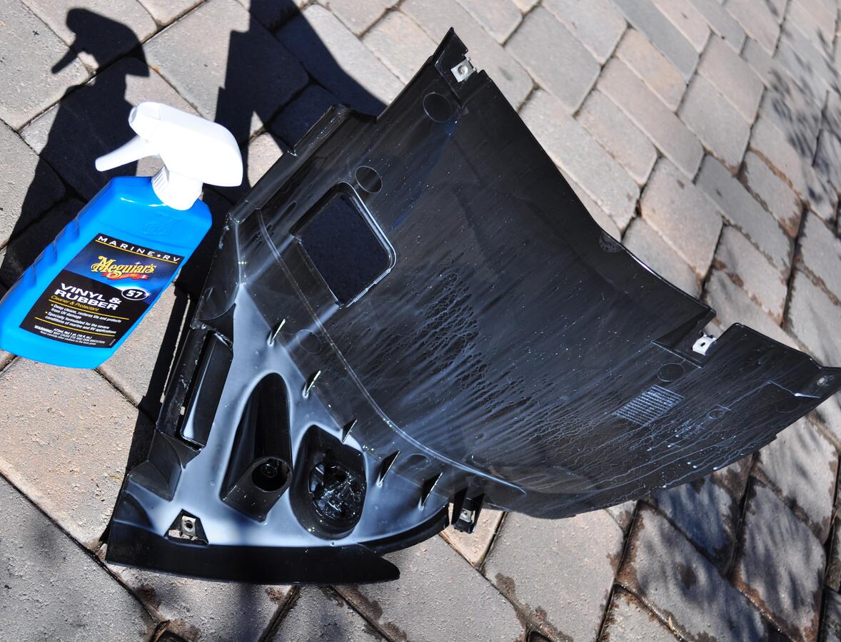

                      Hosed it all down, scrubbed it
                      Click image for larger version  Name:	image_24598.jpg Views:	11 Size:	213.7 KB ID:	109415
                      I then spray anything black (plastic, vinyl, rubber) with this meguiar's product. Same as the professional auto stuff, but half the price. It does a great job at cleaning and renewing. I still like 303 for the interior, but this stuff is just as good, if not better for exterior. Makes the perfect tire tressing imo. You can dilute too.
                      Click image for larger version  Name:	20210603_235627.jpg Views:	0 Size:	173.7 KB ID:	109416

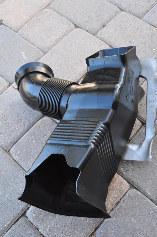

                      Ducting after wash/condition/dry:
                      Click image for larger version  Name:	thursday14.JPG Views:	0 Size:	82.3 KB ID:	109418

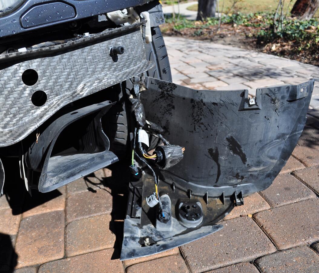

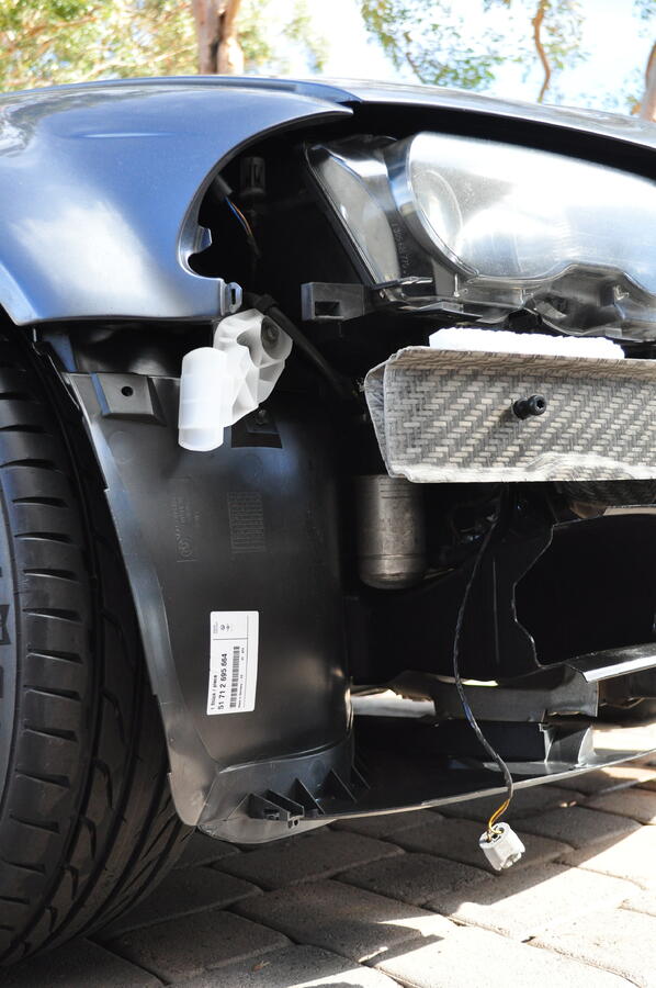

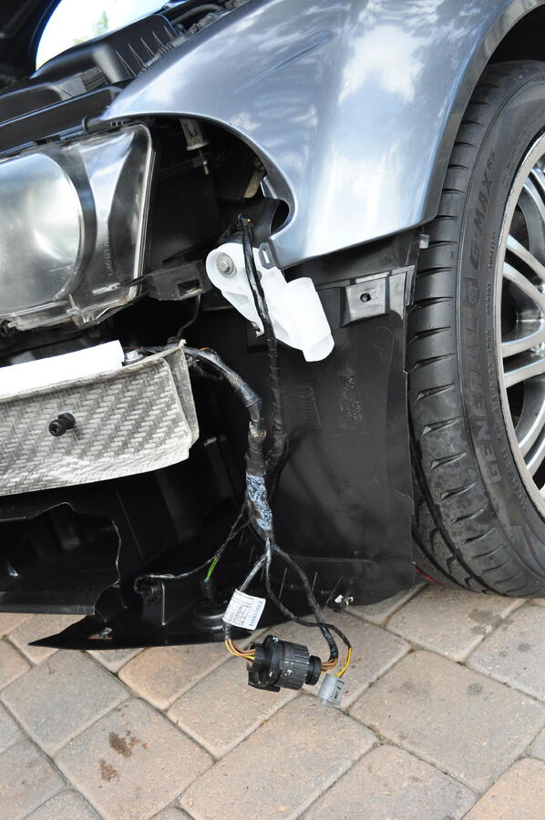

                      Tank down and out/disconnected in 3 spots iirc since this car has headlight sprayers.
                      Click image for larger version  Name:	washer07.JPG Views:	0 Size:	109.3 KB ID:	109421
                      Click image for larger version  Name:	washer12.JPG Views:	0 Size:	78.6 KB ID:	109420

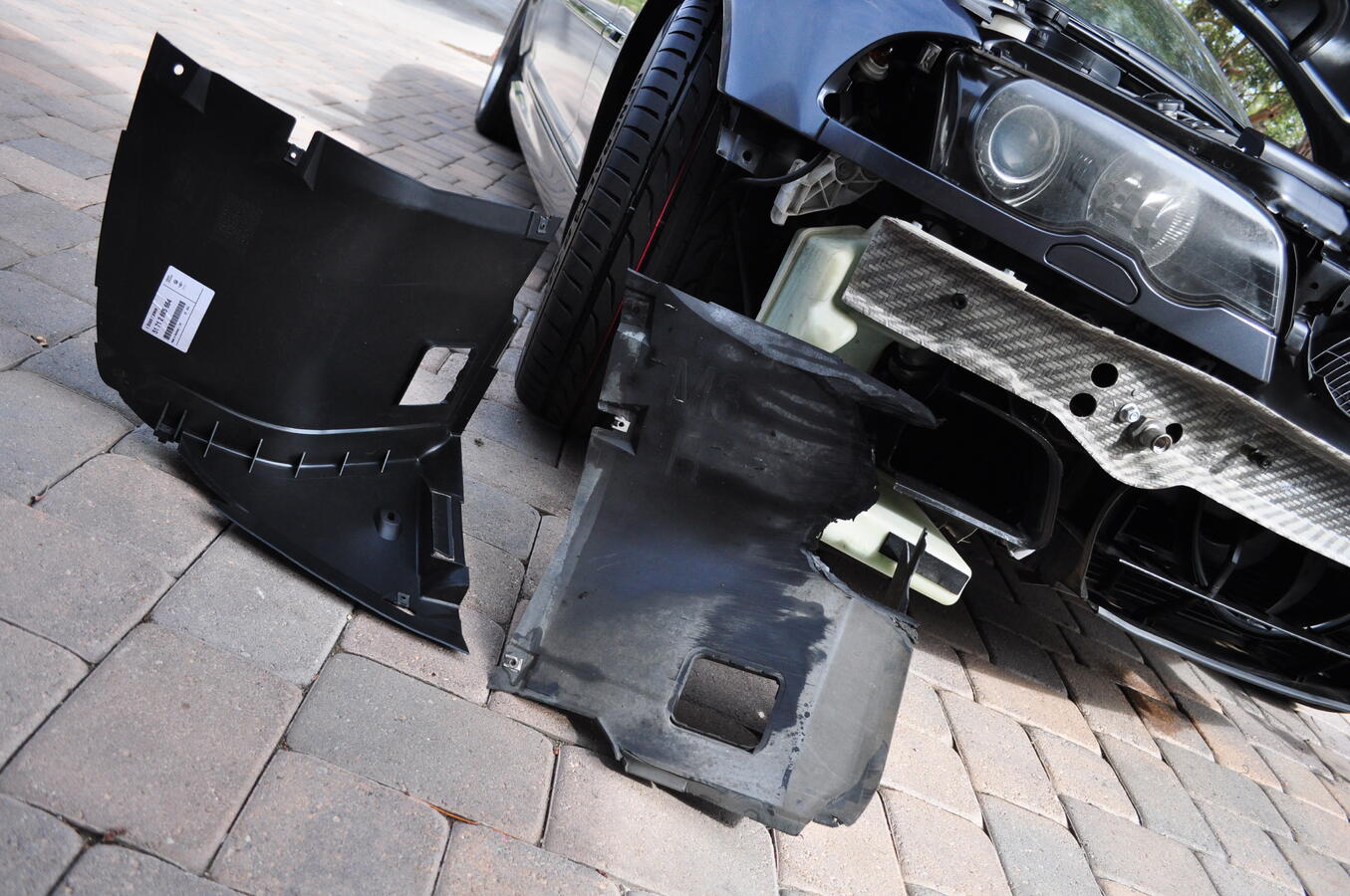

                      New lower liner vs old torn up one
                      Click image for larger version  Name:	washer04.JPG Views:	0 Size:	194.5 KB ID:	109422

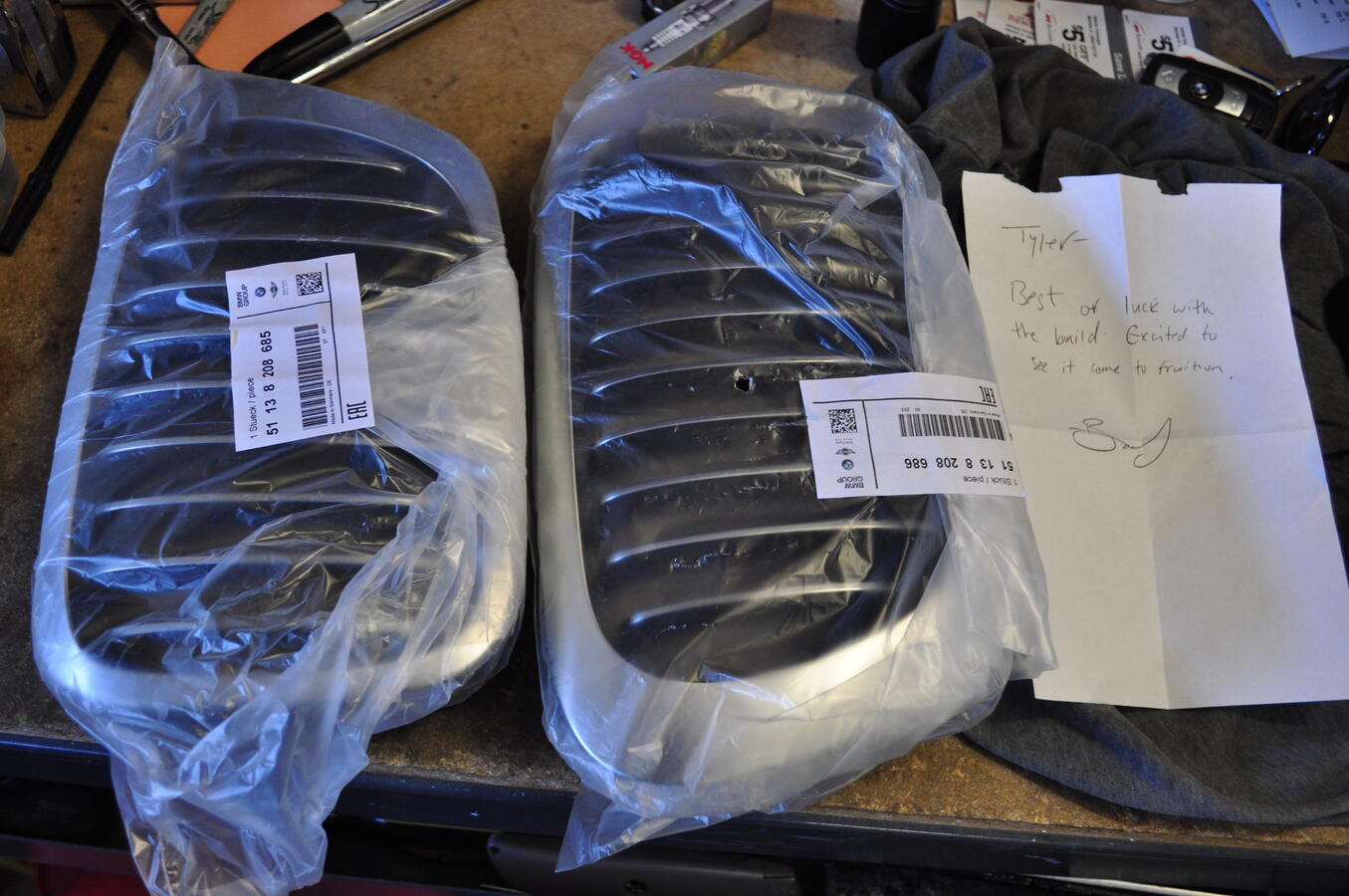

                        Forum member Bassel wanted me to have new oe grills thank you!
                        Click image for larger version  Name:	thursday5.JPG Views:	0 Size:	159.2 KB ID:	109435

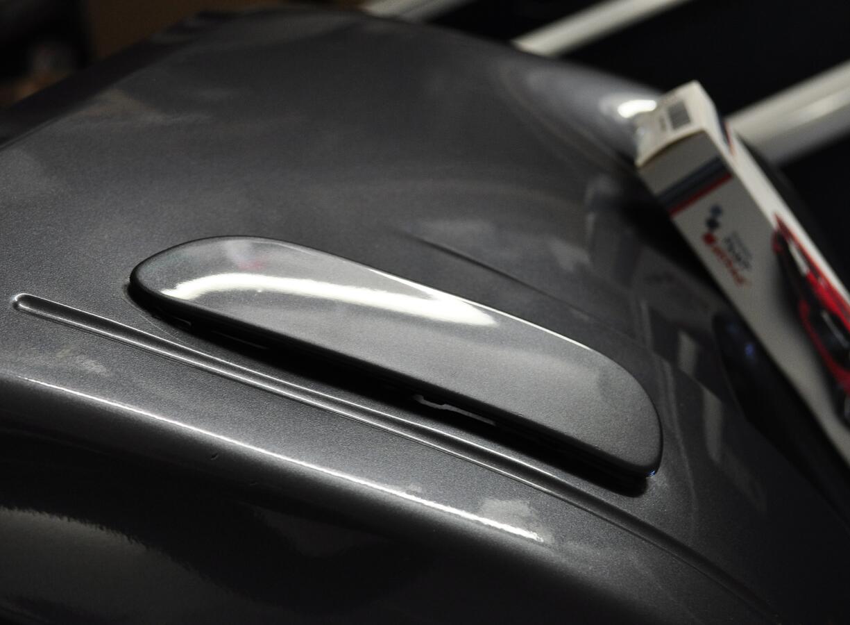

                        Luckily found a set of bimmian painted reflectors in steelgrey for $40! Inventory is low (no longer being made?), some colors are out of luck. Ind has them for $110 iirc.
                        Click image for larger version  Name:	20210603_235426.jpg Views:	0 Size:	83.9 KB ID:	109433

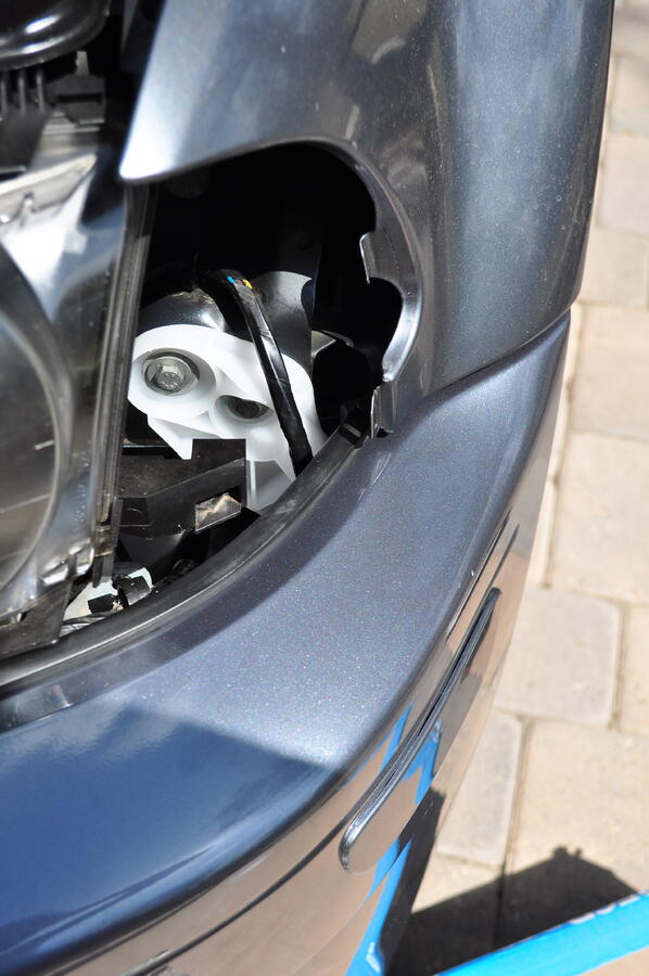

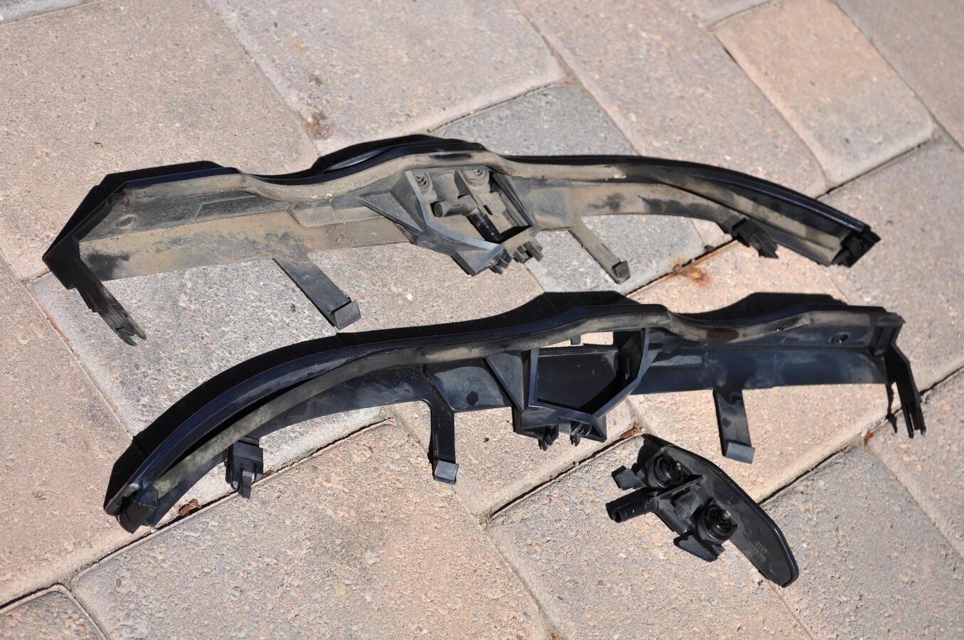

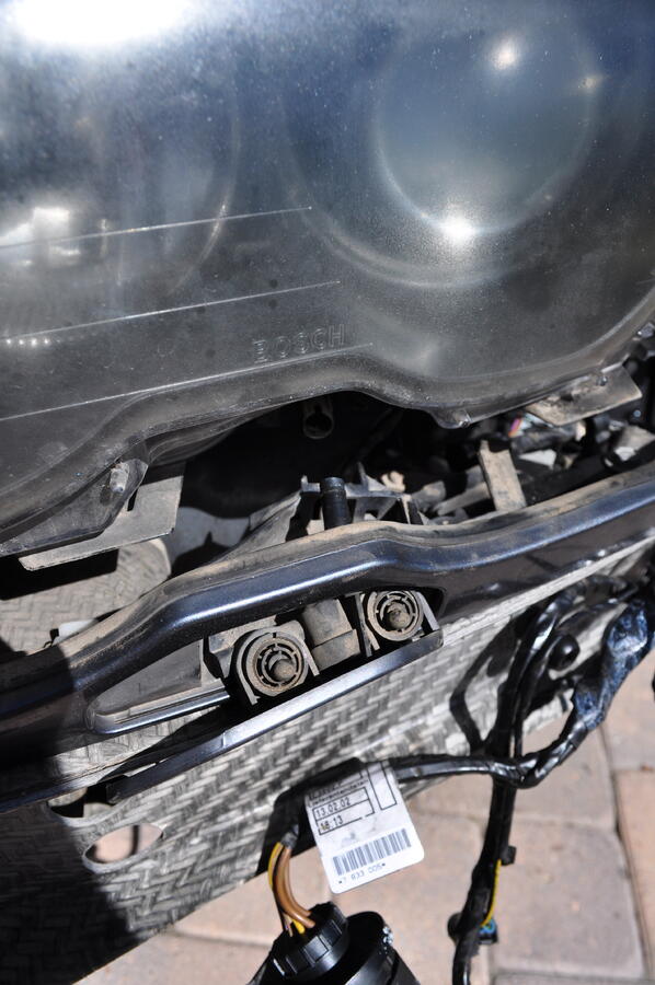

                        Removed the lower headlights trims and sprayers
                        Click image for larger version  Name:	thursday12.JPG Views:	0 Size:	81.1 KB ID:	109436

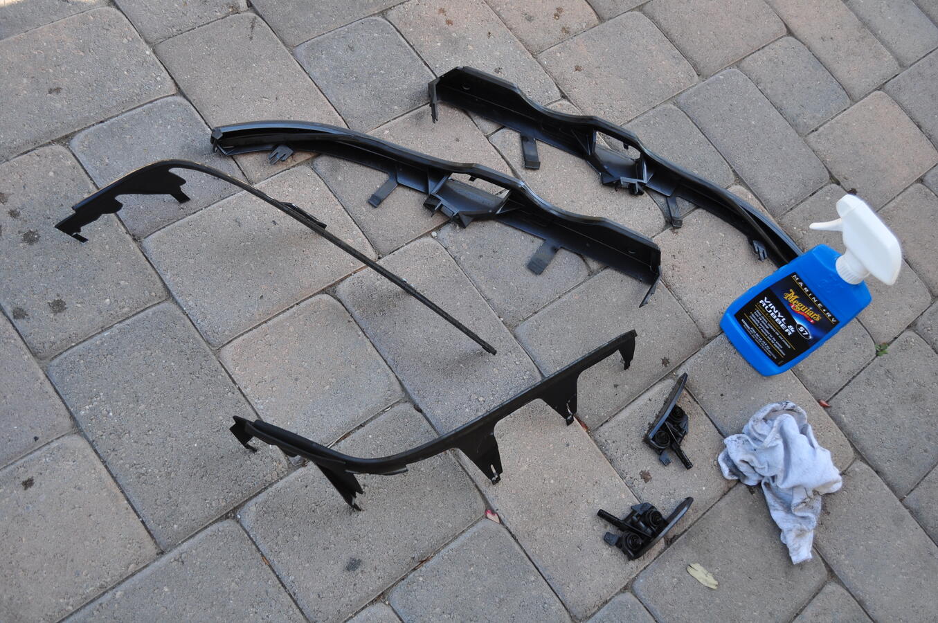

                        Cleaned and conditioned them
                        Click image for larger version  Name:	thursday15.JPG Views:	0 Size:	232.1 KB ID:	109438 Click image for larger version  Name:	thursday18.JPG Views:	0 Size:	233.5 KB ID:	109437

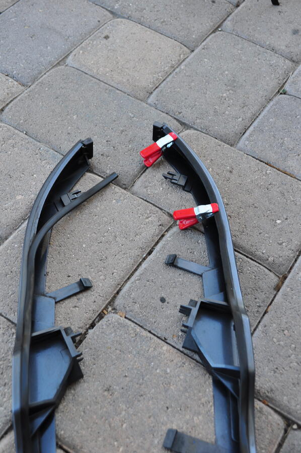

                        Glued the rubber edge gasket back on at the ends (common issue)
                        Click image for larger version  Name:	thursday21.JPG Views:	0 Size:	97.0 KB ID:	109440

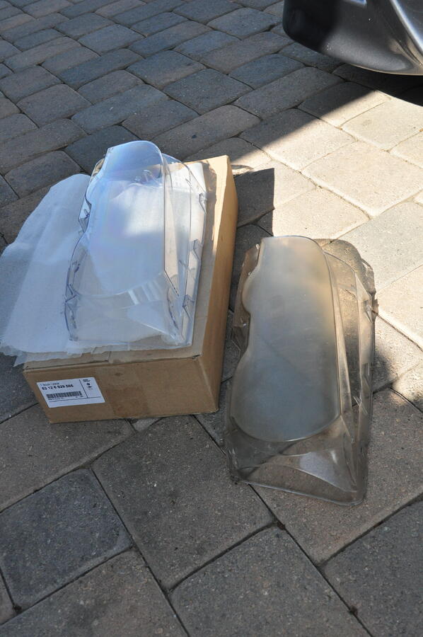

                        Found like new headlight lenses (AL) on ebay for cheap, score!
                        Click image for larger version  Name:	128sold23.JPG Views:	0 Size:	78.3 KB ID:	109443

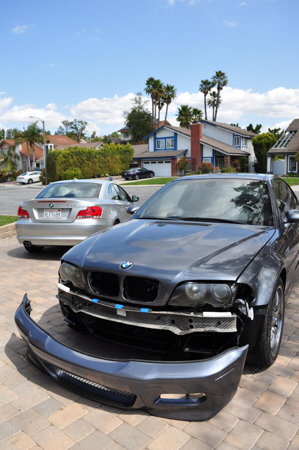

                        Sliding the bumper back on
                        Click image for larger version  Name:	128sold12.JPG Views:	0 Size:	199.0 KB ID:	109442
                        Click image for larger version  Name:	128sold14.JPG Views:	0 Size:	70.2 KB ID:	109439

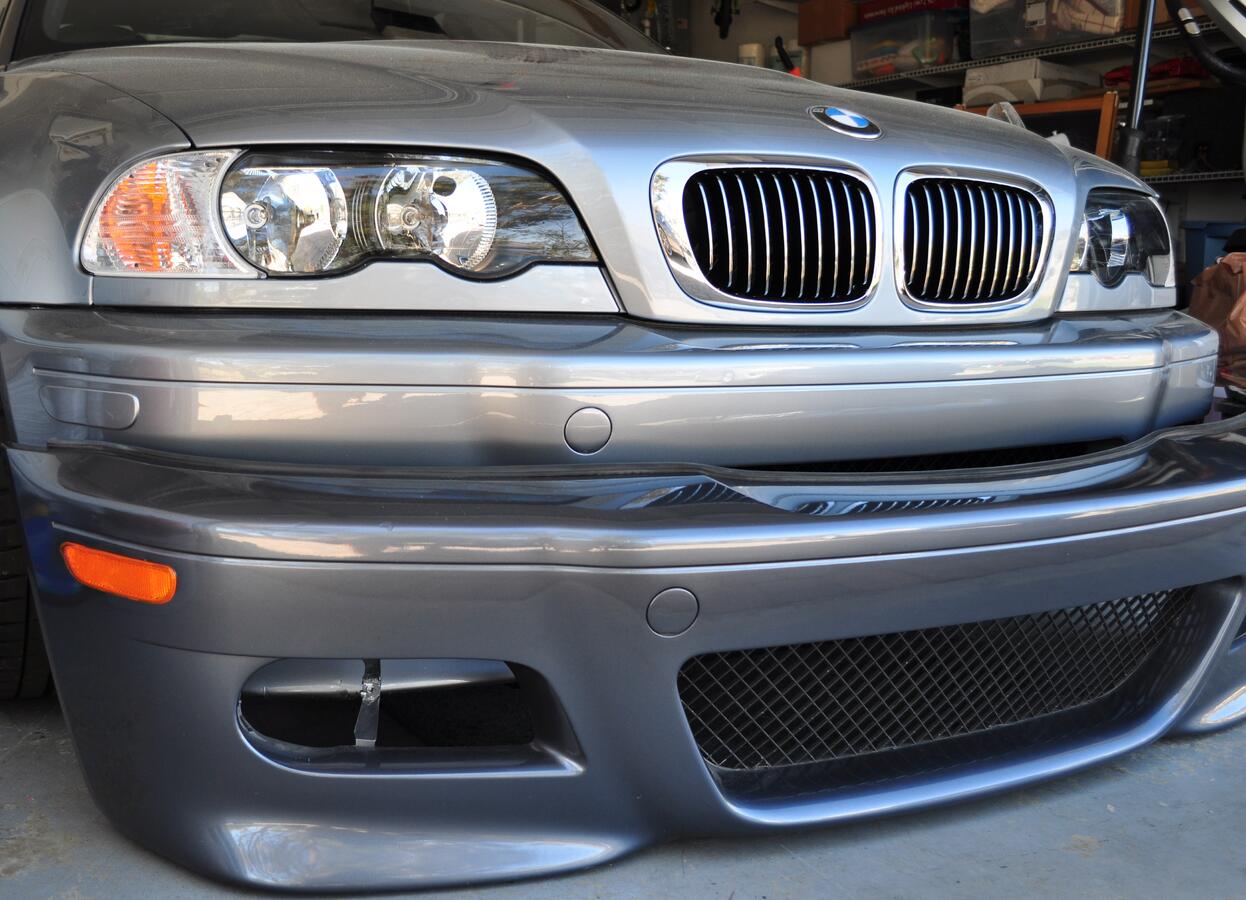

                        I can tell the bumper's been resprayed. Looks like the rear is too as well as the pass door/qp. I was hoping it was more original, but it's understandable for this 19 y/o car owned by a regular person. PO vaguely remembers, but not why the door and qp. Perhaps keying.

                              84 would be passenger side btw
