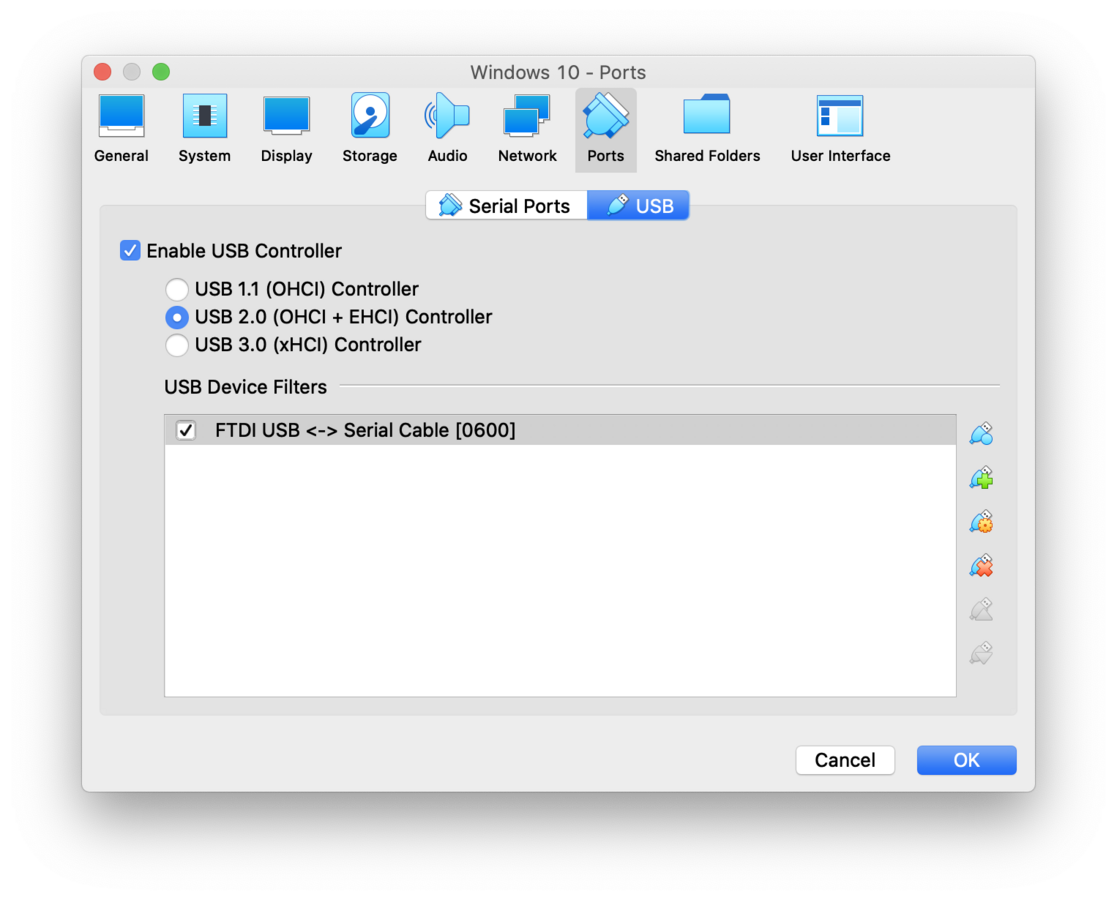

    To get my W10 VM to see my K+DCAN cable + adapter combo, I had to:
    1) install FTDI drivers inside Windows (.exe in the rightmost column was easiest): https://www.ftdichip.com/Drivers/VCP.htm
    2) shut down the VM
    3) change USB settings in VirtualBox to USB 2.0 and add the FTDI cable (thanks to this BimmerFest thread):
Name:	Screen Shot 2020-04-12 at 1.36.38 PM.png

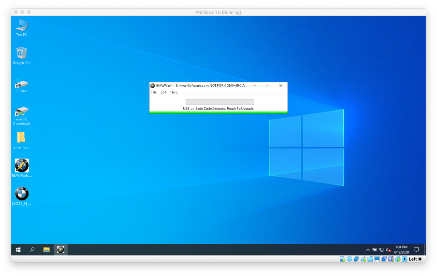

    4) start the VM back up, and BMWFlasher was good to go:
Name:	Screen Shot 2020-04-12 at 1.34.37 PM.png
