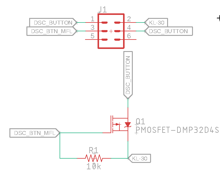

            There was a little bit more to this -- his requirements didn't allow for 12v to be run to the clock spring since he always already using all the pins. I made him a custom PCB with a P-Channel MOSFET which takes Terminal-30 for 12v, the DSC Button as an input, outputs it back to the switch center and also has an input from the button on the clock spring. The PFET allowed him to use ground as a trigger for the DSC button. This is the simple schematic if anyone wants it:

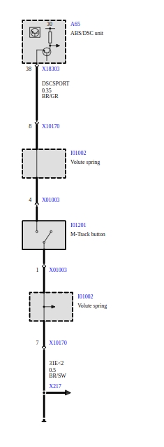

                    Hi there,
                    Has anyone been able to get this to work?
                    Pin 10 on the x10170 seems to be a constant 12v supply onto the steering clockspring, not a switched voltage.
                    I've tested the voltage on pin 2 of x521 and it seems to be a switched voltage when the DSC button is pressed, not a constant 12v. Battery voltage is present on pin 2 only when the DSC button is pressed.
                    Is there a way or method to allow the csl steering wheel button to output 12v when pressed?

                      I am recently trying to get my non csl or zcp M3 to have the m track mode steering button to function and stumbled upon your schematic on the MOSFET PCB to switch the negative trigger on the steering switch to output a voltage into the DSC button output.
                      With regards to the MOSFET PCB, do you have one for sale? I am happy to pay for your time and work for the PCB if you can help me make one.

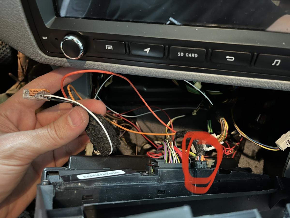

                            You can grab everything you need at the plug for switching center. Run one wire from the steering wheel button to the switching center, then add this circuit in series/parallel with the existing plug for the DSC button. I couldn’t find PNs for the male/female plugs, so I crimped two wires into each pin. Having quick finger/memory access to this button is probably my favorite mod, other than recaros. This is a photo of me testing the intensive washer stalk button/wiring which works with the same ground trigger:

                            So I'm trying to do all this right now and I'm not really seeing how this is going to work based on what you say.
                            Pin 2 on the 4-pin connector for the switch center is for DSC activation... And when I tried to wire that with a jumper wire over to pin slot 8(removed the existing pin that was there) on the 10-pin connector x101079
                            Pressing the button doesn't do anything on the steering wheel, but pressing the button on the switch center still activates in the activates.
                            So then I tried applying 12 volts to pin 2 of the DSC connector and that activated DSC..
                            So it would appear that the button for Amtrak mode on the steering wheel is a negative trigger button, not a positive trigger button, which is why it's not working.
                            I​​ figured this out because when I unplugged the four pin connector under the multifunction area and in a continuity test between pin 2 for DSC and pin 3 on the multifunction plug that triggered DSC and pin 3 has 12 volts... But pin 2 on the multifunction is the signal
                            So I think I'm going to have to just use a four-pin relay with 12 volts and a negative trigger for the ground and see if that works
                            Unless what you're saying is you did not depin pin 8 on x101079 And left the original pin in that slot and then just jumped the wire from pin 8 to pin 2 for DSC..?

                              Yes, you need a mosfet (ideal) or relay (slightly less ideal - longer button press needed) to make this work as it needs a positive trigger and not negative. That’s correct.

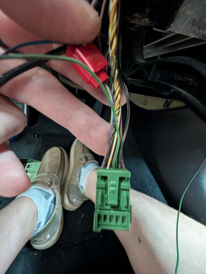

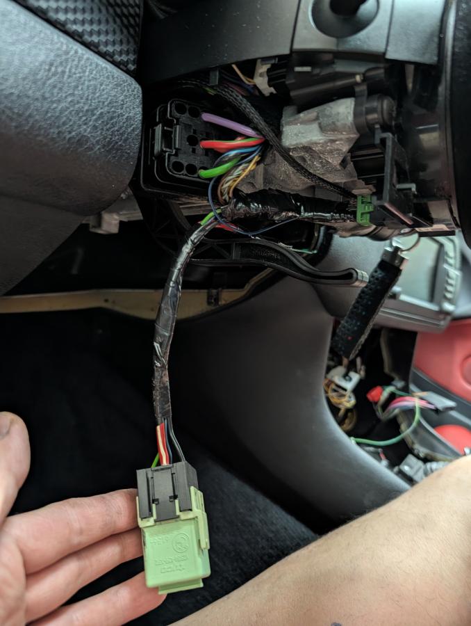

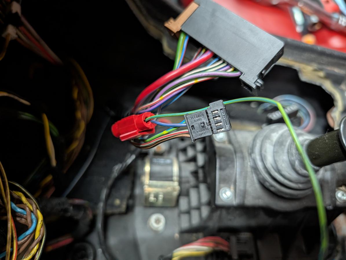

                                Ok well I just did it with a relay. Mosfet wasn't available for me. Not sure which method you did
                                He's what I did
                                This allows you to use the M track mode button on the steering wheel to act as the same DSC button in the SZM switch panel. I have M track mode setup and coded so that single press of DSC button enables/disables M track mode and press and HOLD dsc button disables DSC system. M trac mode button on steering wheel now will function exactly the sme and you can still use both buttons.
                                Code:
                                DSC
                                Tap wire on X521 connector (Black 4 pin connector in SZM Switch panel)
                                Pin 2 - DSC Passive Activation (12+ positive signal not negative ground signal)
                                M Track BUTTON
                                (This is negative ground momentary switch)
                                X10170 Green Clock Spring Plug (10 pin connector)
                                Pin 10 - 12 Volt ignition 2 source - Tap this wire for power to Relay
                                Pin 8 - Cruise Control ON/Off Signal to DME - Remove this Pin it will be unused, wrap pin contact in electrical tape safely as it also has 12 volts directly from DME and has 1 volt when power is off.
                                RELAY (any 4/5 wire relay I just used a factory BMW green relay and socket)
                                Pin 30 and 86 - Combine both wires on relay for pin 30 and 86 together and wire to PIN 10 green connector X10170 via wire tap
                                Pin 87 - Run this wire to PIN 2 X521 DSC Black 4 pin connector via wire tap
                                Pin 85 - ground switch - wire to X10170 PIN 8. (When you press M track mode button, the button sends negative signal on pin 8 which grounds the relay which then sends 12 volts to DSC plug pin 2 to toggle DSC like the factory button)
