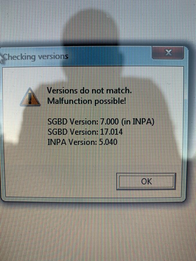

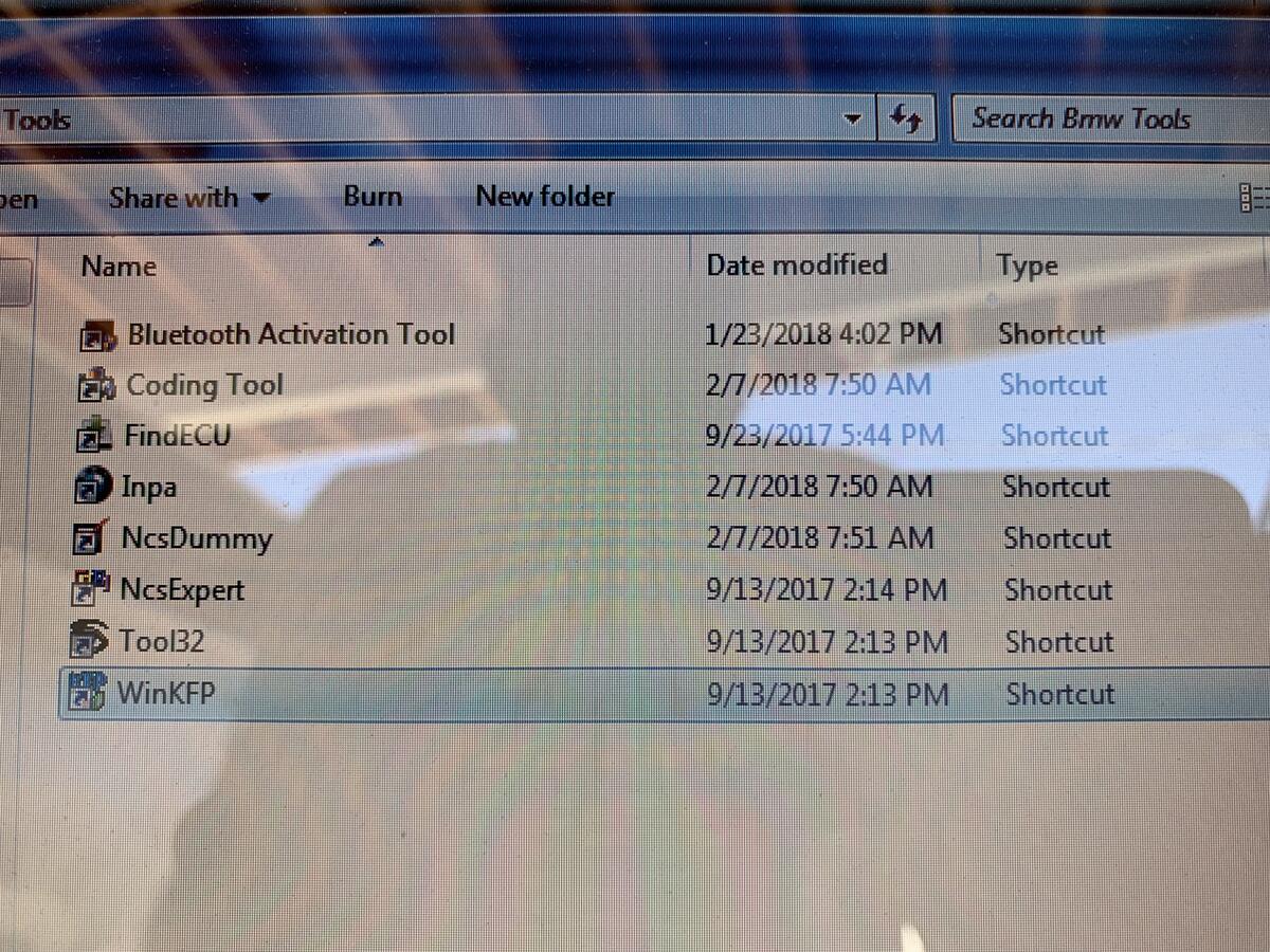

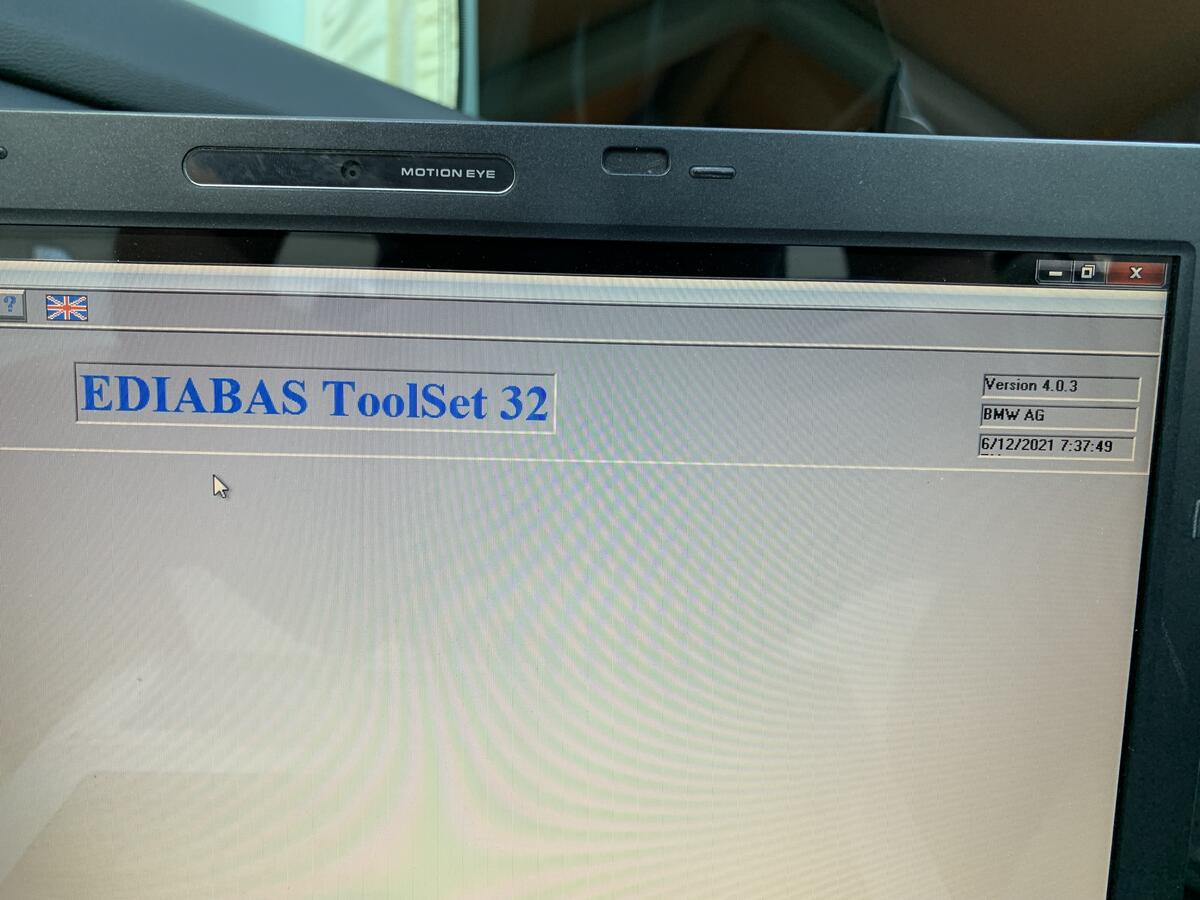

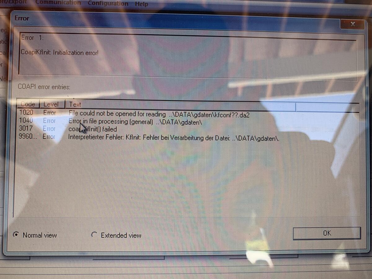

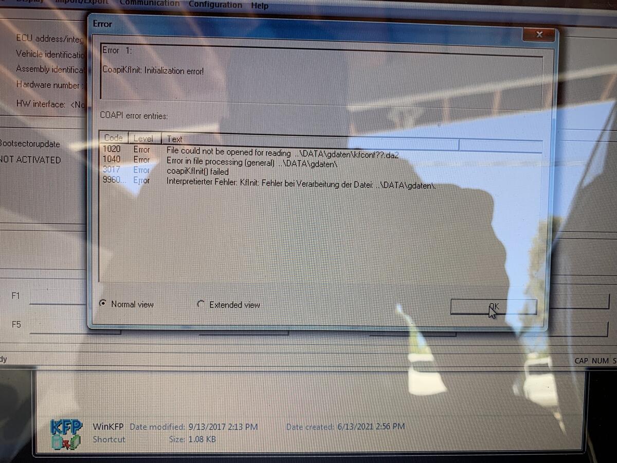

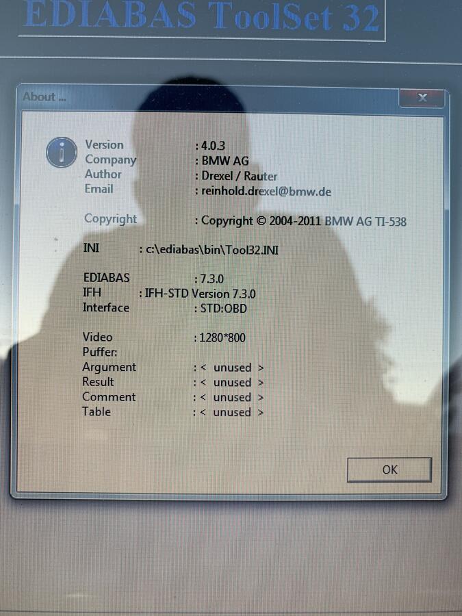

I've installed the BimmerGeeks software suite and although I've very comfortable using NCSExpert, NCSDummy & INPA, I can't say the same for Tool32 & WinKFP mainly due to lack of ever needing to use them. I've been using the BimmerGeeks downloaded software with an Amazon purchased K-DCAN cable that has the switch/toggle. Although INPA shows a solid connection to the car using the cable, I'm running into issues when trying to run Tool32 & WinKFP as I can't get any positive confirmation of either a connection to the car or outright errors when first launching the program(i.e. WinKFP). I'm trying to figure out the source of my issues and thought I would ask the coding gurus of this forum.

I recommend verifying your com port for your K-DCAN cable, it's either com9 or com1 depending on your C: /EDIABAS/BIN/OBD.INI
