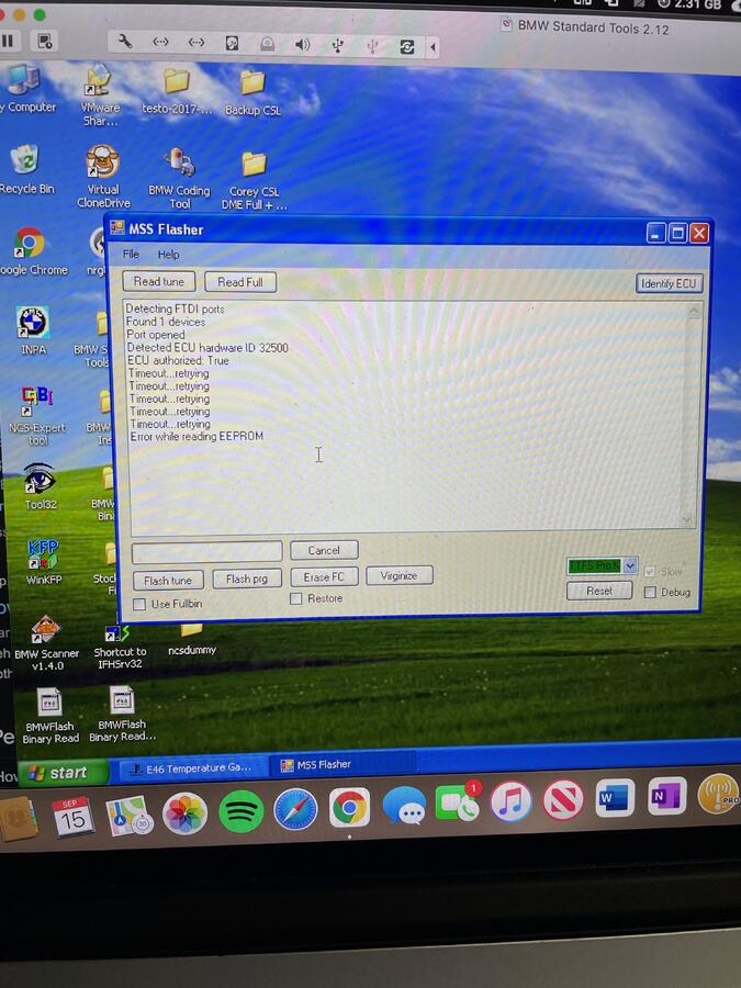

Welp add me to the club... recently picked up another MSS54HP DME and had a friend convert it to CSL bootrom over bdm. Got it back and noticed the cluster was throwing dsc and yellow brake light errors which upon further digging showed 5E19 in the MK60, CAN communication error. This also would not allow me to align the EWS to the DME. When I got to the alignment function in INPA a communication error was thrown every time. Tested 3 other DME's and neither of them threw the CAN error. I hooked up the dme in question to my bench setup and figured I'd try turning off EWS just to see what happens. Before I sent this new dme off I scanned the codes to confirm it didn't have any internal faults, but am now kicking myself I didn't plug it into the car. Well I started to flash the modified bin file with bmw flash via the bench setup and it never started the flash. Hung on a message like "retrieving contents..." (I don't recall exactly) then just sat there. Had no choice but to abort so I figured nbd if it bricked the partial flash I can just load up MSSFlasher and reflash the partial. This isn't my first rodeo...
WELL that's where shit hit the fan. When I clicked "Identify ECU" in Mssflasher it timed out and threw an error trying to read the EEprom. That tells me it's a real brick which is a first as a corrupt partial flash typically doesn't do that.
Anyone ever run into this before? Going to have it hooked back up via BDM and reload the software but I now don't know if this dme is tweaked or it's just corrupt software that was loaded during the bdm process.The CAN error has me concerned for sure. Sucks I literally just replaced my other CSL converted MSS54HP for a 5E19 CAN error due to a shorted pin.

It's a late post, but I'll leave it as a note to help future people.
I had the same problem, but I was able to recover.
First, if you want to reset the flash counter, use "Erace FC". Mssflasher's youtube guide is out of date.
(I made the same mistake.)
In the case of this thread, I expect it to be because the versions of partial bin and Full bin do not match.
The first step in recovery is to flash your tune file (partial bin)→Now you can communicate.
Next, flash your backed up Full Bin.( If you haven't backed it up, you can download a Full Bin without a VIN from GitHub. ← Many thanks)
This will completely restore it.
When You use a full bin on GitHub, the VIN is not registered, You get an EWS error and the engine does not start.
In that case, you need to fix the Bin using Ecuworx tool etc. to remove the EWS error, or rewrite it to your own VIN using Tool32 etc.Last edited by mushitaro; 06-27-2022, 06:47 PM.
