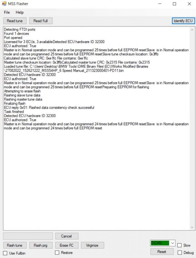

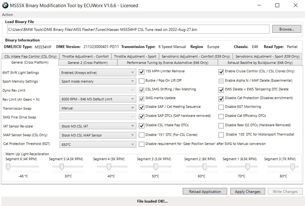

                        Closing the loop on this, I fixed my issue today. Thank you Martyn !!! I ordered MSS Flasher, went back out to the car and it pulled down a 64KB file instead of a 32KB file (that kept happening with BMWFlash). I made my modifications via ECUWorx Binary Mod tool (could not be any easier) and saved the binary locally. I then tried to flash the modified binary with BMWFlash but it error-ed out saying "This Upgrade Is Not For This Type Of DME. HP to Non-HP etc." So I switched to MSS Flasher to flash the tune. Worked like a champ!
                        For the uninitiated like myself, in MSS Flasher, I wasn't sure if I was supposed to select "Flash tune" or "Flash prg" when it was time to flash my DME/ECU. I went with the former (Flash tune) and it worked perfectly.
