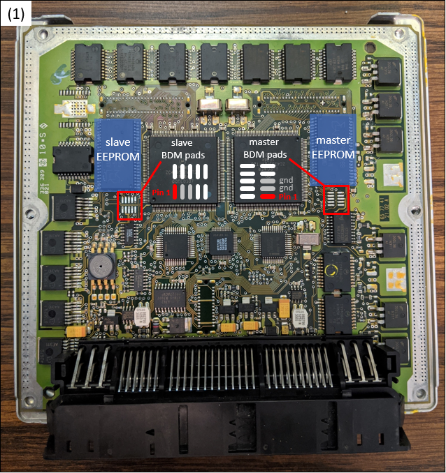

            Open up your ECU and post pictures of your EEPROMs and the BDM pads when you get it back. Like other said, could be ST EEPROMs. Or maybe they messed up the pads.
            The highlighted things in this pic:

                  Hmm I don't see anything blatantly wrong. Chips are AMD too so they should work fine if they have an fgtech clone. It's kinda hard to diagnose over the internet, but the next thing I would do is check continuity of every pad on the bdm header. Just to completely rule out hardware issues.
