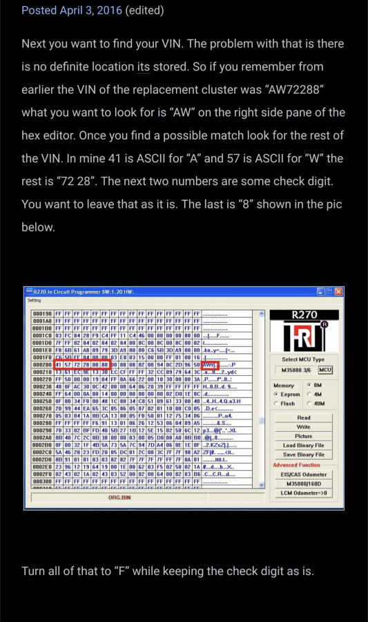

    I'm dropping a C24h IKE into my Touring and I'm in the process of altering the EEPROM bin that I dumped off the M35080-6 -- I have 00h - 1Fh set to 00h, but the VIN is a bit confusing -- do I just set 7Ah - 7Eh to FFh? I do see the VIN there, but I'm not sure if there's a check digit or anything else to worry about --
    50 4E 62 05 80 = PN62058
    Thanks!
    -Ted

        Yeah, you need to desolder the EEPROM, burn the edited contents onto a new one (because they like to fail if you edit them and then burn them back for some reason), then solder it back. I'm converting mine for use in a four door (so adding additional LEDs and such), so it already made sense to strip it down to the PCB.
          Yea i have to remove the M3508 chip from the board and read everything using my r270 chip reader. technically you can use PASoft to read the cluster BIN file but the mileage and VIN areas are protected in the sense that they do not allow writing data via OBD. I have had hit or miss with attempting to write back the new Bin file with Zeroed out mileage and changed VIN back to the original M3508 chip. sometimes it will work if i change my r270 to classify it as a different type chip but usually most times it doesnt work. i have about 3 chips oft i got from ebay few years ago that I use on my clusters and seem to work fine.
          I usually Zero out the mileage and then update the VIN using the directions above, flash the NEW chip in my r270 and then solder the new chip back to the cluster board. as soon as you turn ignition on in a car with an LCM that has a matching VIN, the mileage just updates and displays on the cluster.

              the VO is brought back onto the new Chip.
              when you read the BIN file it contains all of the coding data for that cluster coding index so if its a 24 CI and you read the file. you Zero out the miles and change the VIN in the BIN file and then save it. then you flash that modified BIN file back to the replacement M3508 chip. once you flash it back to the cluster, it should be exactly as it was except the proper Vin and Miles now.
