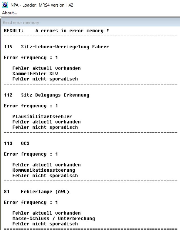

    ..which I've tried without luck. INPA throws code "OC3" now, and if I try other combinations, it throws codes for the seat back latch locking.

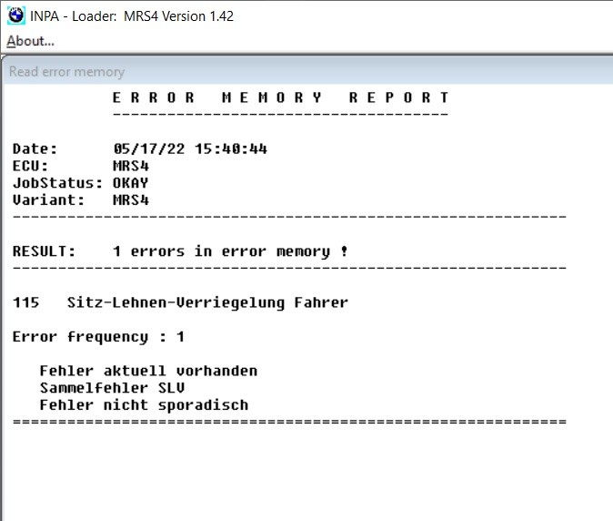

      EDIT x2: I completely reset my FSW_PSW to factory default, then just changed GURTSCHLOSS_FAHRER_1, GURTSCHLOSS_FAHRER_2, GURTSTRAFFER_FAHRER_1, and GURTSTRAFFER_FAHRER_2 to nicht_aktiv. Now here is the code I got in INPA:

        I went in and set VERRIEGELN_SITZLEHNE_FA_1 and VERRIEGELN_SITZLEHNE_FA_2 (Lock seat backrests) to nicht-aktiv. Now the airbag light will flash for 30 seconds, then remain out for 30 seconds, flash for 30 seconds, remain out for 30 seconds - and keeps repeating. However, there are no codes in INPA anymore. Very confusing, especially now that the car is not telling me anything.
        Update: What appears to be a SUCCESS!! I let the light do its flashing thing for a few minutes, then it went out completely. I've turned off power for a few mins, and turned back on for a few minutes - repeated that process 4 times now - no light at all other than its brief self test on ignition. If it comes back, I'll post again - but otherwise I think I'm all set! Thanks for your help Mr.wReckless!
