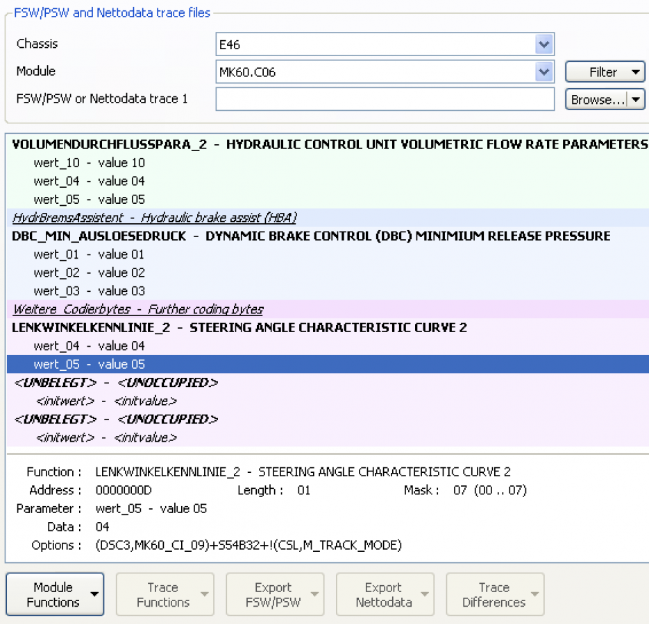

    Hey all. I know it's been discussed before but I can't figure out the function our steering angle sensor uses for determining steering rack ratio and was wondering if anyone has any ideas on this? I have ZCP settings for my ZHP rack currently which is perfect because they're the same ratio on an M3 but actually wanted to see about creating a custom profile in NCS Dummy to adjust for an even faster rack assuming this is possible. I don't see why you can't because you just need the formula for how the sensor takes the turns lock to lock of the rack when mounted to M3 knuckles. I'm more curious if the sensor calibration will max out before reaching said faster ratio.
    Here is what I found in NCS Dummy. For reference, there is a SMALL window outside of the rack ratio that the sensor will allow for a faster rack without triggering DSC inadvertently for thinking you are turning the rack too violently. I actually have CSL MDM settings on my ZHP sedan and on a fast backroad with a lot of inputs the car works incredible with the CSL settings and that rack is a 13.7 since non-m knuckles allow a shorter tie rod length. I've considered custom knuckles on the M3 but if I want to go faster than an equivalent 13.7 ratio, the sensor will absolutely need a custom profile so it doesn't think the car is constantly understeering.

        I would pull the data values for non-m, CSL and stock M3 from NCS expert. Plot those against known ratios and that should give you the conversion curve.

          seems the possible data values are from 00 to 07
          can people help to throw the different values and hardware configurations here?

            in short: we’ve all been wrong. This is not just a steering ratio curve in the MK60, and writing ZCP values *does not* set your car up correctly for the ZHP/ZCP/CSL rack unless you also have a ZCP/CSL specific 817.3 MK60.
            None of this is fixable in NCS expert as that table actually feeds the vehicle cornering model based on which rack you have. It’s not a this ratio to that ratio conversion and the data values in NCS that are writeable are not enough to fix the model.
            The only way to do this without decompiling, writing new software and recompiling, then iterating to get your vehicle model correct, is to 1) set your MK60 to the rack your car came with and 2) intercept the steering wheel angle CAN and convert it to the desired ratio multiplier.
            Hope that helps! Been making great progress in decompiling and understanding the math that’s inside the MK60 this week.
            edit: For completeness, the data values you refer to are not populated on all MK60s - each variant has specific ones available to choose from. This is confirmed in the binaries. Those data values point to a table mapping of several variables that’s baked into firmware and not editable with NCS. The ZCP/CSL in particular remaps the M3 entry in the table to totally different numbers.
