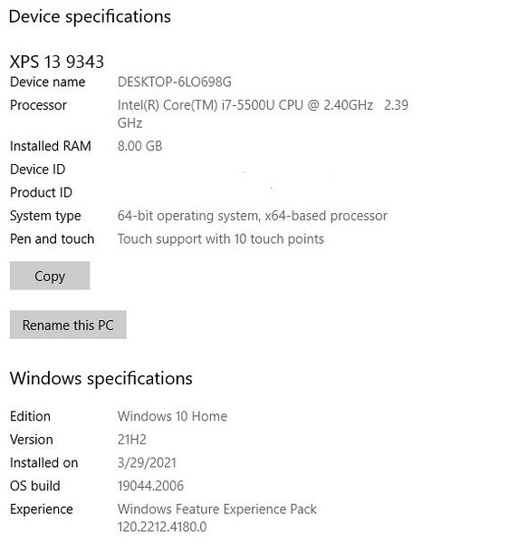

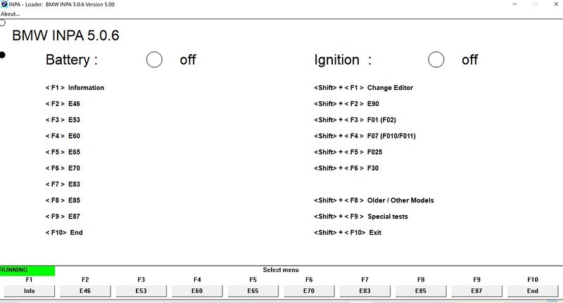

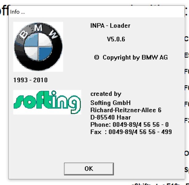

    Below is some more info on my laptop in case it matters along with the version of INPA. Thanks and I appreciate any help!

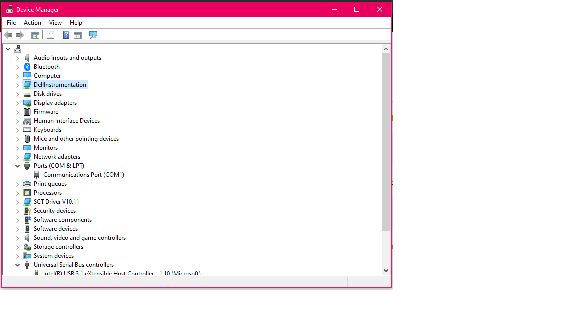

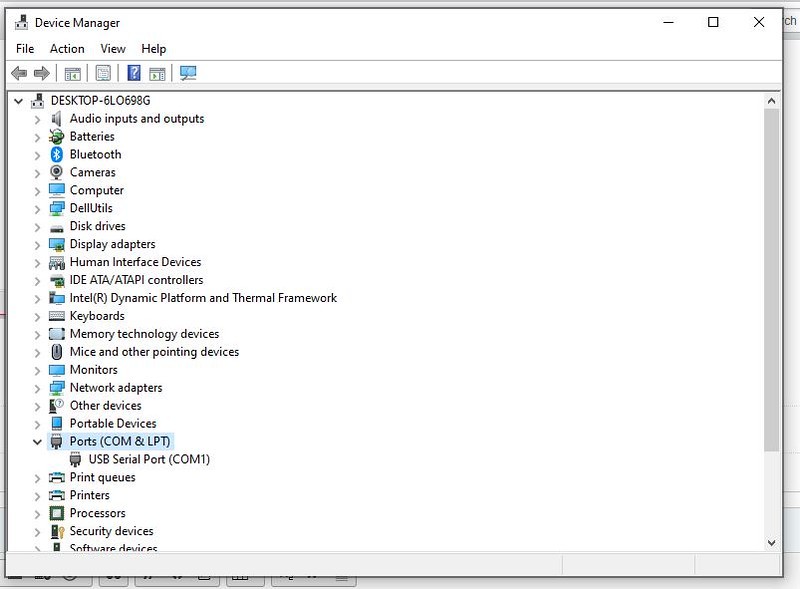

    Have you checked that your com port matches in the OBD.ini file and the device/cable in device manager?

      Thanks for the help! Bear with me here for a minute.
      I am quite a moron when it comes to computers, but you sent me in the right direction.
      I have no idea what you typed meant, other than the port but it allowed me to do some googling. After searching I found this thread:
      From there I think I figured out what port I am using in the device manager. I plugged in a thumbdrive and looked at what popped up ... I think this is what I am looking for (Port 13):

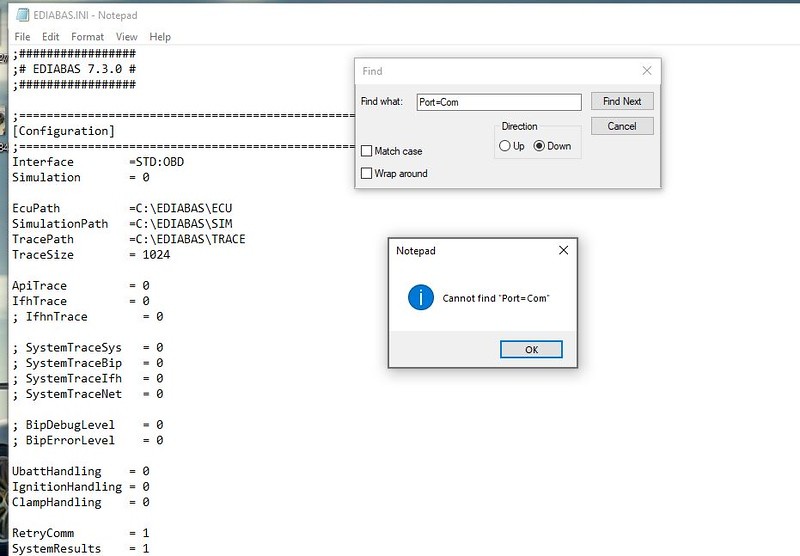

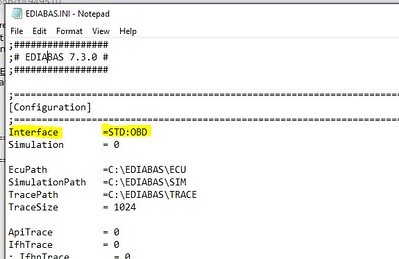

      I then went to the Ediabas.ini and made sure that my stuff was set to Interface =STD:OBD, which it is:

      I then did a search for Port=Com or Port and found nothing in that file.

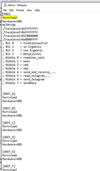

      So, I figured from the post I linked that I needed to look at the Windows OBD.ini file
      In there I found the following and this is where I am stuck. Do I change that number to 13 in that file?

        Yes, you will need to match the port number in the OBD.ini to what is showing under Ports ( COM & LPT). I attached a picture below.Click image for larger version  Name:	Untitled.png Views:	0 Size:	45.2 KB ID:	187175

          I connected the USB to OBD2 cable to the laptop and
          COM4 showed up. I then went to advanced settings under properties and changed it to COM1. Now it shows like this:

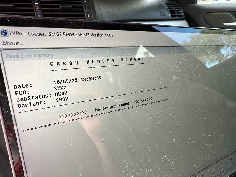

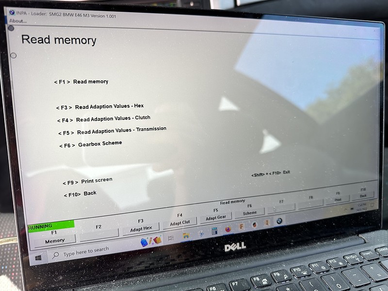

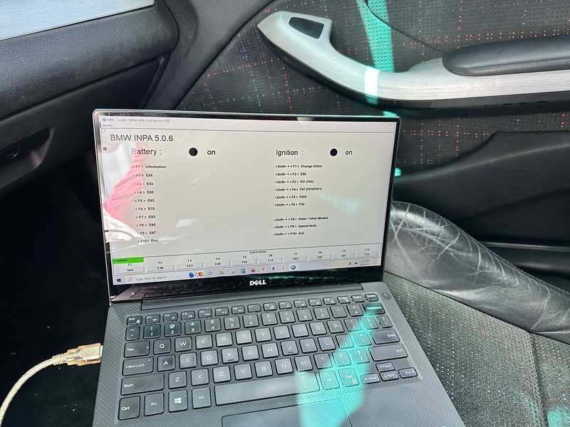

            Success!! Thanks a lot!!
            Now I have to figure out the steps I need to take after I change the clutch. I wish I could also connect to my wife's F31 Diesel to read the code ... but no F31 on the menu.

              Yea, no F series. GL, happy to help.
