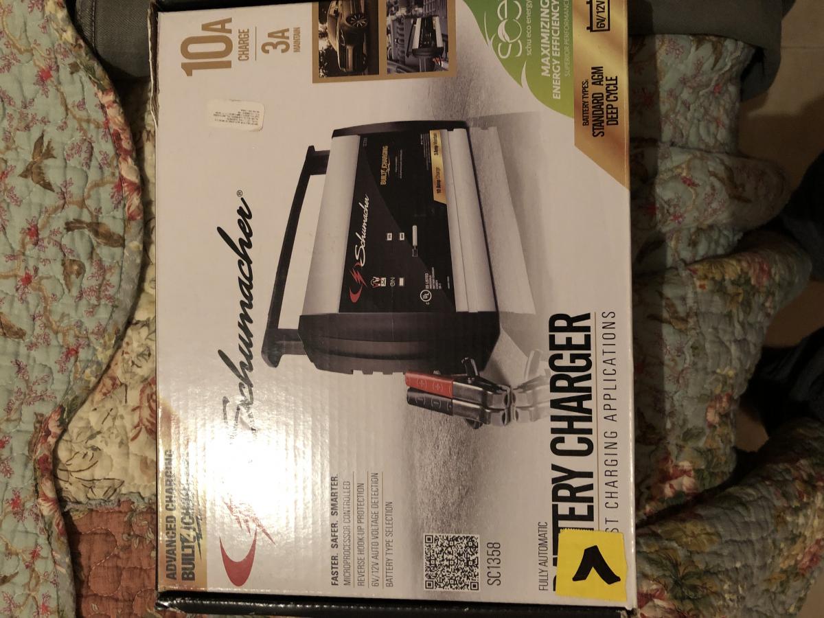

                      I have used a 10A without issue
                      which one do you use?
                        this, bought at Autozone

                          Thank a lot!
