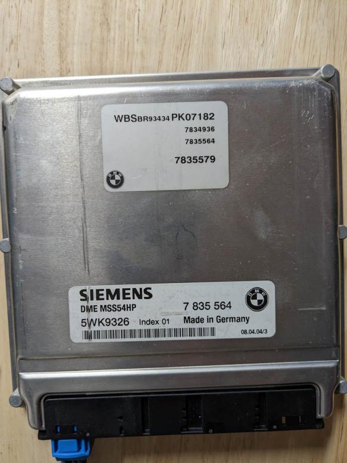

I bought a spare DME, and I'm in the process of changing its VIN using the ecuworx instructions for Tool32.
I was doing OK, until the part with the text string:
I can see the numbers on the case, but they aren't labeled. Can someone help me figure out which number is which, or at least how I can find out? I attached a pic for reference.
update: You can find this info in INPA (see Post #4) or Tool32. Two of the numbers did NOT match those on the case.
Thank you!
The software number, authority number and assembly numbers should be labeled on the outside case of the DME
