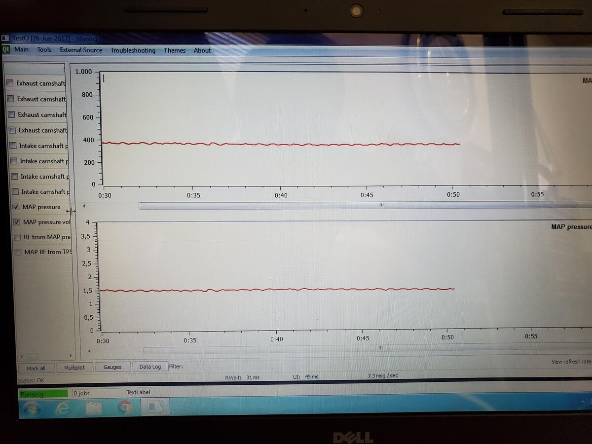

      I used it to check my MAP sensor was working, but it looks like it will log all sorts of other stuff as well.
      Now you’ve wired your MAP sensor as per my guide, it’s time to check it’s plumbed in properly and reading what it should. To check the reading we require a 3rd party tool called Testo. Testo is based the Ediabas API and provides realtime data. In order to use Testo you will need the following: A copy of Testo, available to download here Working INPA installation An OBD2 cable that is compatible with INPA Visual Studio C++ redistributable package, this is only required if you receive an error regarding ‘MSVCP100.dll’. Extract Testo to a folder and run the ‘Testo.exe’ executable.

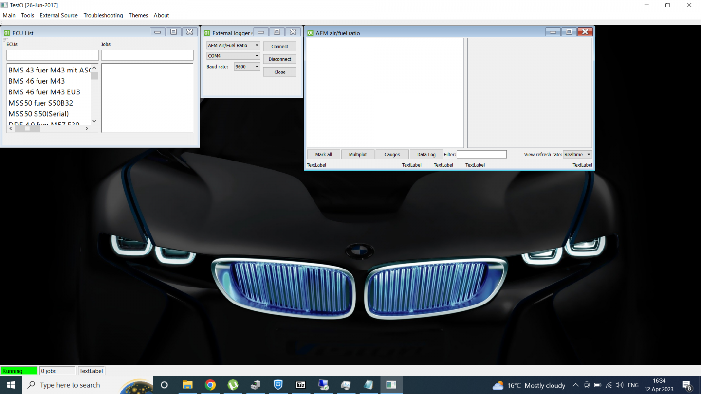

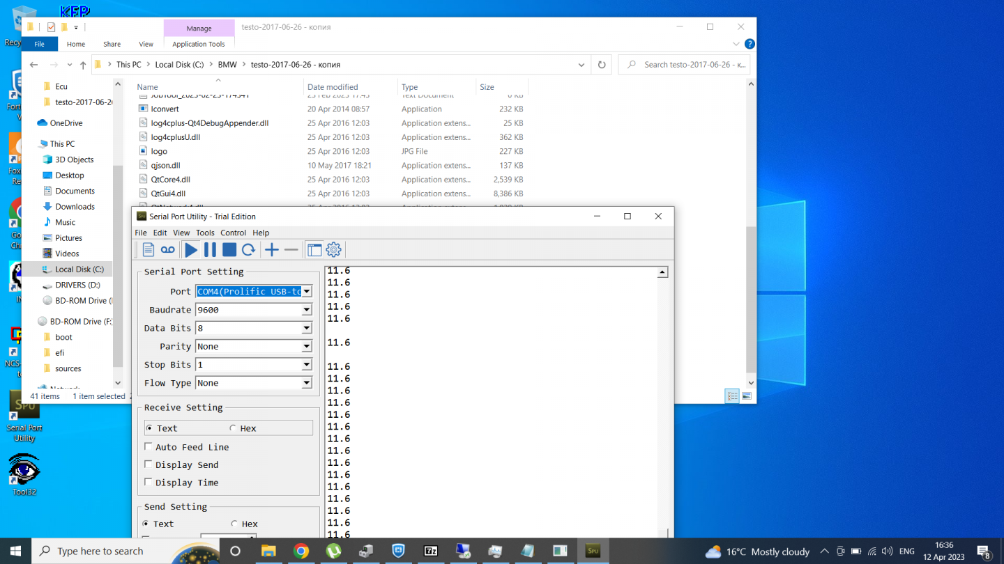

                            Guys! Can someone help with AEM AFR connecting to testo- my old notebook died- now installing new and got the problem- now my testo logger doesnt want connect to AFR, already choosed different com port settings but nothing- on my friend laptop is all ok- connecting to mine- empty windows in afr. Checking with com port data utility- all is working( Click image for larger version
